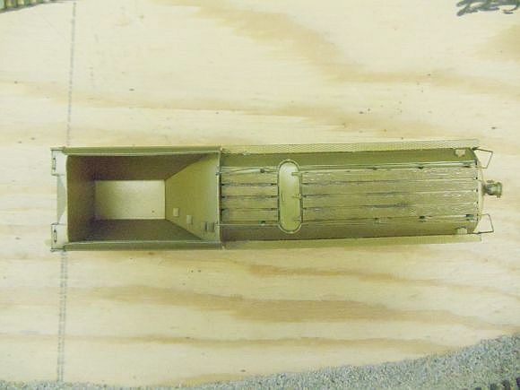

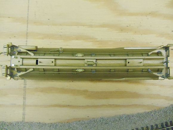

While working on the USRA 4-6-2, I've been looking forward to what I'll be painting next. I have a NJ International C&O J-2 Class 4-8-2. It has a long haul tender.
Here is a photo of the bottom.
The problem is that this tender is all soldered together. The bottom doesn't come unscrewed. If I can't install WOW sound, there is no need to paint the loco. I'll need to find a way to open the tender coal bunker with a hole large enough install the decoder, the Keep Alive unit and a speaker. I'll also need to route the wires from the tender to the loco.
More on this in a few days.

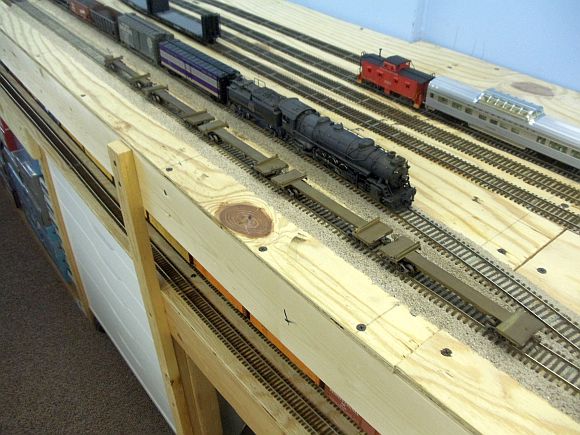

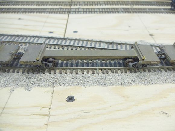

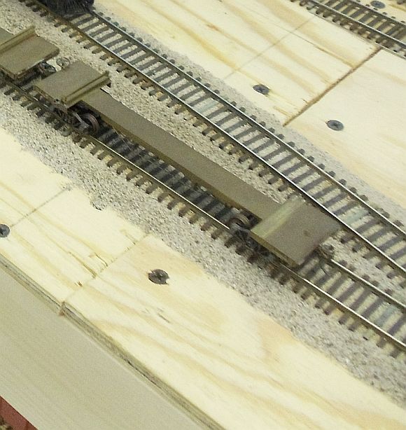

A friend of the SBG, Jon Shubert, gave the Judge five brass log cars. The cars are stamped "Kadee" on four of them and the other is an unknown. It simply has the stamp "Korea" on the bottom.
I'll be making some minor repairs to the cars and then they get an Acetone bath and paint.
The brass log cars are nice but do come with some issues that need to be fixed.
Most of the couplers are affixed as seen below.
One of the cars is missing the log rack on the one end.

I think J2 is a Dong Jin model, you may be able to sweat the slope sheet from the rest of the bunker if you are careful. Use those wet cotton balls profusely and to your advantage. What are the heat limitations for the electronics? No baking the paint on this one.
