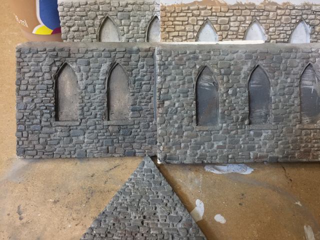

So here is a picture with a few of the walls I've produced playing with different techniques. Over the years I have been coloring plaster castings with acrylic paints and have developed a technique that I like.  My challenge for this build was to take it to the next level with the use of pan pastels and chalks. We have already had some discussion about the results of my first trials. This is picture represents where I'm at tonight.
I took pictures of each step as I made these walls and since this is a build thread I will present them here.
In the picture above the two top walls were done with just acrylic paints.
The three lower castings were done with the same techniques but with two different base coats.  The one on the left, and bottom (with the hip roof) was done with a dark grey primer "rattle can"  followed by a light grey acrylic primer to start.  The one on the left was done starting with a white hydrocal casting with no primer or sealer.
I want the look of the darker stone for this build and like the coloring of the middle left casting the best. Through the next few posts, I will describe the technique in detail and why I like this one the best. We will also discuss a few tweaks to the technique that may give us better results.
ak-milw
Quote from: ak-milw on October 05, 2016, 09:31:32 PM
Either of the two middle ones works for me.
Thanks for the input Andy - I will explain as I describe the technique why I like the one on the left a little better.

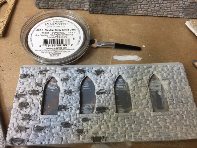

Step 2: Add the acrylic grey primer over the darker primer.  Notice how the darker grey highlights show through.  This is a great base that I can always get back to if I get carried away with the chalks.
Step 3: Start with the Pan Pastels - dark neutral gray to start a few stones.
Here is where we start with the plain white hydrocal casting.
