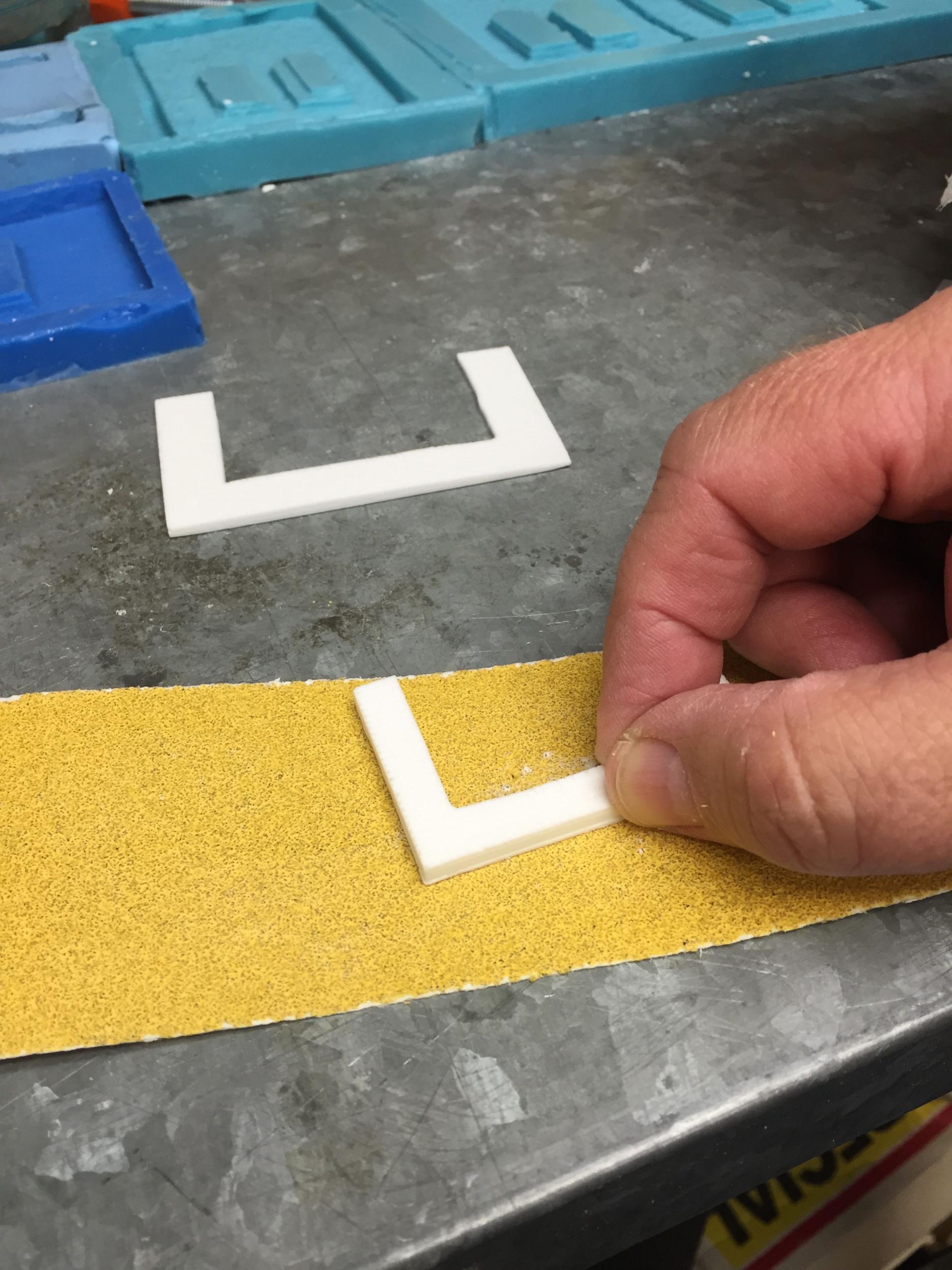

Here is my stop action picture with all the fine plastic dust.  I kept the vacuum cleaner going while I did this. Tip of the day: put the small nozzle on the vacuum so you don't have to go get your casting out of the vacuum cleaner. Yes - that is one of learned the hard way.

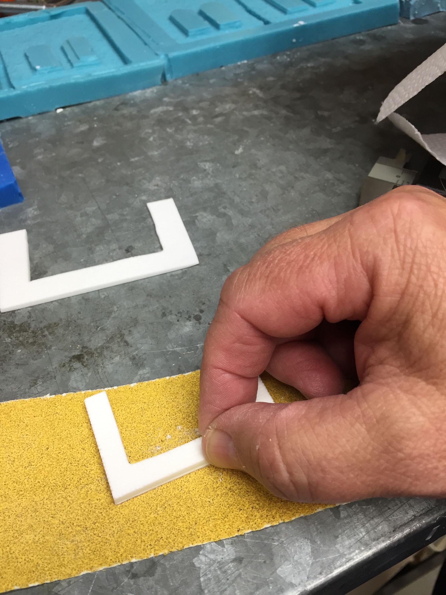

Another tip: This was my first experience at trying to sand resign to size using a process that I've used many times with wood and hydrocal. This plastic material responds very different to the sanding process because of it's low modulus.  You are never sanding the whole bottom at once.  You basically only remove material from the area where you are holding it and putting the downward pressure.
You just have to keep measuring and moving the casting around in your hand to remove material evenly.

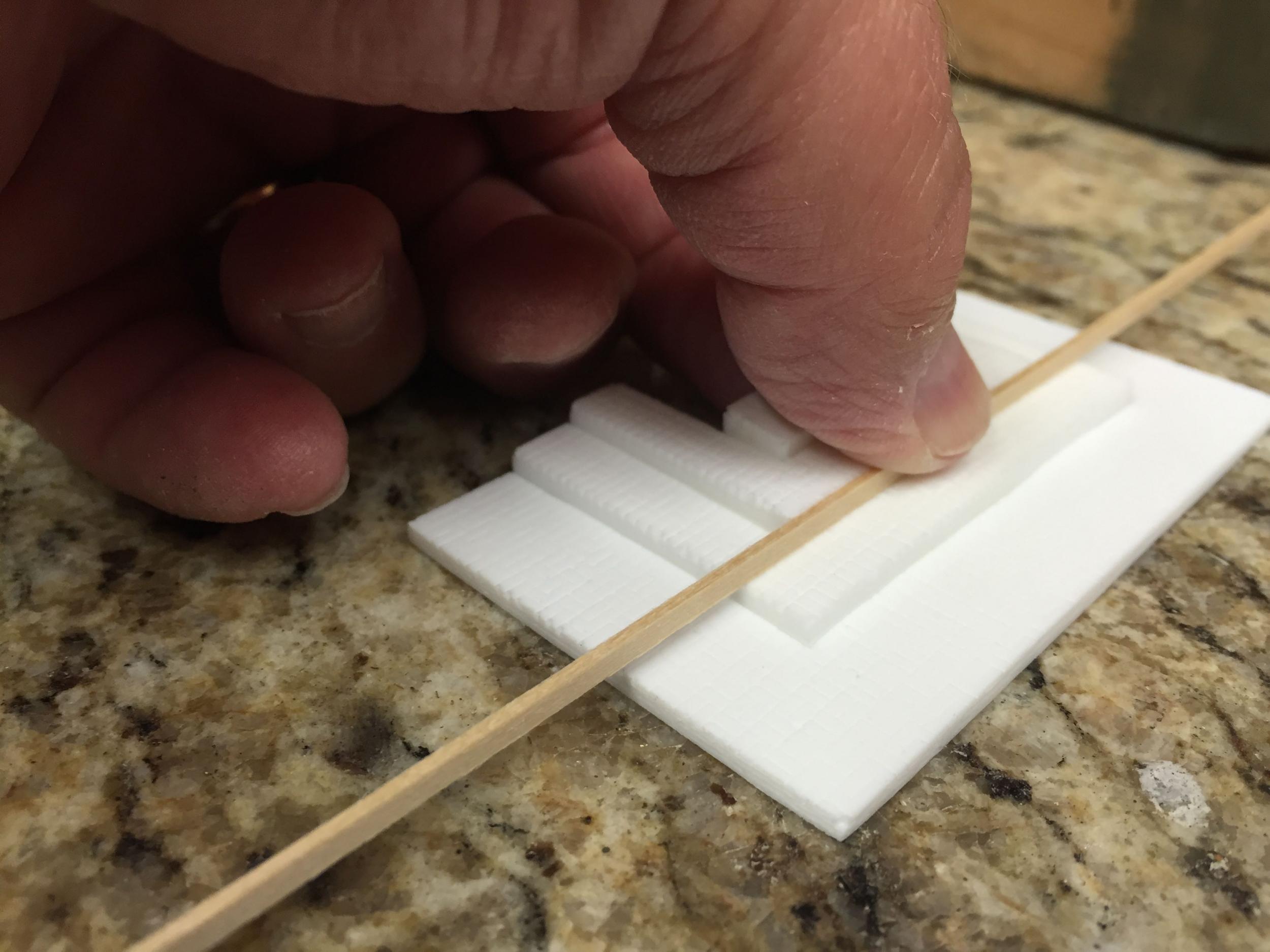

Now for the inspection. We moved the assembly to my granite layout table.  I used my micrometer to make sure I had an 8 inch scale piece of strip wood. I used it to make sure that each step was an even using my now sanded fingers to make sure it was flush on each step.
At this point the step assembly is ready for painting.  I will glue it together on my base for the build once I have the main structure completed.

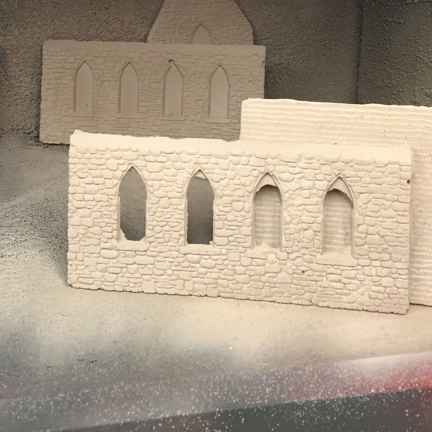

Today, I also primed the test casting so I could start playing with how I want to paint the castings.
I'm starting with a sand primer coat for the main church walls for my first trial.
I want to point out that these are throwaway casting that I made just to test the coloring.  I haven't cleaned them up and if fact choose them because they were defective.

I have been pouring a lot of hydrocal and resin the last few weeks - I had these molds sitting on the workbench and filled them with what ever material was left over from a batch. I'm really not sure how I want to color the stone work on this church and will be trying a number of different techniques.
