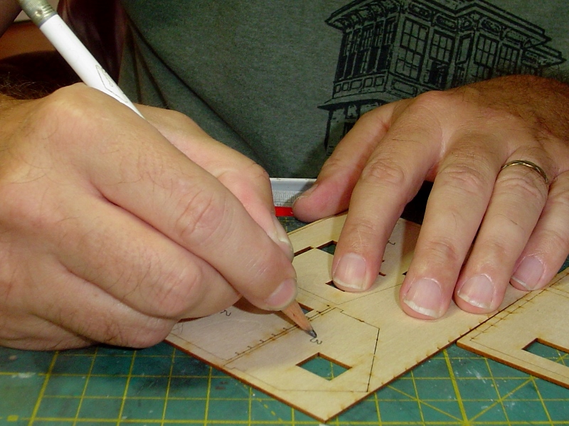

Just to keep track of the walls while referring back to the instructions during bracing I wrote the number (per the templates in the instructions) on the back of each wall in pencil.  This isn't really necessary but it makes things a little easier during certain processes.

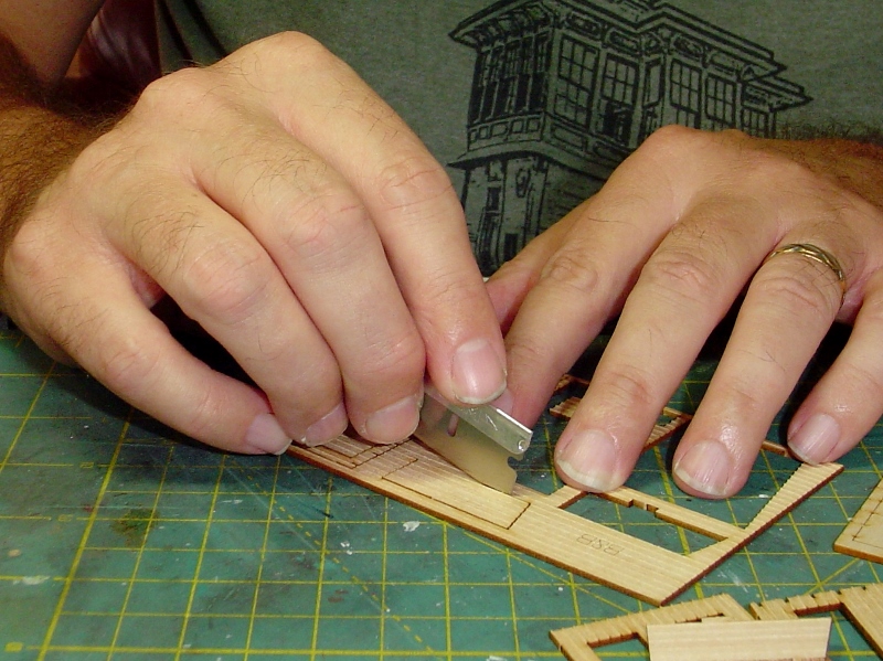

Next I removed the walls from the carrier sheets using my new single edge razor blade.

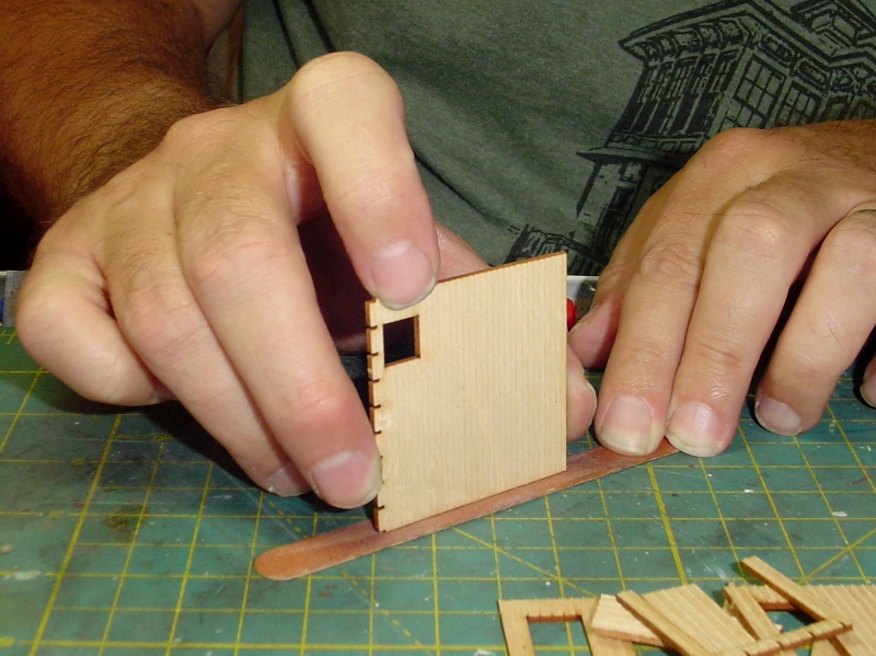

After the walls have been separated from the carrier sheet I lightly sand them on an emery board to 'square up' the edges.

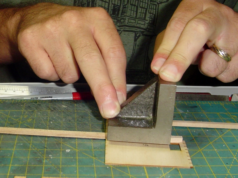

I then started gluing the bracing in place per the templates.  For bracing that runs along the edge of the wall I used a square to make sure I lined it up with the edge and don't have any bracing extending beyond the end of the wall (not that I've ever done that before  ::) ).

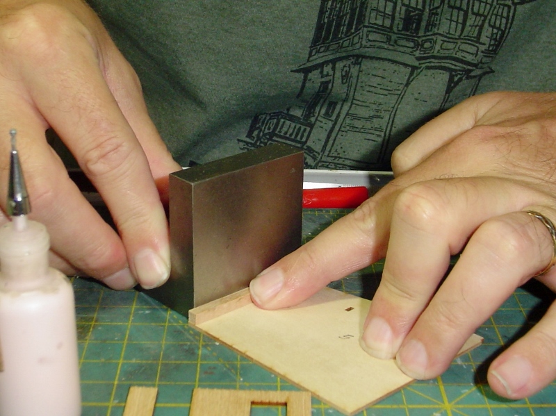

I put some weigh on the bracing to hold in place while the glue sets.

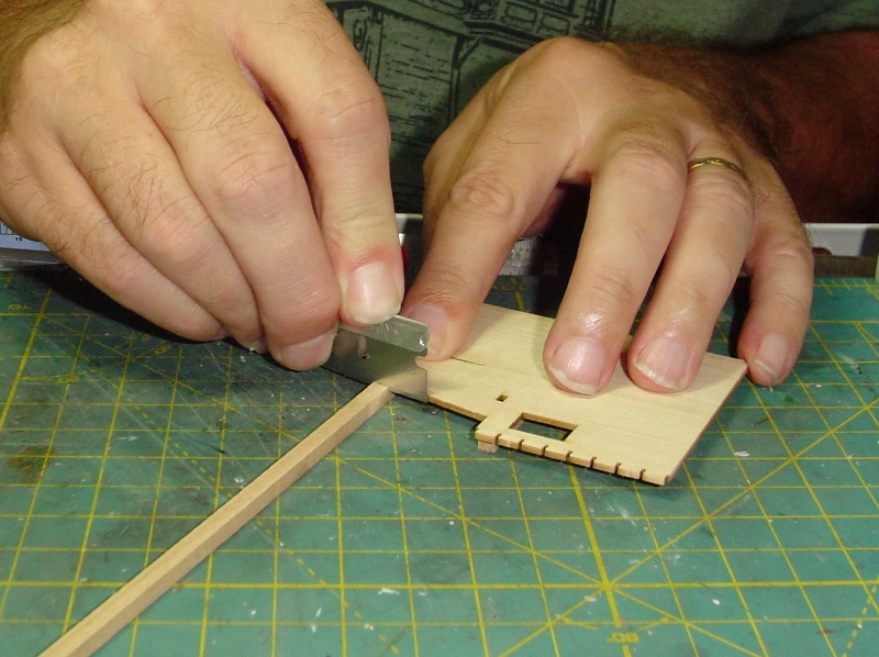

Then I trim the bracing to length using my single edge razor blade.

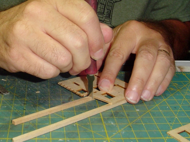

If the wood is too tough or my fingers too sore/weak to effectively cut the bracing with the razor blade I revert a chisel blade in an X-Acto handle for a little be better leverage/grip.

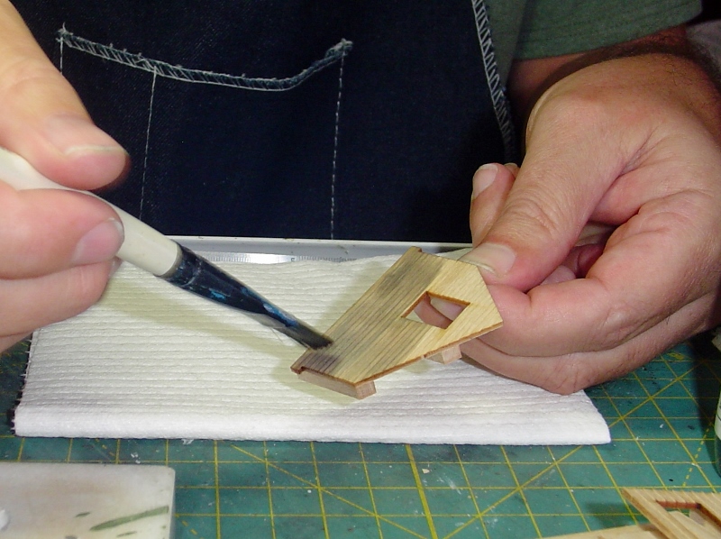

Finally. after the bracing was finished, I applied a light coat of Hunterline Light Gray weathering mix.
