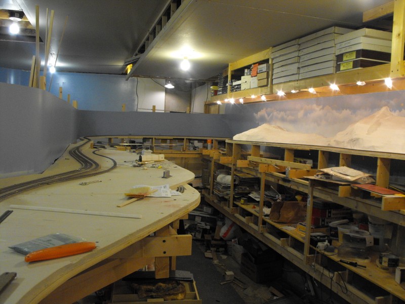

R Edington

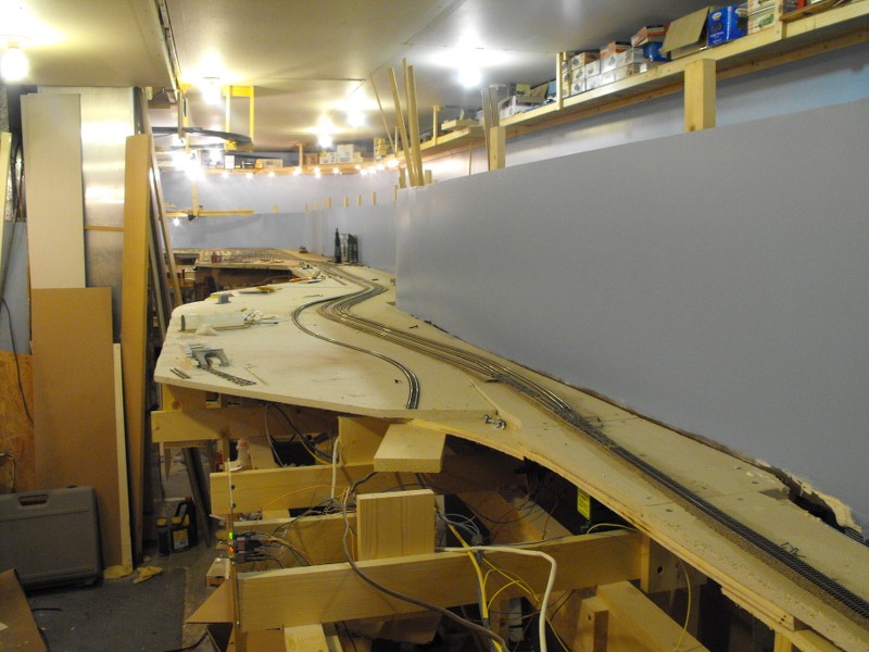

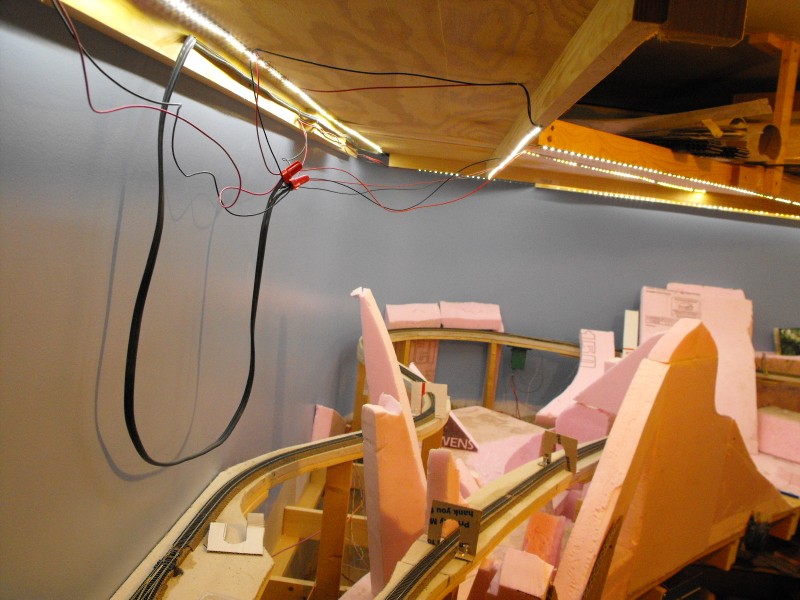

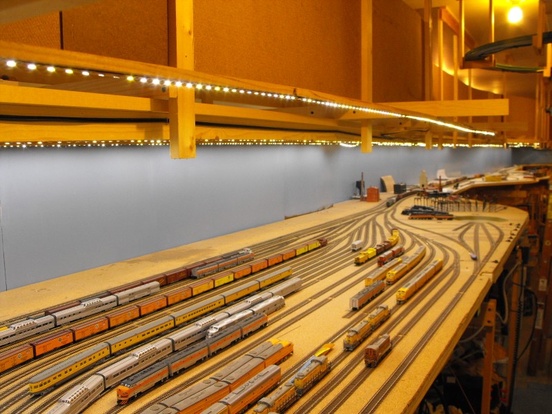

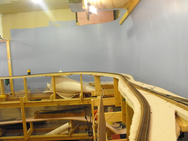

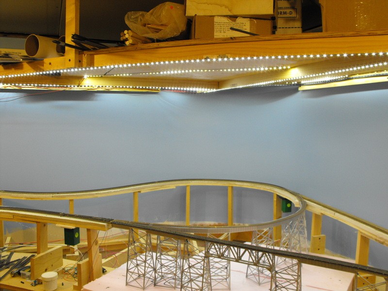

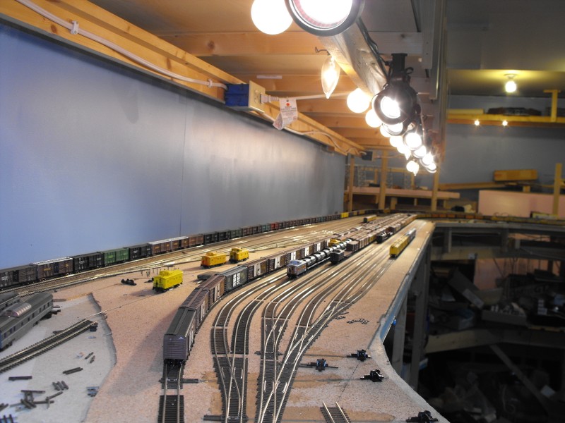

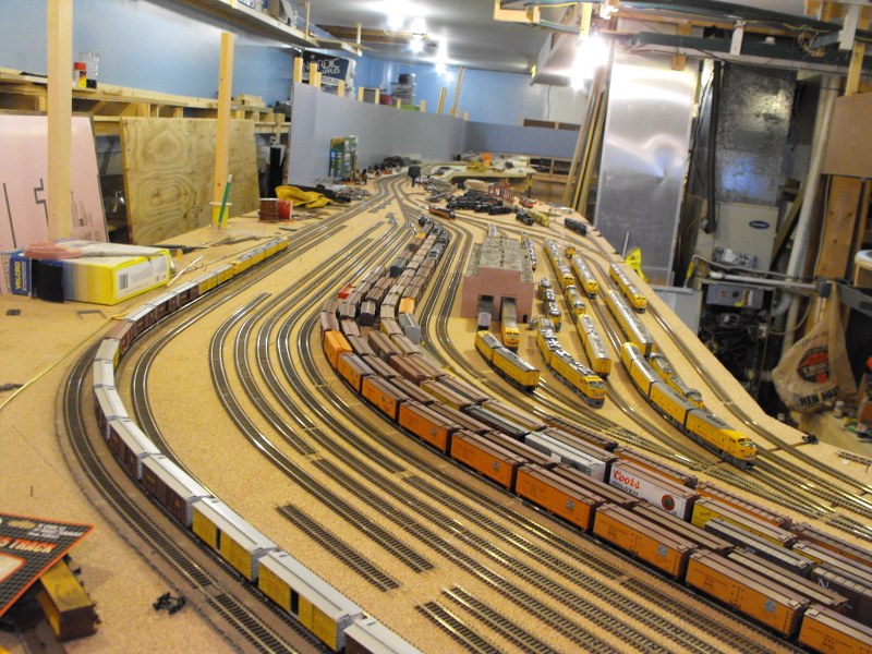

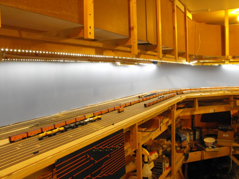

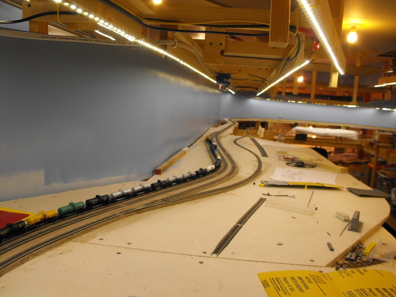

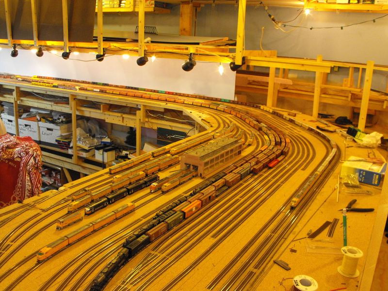

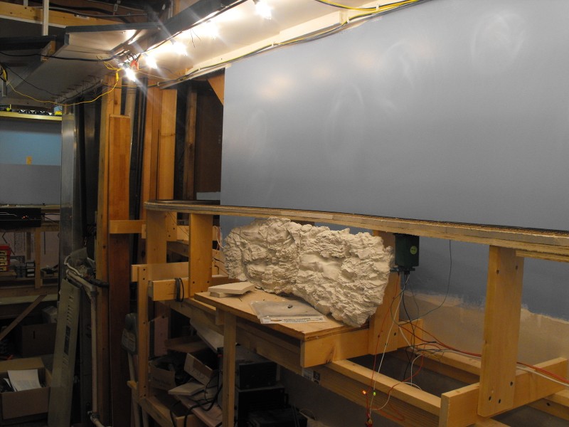

  Here is some more of the yard. Please note that the layout lighting has been changed to all LED's now. In the beginning, I tried a lot of different things for the lighting. Before the LED's, I like the C9, 40 watt incandescent with the spotlights used for outdoor lighting.
And how it looks now
Rodney

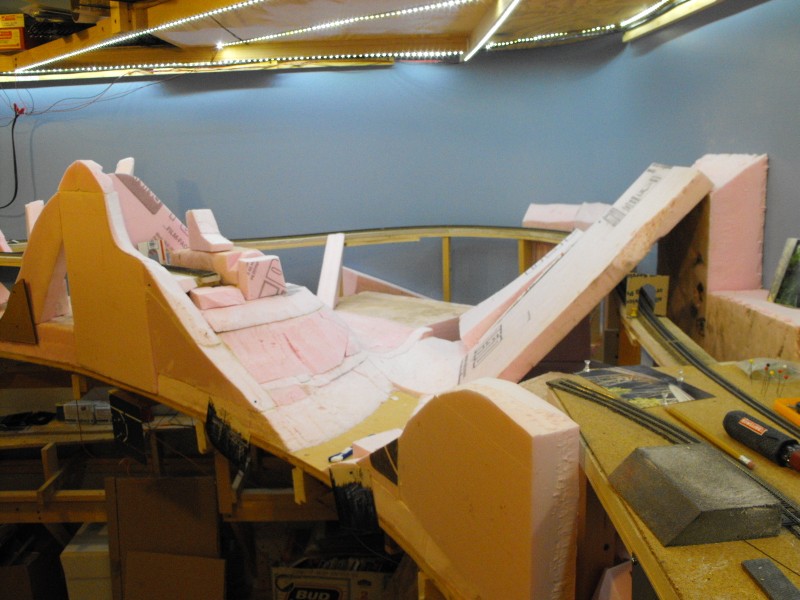

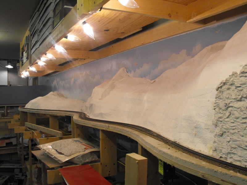

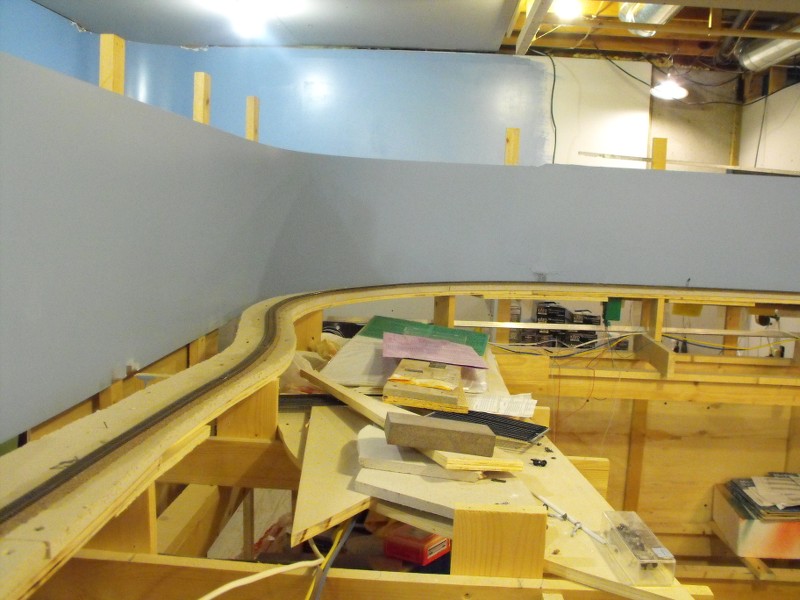

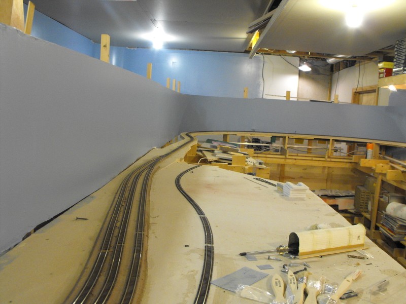

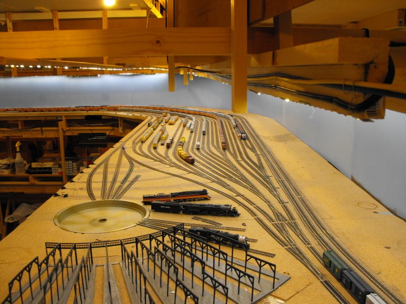

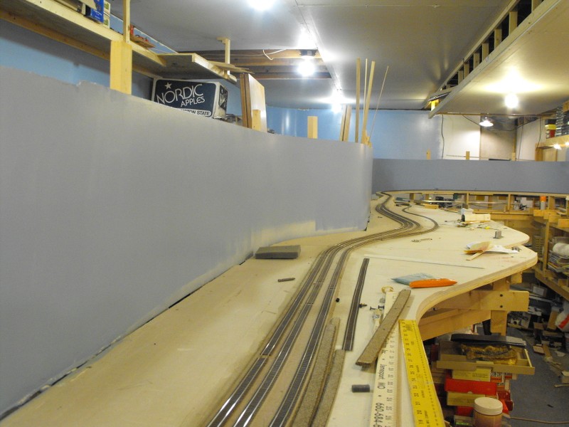

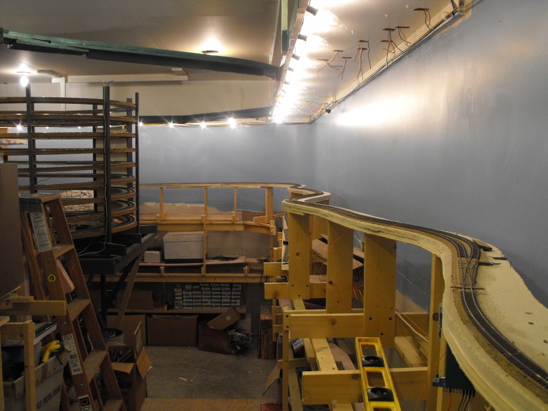

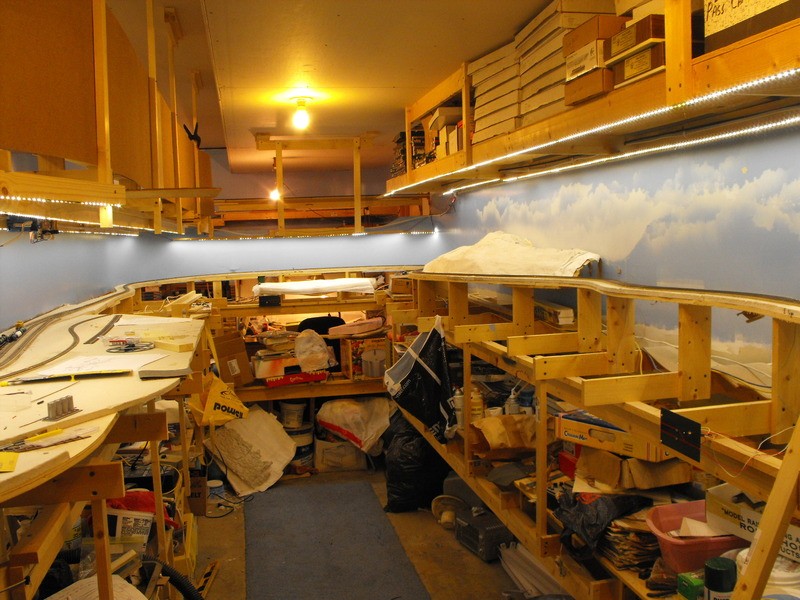

R Edington
  Leaving Oroville
  Looking back toward the yard
Rodney

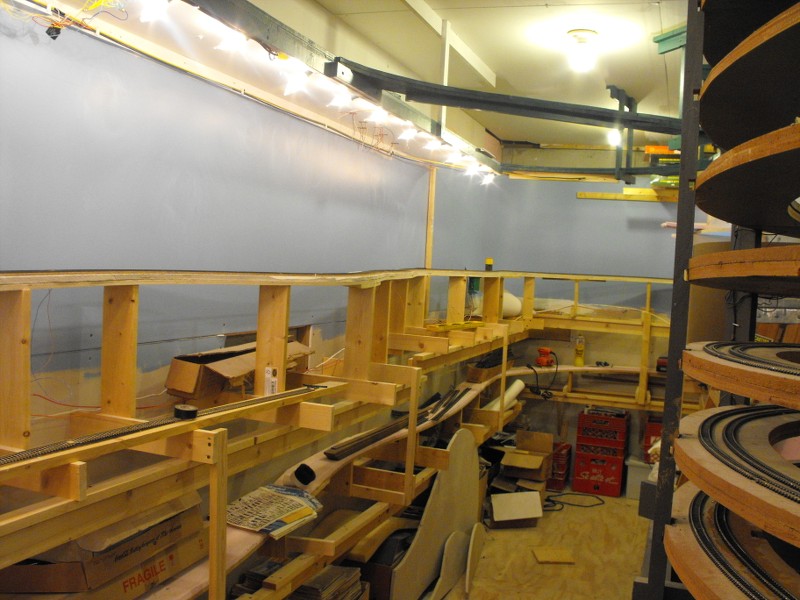

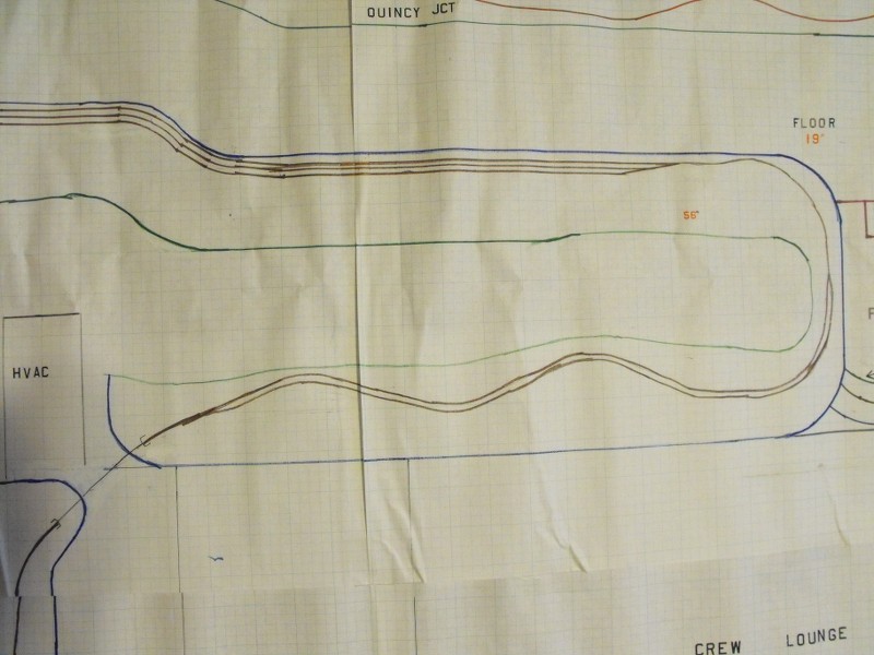

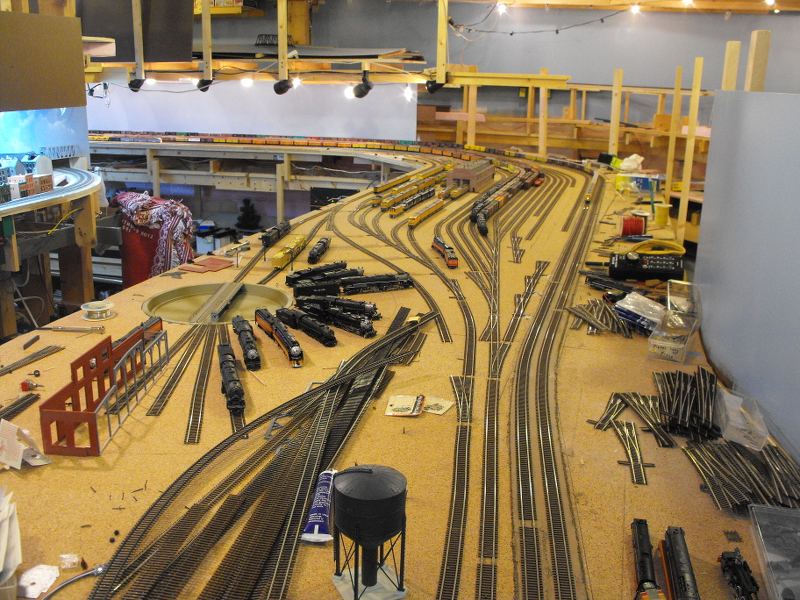

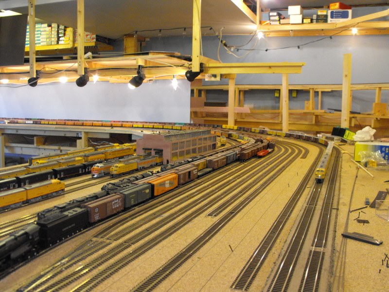

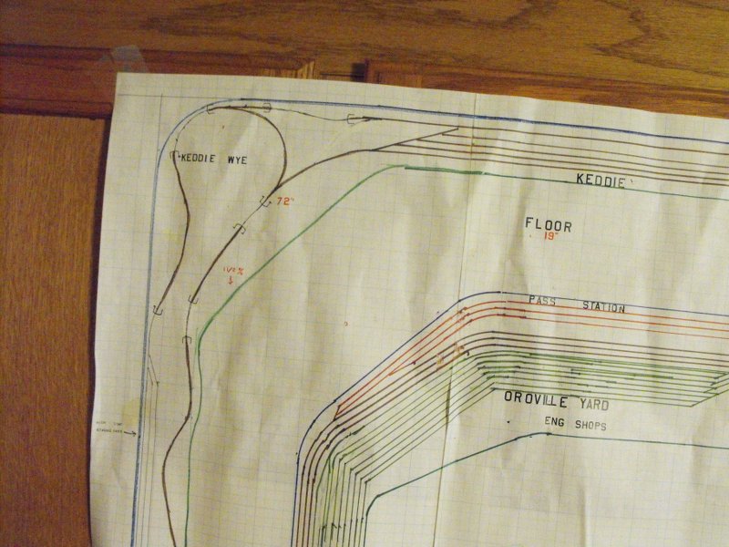

R Edington
#26
   The tracks on the left are the staging tracks for the High line.  The mainline and turnout will be in a tunnel and the yard will also be hidden.
It'll hold 3, 35 car trains
Rodney

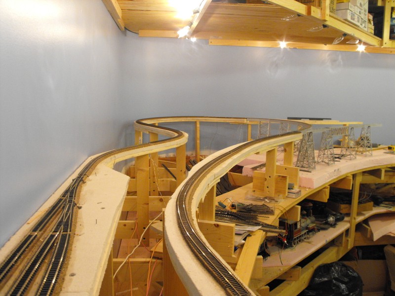

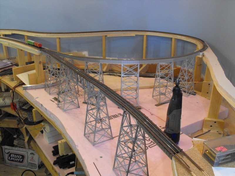

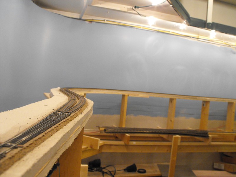

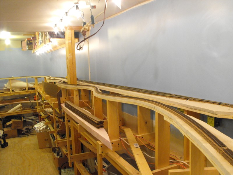

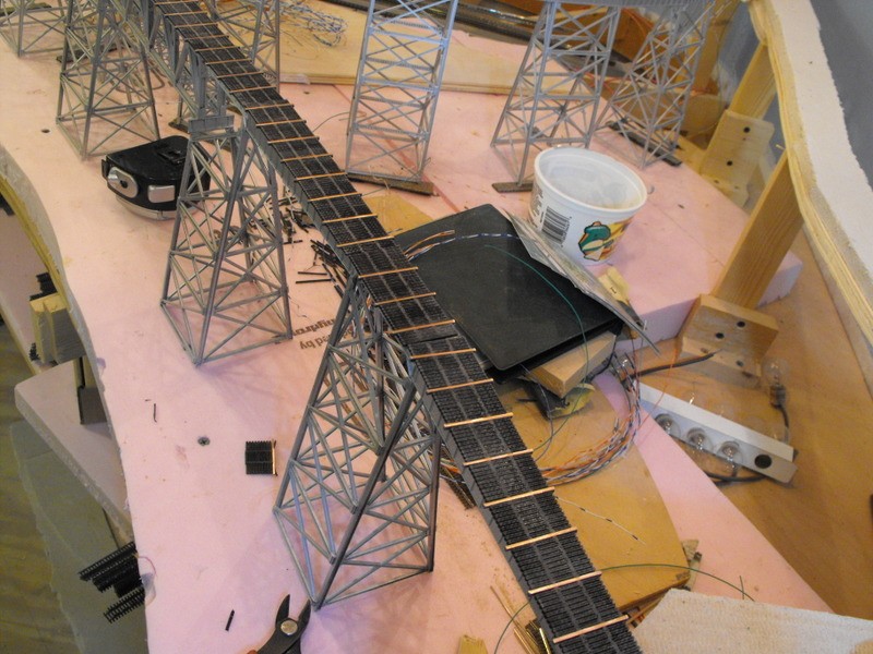

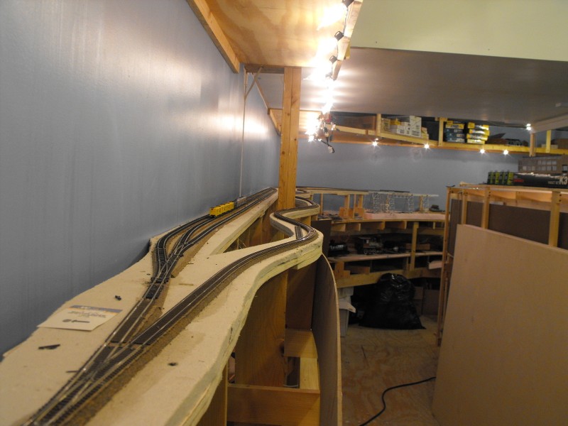

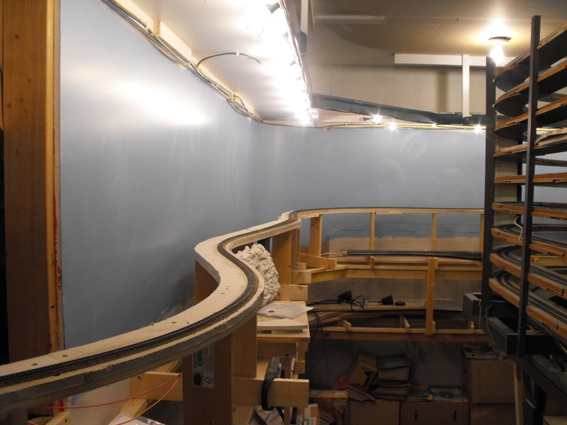

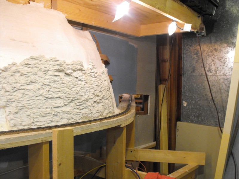

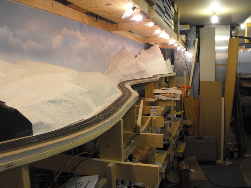

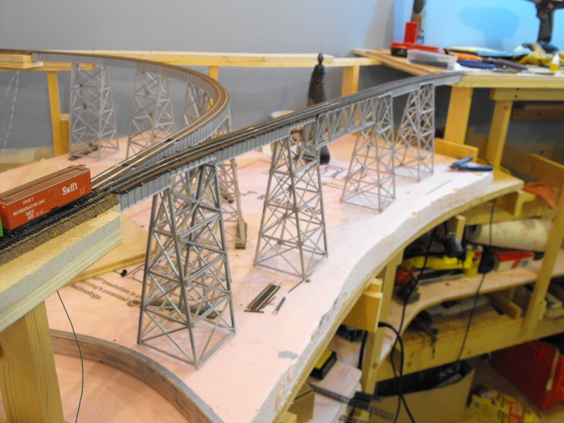

R Edington
#27

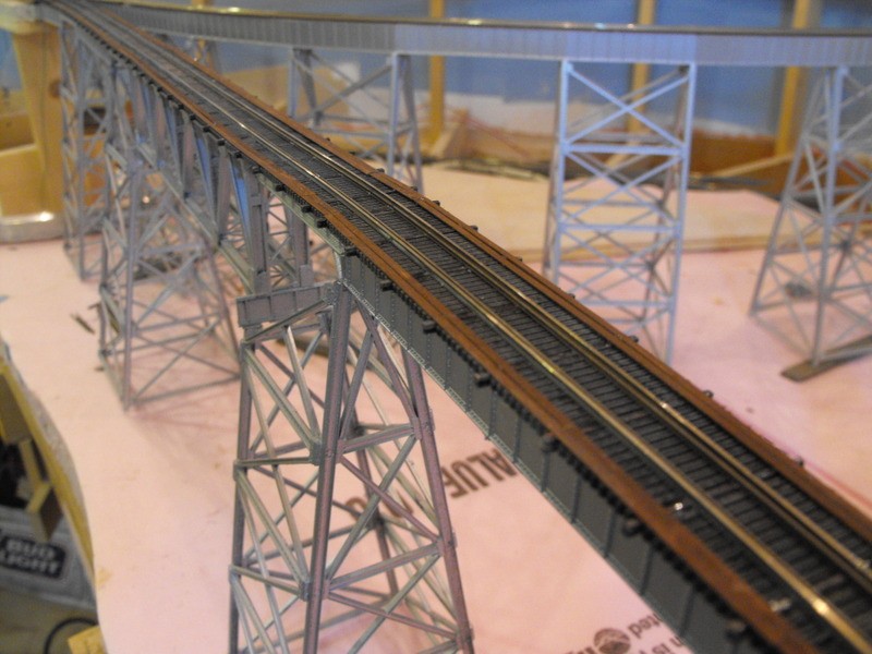

  We are getting close to "Keddie Wye"
  Within the first year and half of start of building the rr, I had all the mainline track laid up to here and when we ran trains, we used the high line side for the reverse loop. With the loop at the bottom of the helix, we could run loop to loop.
The bridges are ME with the parts of a HO bridge bashed into the one on the right.
  The track to the left goes up to Bieber (Ca) and is called the "high line". I'll go into a tunnel to the hidden staging yard for the high line.

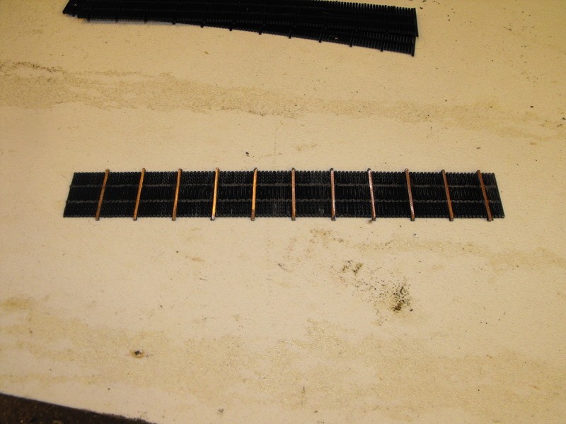

  The tie strips were printed on one of my 3D printers. On the long ties, I've glued PC Board ties and then soldered the code 40 (guard rail) and code 55 rails to that.  Then added the walkways. I still need to do the high line side yet.
Rodney

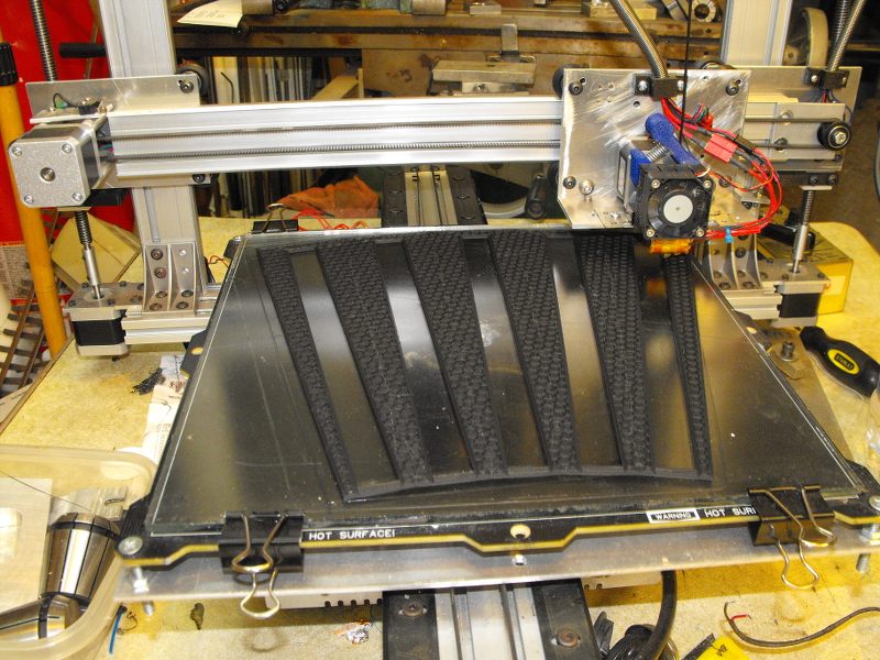

R Edington
  These are the tie strips I printed for the bridges with the pc boards glued on.
Glued onto the bridge and ready for rail.

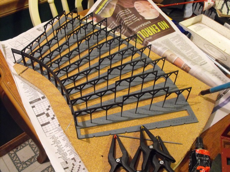

This is one of the 5, 3D printer that I have. This one is capable of printing a 12 inch cube. Since 2012, I've built over 25 3D printers from scratch. The first 19 were 8 inch cube and the last 7 have been the 12 inch ones. I machined all the plate parts on my Bridgeport mill, and the lead screws on one of my lathes. The rail is what is called "makerslide" and the "V" wheels are made of Delrin.
  I'm printing one of the bases for one of the roundhouses that was going to be used on the layout.
Here is the first roundhouse with the framework that I printed. I have since changed the design and still need to print all the parts for the new ones.
Rodney
