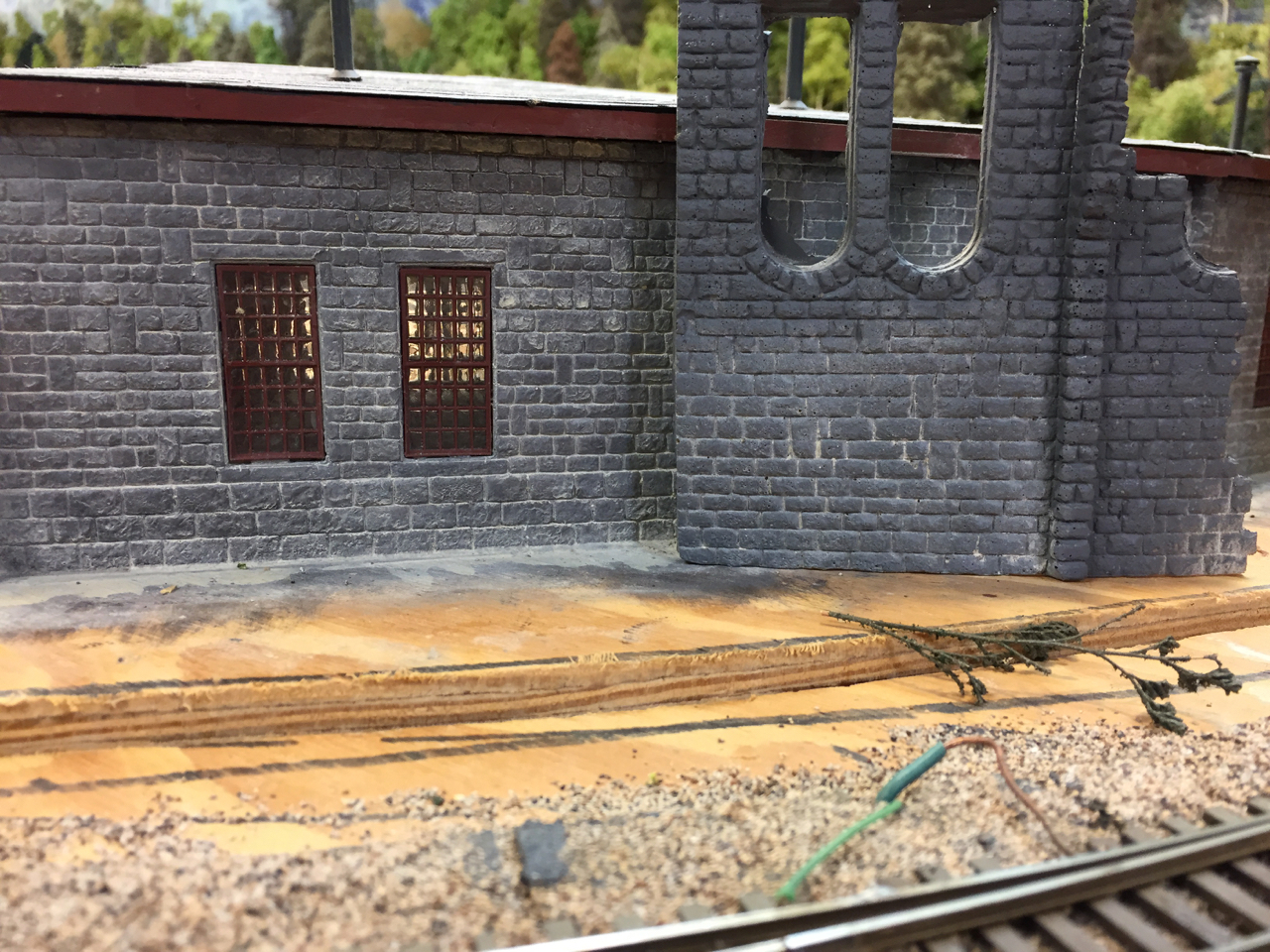

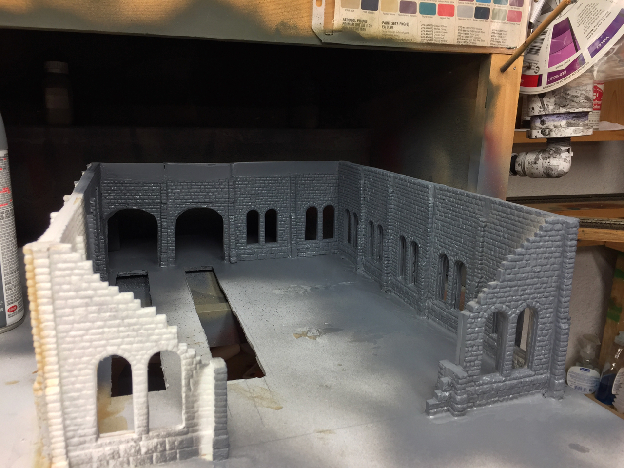

Today, I took a few minutes with the chalks on my test sample to make sure I could get a match of the roundhouse color with my new grey primer.
I think I can get there from here so the Locomotive Works is headed for the paint booth.

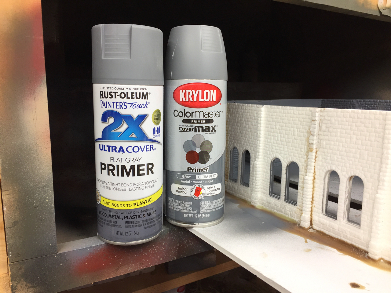

I bought two different primers from two manufactures and could not tell a difference in color.
I took this picture while the paint was still wet and I was waiting for the paint booth fan to catchup with the spray fumes.

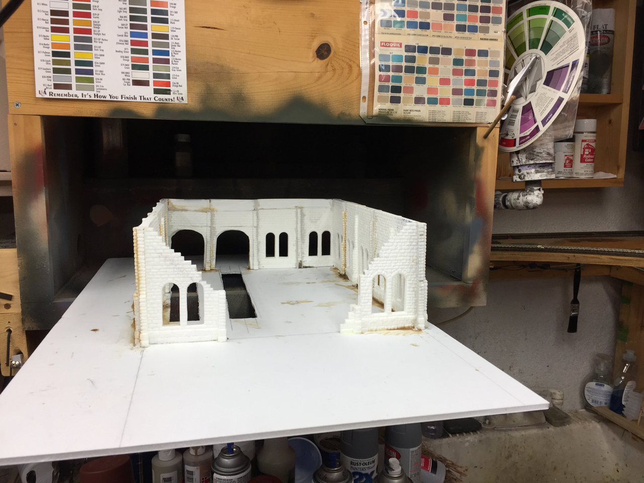

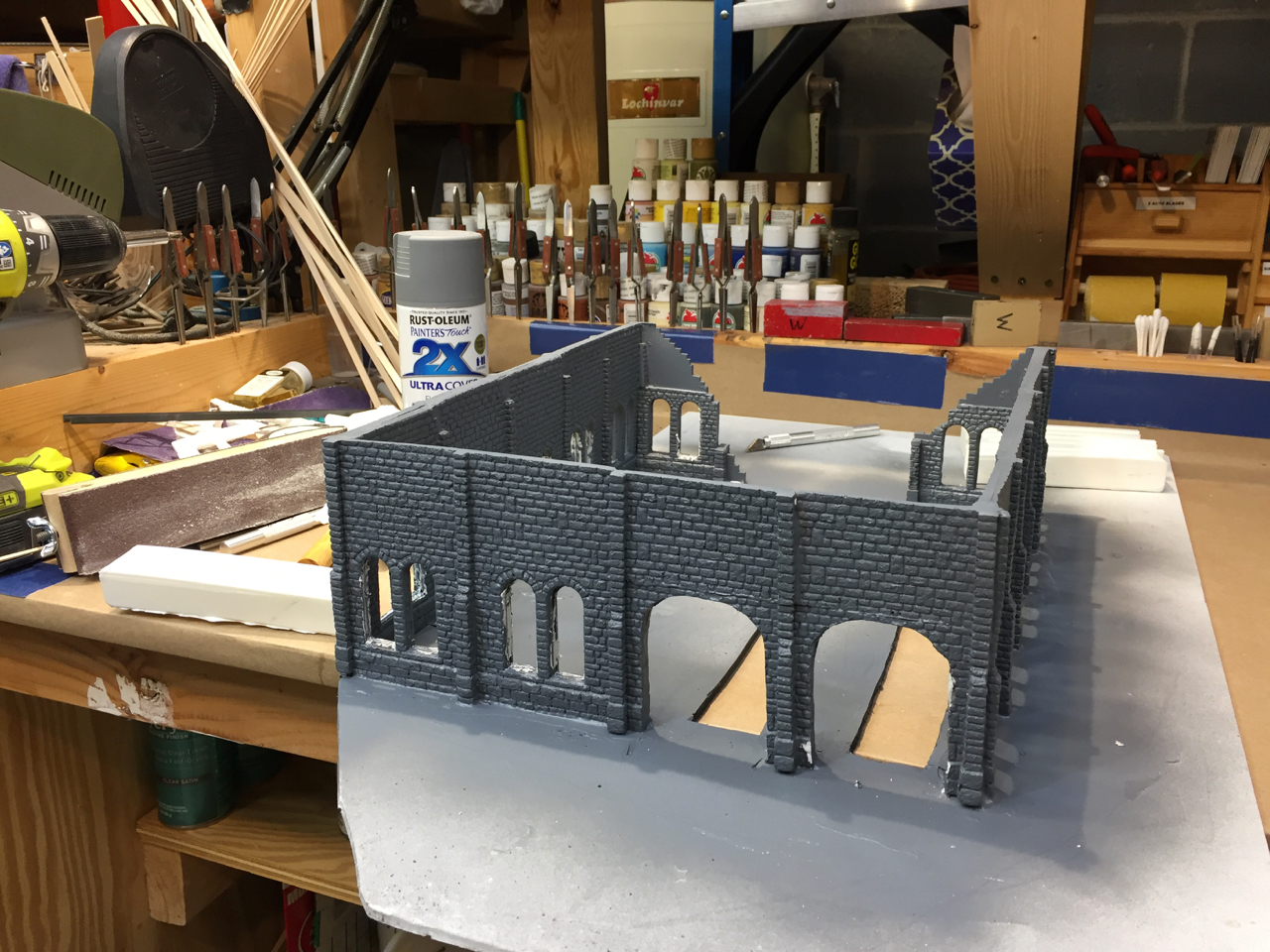

Late in the day the Locomotive Works made it's way back to the workbench for another round of fill and file.  Here are a couple of pictures of this process.  Tomorrow, it will head to the paint booth for the final touchup paint.  This new primer is not what I consider ultra flat like it says on the can but the chalks will solve that problem.
The seam on the front castings will be covered by the wood sign that will be across the front of the building.
I had some gaps between the two wall castings in some areas that showed in the window openings. The problem was solved with some filler putty.

Quote from: S&S RR on December 15, 2017, 07:25:32 PM
Looking very nice John and will compliment the roundhouse extremely well.  With regards to the "sheen" from your primer coat, you could also top that with dull-coat or ultra-flat which would also add some "tooth" for your application of chalks, etc...   Just a suggestion and look forward to seeing you bring this to life.
All the best and I'll be following along,
--Paul

Quote from: PaulS on December 15, 2017, 09:20:37 PM
--Paul
Paul
Thanks for stopping by the thread and for the suggestion - I will see what it looks like in the morning and will probably give it a quote of dull-coat, as you suggested.
