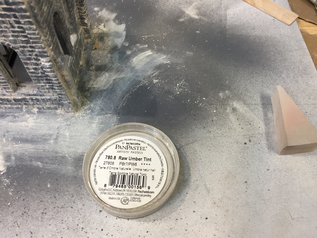

Today, I went back to working on the walls of the Locomotive Works. The primer had a couple days to dry so it was time to start adding the chalks.

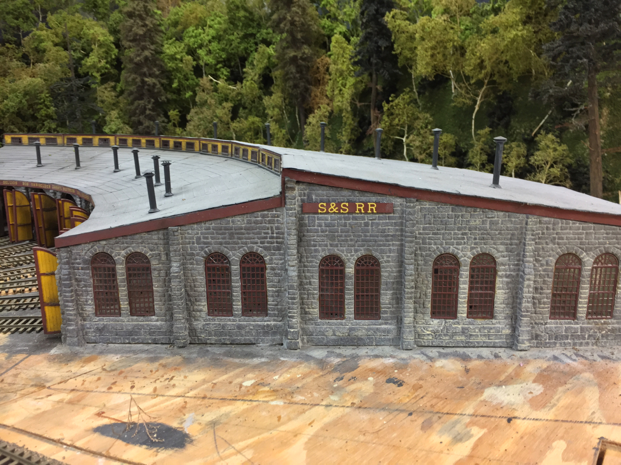

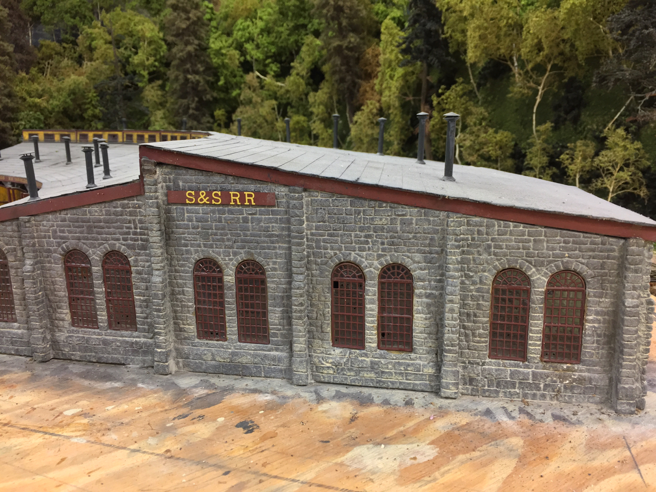

Since this is the companion building for the Stone Roundhouse.  I thought I would post a couple pictures of the Roundhouse wall that will be closest to the locomotive works for a color comparison.
The highlight color and mortar color that I will be using is the PanPastel color Raw Umber Tint.

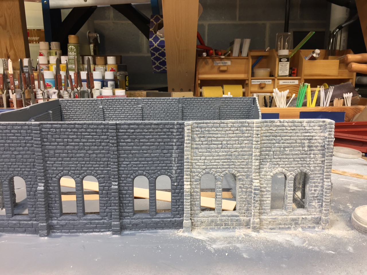

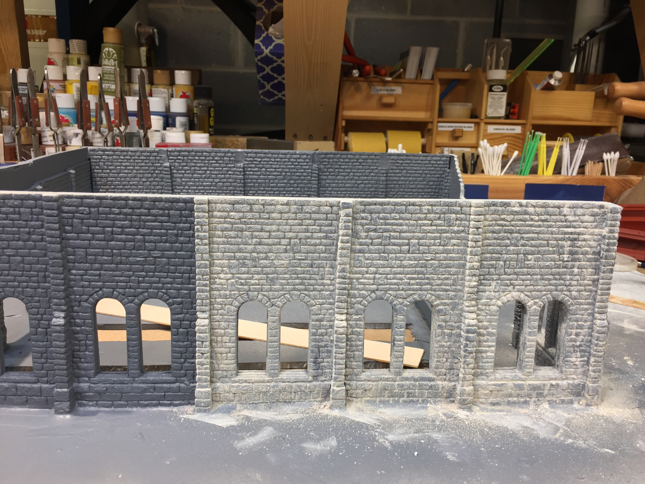

I started with a traditional application of the pastel chalk using a sponge applicator.
In this picture the left wall section has just the sponge application and the right side has the start of the second application of chalk. In the second application I fill the deep mortar joints, air holes, and deep stone formations that didn't get a good coat of chalk with a small paint brush and an alcohol and chalk mix.

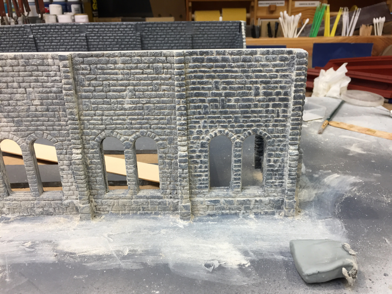

Here is a process picture in the ReadingBob tradition of the process.  I just add fresh alcohol to the palette every time I need to go to the small paint brush.
This process is repeated all the way around the structure.  In this case both inside and out.
The final step in the process is to erase some of the color off the face of the stones to get some of the gray back.
