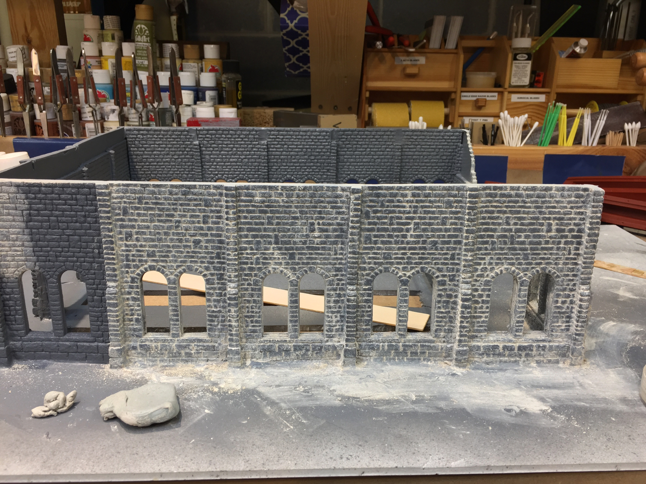

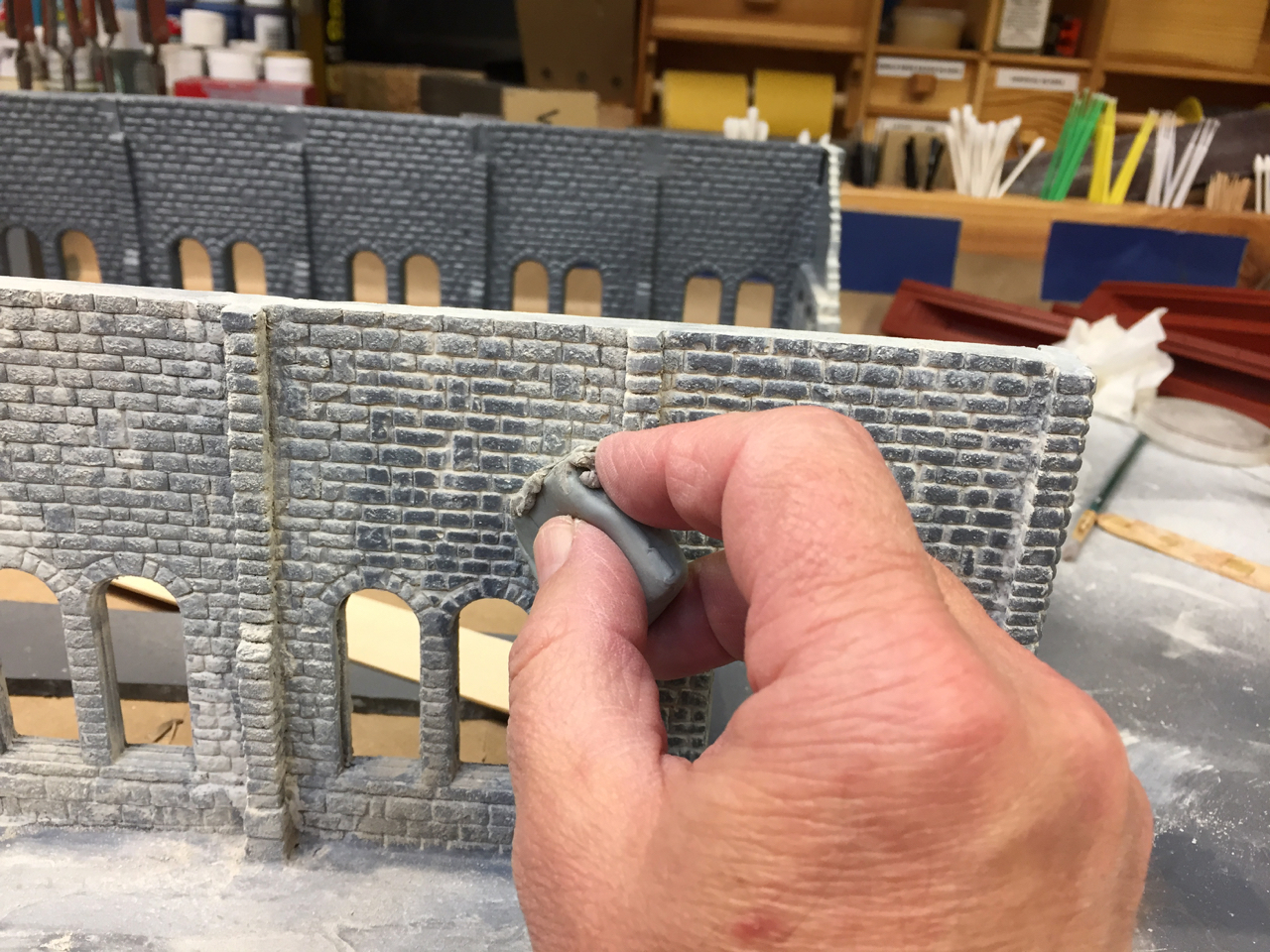

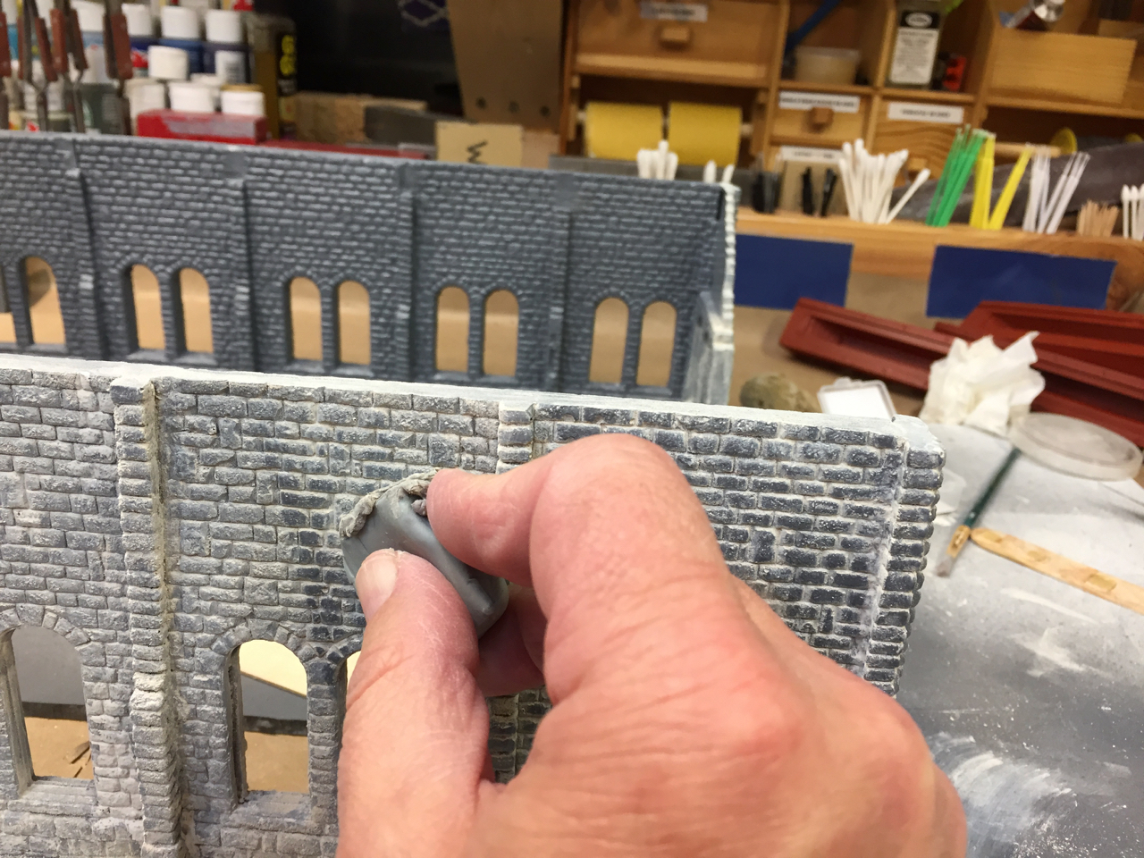

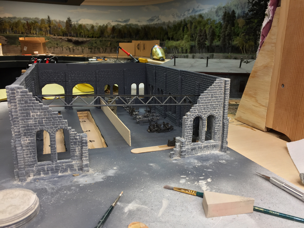

Here are a few pictures of what it looks like as you do the erasing process.  You can see the eraser I used in the picture.  It is a real soft gummy eraser.
Here is what it looked like after the first four section where complete.
Compare this to the Stone Roundhouse pictures.

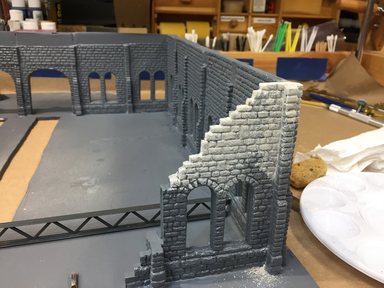

The wall can be made darker by doing more erasing. Basically letting more of the dark gray to show through.

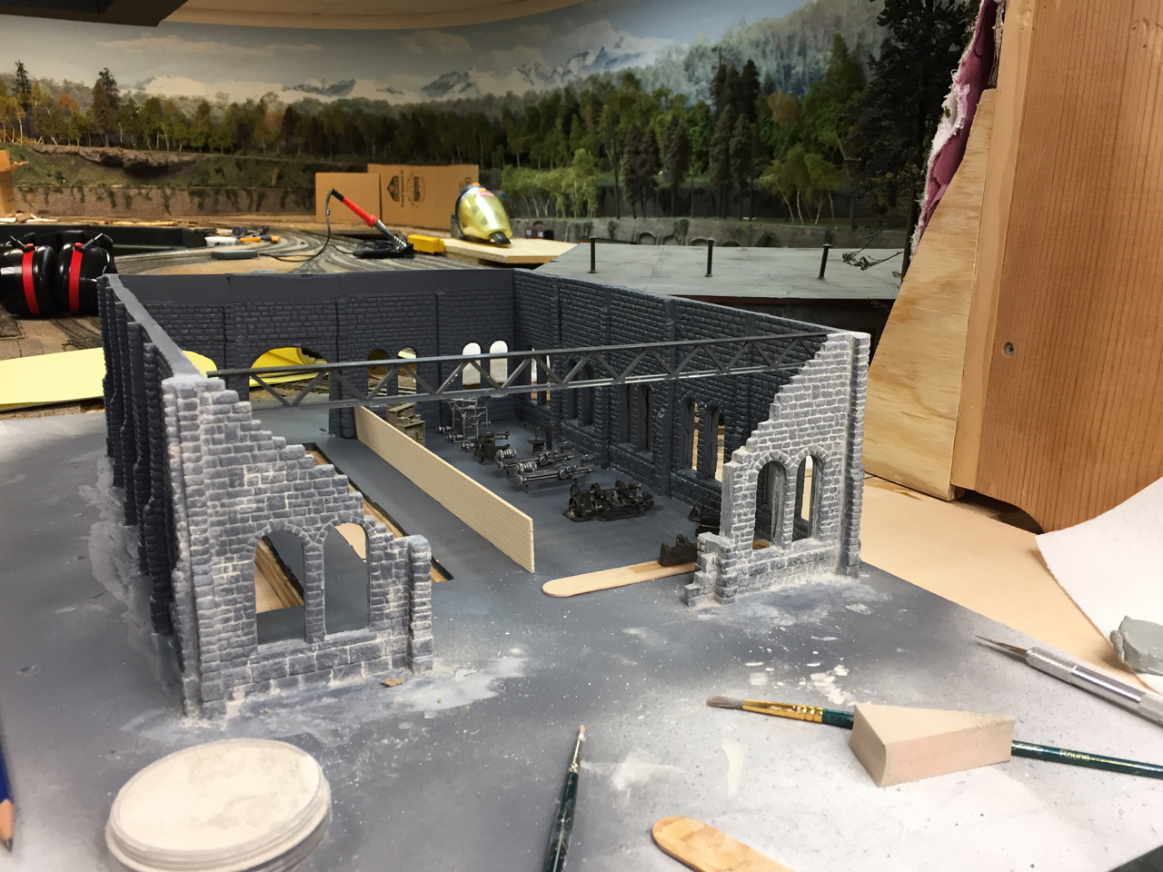

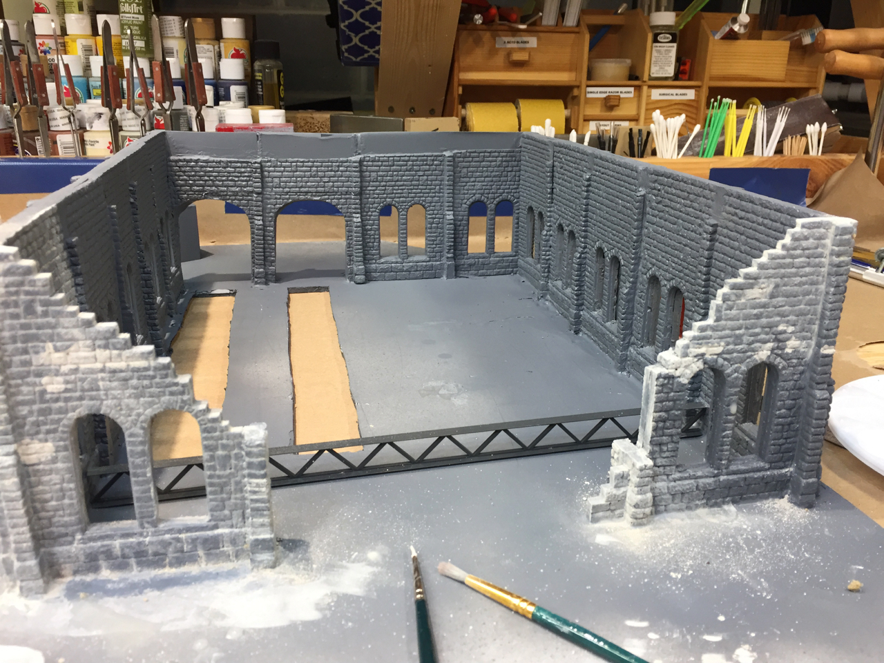

I also moved the structure to it's permanent location on the layout to check the color and do some machine layout work.  I wanted some pictures with a few of the machines set in various locations, to put in the iPad.  I want to play with different interior design ideas.  Right now the left side of the building, where the inspections pits are, will have a brick floor.  The right side will have a wood floor.  A 11 foot wall, is planned, to separate the two areas. I have a lot of details to work out so sketching in the iPad will be a good way for me to spend any down time I have over the holidays.
I should mention that Slim is working on some LED lights that will be lighting up the interior of this building.  I also purchased some goose neck lights for the outside at the EXPO.

Thanks for the kind words.  I thick we achieved a match to what I did on the Roundhouse.  I will be adding a few more colors of chalk once I get it on the layout and detailed. A little smoke here, and a little rust there, and even some mold just to make it look more realistic.
