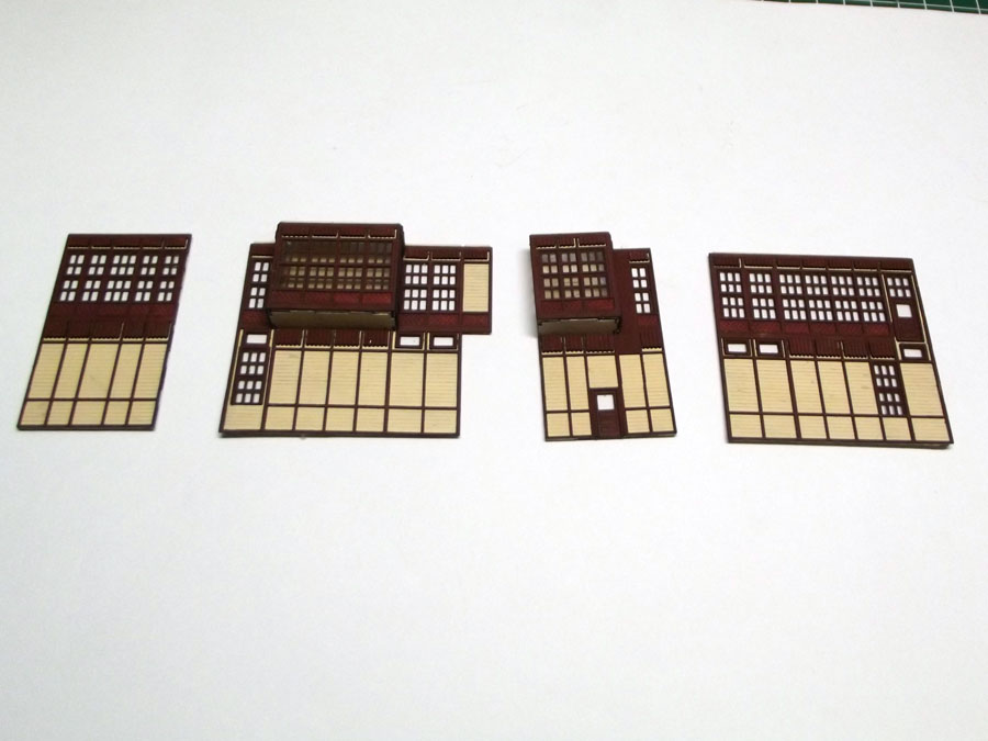

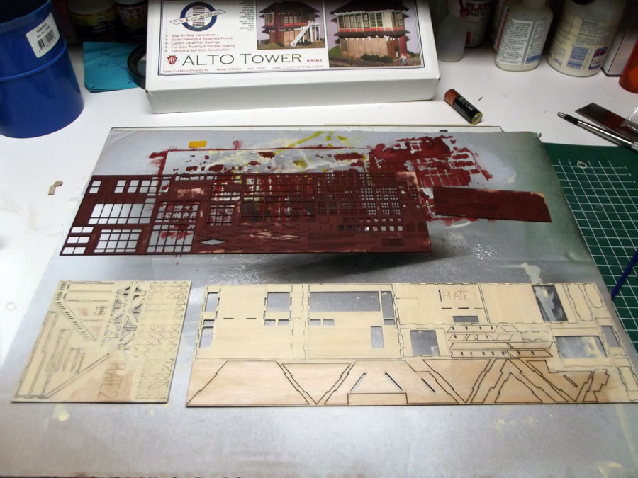

The kit comes in a sturdy box, essential because the parts are really fragile. The structure is prototypical for the Pennsylvania RR but I like it so much on my layout it will be the tower for the Rock Island yard at Clay Center.

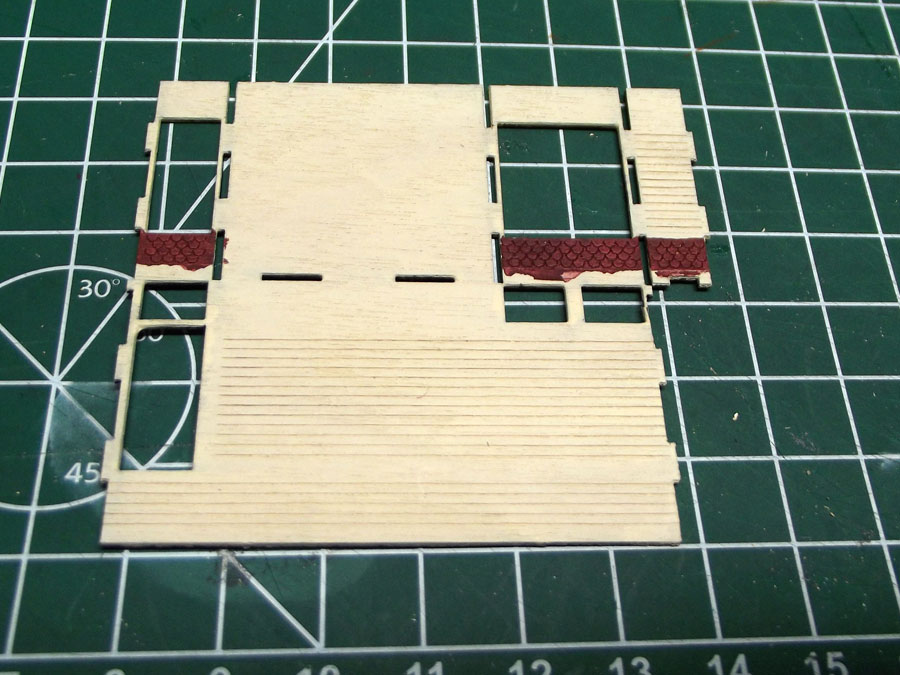

Painted in Rock Island Maroon and DRGW Cream, the walls are lasercut wood, the trims , doors and windows are lasercut with peel and stick backing ( very useful in N-scale ).
The shingles on the side painted Maroon , I used masking tape but it bled through, not a problem because the part that bled through will be covered by trim.

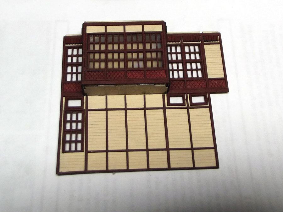

All the trim parts and doors and windows.

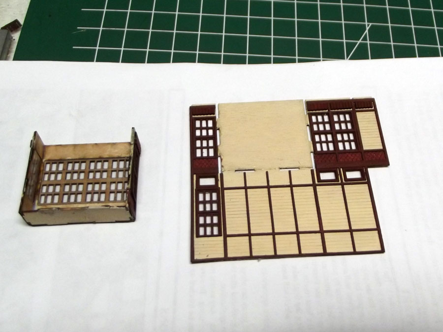

It takes a bit of patience but the trimming in place gives a nice result.
The 3 pieces that make up the overhang.
Glued together with the floor installed , let to dry.
While the glue on the overhang dried I made up an other wall.
Overhang installed on the first wall.

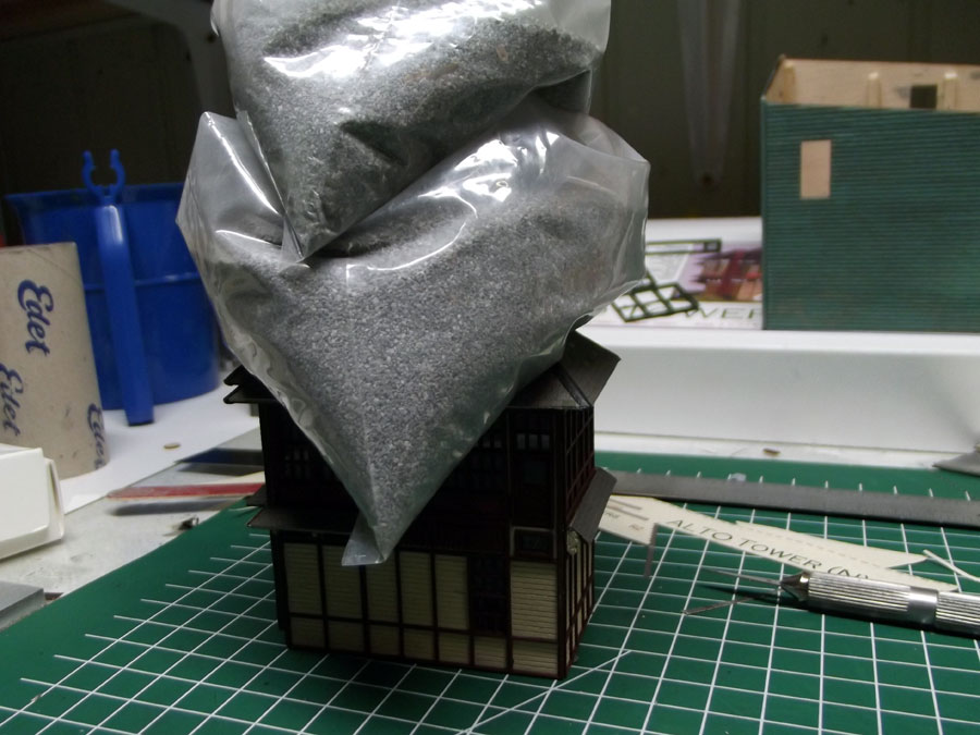

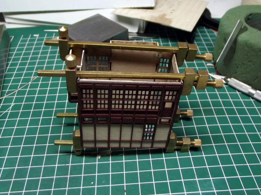

Assembling the 4 walls.

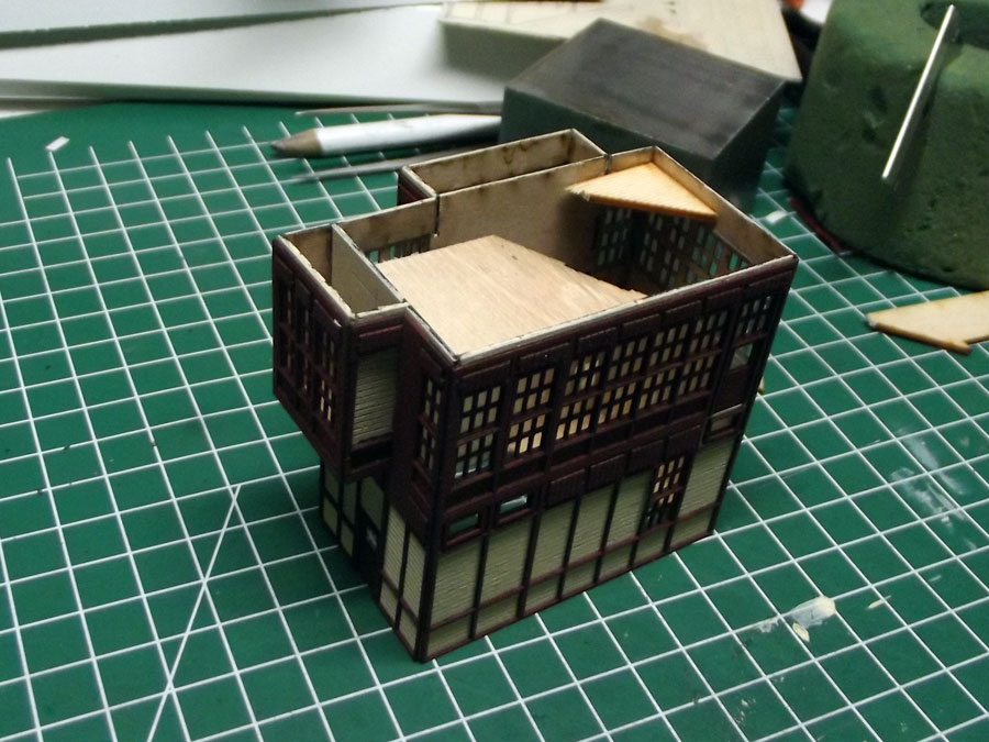

Roof assembly, using my magnetic tray and steel blocks to keep it square.
4 walls assembled and some triangles to help keep square added in the corners.

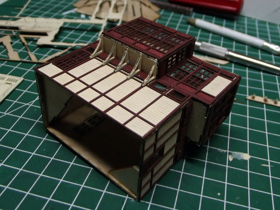

Did some more today

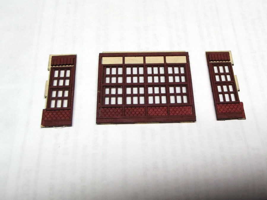

Glued the brackets under the bay windows.
And under the overhanging roof parts.

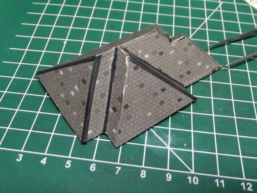

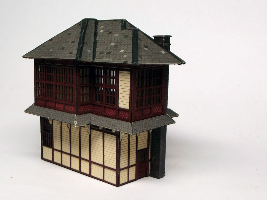

Started shingling the roof with the printed shingle parts, not sure I will keep this , I think better shingles or tar paper roofing would look better.
Looking good Jan!
My N Scale Architect Ferry Slip is also a great N scale model and uses the same printed shingles. They came out okay with a lot of random coloring and chalk weathering, but very 2D. If I was doing it over, I'd definitely swap out the roofing for some shingles. In my opinion, good roofing really makes those little N scale structures "pop".
Thanks John , I'm going to see how the roof comes out when weathered and then decide.

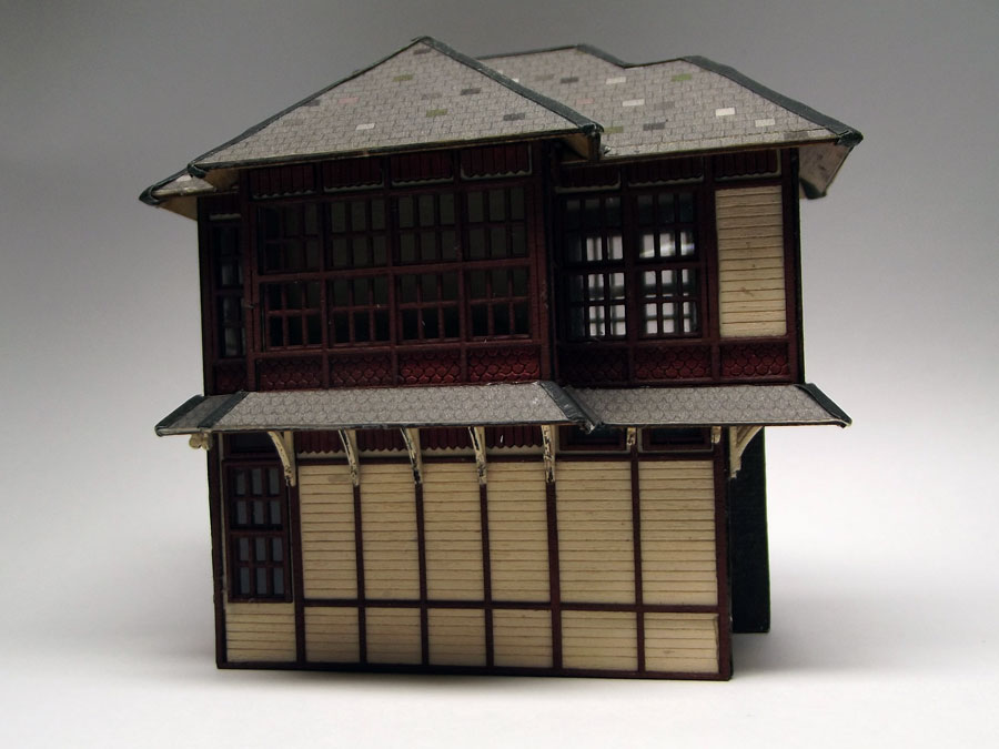

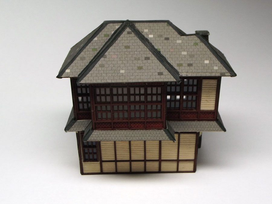

Finishing off the overhanging roof.

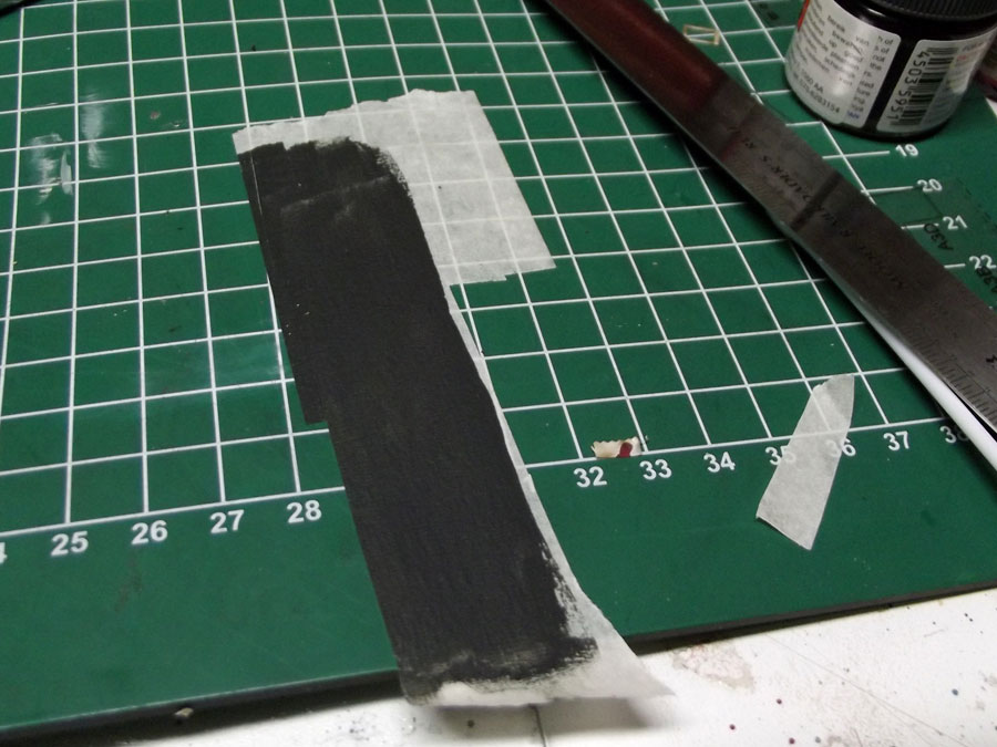

Instead of using the roof caps and gutters in the kit ( they have to be glued and are to small to do that neatly ) , I painted a piece of masking tape Tamiya Nato Black and cut strips off that.
Much easier to apply and looks just as good. I will touch up everything afterwards.
The same tape fixed to the overhang.
The printed overhang roofing applied.

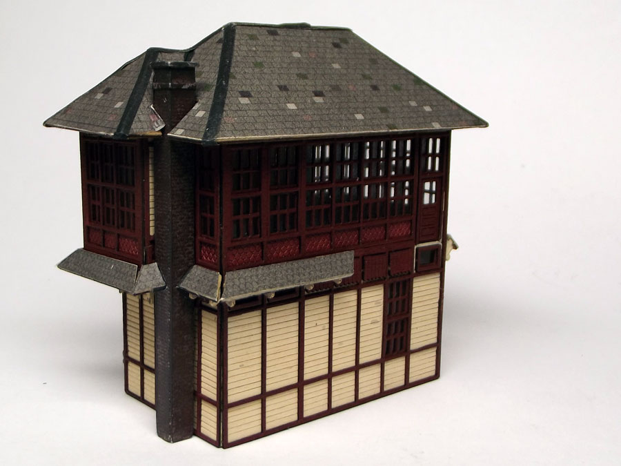

Roof assembled.
This is how it looks before the caps on the overhang.
And this is after the caps on the overhang are applied., covers up the gaps quite nicely.
The close ups show exactly what needs to be touched up.
