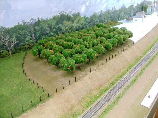

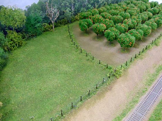

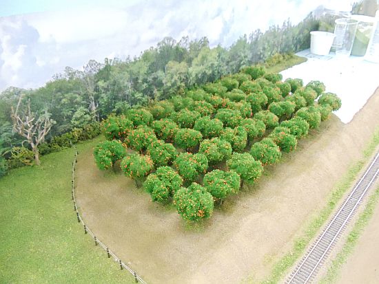

Over the past several days I also installed a fence around the grove area and farm land.

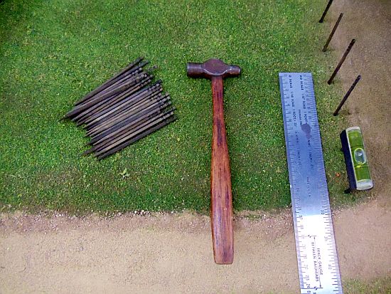

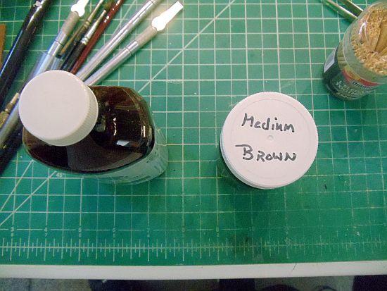

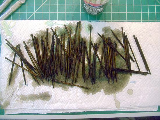

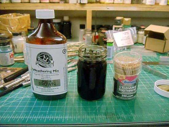

I started by using the tooth picks without cutting them to length. I poured some Hunterline A&I Medium Brown stain in a small jar. Fifty toothpicks were put in the bottle for 20 minutes.
I labeled the jar so I would know what was in it. If not, in a few days I would have no clue.
After twenty minutes I removed the toothpicks, er, I mean fence posts. I let them dry on a paper towel for an hour.

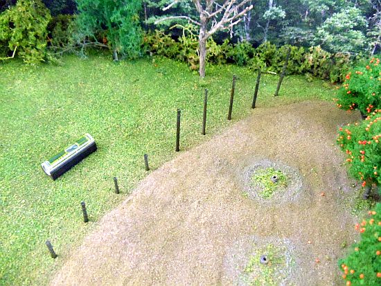

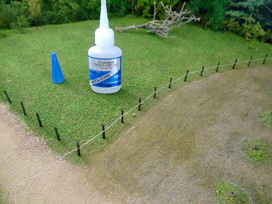

I pushed the fence posts into the foam and used a small level to make sure they were all level. The posts are 4 HO scale feet in height and spaced 8 scale feet apart.
They kind of look like the start of Trump's wall. 8)

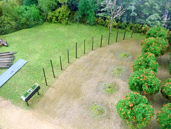

Once the fence posts holes was dug, I used my little hammer to pound them into the ground/foam. The little hammer is the only tool I have left out of my "Handy Andy" tool set from 1950.
I'm getting there.

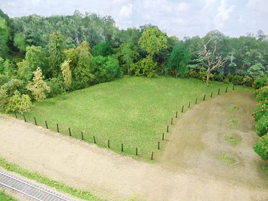

Fence posts are now in place.

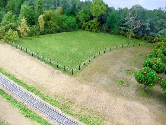

I used tan thread for the barbed wire.
Fence barbed wire finished. I stained the thread with Hunterline Rust.

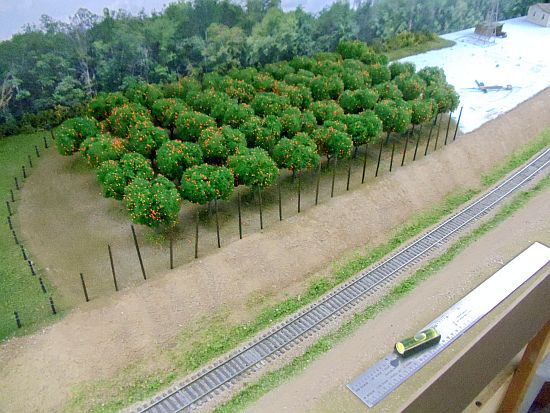

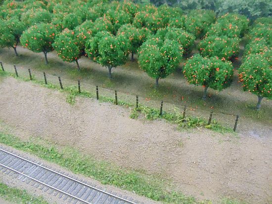

I decided to run a fence line down the front of the orange grove. I used 22 fence posts and only added them to the edge of the current grove. I'll continue the fence once the rest of the orange trees are installed.
Fence posts are installed and barbed wire is added and stained.
In all the groves I've been in, both legally and illegally, I've never seen the fence line void of weeds. Time to add weeds to this fence line.
