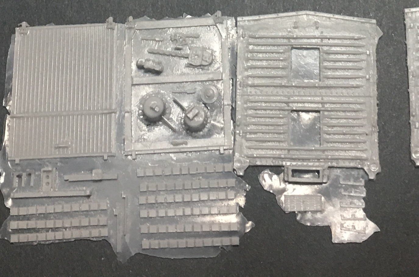

I thought I'd cover the process I use to build a flat-sided resin freight car kit, in this case a boxcar, and document it here. I also plan to document this same process over on my steam era freight car blog.
In keeping with the first post for any build tradition, here's the assortment of parts you find when you remove them from the box. This is fairly typical of a resin freight car - although this particular car has some additional parts not usually found in a standard boxcar kit.
You'll notice in the closeup image below, things like the gear mounting for the brakewheel, and the cylinders are included in the resin "sheet" - rather than mess around with trying to clean up the resin around these parts I usually replace them with aftermarket detail parts.
In another section, you'll notice the ladders/grabs are also included in the resin sheet - I think for this car I'm going to try and substitute the ladders with etched brass ladders - for better appearance and a much more rugged model.
I won't specify which kit this is - yet.
In fact I plan to build two versions of this car, one for the "as built" configuration and paint scheme (roughly, the mid-1920s) and the other a "modernized" version that shows how these cars looked in service in the late 1940s/early 1950s. (that's the version shown in this photos)
