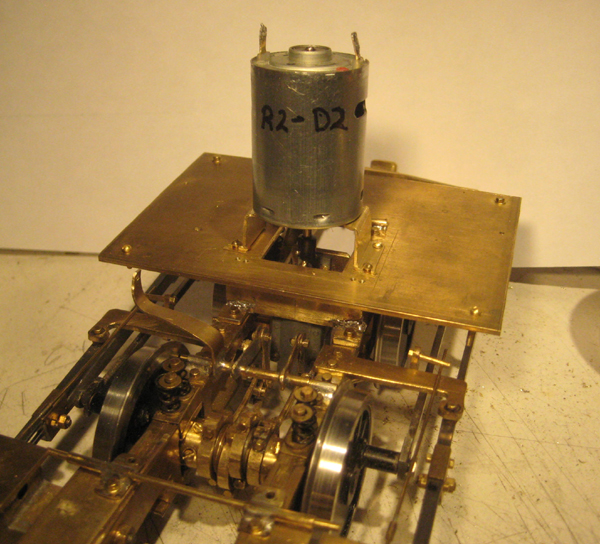

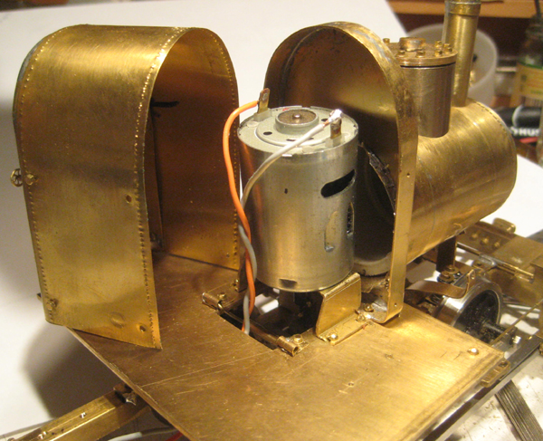

Got the motor installed and aligned.
It actually moves ........... right now with 12 volt but it will have a decoder put in.
see ya
Dave.........

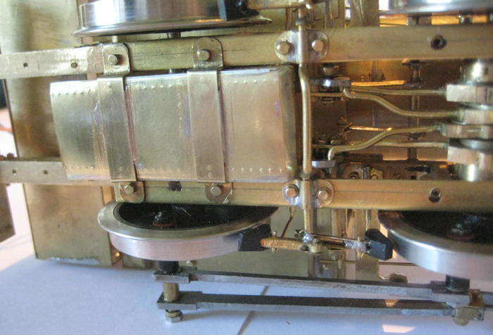

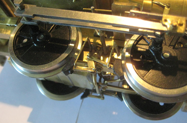

So I got some serious time on the Falk today...
I am moving closer to putting in the electric pick up wipers to the back side of the tires and the rear pair will be half hidden in the fire box.  So I decided that I should build that first.
Below are two shots of the fire box.  It is made of .010" brass sheet stock and cut and fitted.  I had a minor collision with the brake rigging so there was some quick peddling backwards but it ended up fitting.
see  ya
