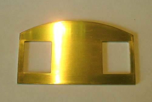

So here is a very rough cab front that doesn't like two days of work.  I got lucky and found a stainless pot lid in the kitchen that had the exact radius.  Two scribe shots later I was back at the bench.

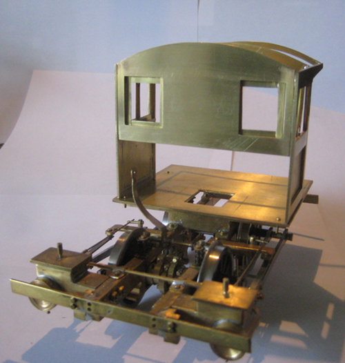

Got the cab front done this morning.  The lower section below the windows will need to be built separately and fastened to the cab base as there are controls that go out onto the frame and boiler.  I'll try and get the main parts of the cab soldered up this afternoon.
Got the window frames in the slider tracks but again, glass goes last.
Still needs a bunch of cleaning.

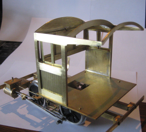

Well I got he cab sort of put together... the real triumph is that it is square both to itself and to the world.
I'm having too much fun with this thing........ It's even starting to look like a locomotive.
