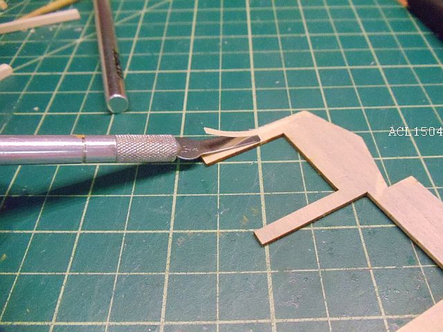

Whenever I start a new build, I always start with new blades in the knives.

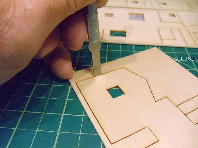

When removing the walls, I used a #17 Xacto blade. I placed the flat edge of the blade against the section to be cut off. If there are two sections together, I'll make the cut in the middle and trim with an emory board or #11 blade.

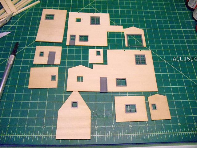

Once all the wall sections were removed, I test fit all the windows and doors in the openings. If you've followed any of my other builds you know this is standard for me. It's either a curse or a blessing but the end result is that I don't want any surprises down the road. When the walls are painted and the signs are in place I don't want to start enlarging window/door openings.
The opening were all true and everything fit. I've never had an issue with any of Doug's window/door openings but I stay true to my method all the same. Like I said, it's either a curse or a blessing.

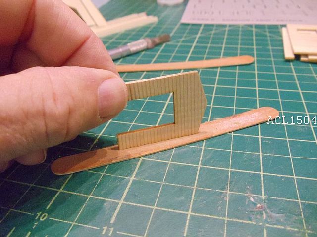

Another habit I have is to square the laser cut edges. I'll use an emory board held flat and the piece to be sanded is passed over the emory board. It only takes a few light passes. In the photo below I'm showing how I do it. NOTE: Also in this photo I'm holding a fragile part at the top and not the bottom. This is to show you the squaring process. Always hold the part to be sanded, especially a fragile one like this, at the bottom and close to the emory board. This way the part won't break on you! Well, hopefully anyway!

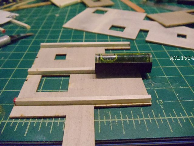

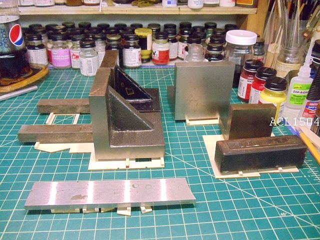

Doug includes in this particular kit a card showing the proper locations for the bracing, trim and other details. I followed his suggestions for the bracing. After gluing the bracing on the backs of the walls, I set all the sections on the workbench and used weights to hold the bracing in place while they dried.
Tom- an interesting thread. It's not clear to me which piece has the flat side of the #17 blade against it- the carrying piece or the piece that goes on the model? Thanks.
mike.engler59@gmail.com
Mike,
Thanks for stopping by. Great question as I did leave the explanation open ended.
The FLAT side of the blade goes next to the model wall. If two walls are together, separated by the little tab the laser left to hold them together, I try to use caution and use the flat side on the wall sides there as well.

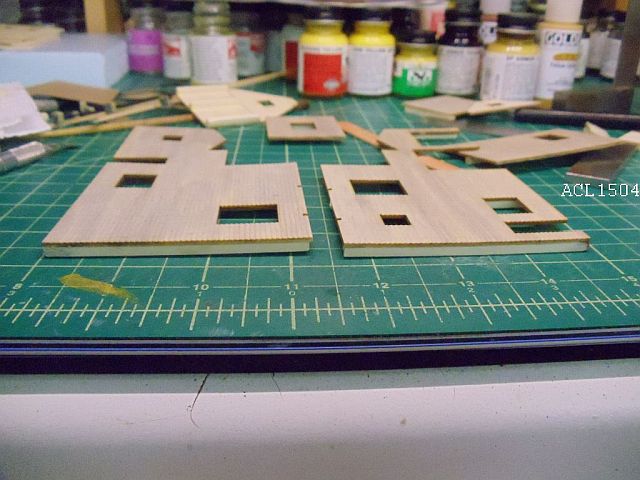

Well, after the walls were braced and the glue dried, I applied a coat of A&I wash. I was concerned about the large walls warping so I applied a coat of A&I to the back sides as well thinking this would help or stop the warping.
Oh no, nothing that simple. The morning after the wash was applied I found the two large walls were warped anyway. I've never had this happen before. DANG IT!
No matter how I looked at them, they were still warped, kinda like Gnatman, I'm just saying!  :)):))

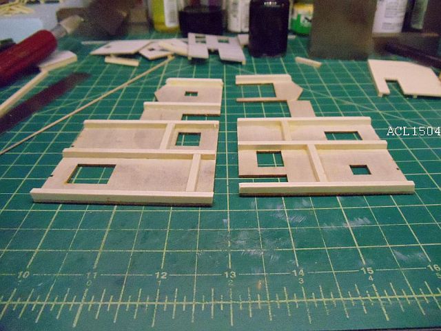

I used the bracing supplied with the kit, 1/16 sq." which should have been strong enough to prevent the warping. I thought for a moment I'd straighten it out when I glued the walls together but decided to just replace the bracing with larger pieces.
I decided to remove the bracing and replace it with scale 12X12" bracing. I'm not sure if the bracing in the kit was 8X8 or 10X10. Maybe I got the bracing pieces wet with the A&I and this caused my problem. Anyway, no problem as I needed to removed the glued on bracing.
Here is how I did it without wetting the walls to soften the glue or more importantly, causing damage or breaking the stock walls.
I took a new #17 Xacto blade and put a slight bend in it. I used a standard size plier to make the bend. It doesn't take much, trust me here and don't ask why I know! I just know this kind of minutia. =))=))=))
Using the new blade, I slipped it under the old bracing on one side and carefully pushed it forward. I repeated the process on the other side and worked forward.
The bracing came off with ease!
I then used fine grit sandpaper to clean the glued spot (not shown). Some of the bracing came off clean and some was holding on for life! Once the large piece was removed, I used the blade to carefully remove the rest. The #17 blade bent at an angle was perfect for getting under the braces.
Okay, the old thinner bracing was removed and the scale 12 X 12's were added in the same locations. I added a couple of horizontal braces as well.
I applied a second coat of A&I wash/stain to the front side of the walls and kept it off the new bracing. The next day I had no warping of walls. :-bd:-bd
