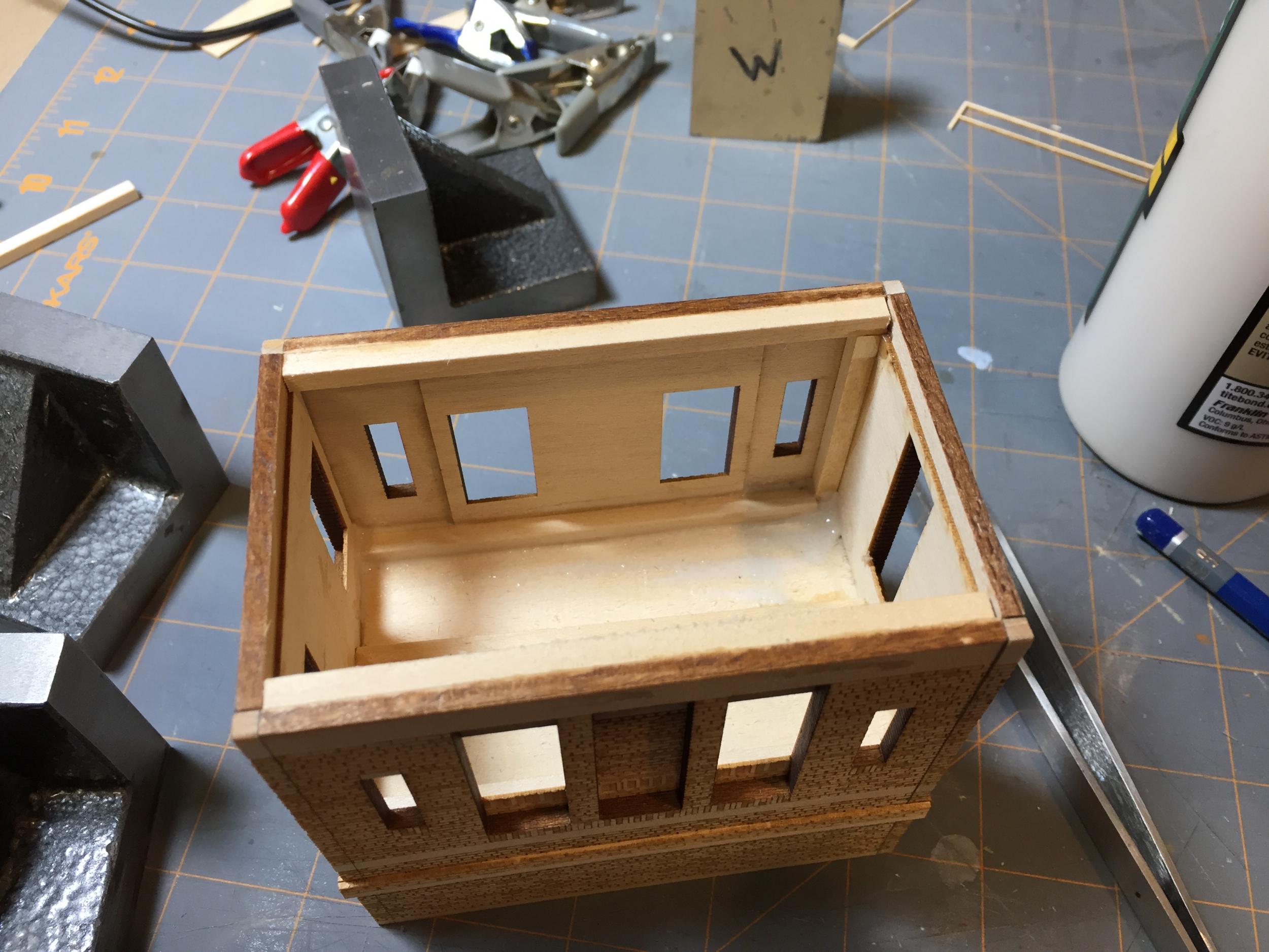

I made some more progress today.  First, the outside brick pieces were glued on.
I then started adding interior bracing to make this a very rigid structure.  Based on my experience with warping with the painting samples I want to make sure the structure is well braced before it sees the painting process.

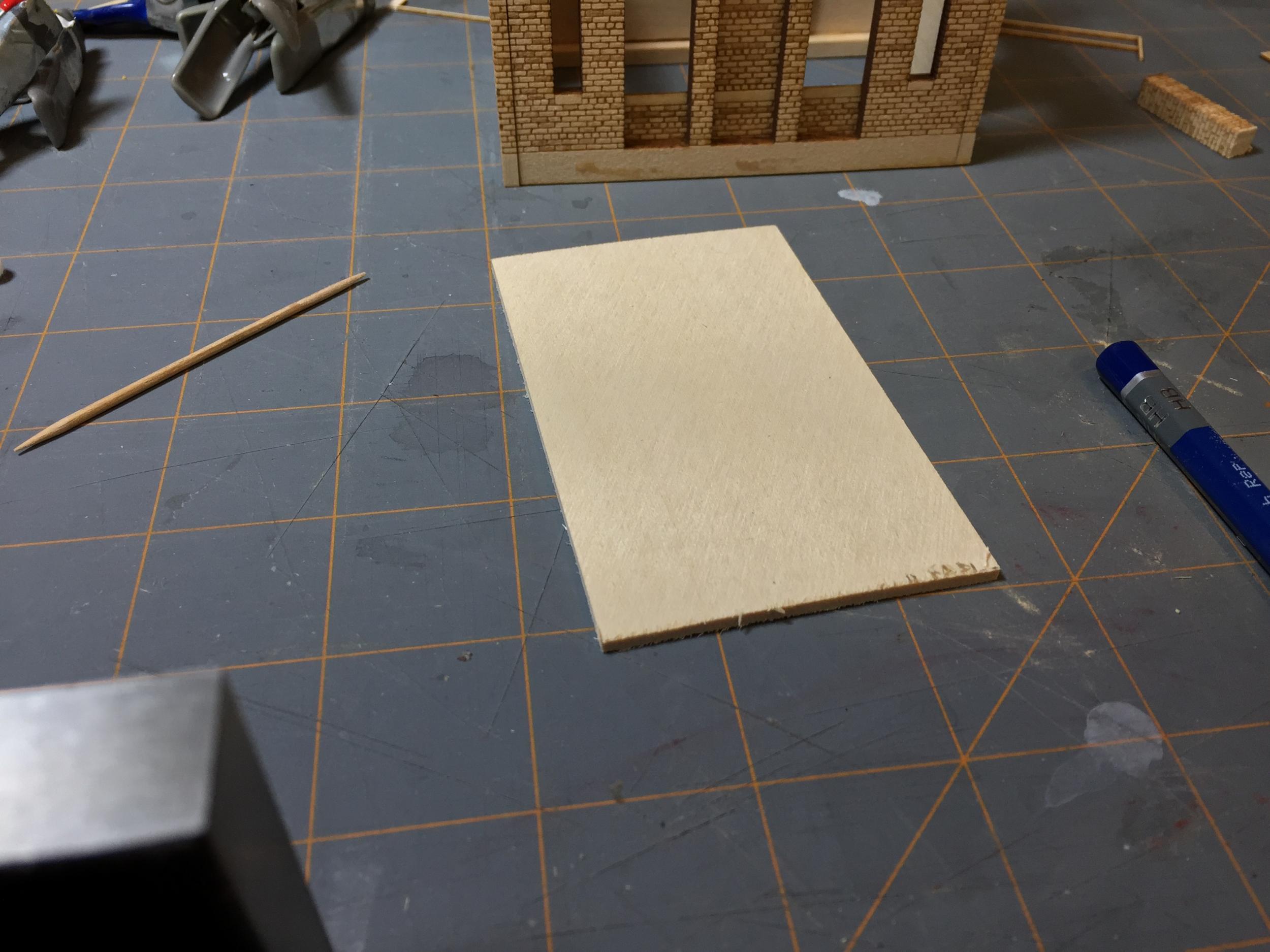

I then cut a floor piece out of basswood.  Since my model will have interior detail  - this is an add on piece not included in the kit.

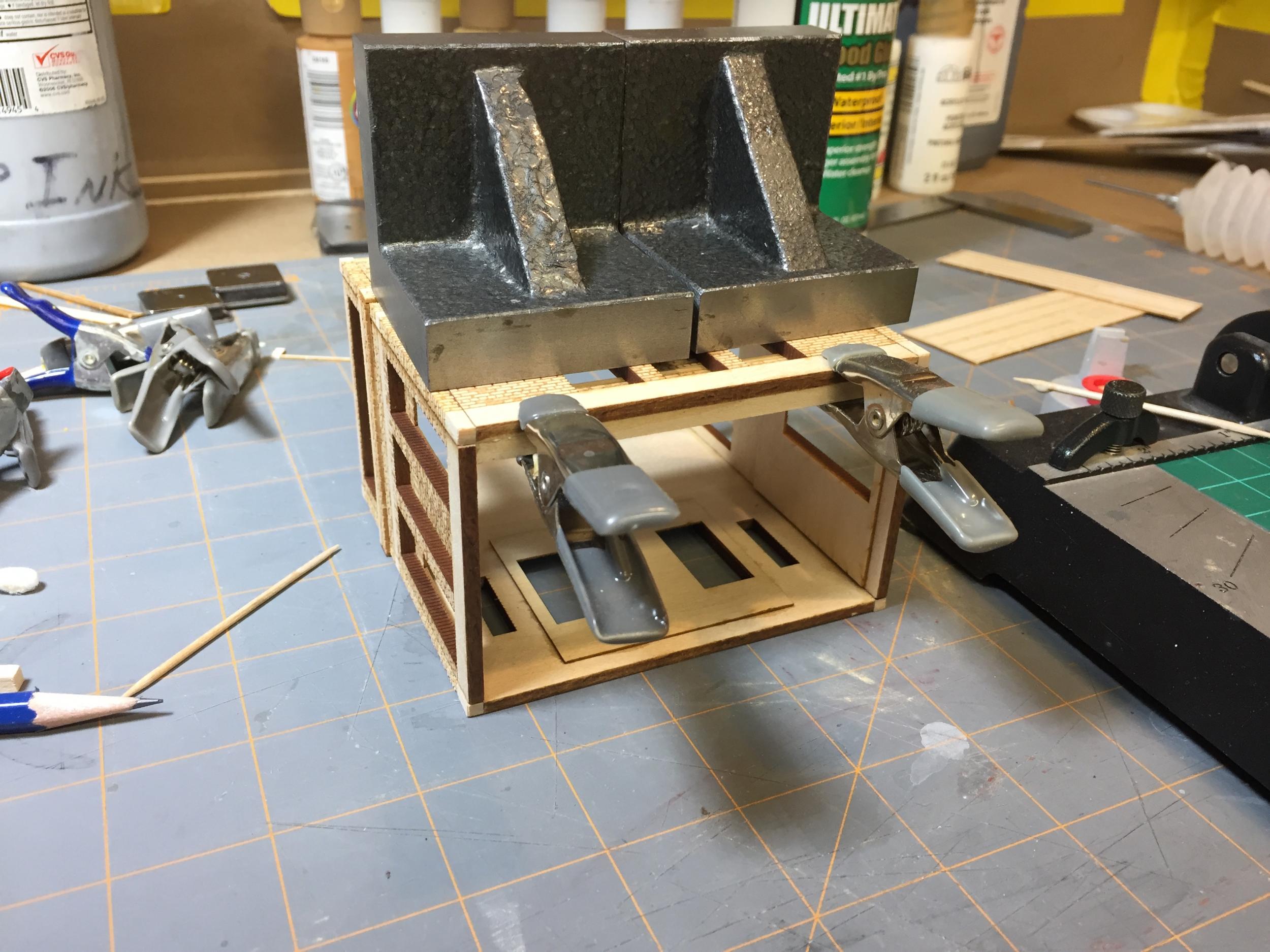

At the end of the day I was adding more bracing in the lower level of the Yard Tower being careful not to get in the way of the window and door inserts that will be added after painting.

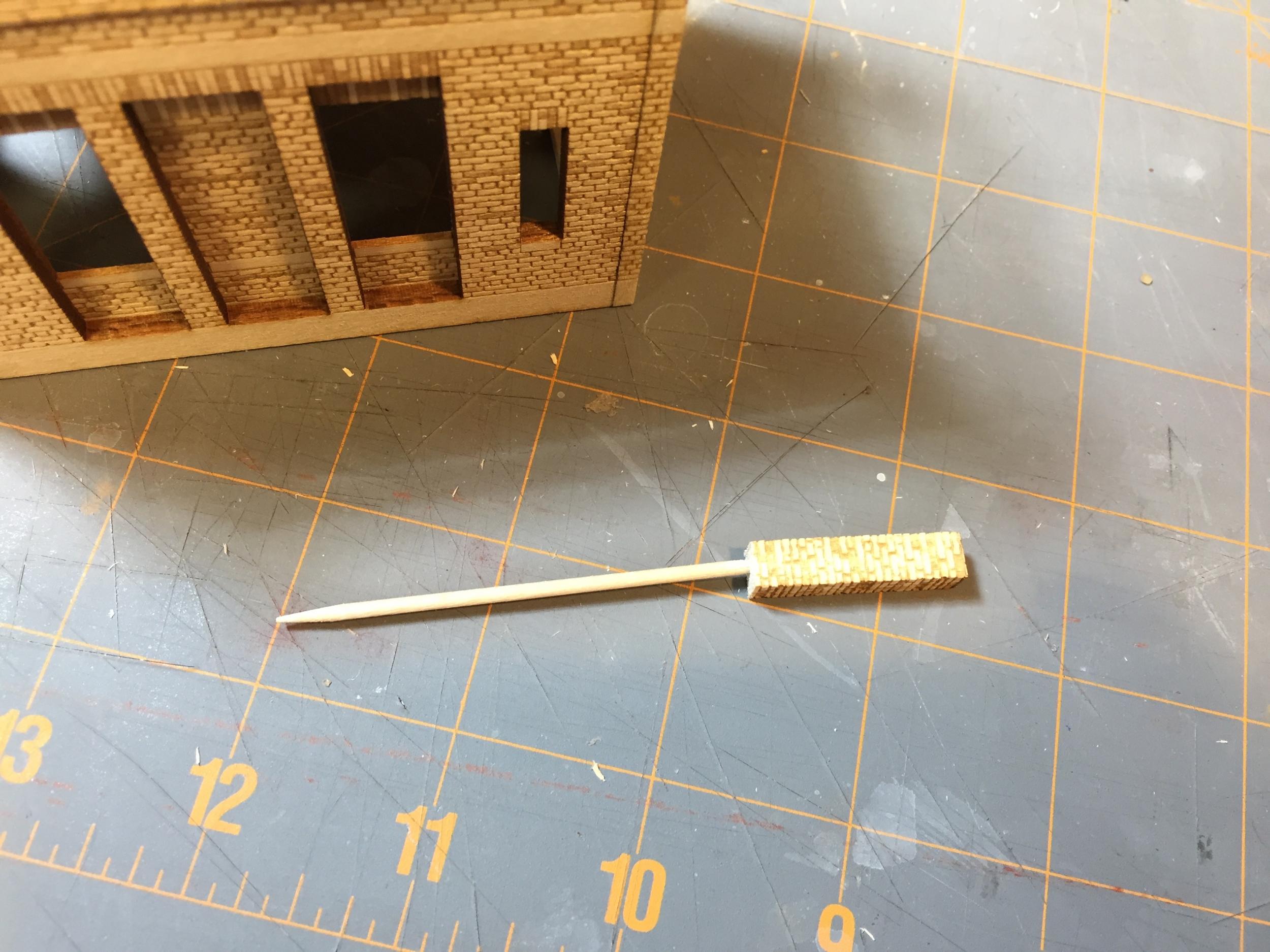

So anyway, back to this build. I finished bracing the interior of the structure and painted it with the lt. grey acrylic primer. This is not the procedure on the directions.  I'm painting the mortar on first and then adding the brick color.  See sample 7 above. I started the painting process with figuring out how I was going to hold the molding pieces and the chimney while I painted it and let it dry.
