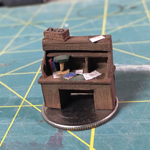

Quick update between Christmas responsibilities:
I built an office for the corner of the machine shop using stripwood and some tulle fabric.
I scratchbuilt a desk from cereal box cardstock for the interior of the office.
Other details, including castings from Rusty Rails have been making an appearance and more will follow.
Matt

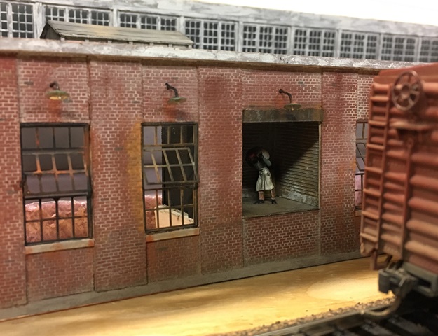

Another quick update.
I have continued work on the Foundry building. I fabricated some skylights to add detail to the roof expanse and because they exist on the prototype. I borrowed Opa George's leaf detail. I used real leaves that were crushed between my fingers.
I also began construction of one of the additions that surround the foundry proper. This addition is influenced by the existing building but I used some Tichy window castings which are smaller than the real thing, so it looks rather different.
Here is the real building:
And my model:
I added the loading dock for interest:
The light fixtures are sequins and wire.
Here it is place in its approximate position:
And here are a couple of overall shots to remind everyone what the heck is going on. The addition building is not located in these shots but will be between the large foundry building and the tracks.
