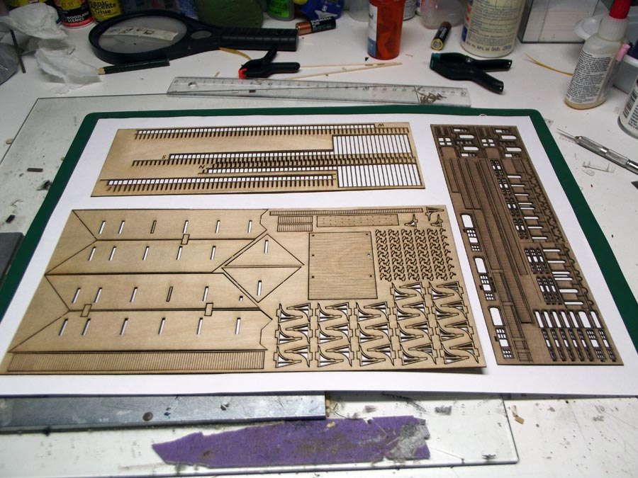

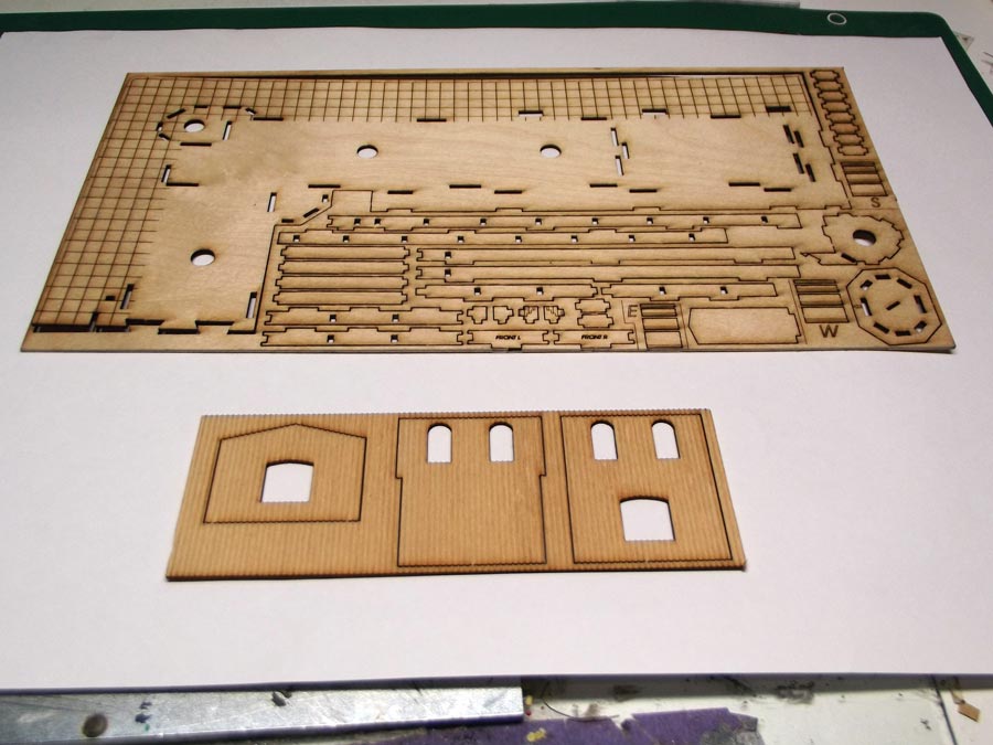

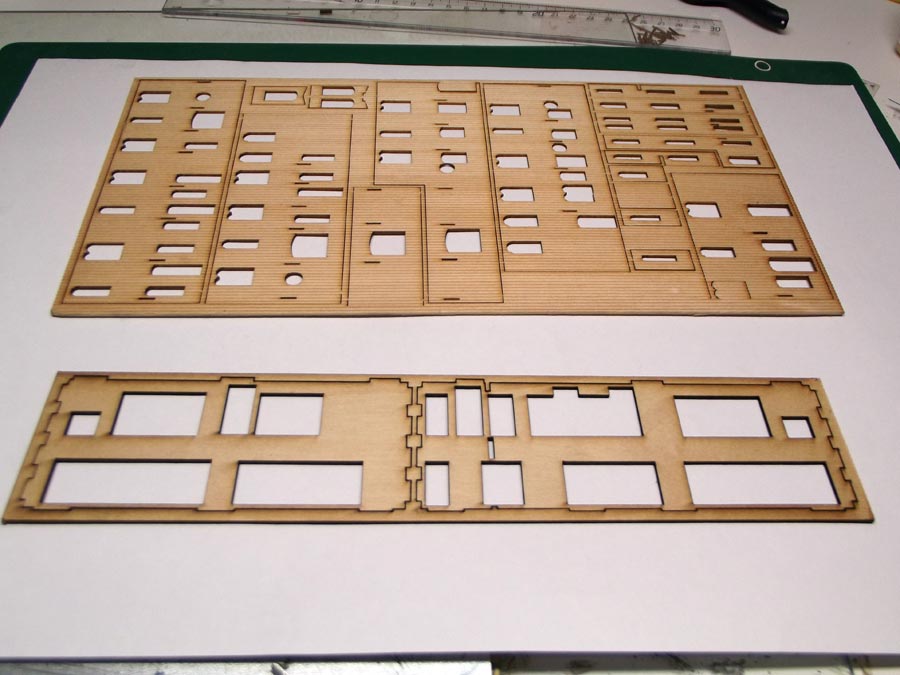

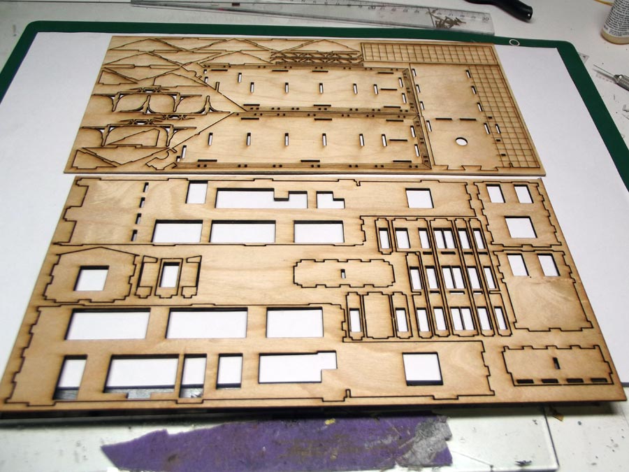

All the parts , at first glance very intimidating , when I'm done we'll know if it's a hard kit to do.

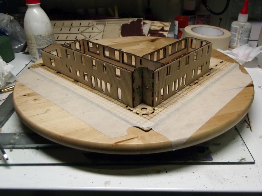

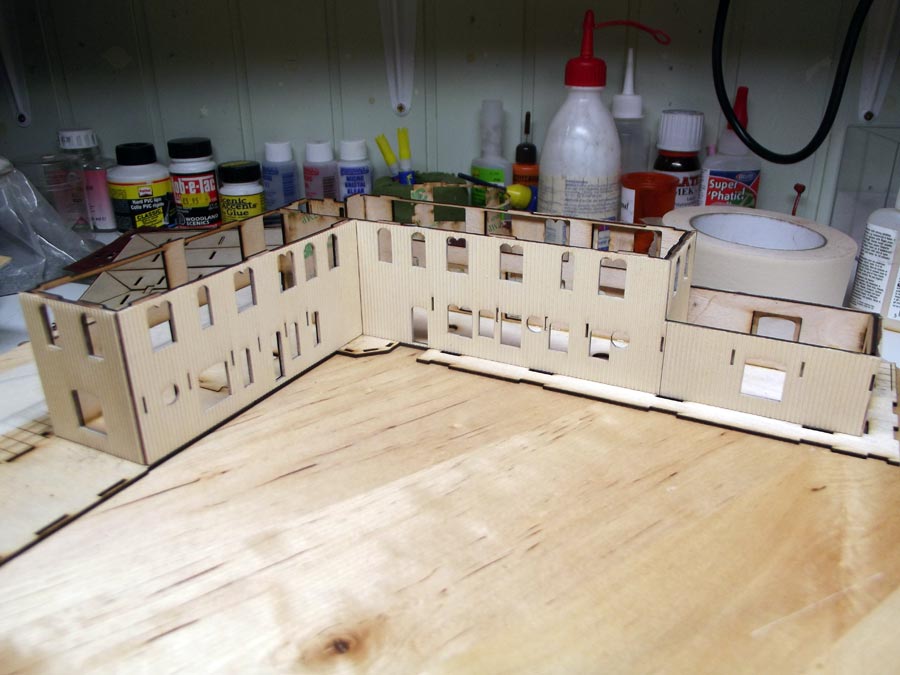

Started by taping the base to a lazy sue , this will make it easy to work on the kit from all sides. Glue the 2 base pieces together.

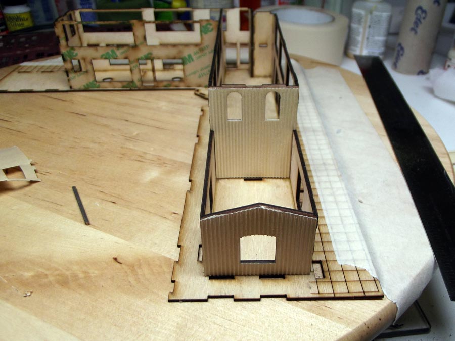

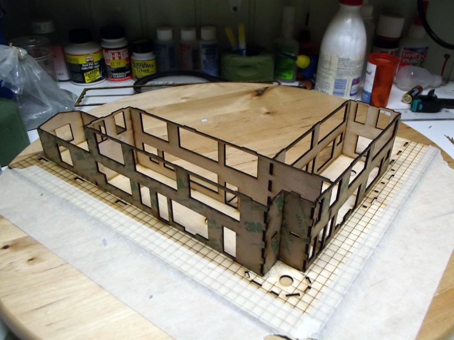

The inner walls glued to the base and to each other , with masking tape to keep things tight while glue dries. The inner walls are peel and stick , make sure the P&S is facing outwards.
The base makes it easy to keep things square.

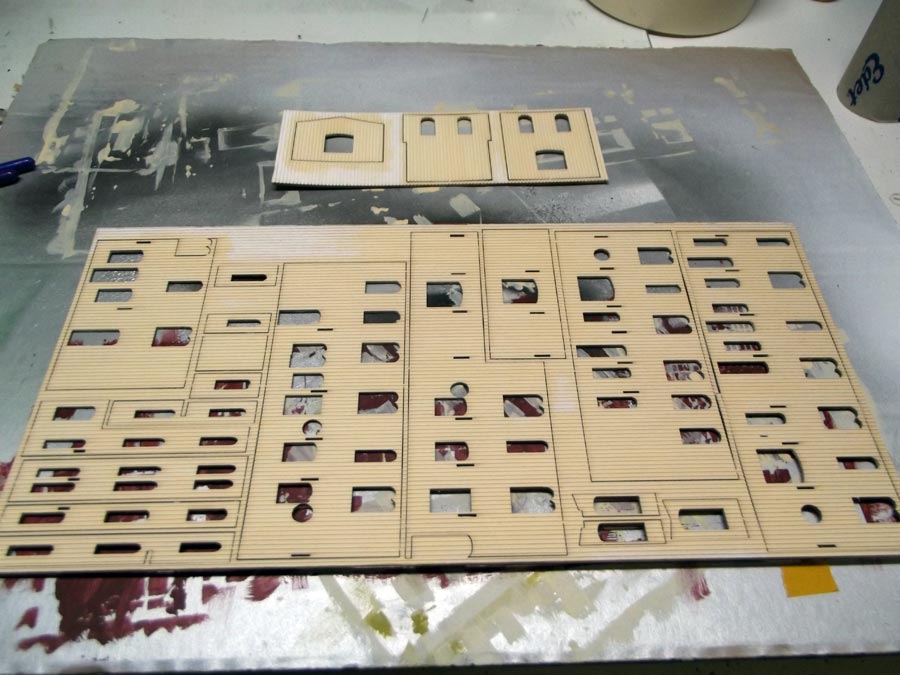

Outer walls with 2 sprays of white primer.

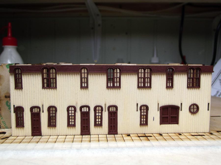

Outer walls painted Building Cream

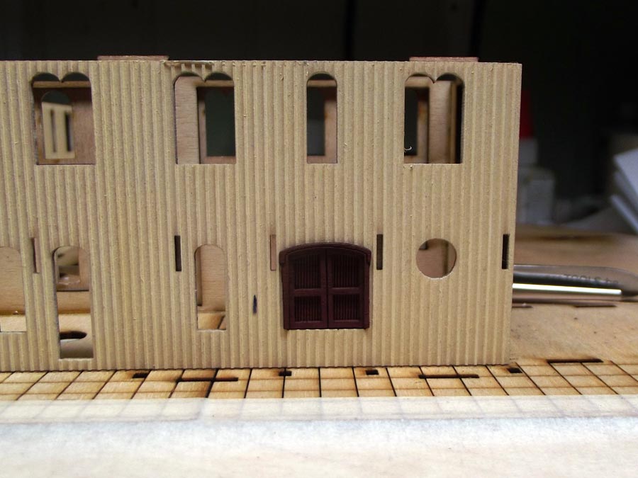

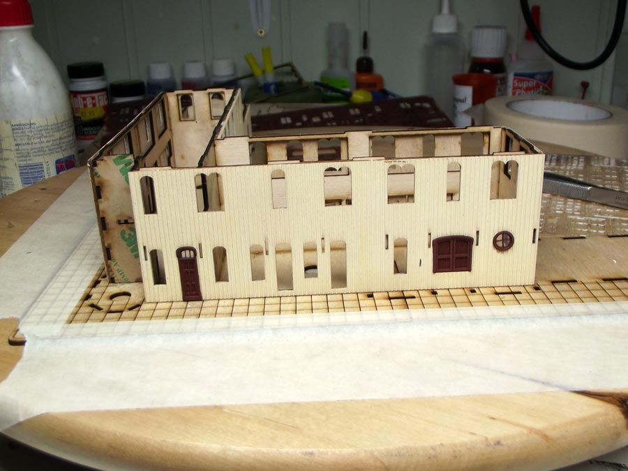

Peel and stick the outer walls to the inner walls starting with the end walls.
Then the other walls.

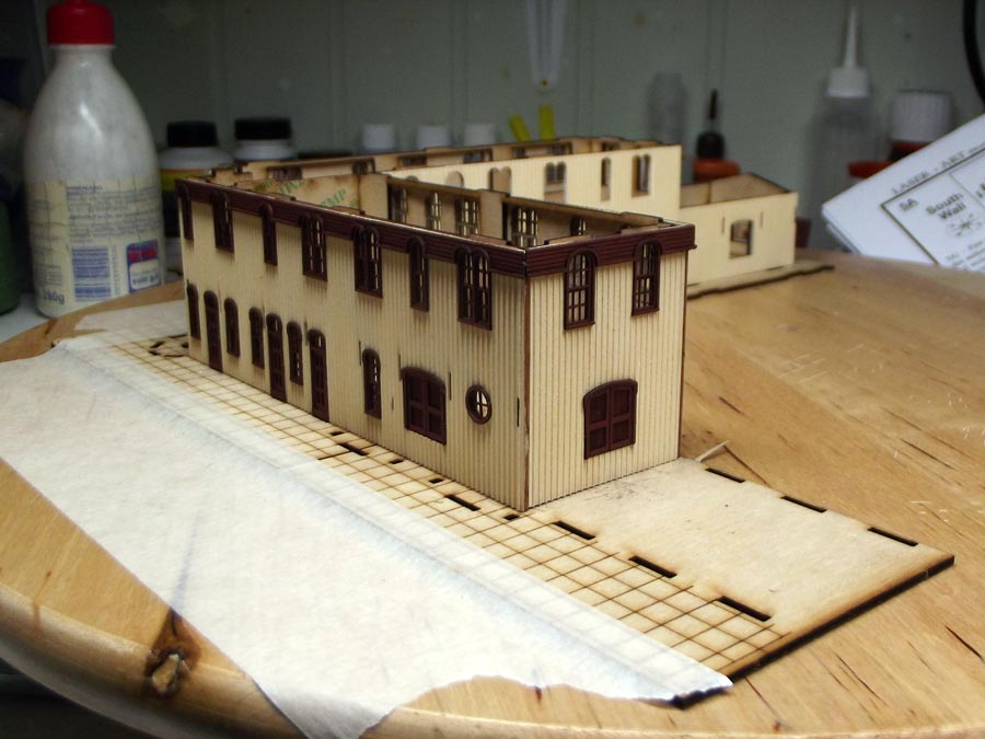

Started assembling doors and windows , these are painted Rock Island Maroon, there's a lot of them.

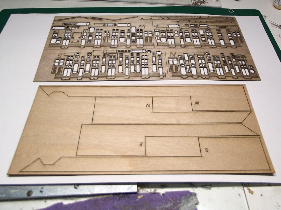

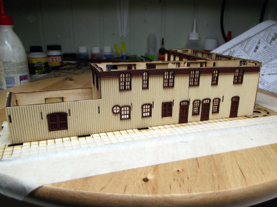

The windows for the first floor , peel and stick , 1 long frame where the rest of the windows is stuck to.
I was afraid it would be hard to get the windows in the openings , but that went quite well.
Hard to see , but added a piece of trim on the top of the windows.
This part of the build is actually a bit tedious, there's just so many windows, with every window consisting of 5 parts.
Some pictures of the progress with windows and doors. Each wall takes about 1 1/2 hours.
