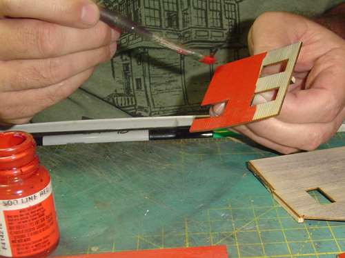

The liquor store walls were painted with PollyScale Soo Line Red.  It looks bright in the pictures but the weathering and A&I wash will really tone it down and darken it.

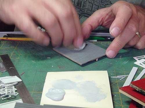

Now it's time to go for the peeling paint effect.  I do this by dabbing on some gray paint (again, a cheap craft store acrylic) using an a sponge that was dipped in the paint and then had most of the paint removed.  Dry sponging so to speak.

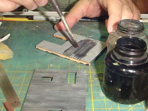

After the dry sponging (I used both a gray paint and a khaki paint for that step by the way) I applied the A&I wash.  Here's a chance to erase any spots where you may have gotten too aggressive with the dry sponging.  The A&I wash can be used to erase some of the bigger blotches.  It'll blend the cheap acrylic paints together and wash them away if you scrub them with the brush.

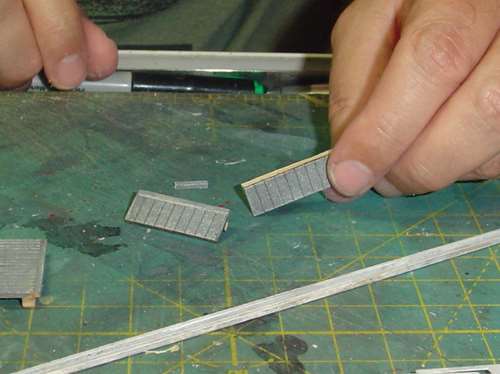

Now it's time to dry brush everything.  Once again, I'm using a cheap craft store acrylic.  The idea here is to highlight, ever so slightly the edges of things (including your fingernails  ;D ) so they're more visible.
I even dry brush the edges of the strip wood that will be used for the corner trim and the walls.

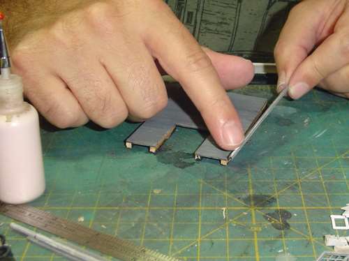

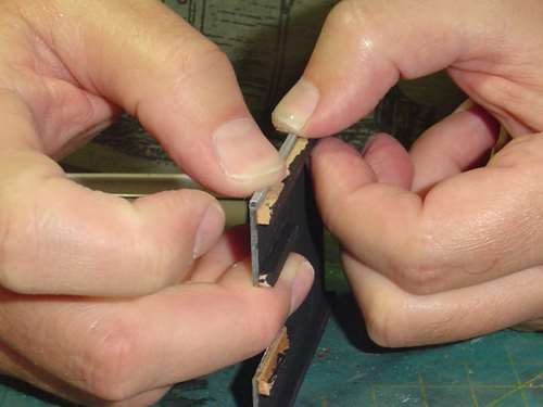

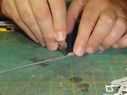

After the glue has set a bit I can trim the corner trim to fit the wall using a single edged razor blade.

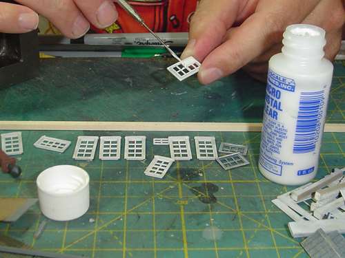

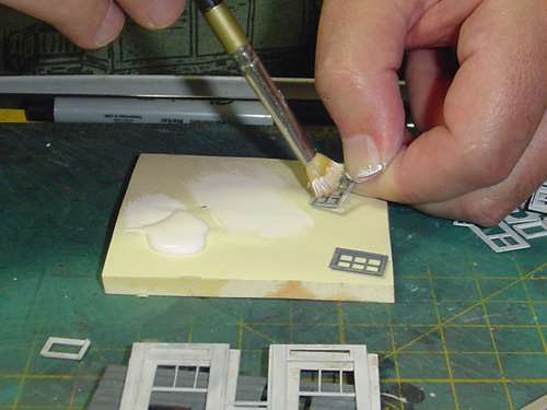

I use MicroScale Krystal Clear to glaze most of the windows.  For the larger, store front, windows I used the acetate included in the kit.  Krystal Clear is thick, white glue.  Spread it across the back of the window to form a film.
I rarely end up with any air bubbles with this stuff.  After it's been applied it's still white but don't worry.  It'll dry clear.
You can see it turning clear as it dries.

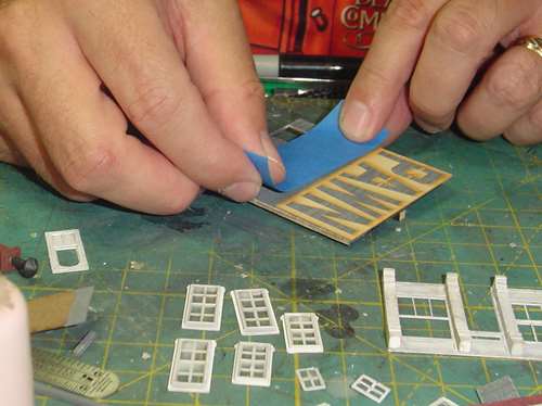

Now it's time to add the large Pawn sign to one of the walls.  I first figured out where the wall needed to be painted black using the template as a guide.  Then I applied some blue painters tape to mask off the portion of the wall that doesn't get painted.

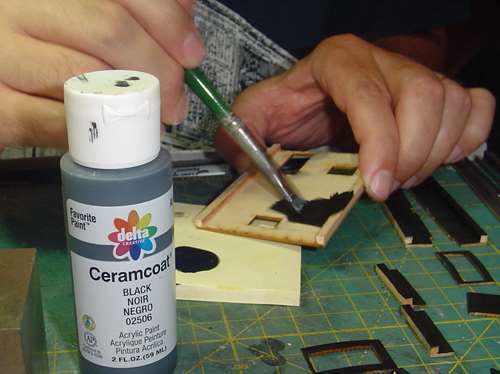

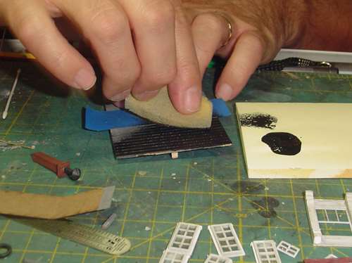

I painted the wall black using the sponge and the same paint I used to paint the interior walls black.

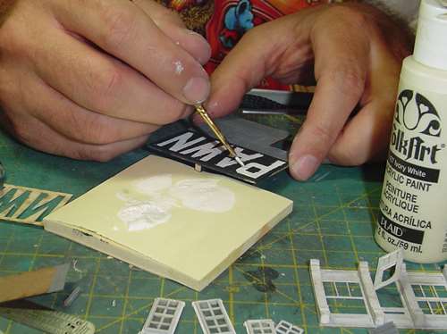

After that dried I taped the template in place and dry sponged white over the template.  If there's too much paint on the sponge it'll bleed under the template and the letters won't appear crisp.
I used a sponge to fill in the letters where the template had connectors to hold the inner pieces in place.  You can also touch up anywhere that didn't get a nice crisp edge if need be.

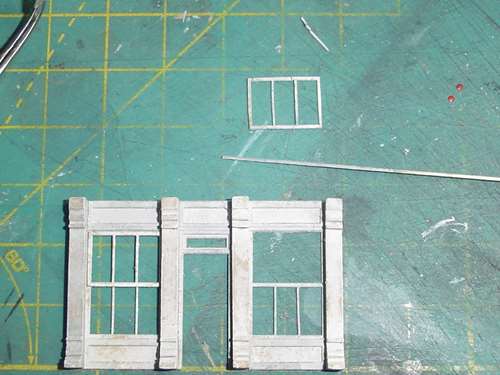

I messed up one of the mullions on one of the store front windows.  When I put the window on the blue painters tape to airbrush it I should have just put one edge on the painters tape.  I was slightly off and a little bit of the mullion was also on the sticky tape.  When I went to pull the window off of the tape the mullion broke into three pieces.  I aligned them and glued the back together but I just wasn't happy with the look.  So, I cut out the offending piece (it's at the top of the picture), sanded down a piece of 2" x 2" stripwood until it was approximately the same size as the mullions, painted and weathered it and cut a piece out to fit in place of the piece I removed.  I think it worked out okay.  Whew...

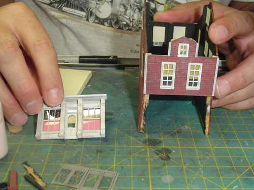

Next up is my favorite part of the build!  Gluing the walls together.  Things start to take on a whole new look when I get the walls together.  I use a square and a flat surface to get a 90 degree angle.  I have a magnetic tray to do this but sometimes I just hold them in place like this until the glue sets (I'm watching a movie or a sporting event while I work).

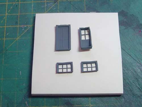

Okay, True Confessions Part Two.  When I was airbrushing the doors, windows, etc. and I had painted one side I usually wait for the paint to dry just enough that I can flip 'em over and paint the other side.  Normally I just set the tray on the roof of my car in the driveway and the Florida Sun takes care of it for me in a matter of minutes.  On this particular day, however, my son was washing his car in the driveway so I went to my back up method - using a heat gun to speed up the process.  First time I ever fell asleep at the wheel and melted some of the pieces.   :-[  Thankfully I have a couple Tichy door and window combo packs so I had replacements handy.   ;)

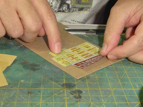

The signs on the front of the pawn shop are glued to scrap pieces of chipboard and then attached to the wall.  I decided to weather them all before cutting them out.  I started by lightly dragging some fine steel wool from the top down to take the sheen off.
Then I gave them a very light A&I was from the back side.  It'll bleed through.
More in a moment... :D
When I flipped them over they looked pretty dark.  No need to panic though.
They lighten up as the A&I dries.
I attached them to a scrap piece of chipboard using 3M Transfer Tape.

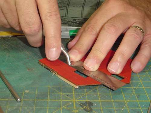

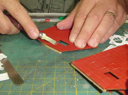

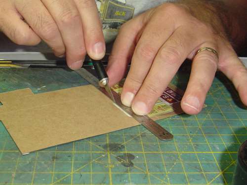

Then I carefully cut them out using a steel ruler and a sharp X-Acto knife.  I use the ruler to protect the sign.  It the blade wanders it'll be away from the sign rather than into it.
Then the edges of the signs are colored black with a fine point black Sharpie.  Don't hold the tip of the marker in one place or the sign will soak up the black ink and it'll bleed away from the edge.

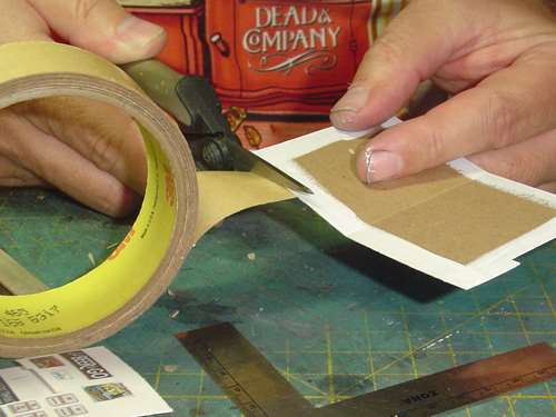

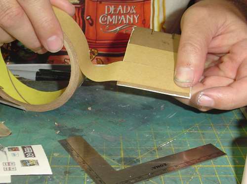

Now it's time to work on the roof.  I applied 3M Transfer Tape to the top side of roof first.  Note, the alternate methods of applying the roofing material are just to schmear white glue on the back of it and glue it in place or to use a Glue Stick.  The Transfer Tape method makes the surface of the roof sticky like it's a piece of tape.  It's not as messy as the glue methods.

I trim the 3M Transfer Tape with either an X-Acto or a pair of scissors.
