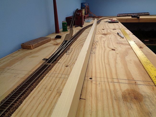

I started work on the East Summit Yard as I mentioned yesterday. This yard is just over 16 feet in length.
When I installed the mainline in East Summit, I measured the center line for both the north and south ends of the yard. Both ends of the yard throat come off the mainline. The yard throat is 14.5 inches from the wall to the centerline.
Here is a photo of the south end throat area.

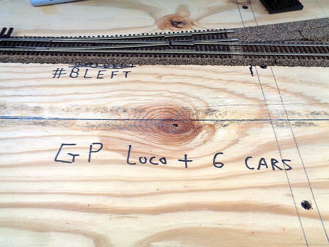

I obviously made a mistake on the north end. Refer to the photo below. The old centerline is shown at 13.25 inches from the wall. A new line is  marked under the 14.5 inch mark.
Here is what I did to fix the difference in the 1.25 inch offset.
I marked a point in the centerline on the north end. I used a long 1X3 and drew a line from the north end to the south end centerline.
I then glued the cork in place on the new line. In the next photo you can see the track in place with only a very slight 40" radius curve at the turnout to bring the track back in line.
On each end of the yard is a short yard throat. The north end will hold a small loco and 6 cars. The south end will hold four cars and the south end mainline will be used in addition for switching in the south yard. More on this short yard throat later in the build thread.
This photo was taken prior to the cork and track being installed on the centerline.

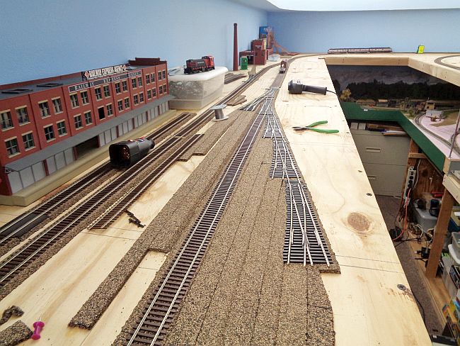

Didn't get much done this afternoon. Cutting the grass took some wind out of my sails.
I did get a few #6 turnouts installed in the north end of Summit Yard. These are all PECO turnouts.
Looking South -
Looking North-
Tomorrow I'll work on the south end of Summit Yard.
