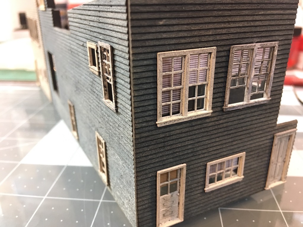

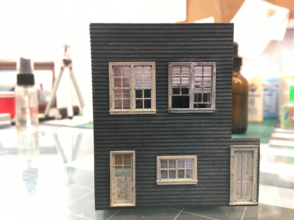

With the windows weathered I installed them. Not sure I like some of the heavier weathering on some windows but can correct as I go.
I am using real glass in place of the plastic that come with the kit.  In addition I changed out many of the Tichy windows with open windows by Tichy.
I used microscope slide cover glass. While the glass will not be in direct contact with the mullions it will be too close for anyone to be able to tell, that's theory.  I have had a couple e-mails with Bob Parrish concerning the issues with using real glass. He has been a great help. I will be practicing his ideas this weekend as I have more windows to install requiring the glass be inset into the window frame.
I use Formula 560 canopy glue if I am just covering across the plastic window and the glass will be in contact with the wood, which is most times. I will discuss the windows requiring the glass be directly glued to the window frame when done. Attached are pictures of the fronts with windows in place, back side showing glass being glued in place and finish look. I think you can see the glass really is clear (I wore latex gloves so as not to leave prints).

The blinds for Schwarz Stamping have a used look since it has been in operation for a couple of years. By I using glass I went with decals (one reason I used glass). My plans are to light the interior allowing the blinds to look like they are 'drawn' for night scenes. Over several days I tested a lot of ideas. Here is what I settled on:
Evens Design offers a white decal paper that works well with my HP inkjet printer, here is their link:
https://www.modeltrainsoftware.com/pages/adding-white-text
At $18.99 for five sheets (8.5 inches by 11 inches) it is not cheap. Most likely there are other brands less expensive but five sheets will make a lot of HO scale decals. I used white so the blinds show completely (can't print white). I tried clear Testers decal paper (with bonder) and it just did not work.
First I tested my ideas on regular paper. Then printed just a few blinds on a sheet of decal paper in one area. I ended up reusing the same paper by printing area by area until I had exactly what I needed. Two of the Wiley blinds and one I found on Goggle ended up being used.
For the attached pictures I've put some of the wall sides together using magnets to give an idea of what I am working towards. I also have pictures showing the inside. As you see the inside is getting messy.
Some caution doing what I did:
1 - I am attempting something the makers of the paper did not expect. I transferred the printed side of the decal so it is facing the glass. This allows the printed pattern to show through the glass window and the white backing is behind it. This is opposite of what the makers of the decal paper tell you to do.
2 - The decals take a lot of care. Follow their directions exactly, especially the print settings (I did not on my first try and ruined the sheet of decal paper).
3 - Cutting and placing each decal correctly takes time, lots of time. I needed to use lighter fluid to stop some of the decals from curling so you need to watch the decals as they dry and not just walk away and assume they will dry flat.
4 - Since the decal is 'backward' (printed side directly on glass) I will be carefully applying glue to each of the decals edges to prevent future delaminating.

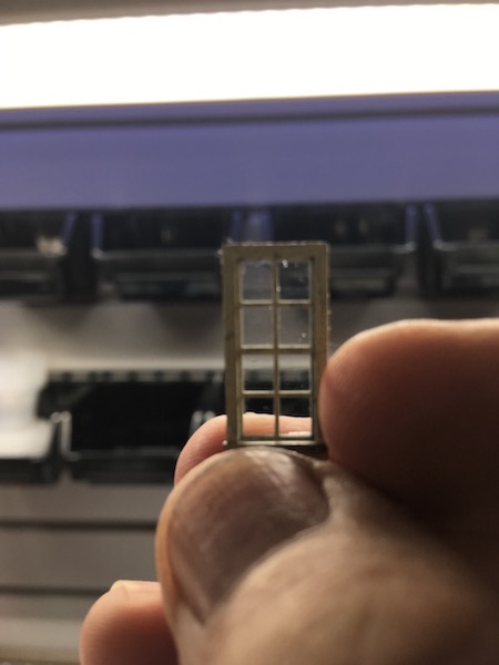

I discussed cutting glass with long time forum modeler Bob Parrish when I started this project. He said to use a scribe made by General Tools. I did not wait and used the X-Knife I have used before, big mistake, I had many mis-cuts, direction problems, fitting problems and so on. But it got done after a lot of work.
Practicing today I placed a microscope slide cover on my self-healing cutting board and measured the length and width needed to be cut so it would fit inside the frame of the back of the window. This way it would cover the window but allow the frame to slide into the opening in the wood wall. This is much tighter tolerance then what I attempted on the kit. I put a ruler along the first cut needed, the ruler has a cork back to help it not move when held in place. Using the General Tool Scribe I made a single pass along the ruler using about the same amount of pressure you use with a pencil, no more. It drew a line straight down the glass cover. I put the glass cover with the scribed line over a small dowel, making sure the line was over the dowel, slight pressure on each side and one perfect cut. Then I did the other side. Another perfect cut. Here is how it looked, this is the FIRST attempt using this scribe, it worked that well.
Part Two Gluing:
I first attempted was to use canopy glue to weld the glass to the window, difficult but I am sure I could have with enough time, a lot of time. Then I used the Visbella UV Light Glue. I learned about this from forum modeler Darryl Jacobs. He did a posting on using this glue:
http://www.modelersforum.com/index.php?topic=4096.msg110894#msg110894
First I put a little amount of glue on a post-it-note. Using a toothpick I worked around the outer edge of the backside of the window frame. Then I carefully placed the cut glass on the window using a dowel stick that had tacky clay on the tip so the slide would stick to it but easily come off with a light touch using a separate stick once in place. This resulted in very adjusting needed little so all was in alignment. Finally, I used the UV light per the containers' directions. I moved the light around the glue line using no more then 10 seconds for the entire frame. The glass was firmly, very firmly, attached to the window. Amazing! Here are the results:
Using glass has just become easy for anyone! Thanks Bob and Darryl!  Next building I will be doing this method without a doubt.
