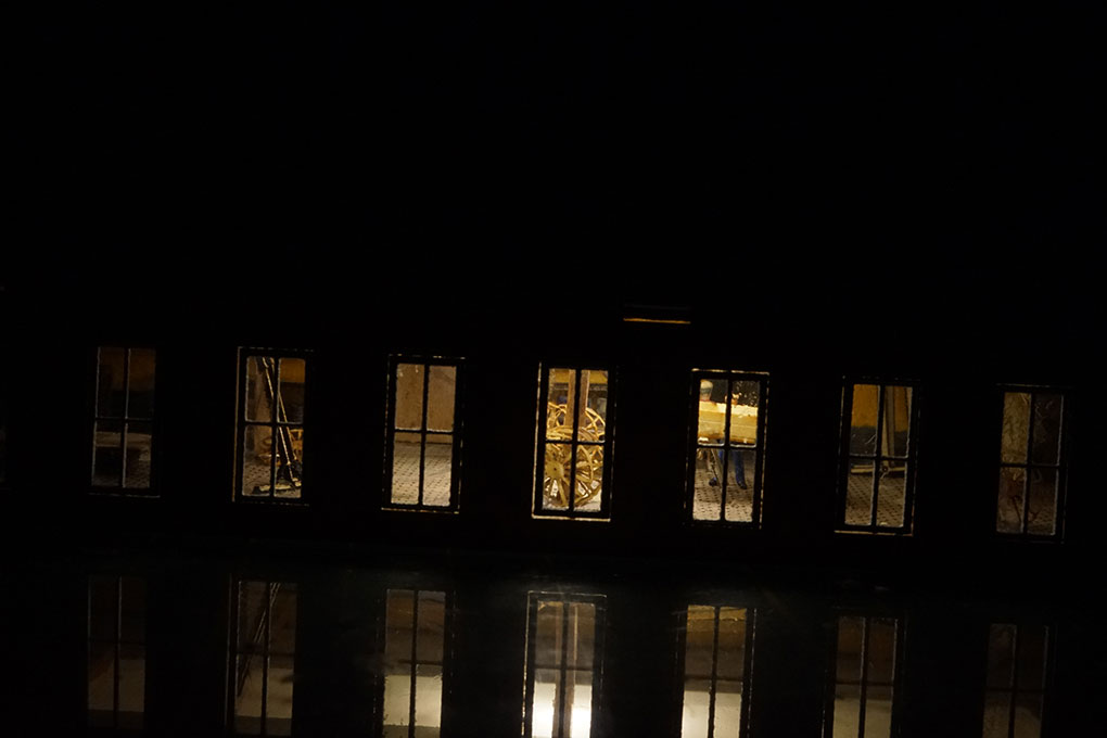

Although I had to work till 21:00 , I found some time to do some modeling.

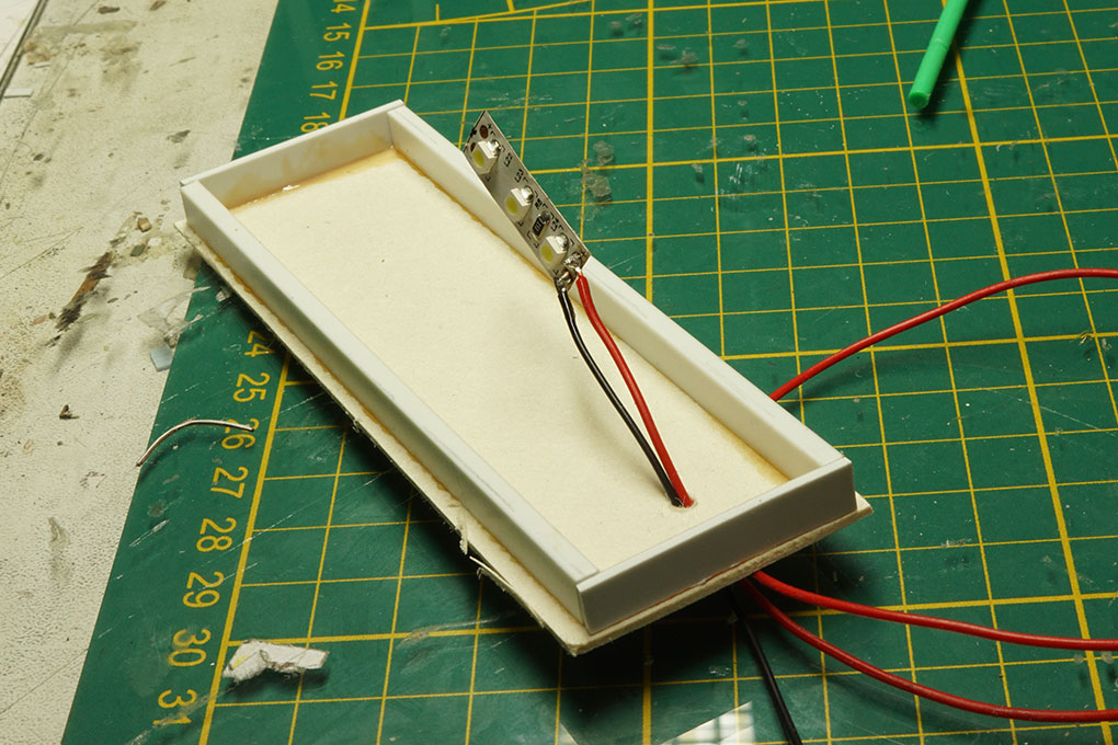

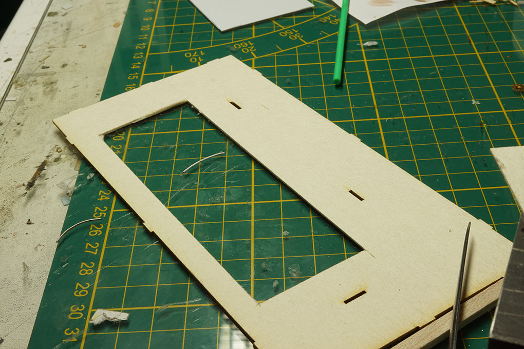

I wanted lighting in the structure , but not direct LED's , I wanted a box that would give some overall lighting without being to bright, so I cut out a part of the floor above.
Cut off a piece of thin milky white styrene.
Made a box with the cut out floor and some styrene. Stuck 3 LED's in a row to the box.

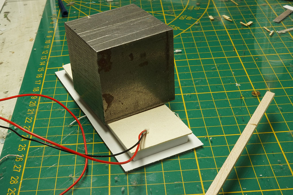

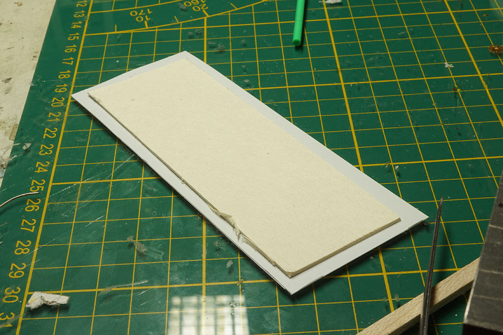

Glued the box to the somewhat larger piece of styrene.

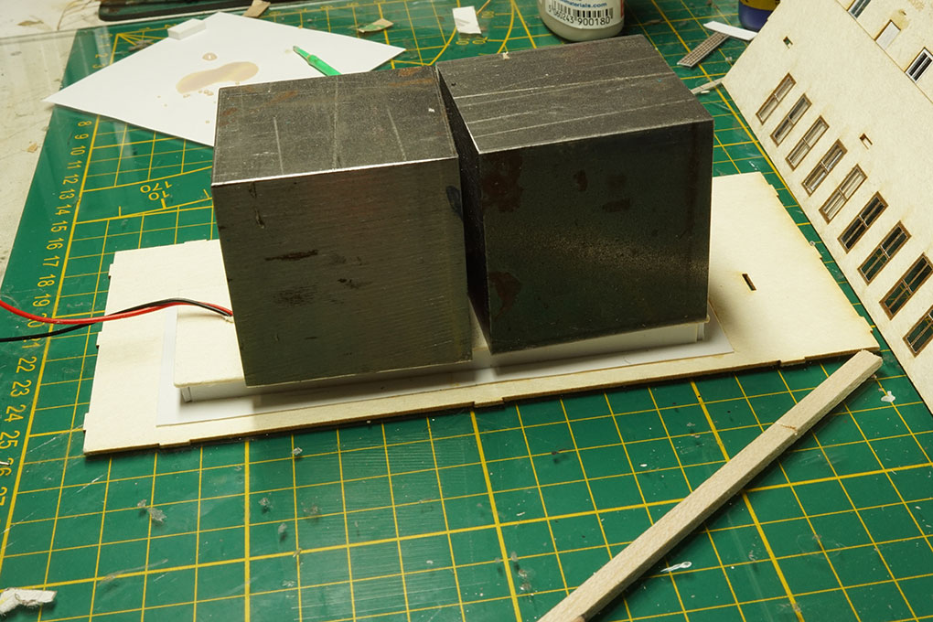

Glued that to the floor with the hole in it.

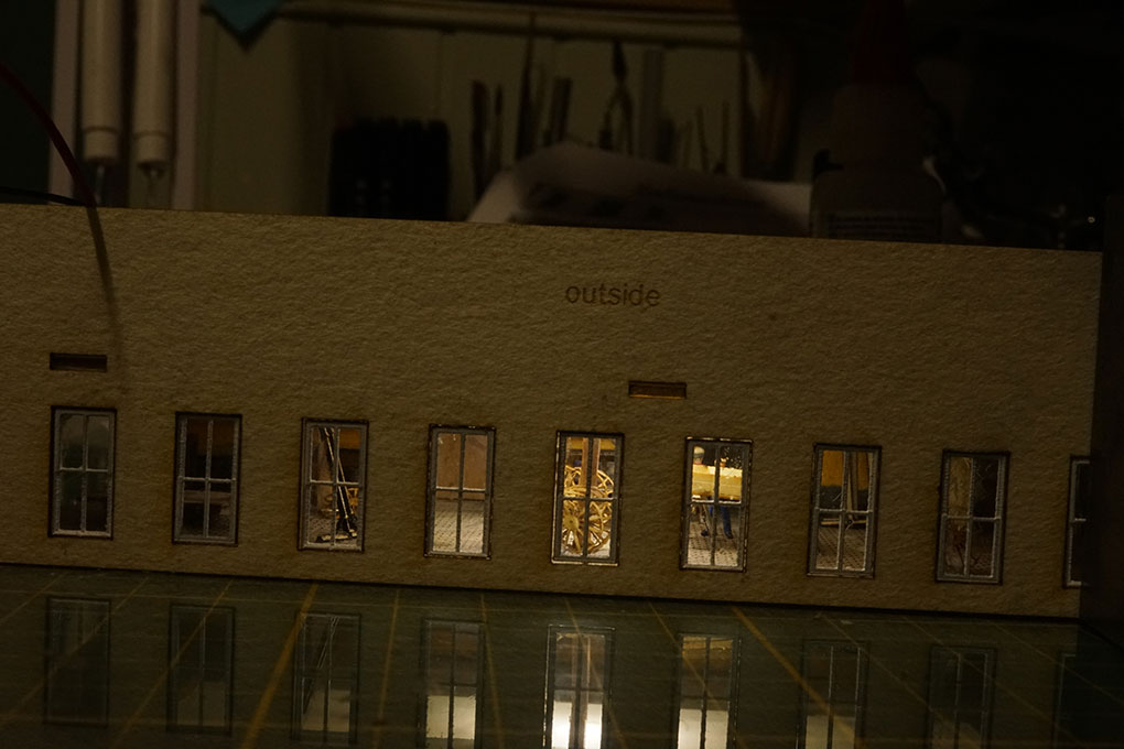

And tested if the lighting was what I wanted , and I think it's exactly what I had in mind.
I continue to be amazed..........are you sure this is "N" Scale ?
Jim Donovan
Jan
the lighting level looks real life. Floor is great, nice touch with the wagon parts and love the little people. I can't keep my eyes focused in HO scale, no idea how you make it so real in N gauge but sure like it.

Thanks again Jim and Jim , I do need special made reading glasses to work on modeling with , and a lot of patience   ;)
