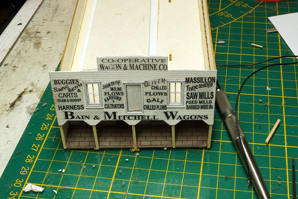

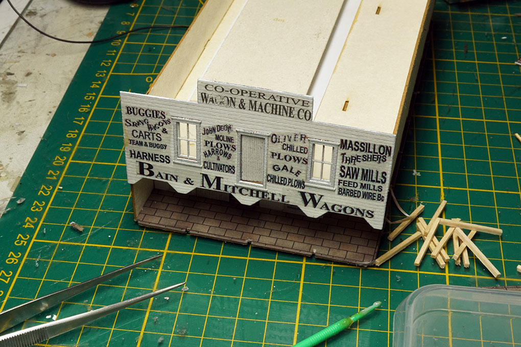

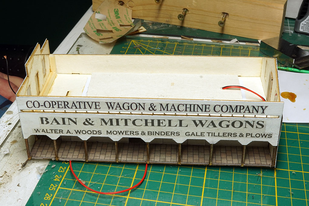

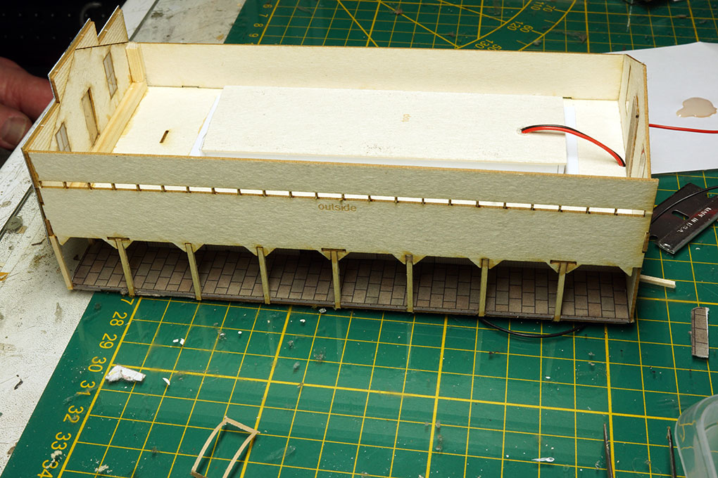

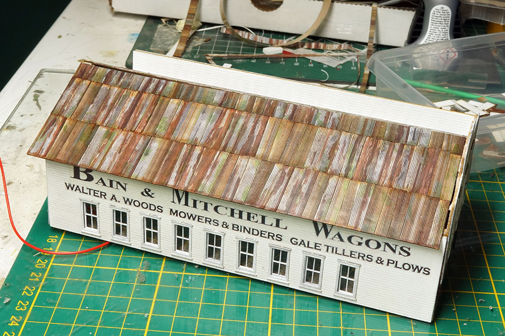

Next was assembling the posts of the porch, cut them from scale wood provided in the kit along with a small jig for the size.

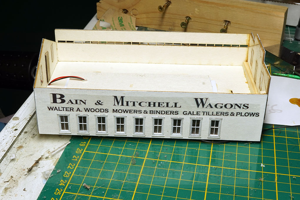

Then it was time to assemble the Peel & Stick outer walls , everything fits perfect so this was an easy task.
Next up the roof , and a mistake I made.
Jan:

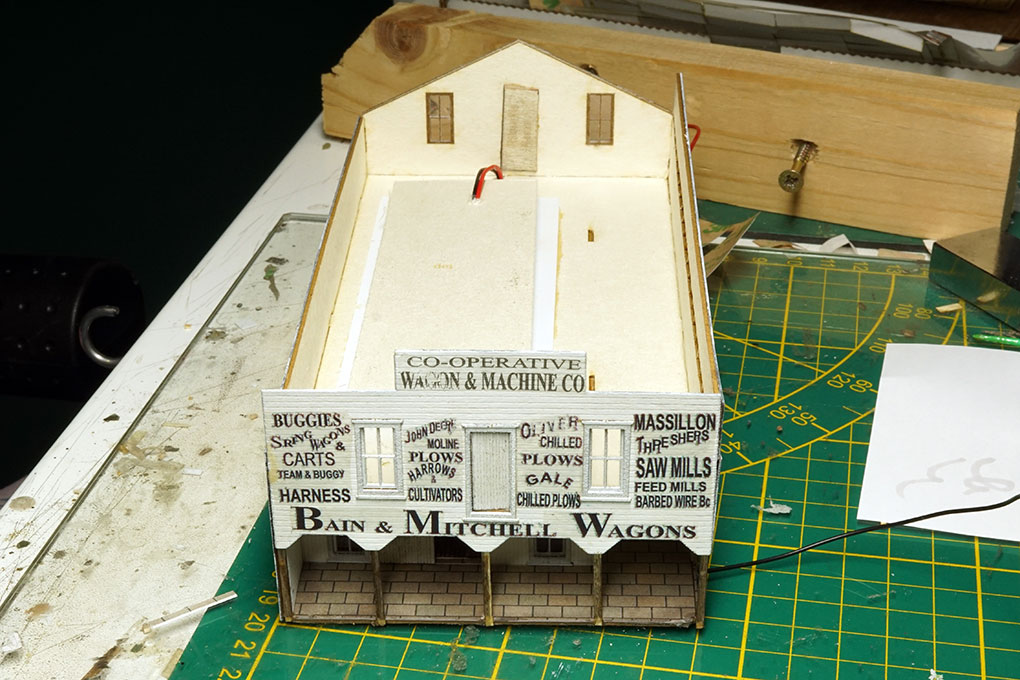

WOW really fine modeling. Love all those signs.
Thank you Curt , Karl , Chris , Rich did well on the signs , besides the porch they are what make this structure stand out. They are decals , and until I sprayed them with Dullcote you could see they were decals , now it's only visible on the photo's because they still reflect a tiny bit , but not visible to the eye.

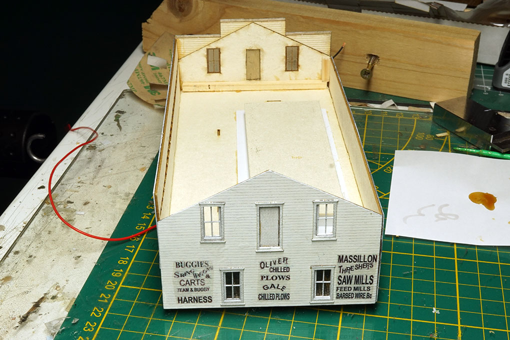

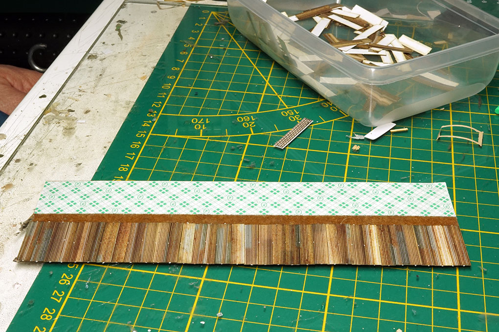

So on with the roofing. There are printed corrugated roof sheets in the kit , each is a single piece so you put them on using transfer tape .
So I did the larger piece first and thought that had to be made to size to fit through the slit in the wall on one side , which has been done here. That was my mistake.

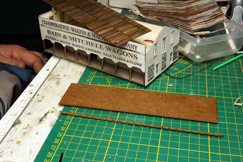

While fitting the smaller piece of roof base I found out that this wasn't large enough, and after looking in the box more seriously I found a small strip of roof with slots in it . Oooops , the smaller piece of roof and the strip together should have made the roof that goes through the wall.

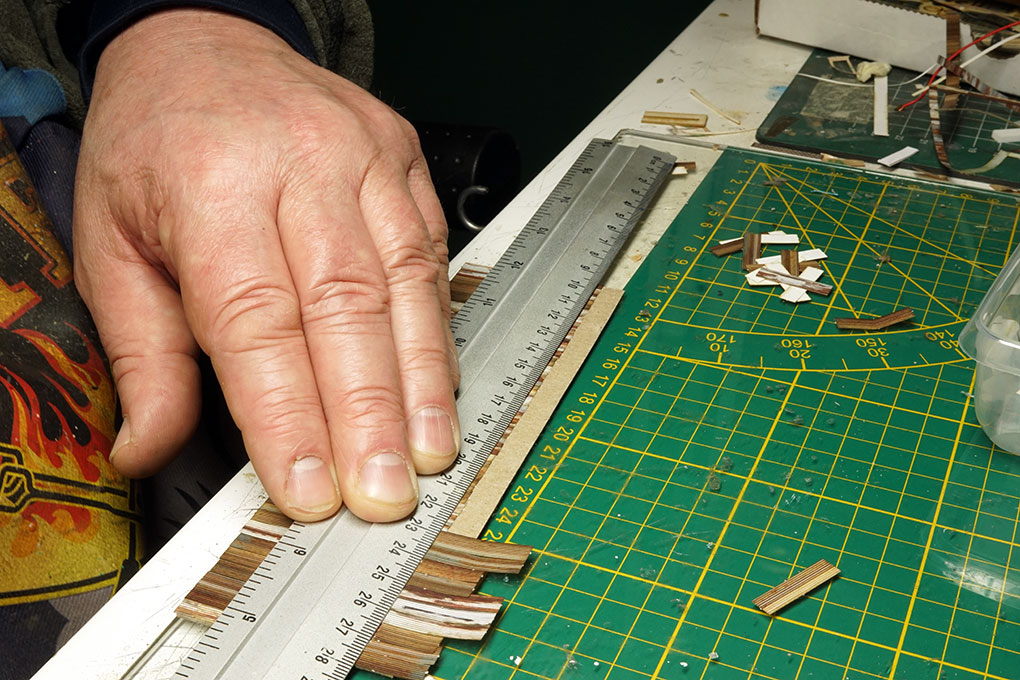

I had already cut away the little beams in the slit of the wall , so I decided to just leave that roof as I had done it and make a new piece of roof for the other side . Here you can see me doing the last row of corrugated roofing on the piece of cardboard I used.

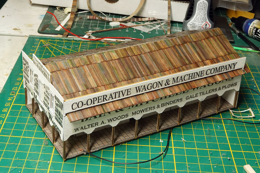

I then brightened down the printed paper as I had done with the Regal Cinema , used artists markers in various tones to blend and tone down . Later I will be using pastel chalks to even further brighten it down. I then glued the roof pieces in place.

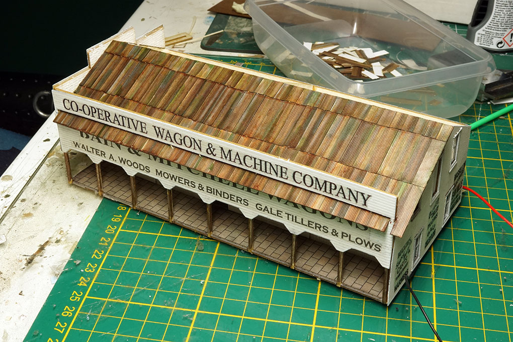

Here is the roof before finishing it with a cap , you can see that I used moss green markers to simulate moss and fungus on the roof.
This is the other side it's a bit darker because the sun shines on the other side.
Roof cap on , next is trimming.
