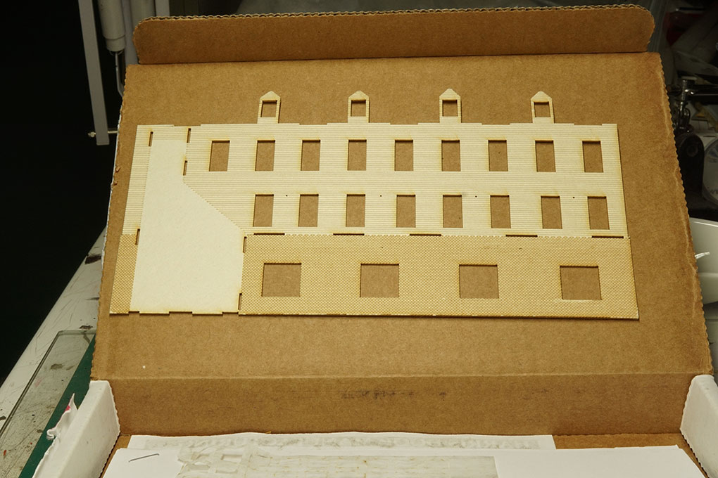

The box. Always excellent packaging .

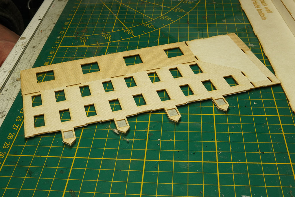

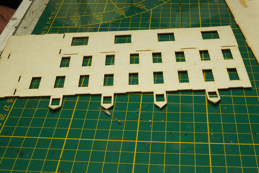

This is a backdrop structure with a little depth , the main part is the front wall.

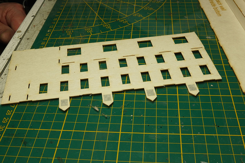

Right away I had a small issue with the dormers , they are very vulnerable, I had to do something about that before they would break off.

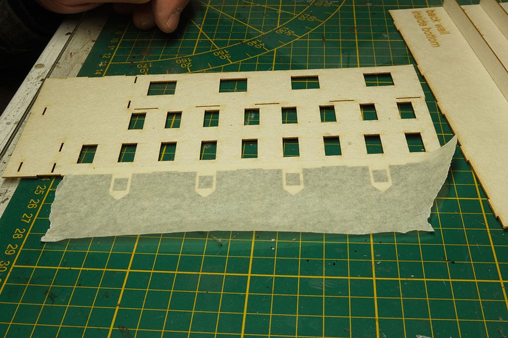

I taped them with masking tape , and cut around the dormers.
This would be enough to keep them safe until the windows and the window frames were assembled, once those are in place the dormers won't be vulnerable.

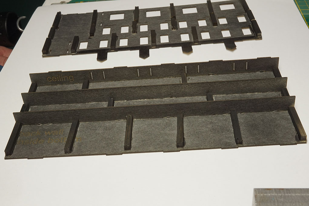

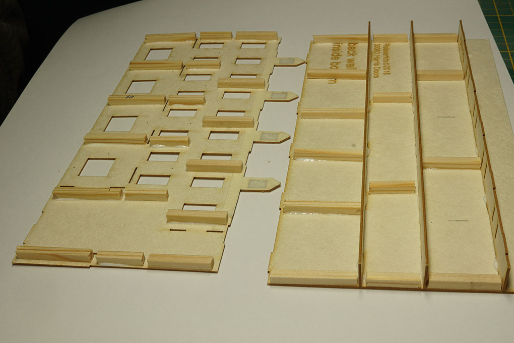

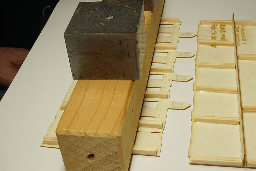

The I braced the whole wall , leaving space for the horizontal bracing provided in the kit.
Then I spray paint the inside black.

Jan, I meant to ask earlier what the paper does on the upper windows?
Quote from: PRR Modeler on February 03, 2019, 04:32:11 PM
I think you mean the masking tape Curt correct me if I'm wrong, they keep the dormers together and safe until I have the windows in, the dormers are a bit fragile.
Thank you Rich , and yes it's easy to solve the fragile dormers , so it isn't really a problem , just have to be a bit careful, but that goes for many things in N-scale.

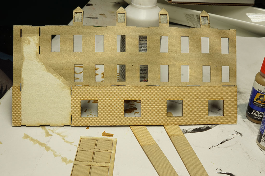

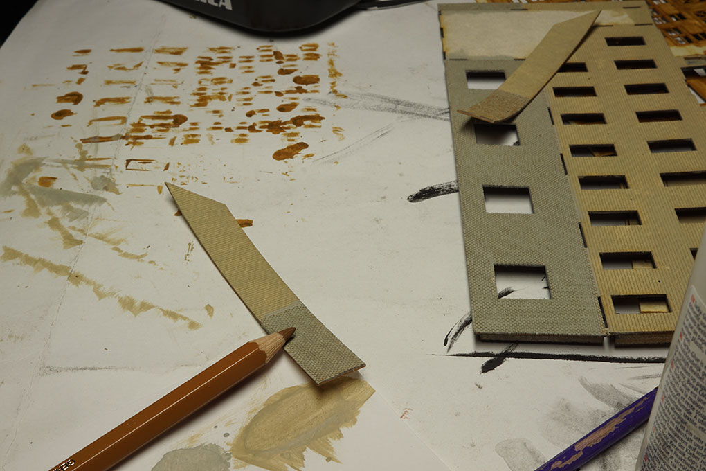

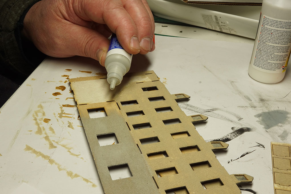

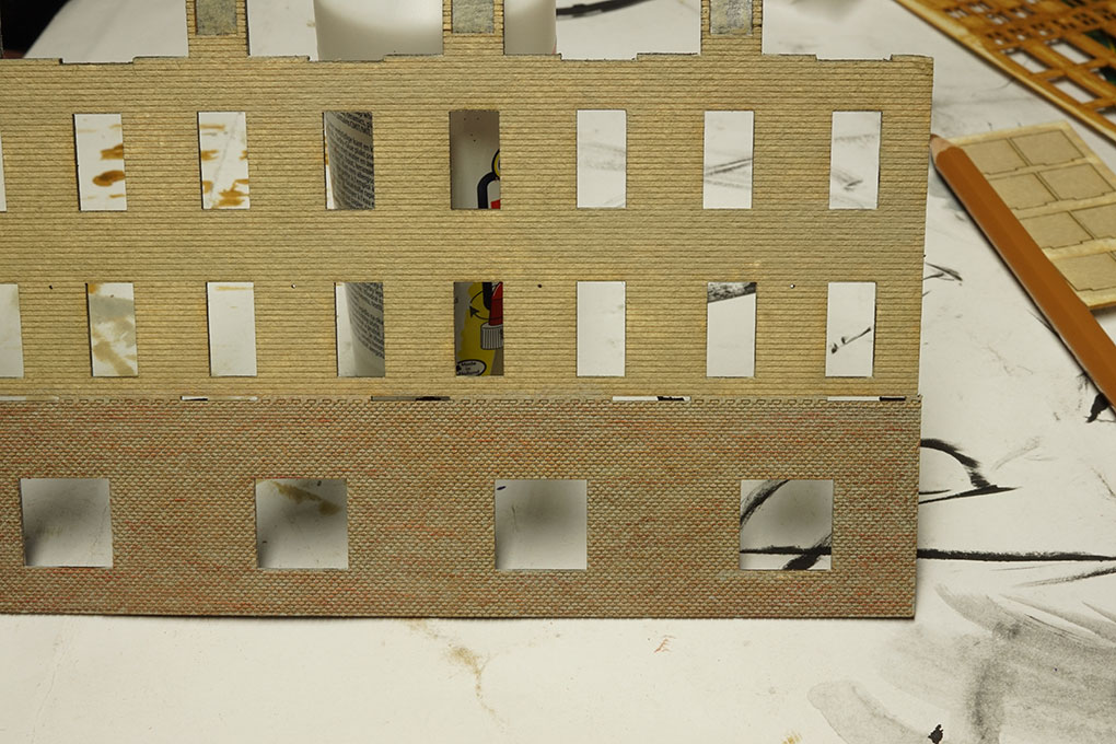

Time to give the outer wall some color.

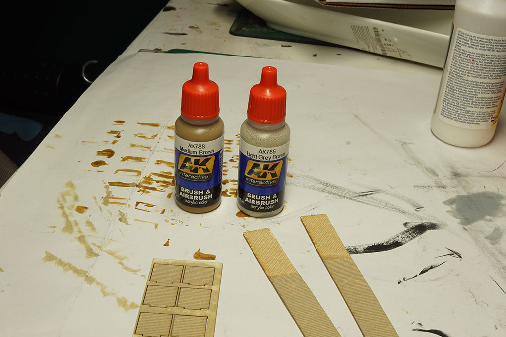

Some AK acrylics.
The board takes up paint so fast that I just held the bottle right next to my brush. Next time I will prime this material first.
Light Grey Brown is this color.

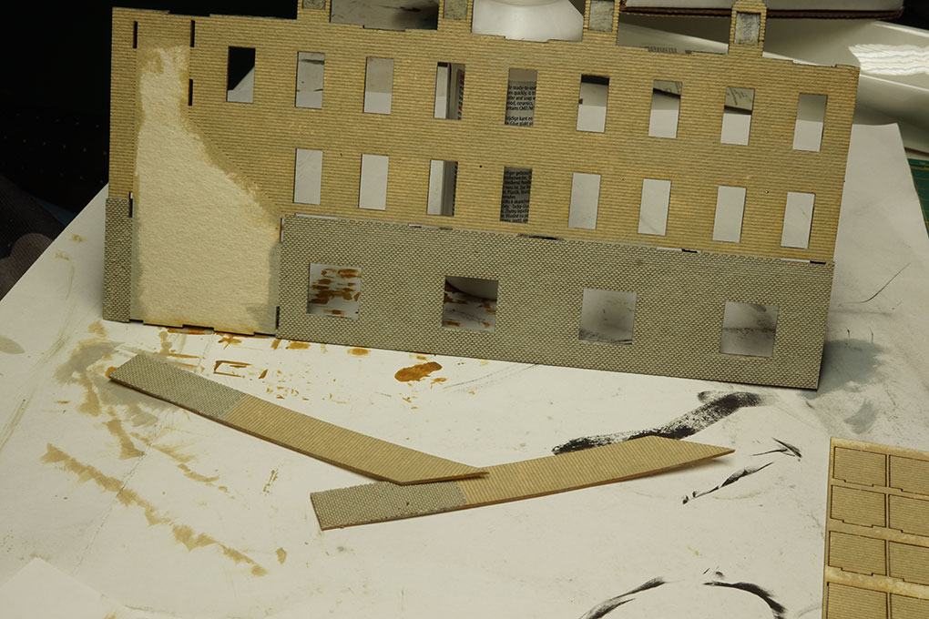

Then I got out my Faber Castell Albrecht Durer pencils .

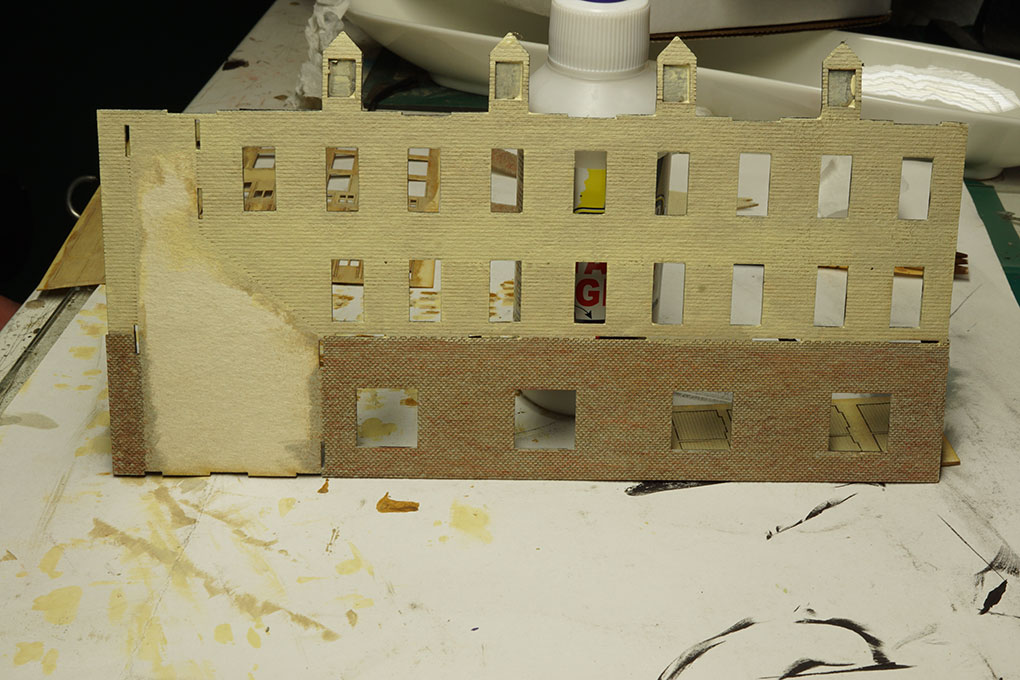

Using a few red and orange and brown brick colors Icolored the brick part of the wall .
In this photo the wood part of the wall had also been done with Polly Scale Antique White.
