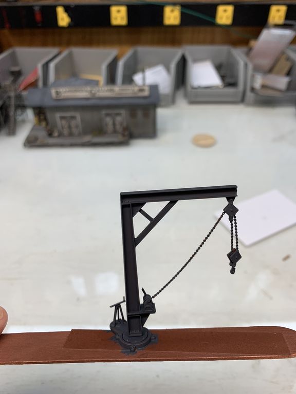

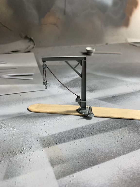

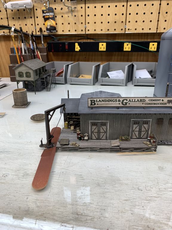

I got a few things done last night and today. I put together a Tichy crane and a little water tower for the scene.
I had a couple of these Tichy kits in my stash so I decided to build one for the scene. They go together very easily and quickly. Took me around 30 minutes to build it I think.
I primed it with a orange/red primer followed by a coat of Aqua-net hairspray then I painted it with Apple Barrel Pavement.
I used rubbing alcohol and small stiff brush to pull up some of the gray paint and expose the rusty color under it. I blended it all together with a few shades of rust chalk. This is one of the first times I've messed with this technique so I was pretty conservative with the amount of paint I removed.
I'm thinking about placing it here next to the loading dock on some type of concrete base.

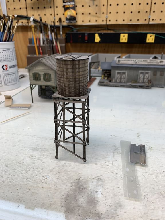

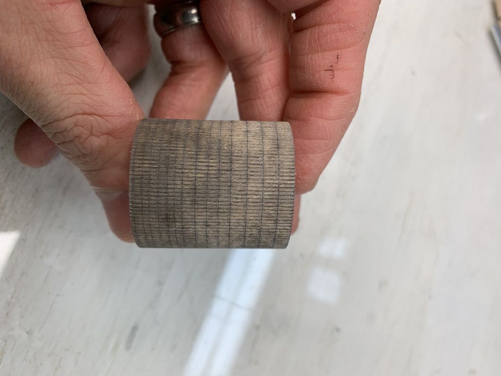

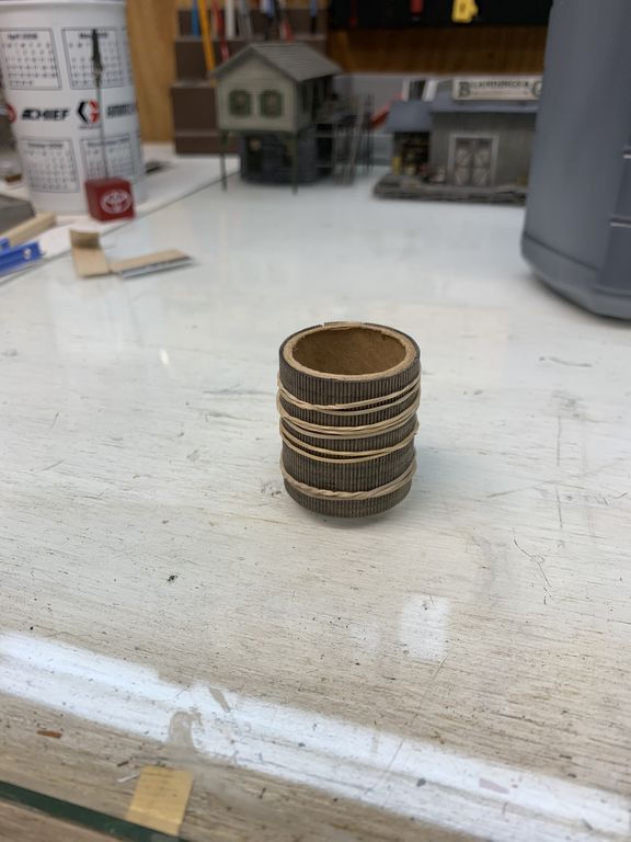

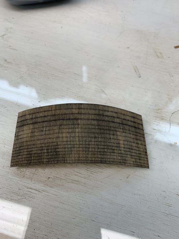

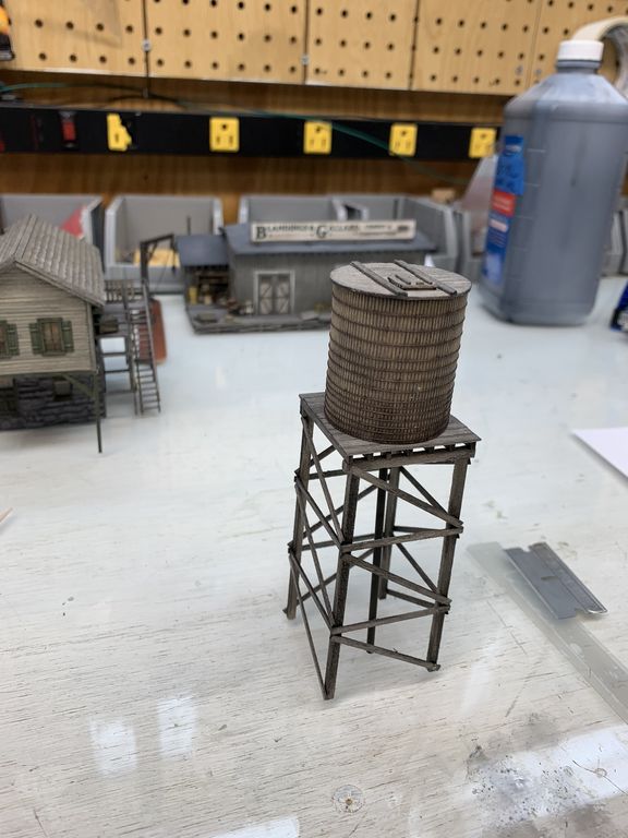

First step for me building a water tower is the scribed siding. I scribed horizontal lines in the siding and colored it with A&I. The scribed lines act as a guide for the thread I'm going to use for the bands. None of this was included in the kit I just wanted to scratch build one for the scene. I use thin scribed siding for this.
I used rubber bands to wrap the siding around the core which in this case is a cardboard center from a label maker used for printing oil change reminders for the corner of your windshield.
After everything dries you can see the lines and they leave enough of an impression that it will hold thin thread inside.

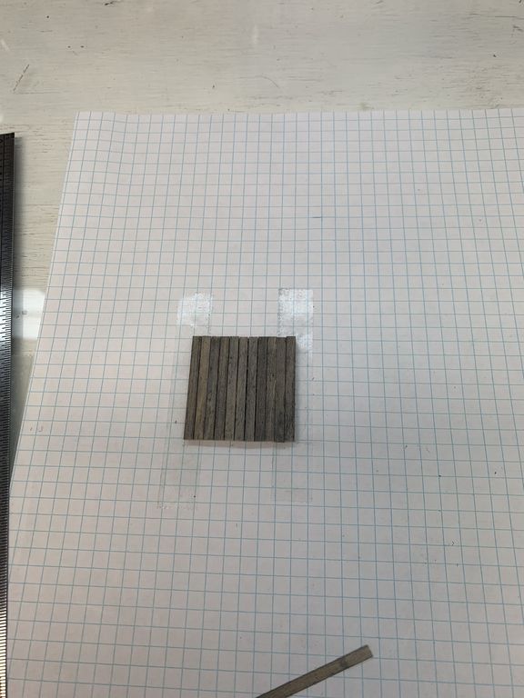

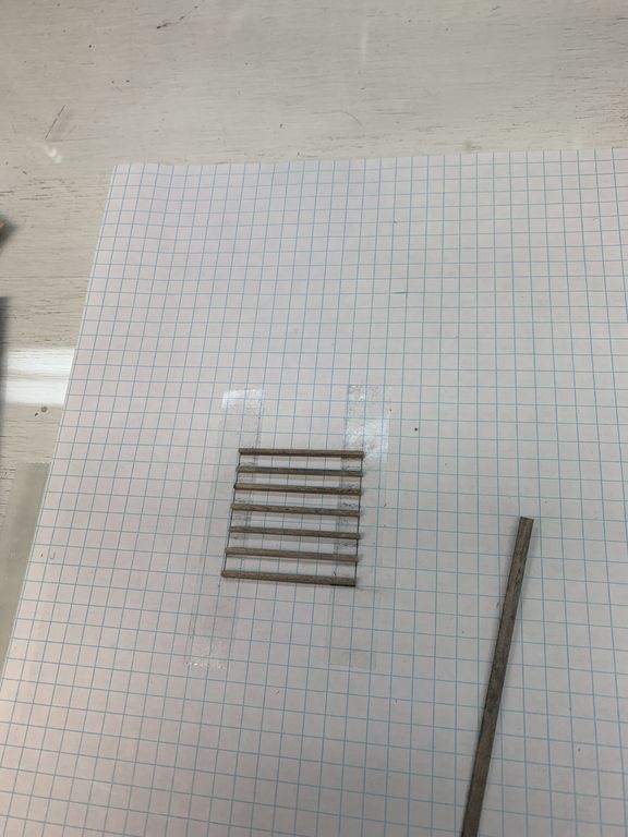

I used double sided tape to secure the bottom framework of the upper tank support. It will be about 10'x10'.
I covered the beams with planks.
While the support was drying I added the thread to the tank. I used some brown thread I got from Wal-Mart. I don't know anything about thread types so I just picked one that didn't have many fuzzies coming off. I secured the thread with a drop of super glue every 1/4-1/2" or so.

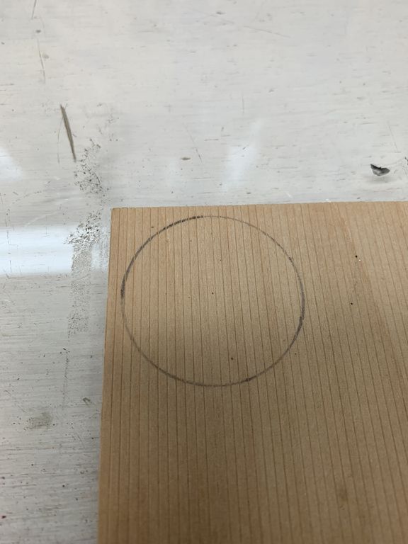

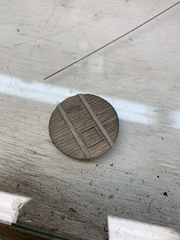

I wanted to build this tank with a flat top instead of shingled roof. I used a compass to draw a circle on some thin scribed siding.

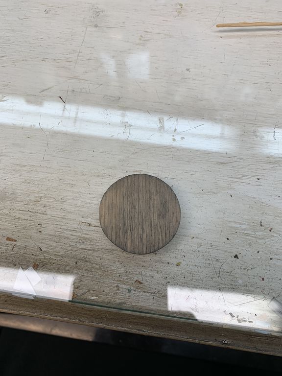

I cut out the circle and stained it with A&I.
Added some 2x6s as cross support.
I outlined the hatch opening with some scale 2x2s.
I built the door directly on top.
I build the water tank support structure right over some crude drawings I made. I made 2 of them.
I glued the supports on and added some cross bracing.
I ran out of NB&W castings so I had to order some. Once they come I'll be able to finish the tank. I'm thinking it will sit right next to the office building but I'm not sure yet.

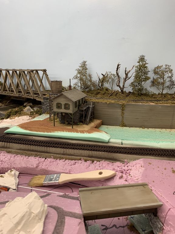

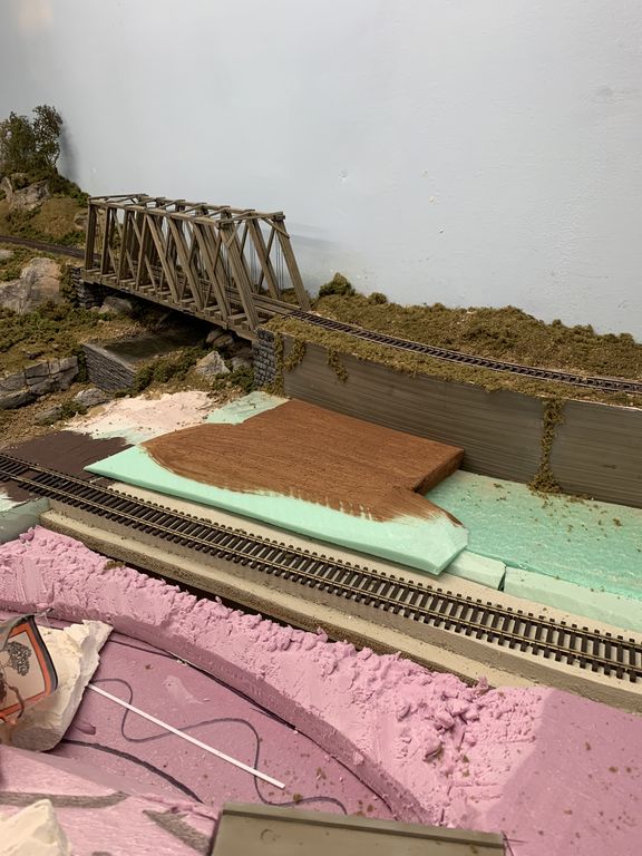

I made some progress getting everything laid out and figured out over the weekend. The natural placement of the structures in such a narrow spot felt a little challenging to me. I'm looking for selective compression of the scene but still have a natural feel.
I decided to elevate the office so I cut a piece of 1/2" foam and painted it brown as the base.
Glued the office structure down. Still wet in this picture.

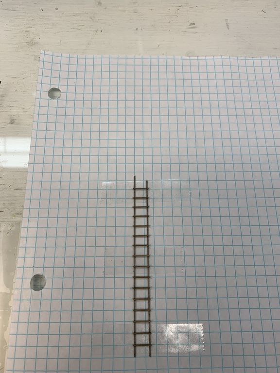

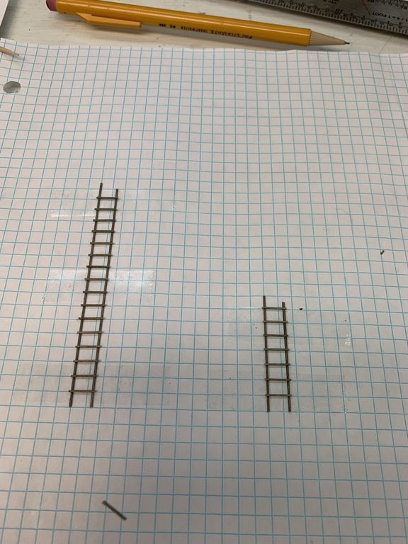

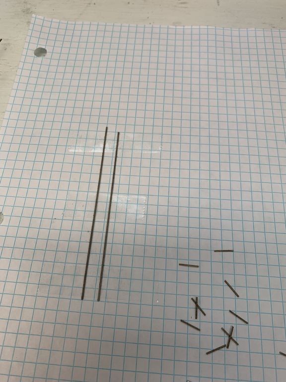

I wanted to add some ladders to the water tank assembly. This is how I build them cheap and easy.
With a chopper this took about 5 minutes to build. I used double sided tape to hold it in place while I put the rungs on.
I made another small one for the tank.

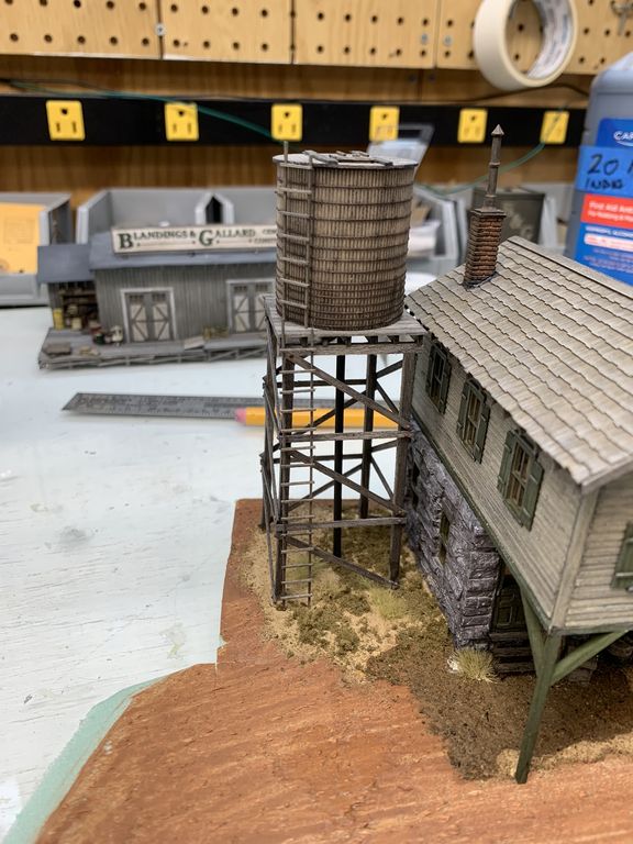

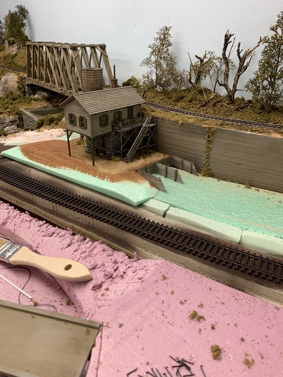

Ladders are in place and the tank structure is glued down. The scenery under the overhang is still wet. I added the little stairs under the front door.

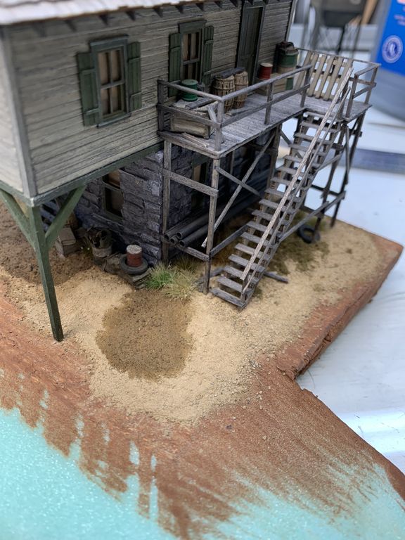

I added some details under the front porch. These type of scenes are a good place to use some less than perfect castings or some not so great paint jobs.
I added some pipes under the porch. They are made from Evergreen styrene tubing that I drilled out on the ends to make thinner. I sprayed them with dark gray primer and weathered with chalks.

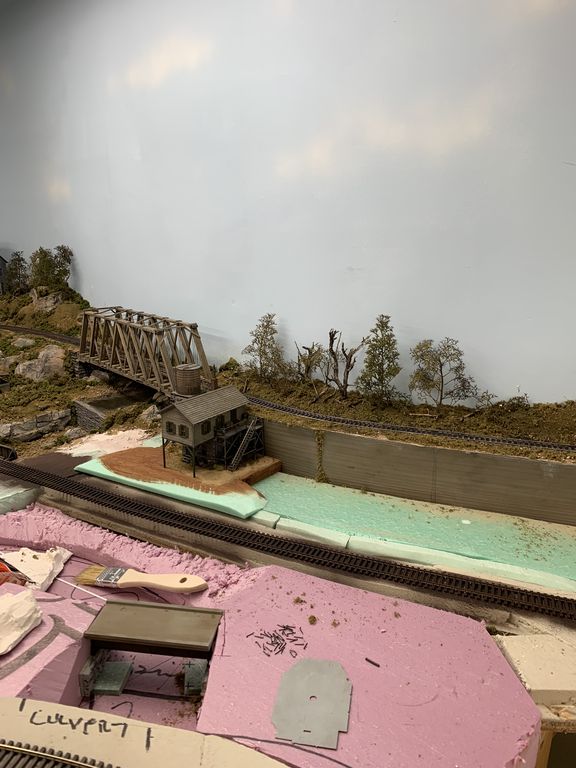

Here is the office glued in it's home.
I added the trees and foliage above and behind the concrete wall today. I'm still adding more there.
I build this wooden bin to use for some stone. This is not part of the kit either just something I thought would look neat.
This is where the bin will sit. I'll add a couple different types of stone in it.
I'm trying to get the main structures placed in there final positions so I can figure out what else I need to complete the scene.
