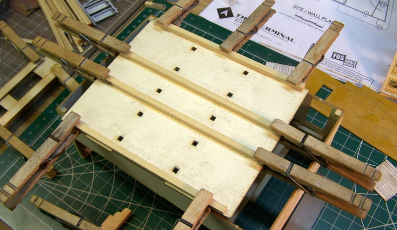

Continuing with the bus terminal, time to carefully brace the task board walls into a frame. No bracing diagram was suggested but a little common sense and test fitting the tab and slot corners allowed me to figure it out. I used quarter-inch and eighth-inch square bracing strips as appropriate. Below several shots from different angles.
And the ceiling. I added more bracing here than anywhere. Knowing I would later be fitting multiple support columns into this sheet, I wanted plenty of strength to avoid accidentally cracking the fragile material once that step came up.
And here is the completed inner frame.
