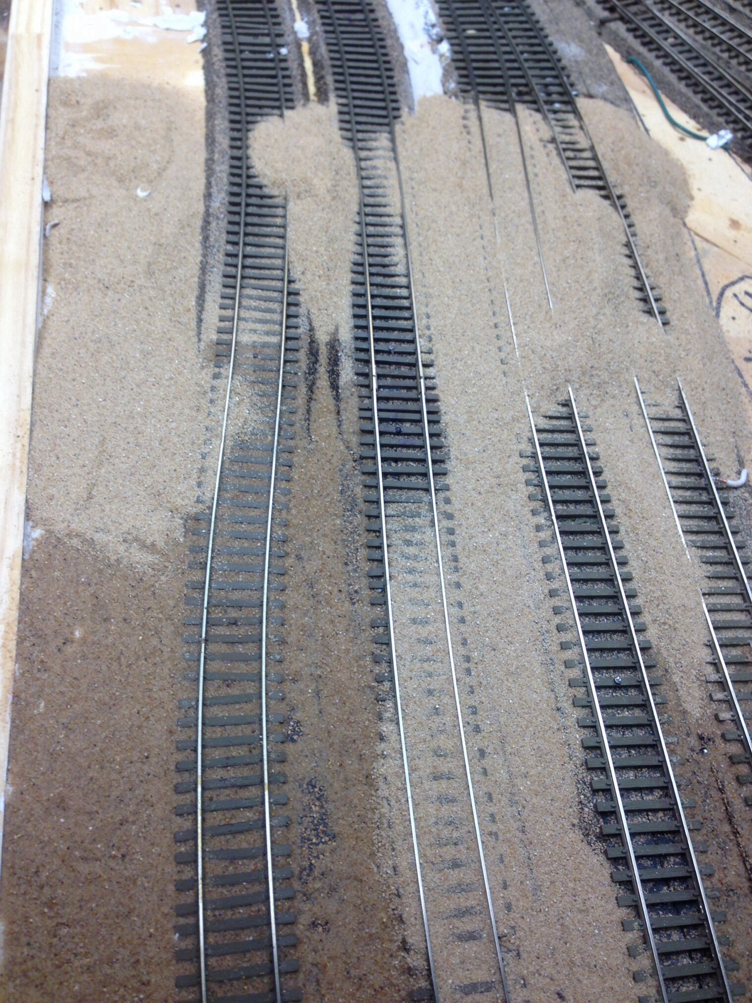

The first step in ballasting is to use good old beach sand to fill in the area around the track.  Here we are just getting started.
At this point the track work has been painted with rail brown paint and spiked down with track nails in the center. The sand is added to save on ballast. After the sand dries we will add the final coat of ballast.
The next step will be to remove the track nails and do the final cleanup of the track.  Then it will be weathered and detailed.
I will post pictures of each step as we go along. I'm using 4:1 white glue to hold everything in place.  The sand and the ballast is sprayed with wet water first and then the glue is added with a large turkey baster.

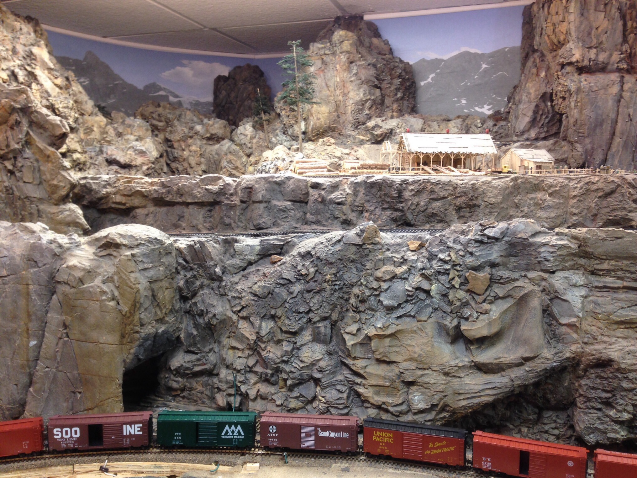

I have a narrow gauge wood trestle planned for the center of the upper level scene.  I also have the FSM sand house kit about 60 percent completed on my workbench that will go to the right of the saw mill on the upper level.

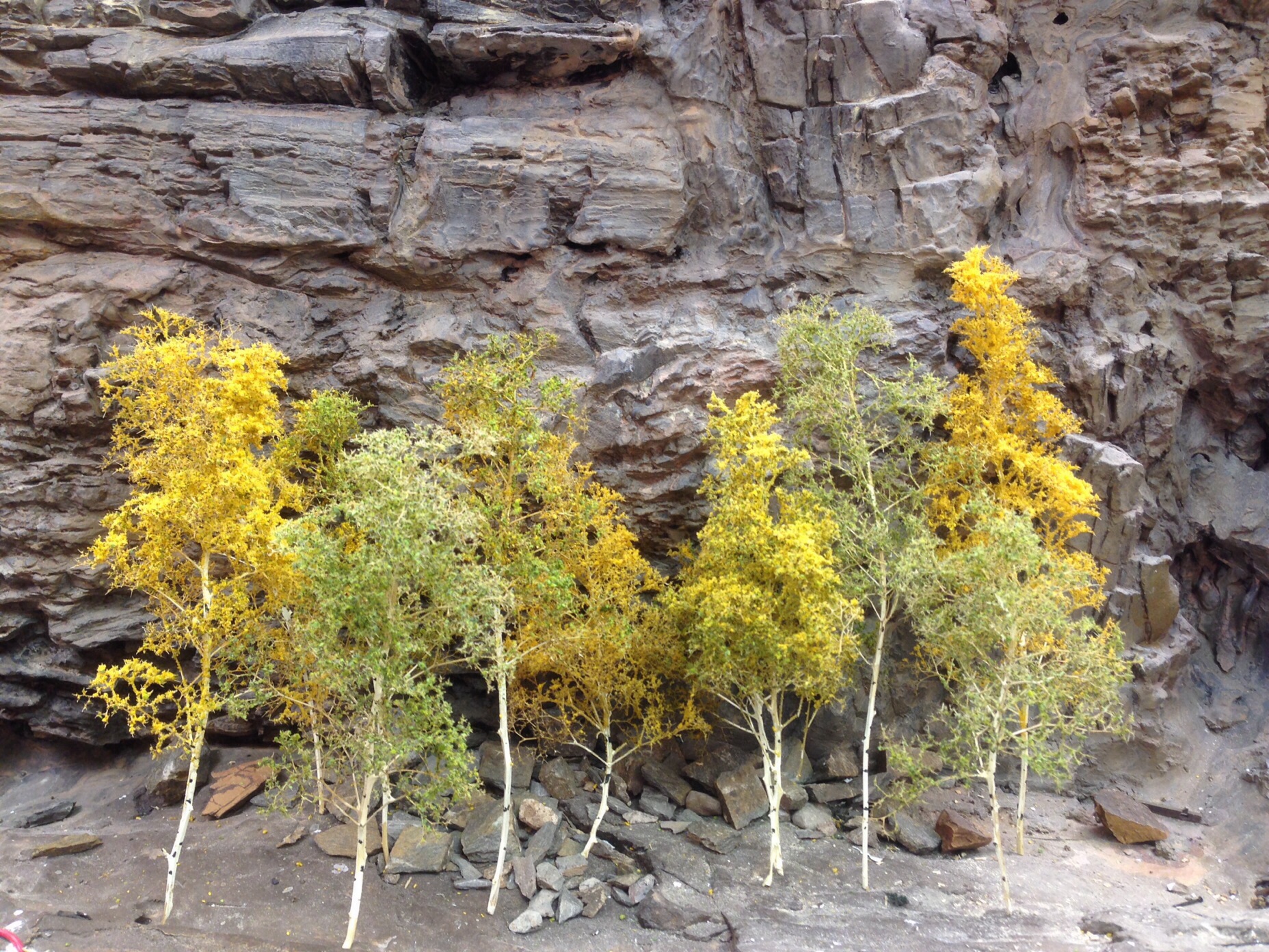

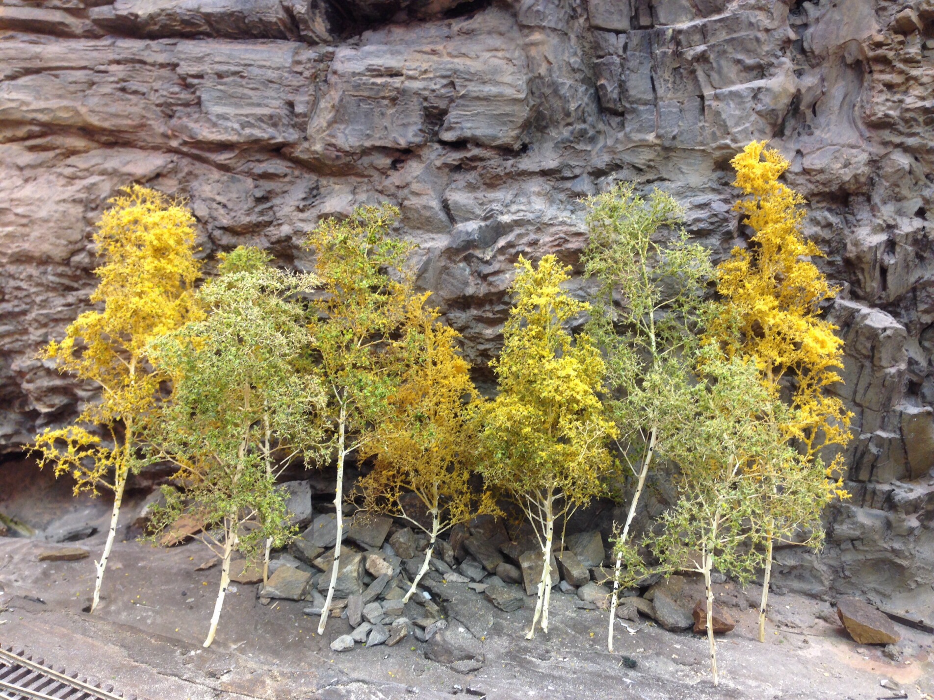

I'm playing with using fall transition colors in the higher elevations. Here are a couple of picture of my test grove of Aspen trees.   What do you think?
gnatshop
The Aspen trees look great!
I've never lived where they grew, but I've visited the area.
The black spots on the trunks definitely identify them, and they did grow out of
rocky barren areas that make you wonder if there was enough soil!
Their underground root sysem should continue to populate your higher areas!
A super addition for the higher areas.
John.............
Given David's remark above.............. he is absolutely correct about the nature of aspens.
I just got back from Yellowstone and this was a topic of conversation.
They have an extensive tuberous root structure that causes more trees to come from the root structures than from seed.  Thus they grow in tight groves and in rock draws and creases that collect water.  They also are stimulated by fires that fry off the tops.
They are also very susceptible to the pressures of grazing of animals.  They don't do well when the tops keep getting munched off by deer and elk.
However........ deer and elk are, like most other animals.......... an energy conservation machine.  People are just lazy.  They will search out food sources that are the easiest to gain access to. Thus if the hillside is step enough, aspens will come back very well as the critters will not work it unless they have run out of everything else.
So............ keep planting those aspens............. they look great.
