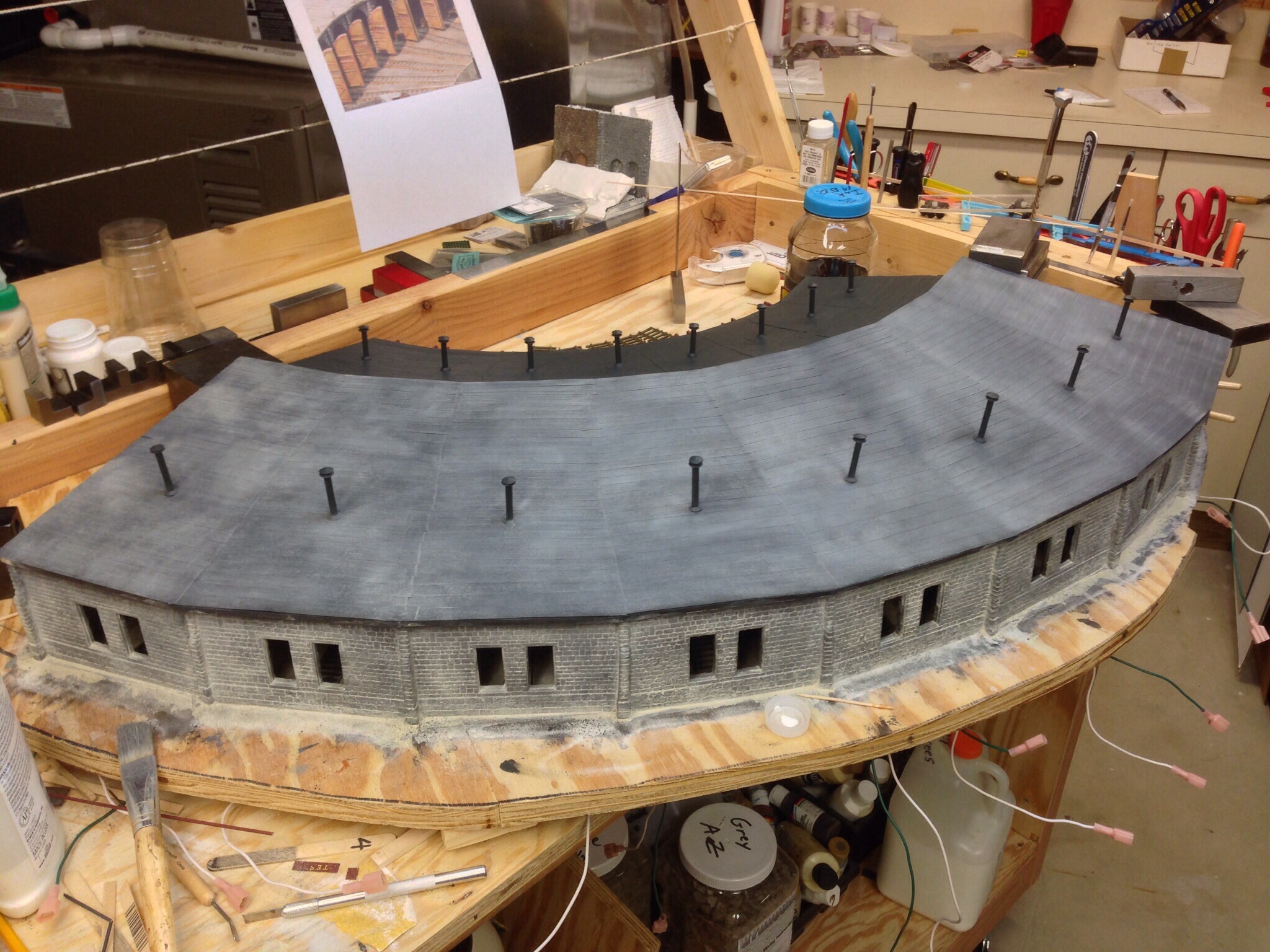

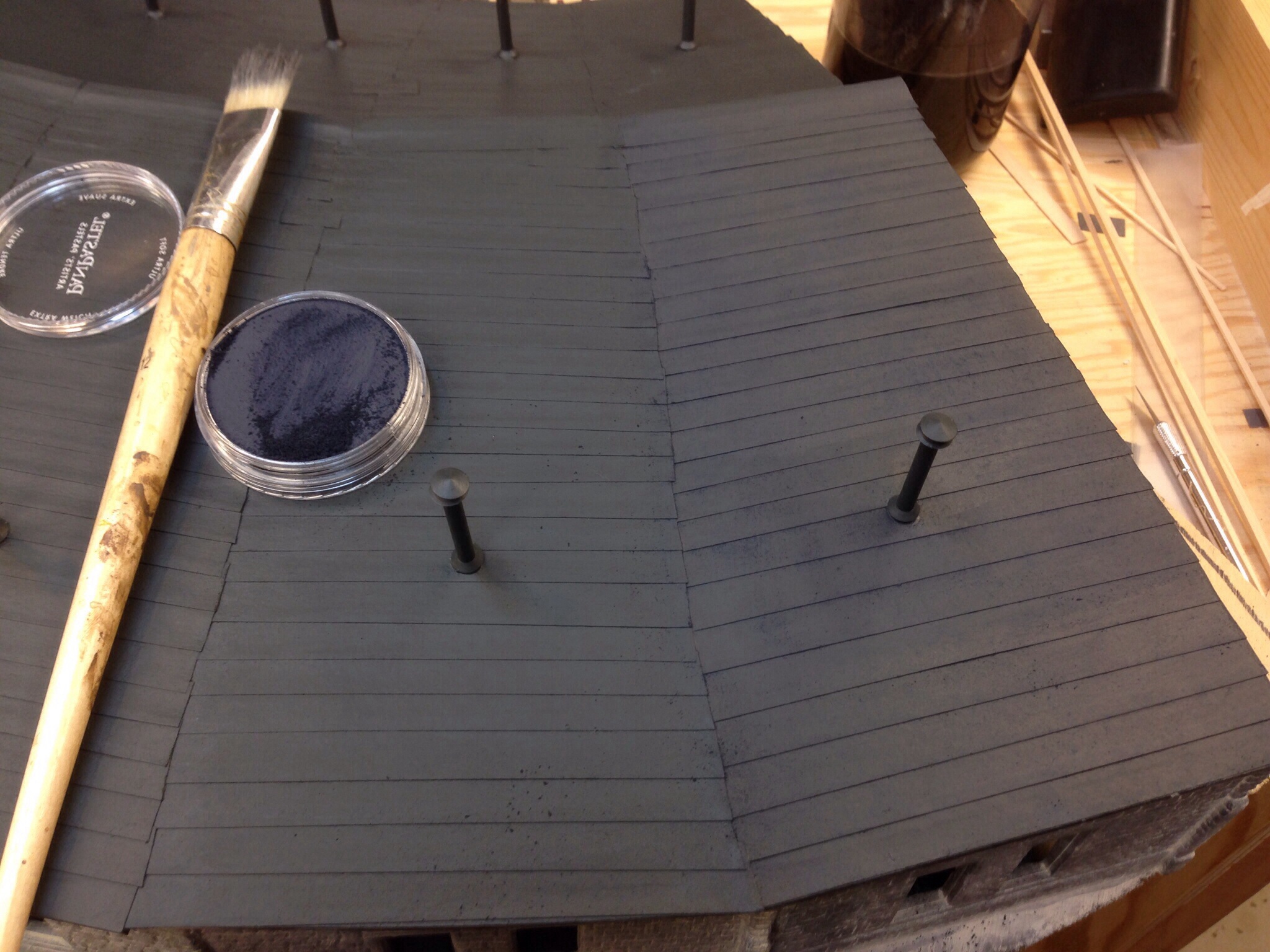

So here is what I did to fix the roof on the Stone Roundhouse. I started with a Paynes grey extra dark PanPastel in an attempt to get rid of the shine. It worked great. Then I started dry brushing with a neutral grey PanPastel. I used a brush and just kept adding more until it looked the way I wanted it too. The same technique I would have used with chalks. Here are a few pictures of the process and a final close-up showing the final look.  What do you think?
Step one Paynes grey extra dark PanPastel
Container labels for reference.
Picture showing the grimy black painted roof, the dark grey roof, and the finial neutral grey.
Final roof on upper area - lower roof is painted only with grimy black.
Close-up of the roof with the final brush of neutral grey PanPastel.  The amount of shading and highlighting can be changed by brushing on more or brush off more in any given area.  I'm going to let this sit for a couple of days and see if I continue to like the affect.
The one suggestion I'd make is to go back and see if you can gently change the color/tone on some individual strips, so it doesn't look like each strip of roofing paper weathered identically.
This is a great application of Pan Pastels to achieve coloring/color blending, weathering and flattening.  They're a lot of fun for this kind of project.
Quote from: deemery on September 18, 2014, 04:35:05 PM
Thanks for the comments Dave and I agree.  I'm going to take some pictures with the SLR before I move the Roundhouse to the layout.  Looking at the pictures on my monitor vs. on my IPad the close-up really washed out the differences in color that I see with my eyes.
Any changes will be under the layout lights.
Quote from: S&S RR on September 18, 2014, 05:33:07 PM
[size=78%]Thanks for the comments Dave and I agree.  I'm going to take some pictures with the SLR before I move the Roundhouse to the layout.  Looking at the pictures on my monitor vs. on my IPad the close-up really washed out the differences in color that I see with my eyes.[/size]
I think it was John Allen who first highlighted the use of a camera as a modeling aid...
Quote from: deemery on September 18, 2014, 05:45:13 PM
Dave
I believe you are correct and I know it's one of my most important tools. I'm always amazed at how different pictures look with different cameras and different monitors. The retina display on my Ipad has become my standard - looks the closest to what I see with my own eyes. Look at the difference in the colors from the overall shot above to the close-up. Same camera just how the iphone camera was dealing with the white balance.

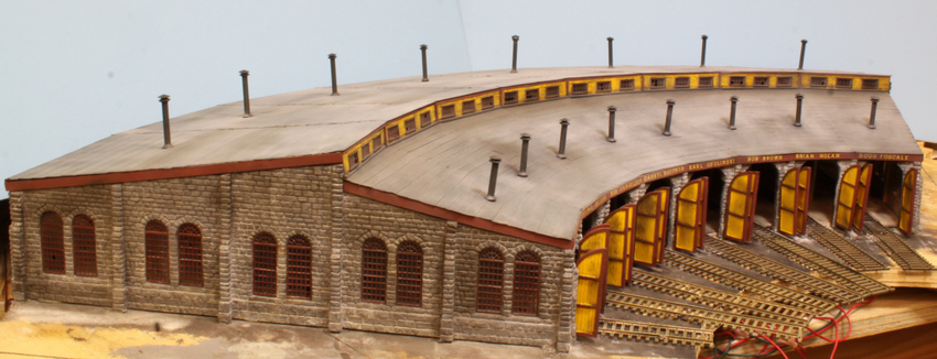

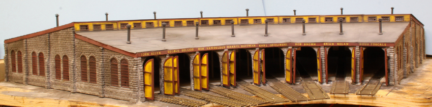

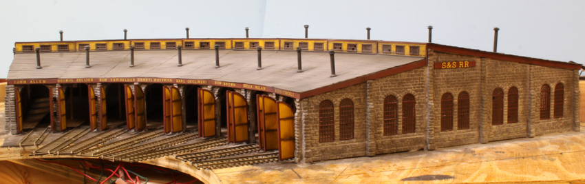

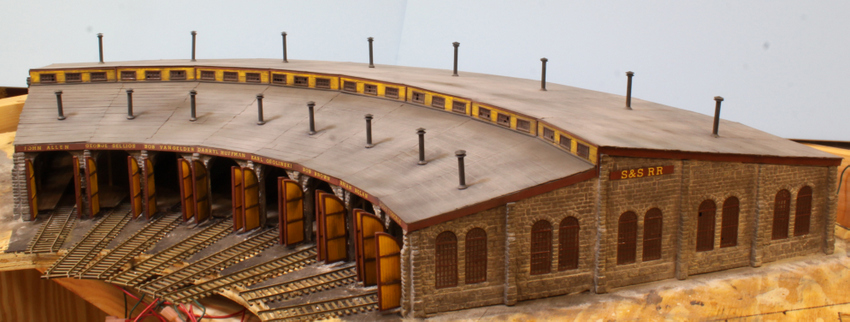

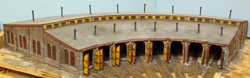

The work on the Stone Roundhouse for the S&S, that I wanted to complete on the workbench, was completed today.  I took a few photographs on the workbench before the move.
Just great. Just like the Aspens, those colorful doors and accents will "pop" against the stonework and rocks behind.
I'll say it again......
I sure hope you don't spoil this great engine house with diesels.
Great build
Thanx
Fantastic work John and well worth the wait to see it finished.
;D ;D ;D ;D ;D ;D ;D ;D ;D ;D ;D I sure miss the other forum little icons so you have many thumbs up here.
