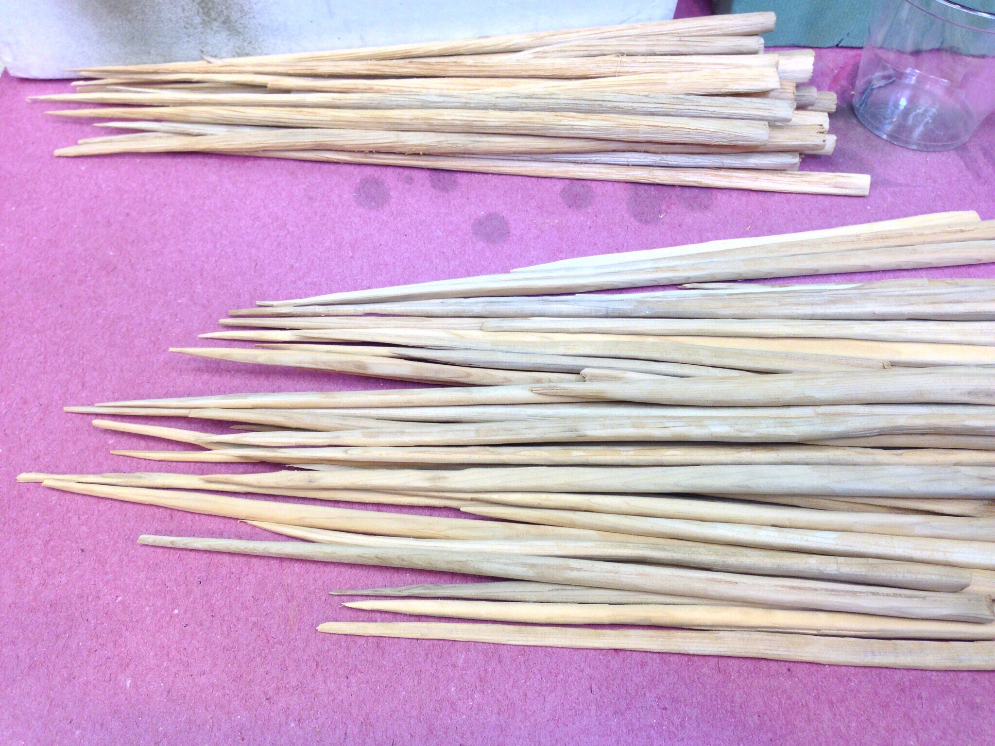

I started another batch of Pine trees yesterday and I promised someone at the EXPO that I would post a couple pictures of the process I use for the cedar shingle armatures.  In the past, on this thread, I posted the pictures of the belt sander that I use to take the pieces of cedar shingle down to a tapered dowel.

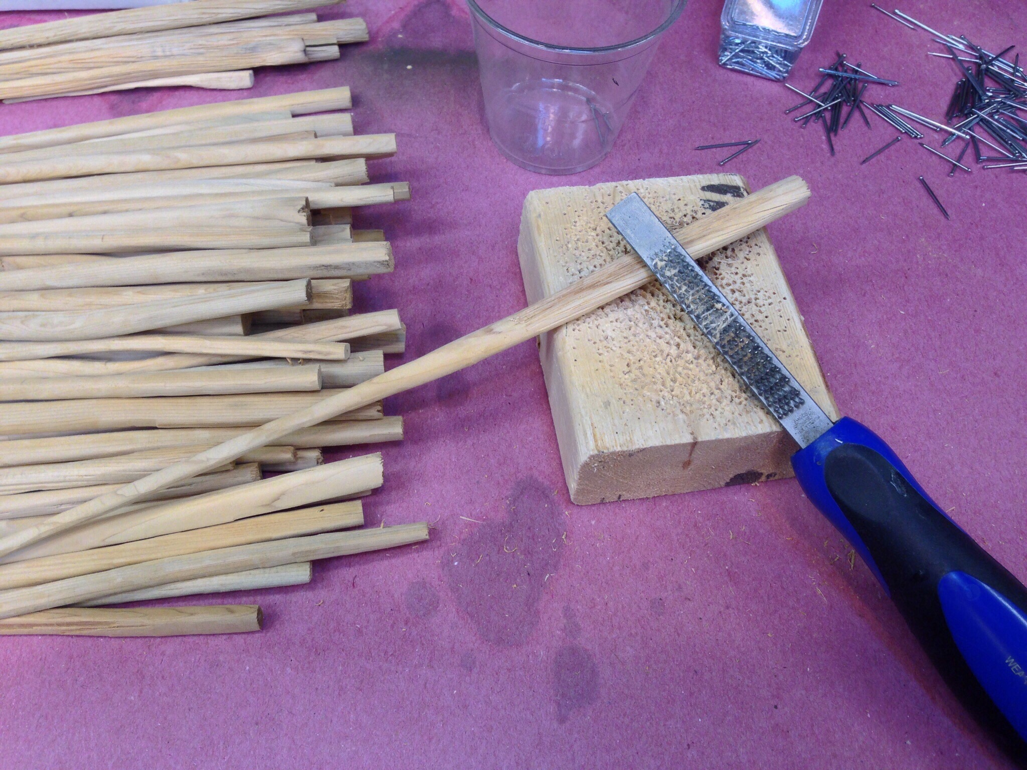

The next step is to use a rasp to cut deep bark lines into the armature.

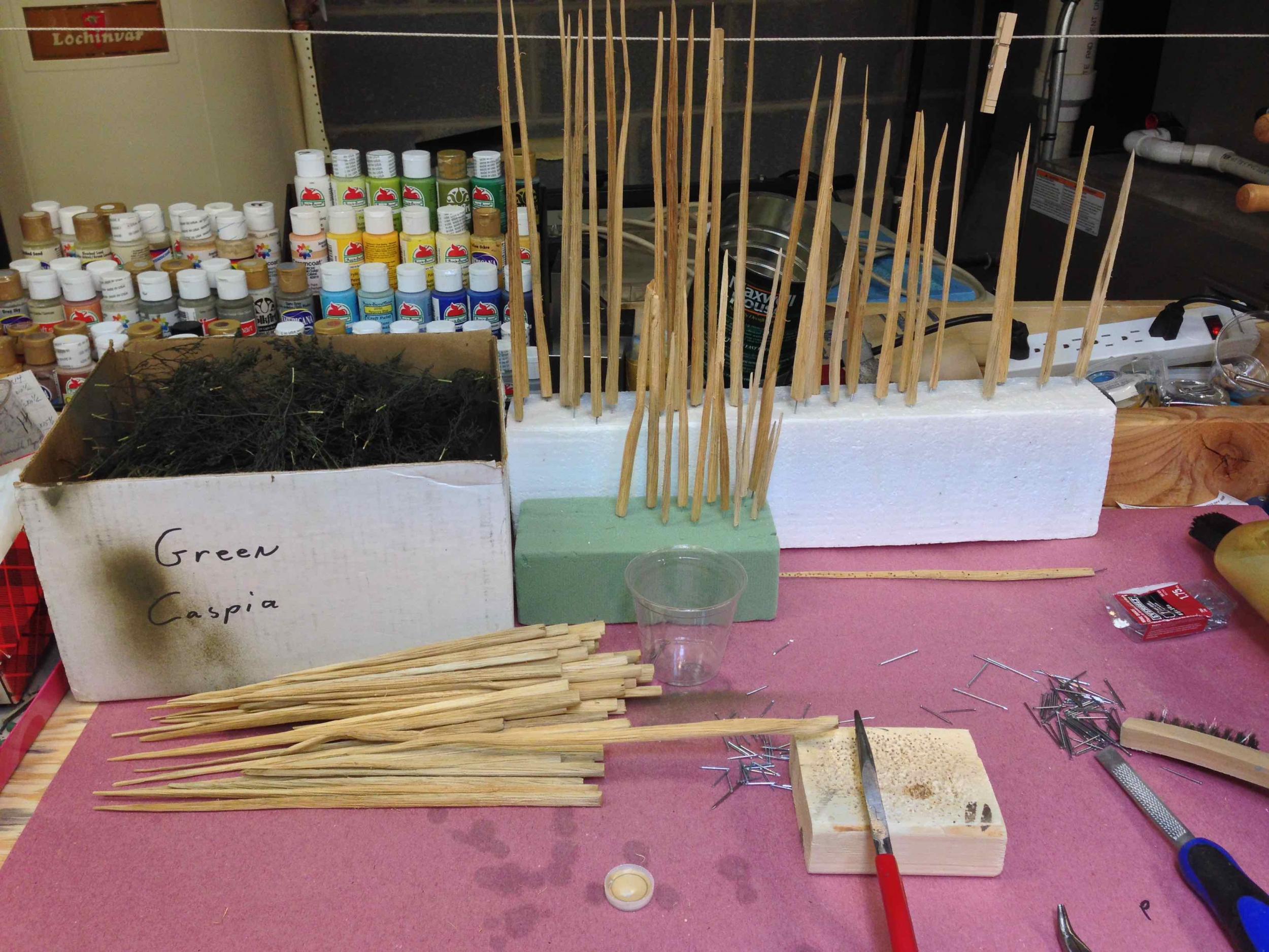

I make these armatures in batches of about 100.
Next step is to add a nail to the base of each tree armature.
I forgot I'm keeping track of the time to make a batch of 100 - total for this batch so far is 2 hours. But who cares it's a hobby and I like the way these trees look on the layout.

WOW John, you're a tree making machine.  Nice texture on the trunks.  Great tip using the rasp.

Here is an update photograph of the Pine Tree Armature process.  Today I finished the bark on the batch of armatures and also added a nail in the end of each one to help in planting and handling through the rest of the process.  Next, I will drill the holes for the Caspia Branches.
Total time on this batch is now 3.25 hours.
