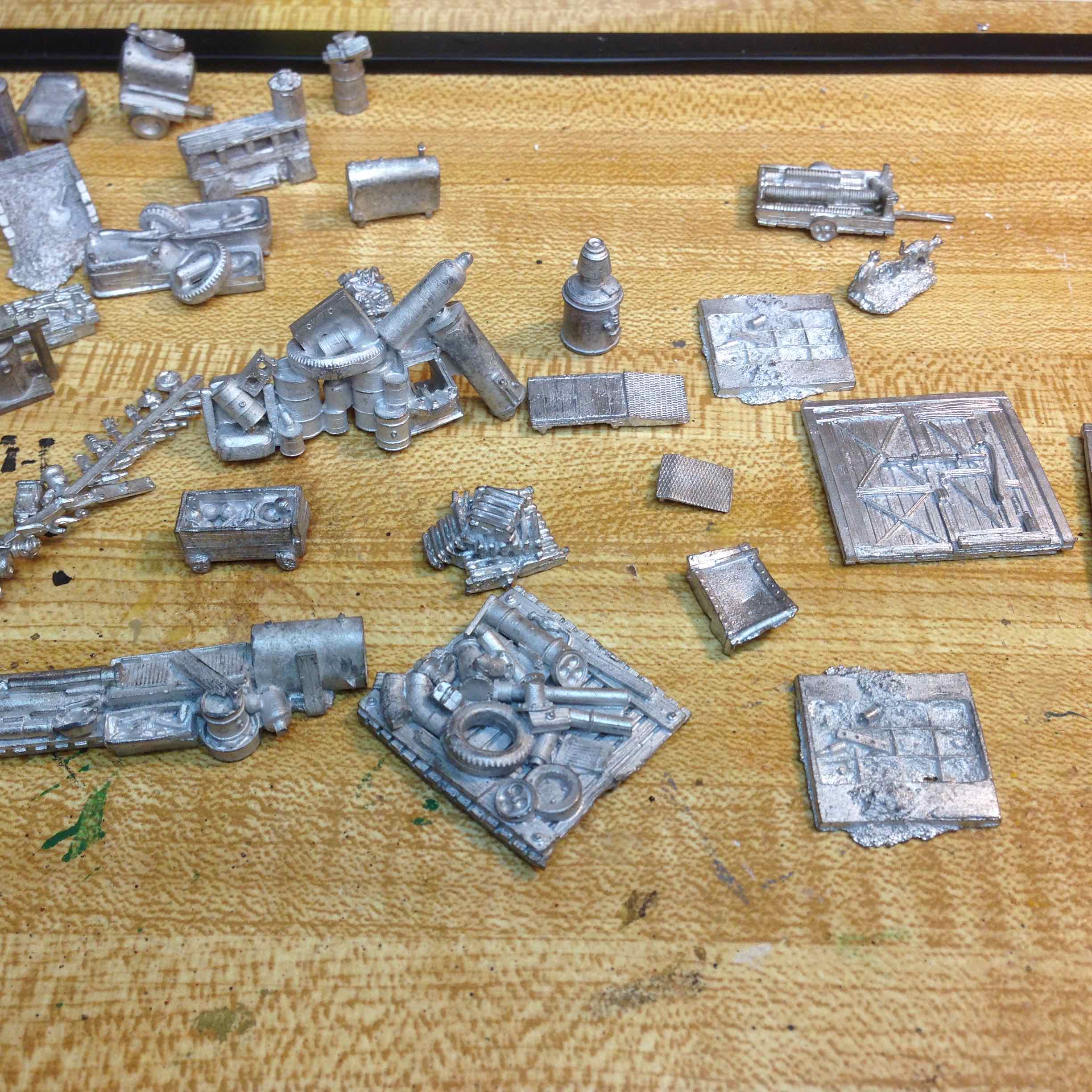

I also started getting those wonderful FSM castings out of the box and ready for primer.  I can spend hours looking at the details George has carved into his original molds.   Can you find the rat?

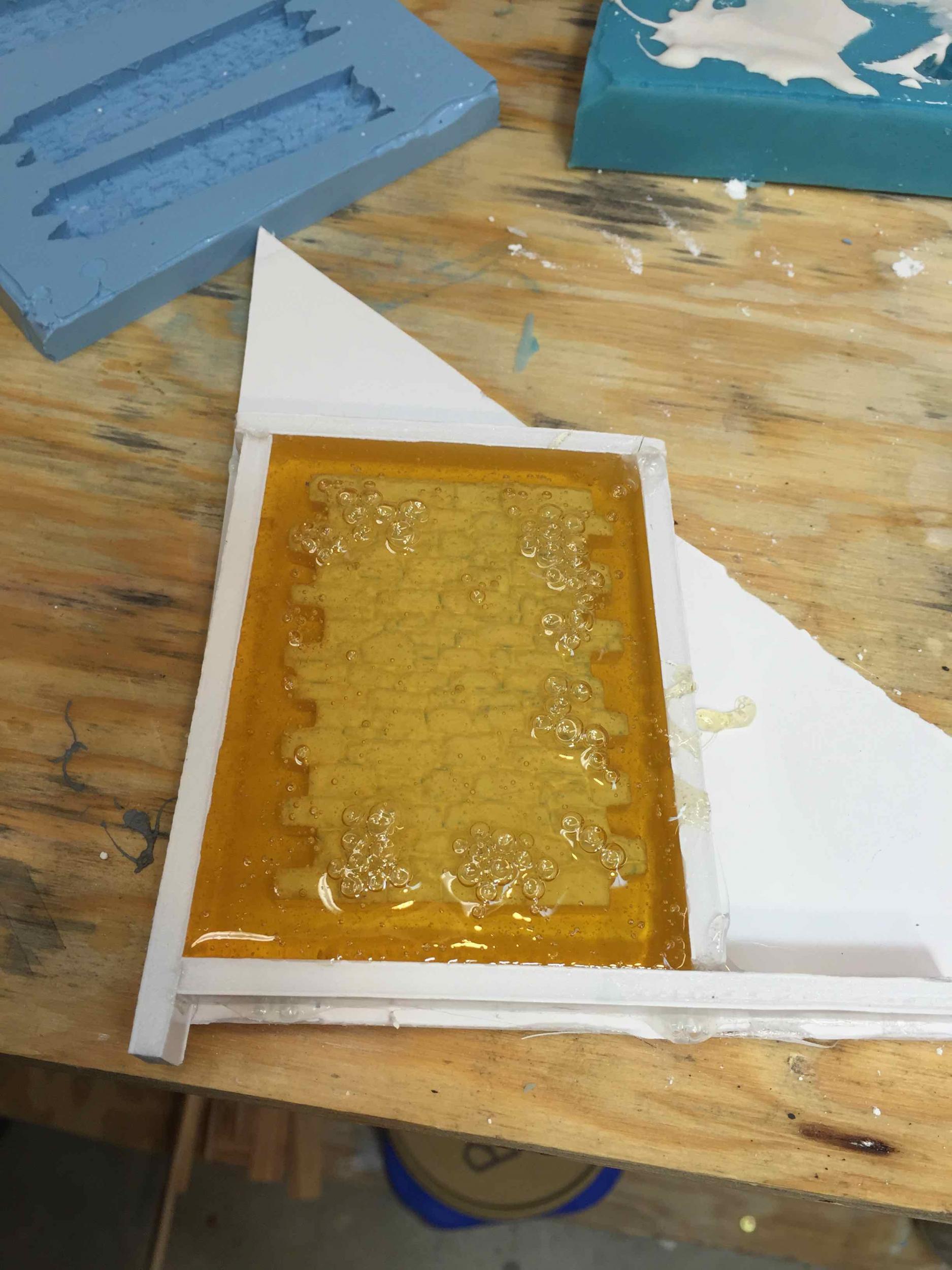

Field test report - on my  "molding process".  We are not going to use the other word for awhile - Tom is on the mend.

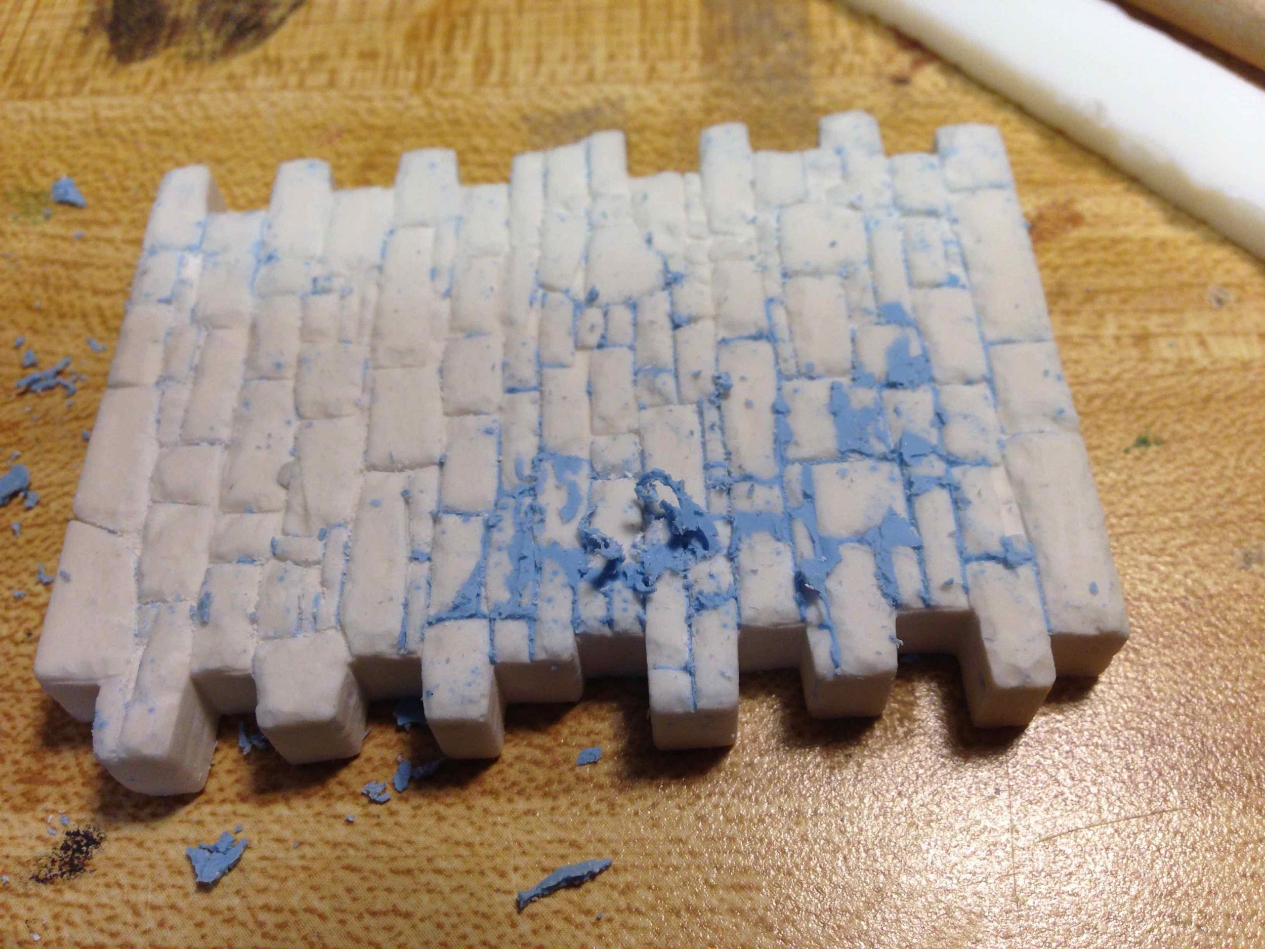

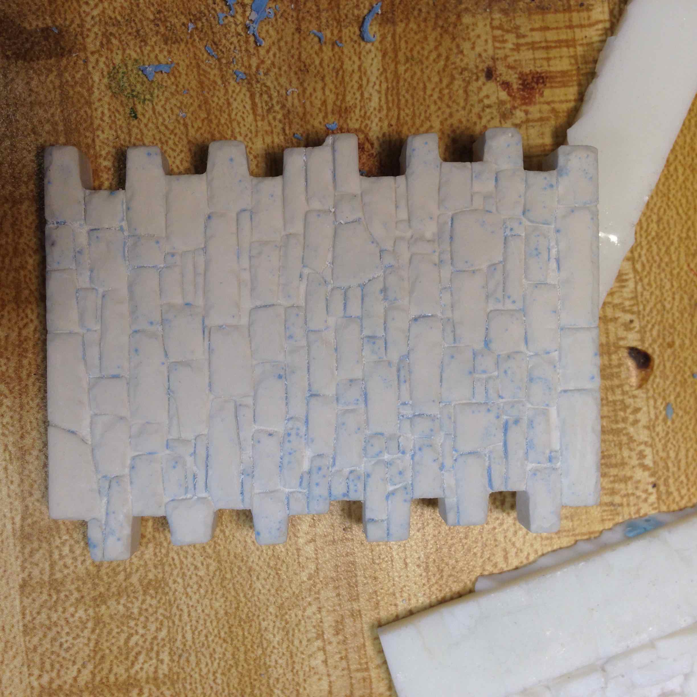

I bought some 30 minute cure time rubber from Micro-Mart.  It was on sale!  I have used lots bottles of the 4 hour cure product without a problem.  So as you can see from the pictures the 30 minute cure didn't cut it.  All the detail pulled off with the original c******  when I tried to get it out of the mold.  I should have thrown the bottles away but decided to try one more time and got the same results see picture 4.  It took two hours to restore the wall section in the first two pictures. Although it did fill the air bubbles in the original c*******.  Since this is a build thread I think it's important to report our failures along with the successes - let me know if anyone has had better luck with this.  I just looked at the Micro-Mart catalog and only saw the 4 hour cure available.
This is after I had been working at it for awhile and decided to post some pictures.
The good stuff.  The bottles of the 30 minute cure were already in the trash.  I placed them there with proper sendoff.
The original c***** that I pulled out of trial two.

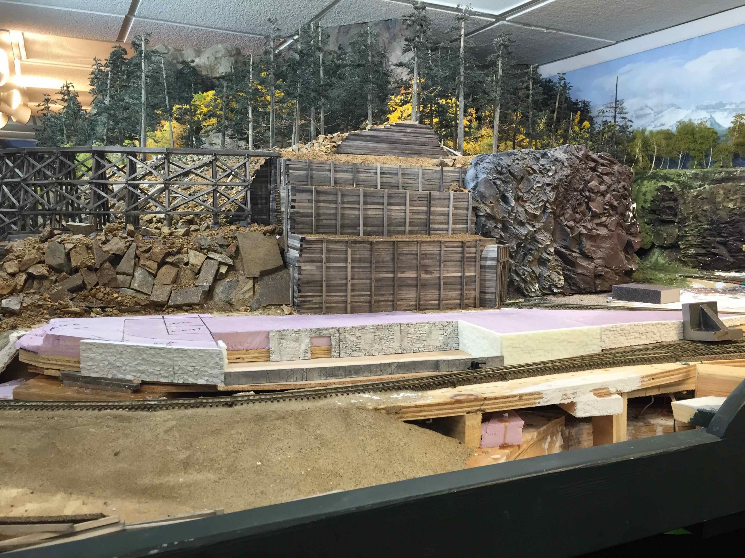

Here is a picture of the base for the build with all of the extra castings fitted and ready for the paint booth.  The base will now be moved to my workbench.
The casting are in the paint booth.  I'm using Krylon Sand as my primer coat.  Three different materials for the castings - the metal casting from George's kit, plaster and resin castings for the retaining wall.  I'm very interested to see if I will be able to tell the difference after painting.

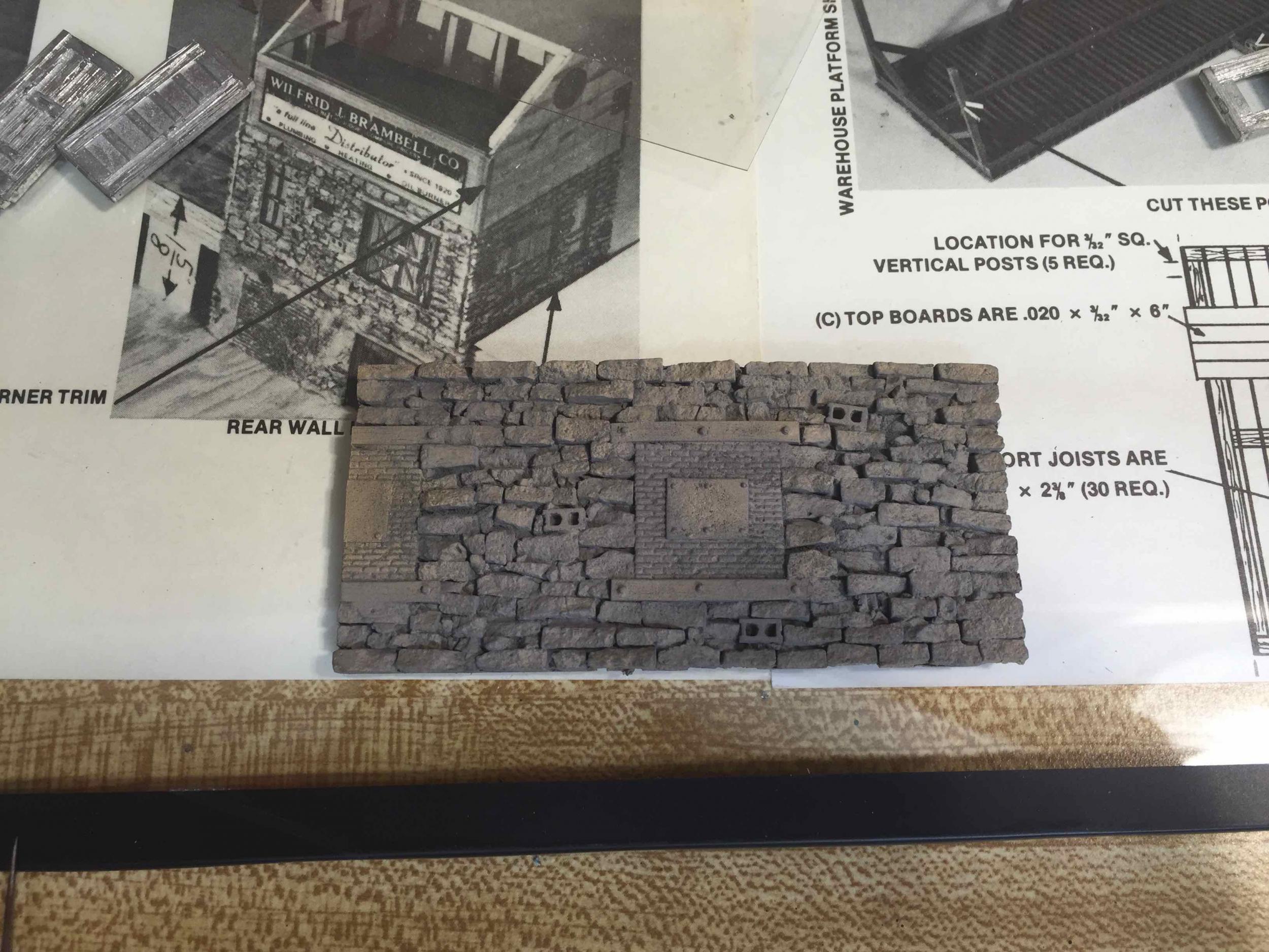

I started painting the wall castings today.  I'm using pastel chalks for their natural colors and textures.
First step was to add the motor grey in the cracks.
Step two was to remove some of the grey color from the surfaces of the stones leaving it in the cracks using an eraser.
