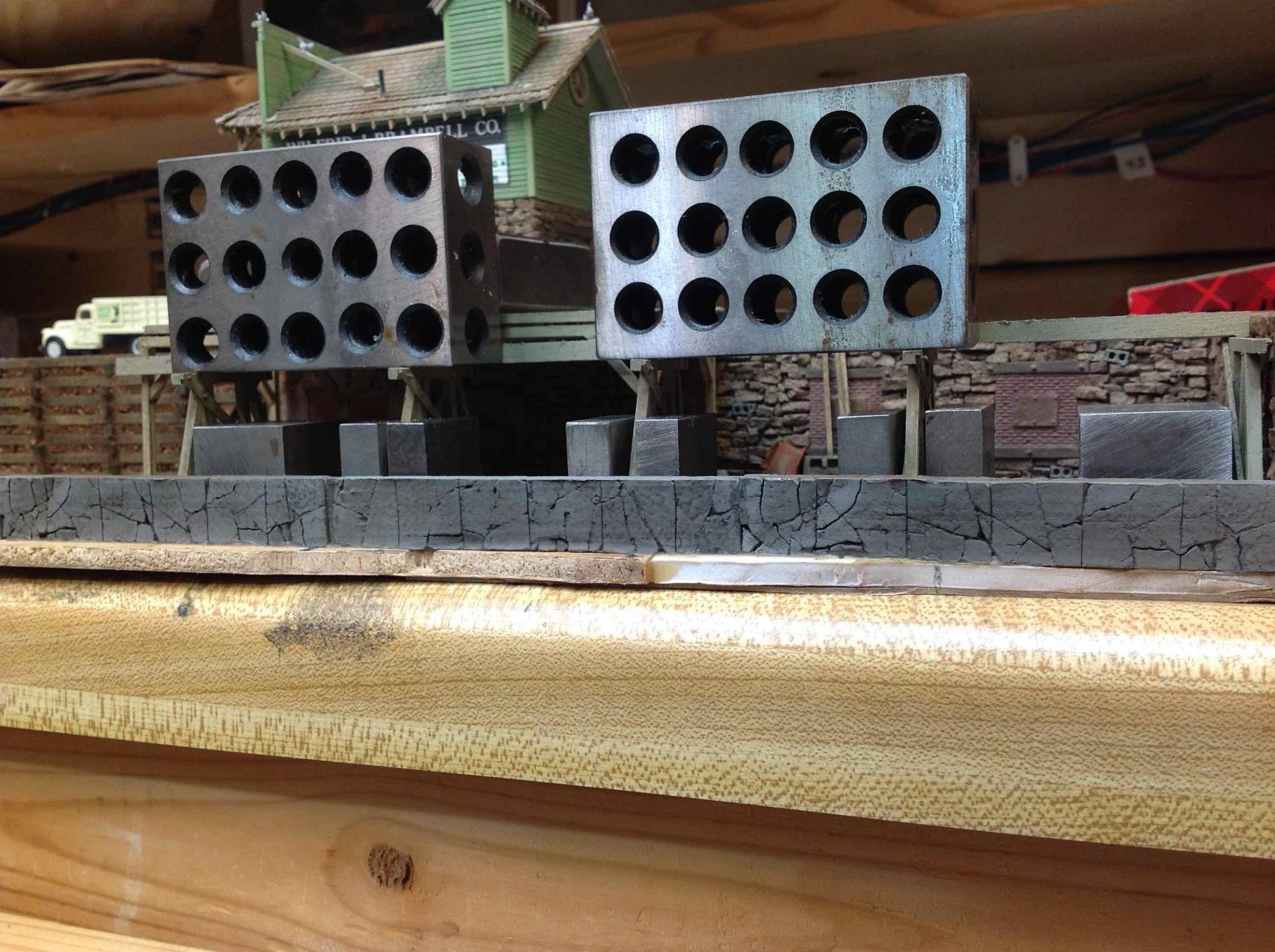

I'm using my iPhone more and more as a modeling tool. I cut and sanded the legs for the deck until it was level.  Keep in mind that the base has to be level on the workbench and on the layout for this measurement to mean anything.

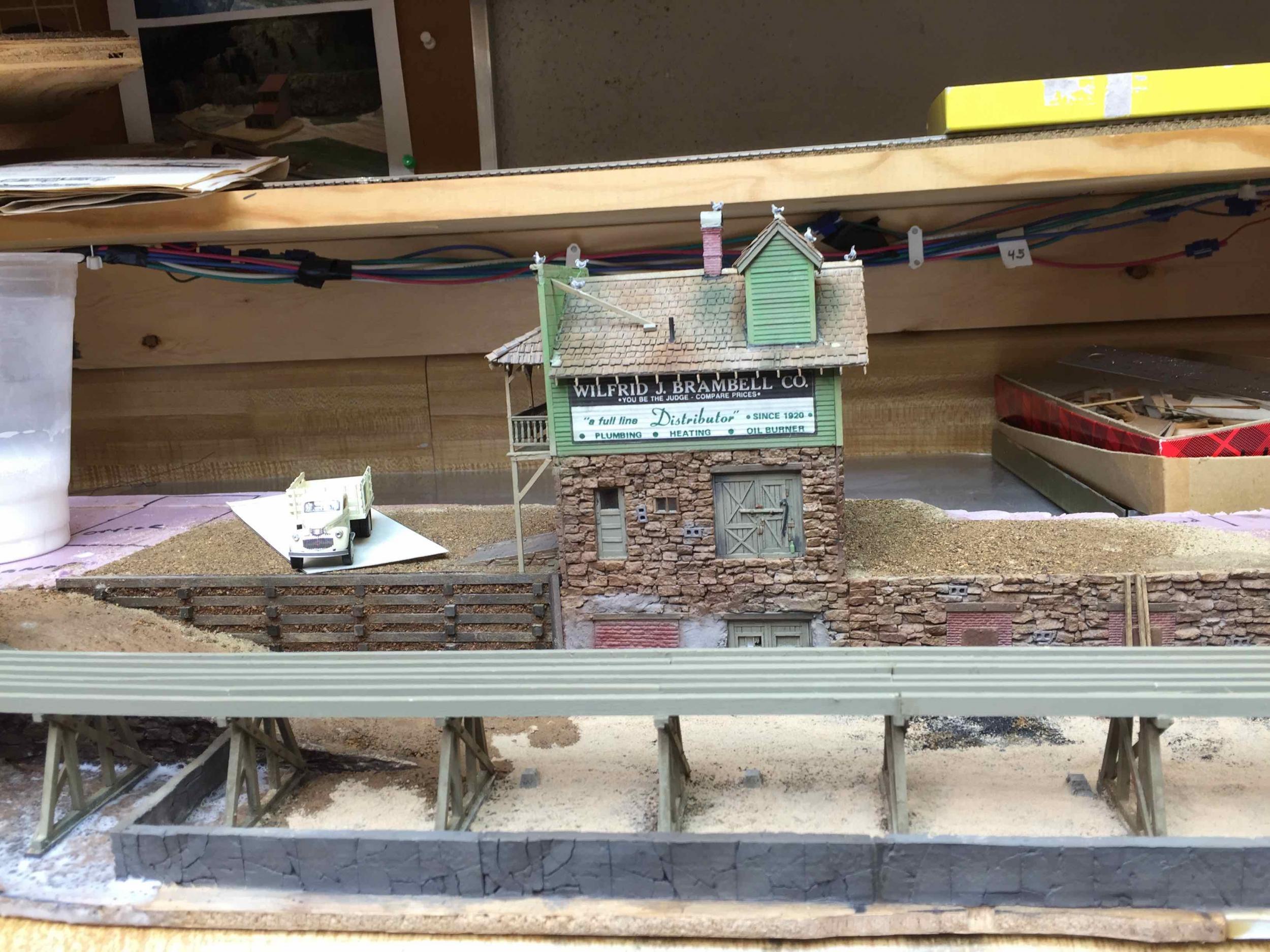

A few more progress pictures of the trestle install.
I also install another section of stone wall to support the dirt road that will serve as a ramp for truck traffic into the pit area.  In the instructions George makes this out of cardboard and then fills it with plaster.  I decided to add some more stone work and fill it with sand.
At this point it is time to remove the deck and fill in the pit area with dirt and then the details before I add the top deck to the trestle.

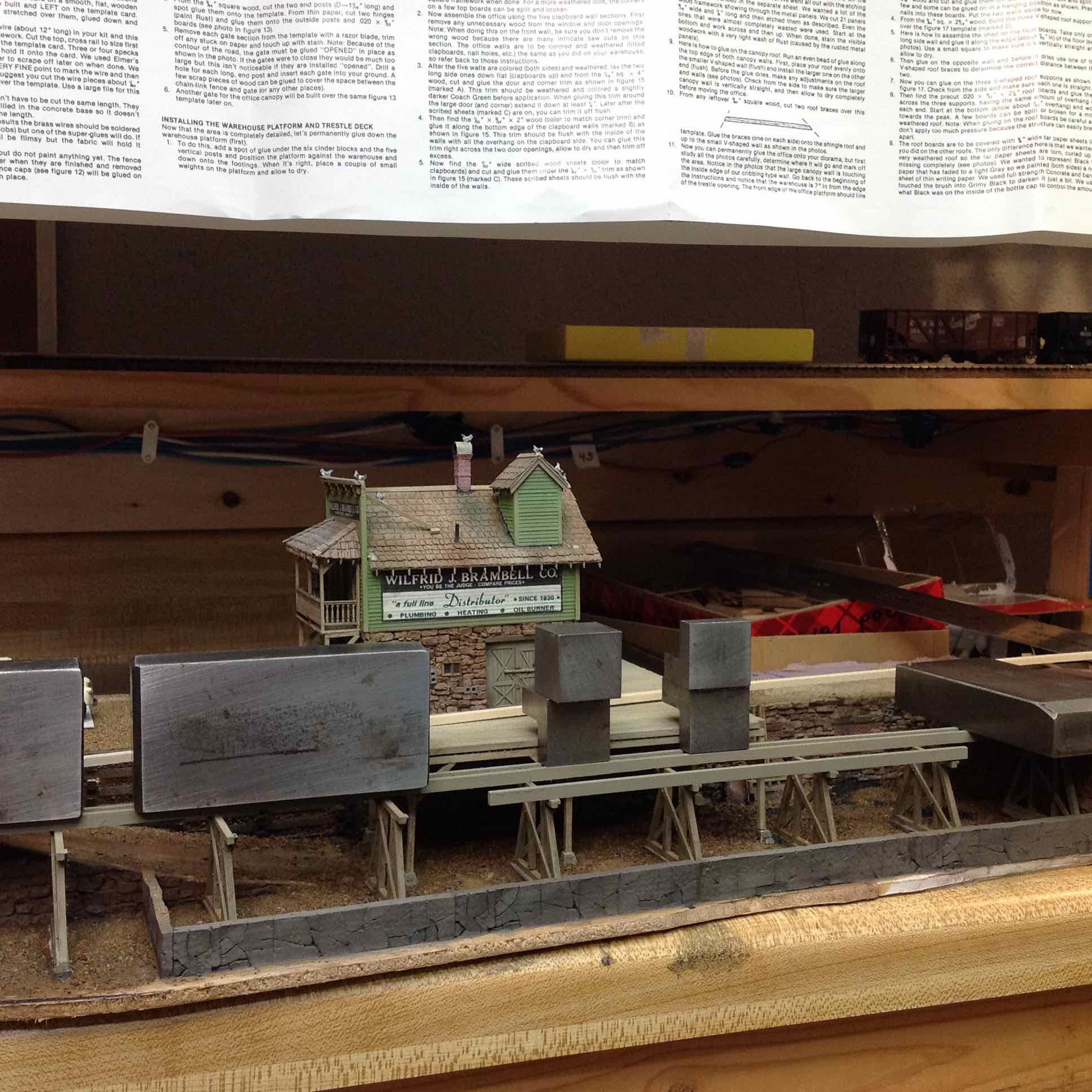

The next step in the build will be the main beams on the trestle.  I got the first couple glued in place before dinner.
The directions in the picture above are Sheet C from the FSM instructions.  I just flipped the page.
