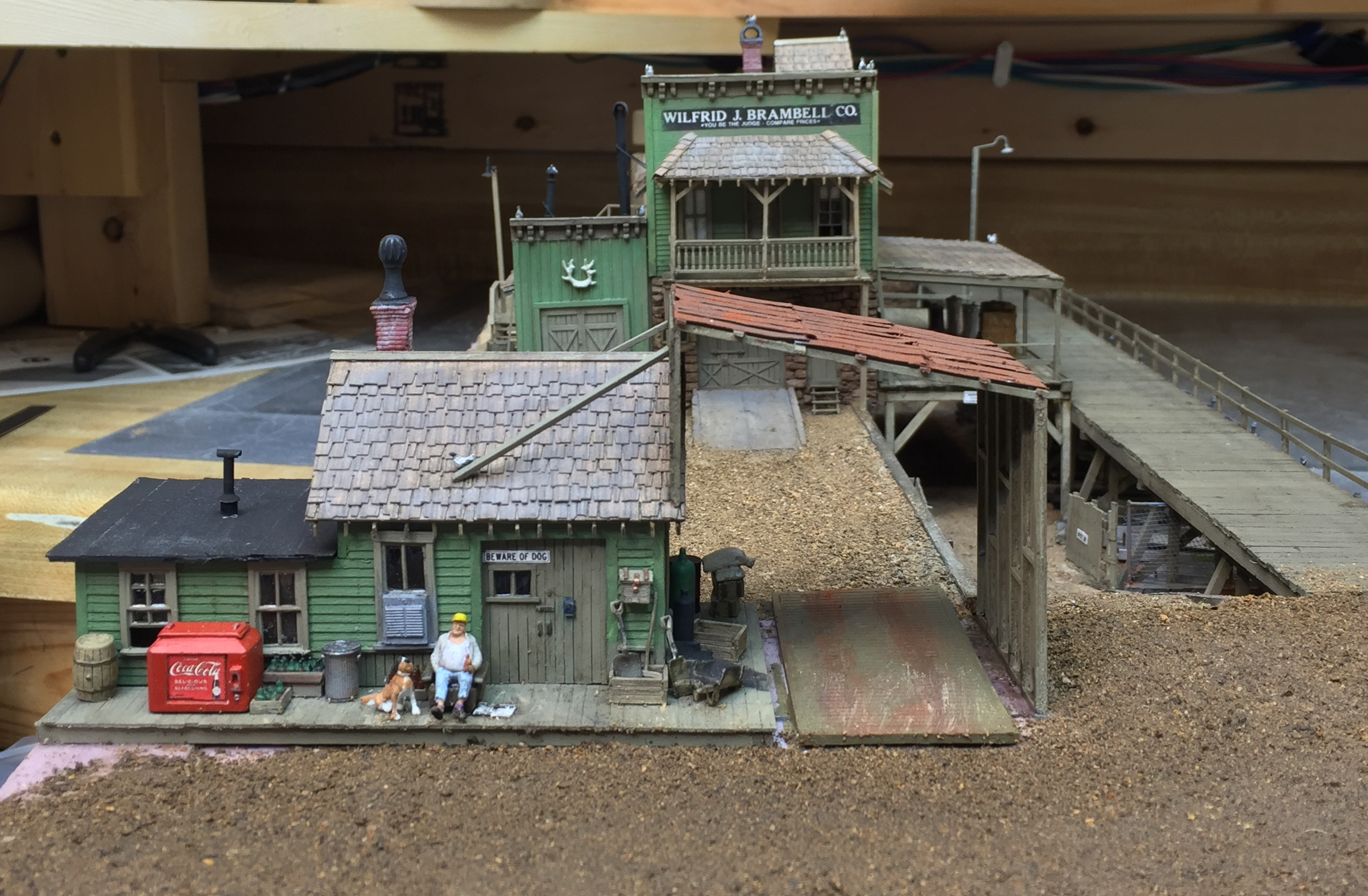

I have been working on the office building - which from a build standpoint is very similar to the warehouse.  Here is a picture just after I mounted it to the base.
The glue on the canopy roof was still drying so I left the weights on for the picture.

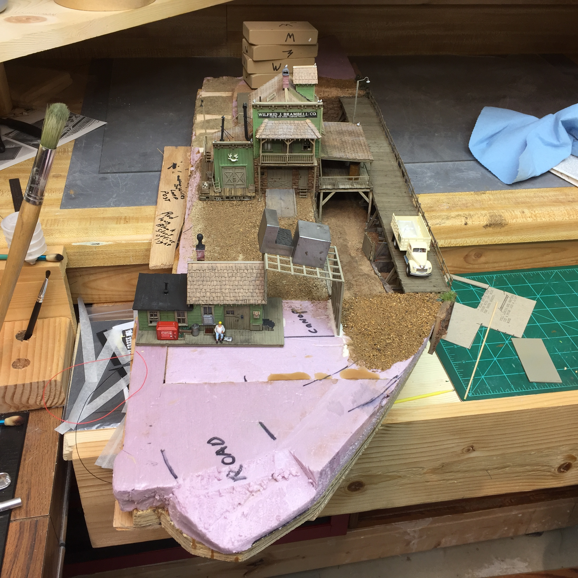

Here is another picture that shows the layout of the yard better.

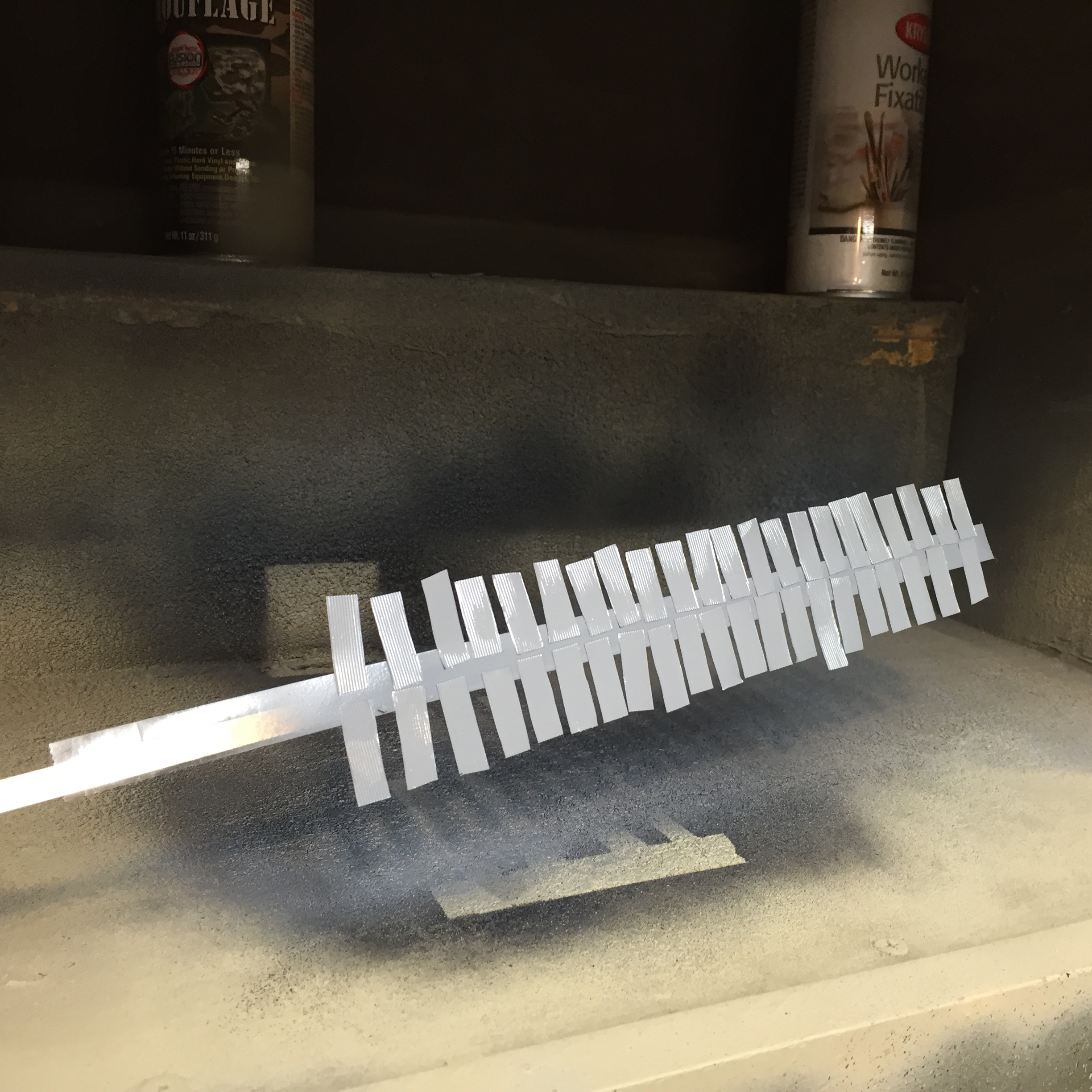

I took this picture because I found a better way to paint corrugated roofing material (at least better than what I was doing).  The old procedure was to paint the sheet with premier and then cut the roofing material to size.  This usually resulted in lots of shinny spots to cover because the premier popped off as you handled the material as it was cut to size.
What I did this this time was cut it to size and then mounted it on a piece of strip wood with double stick tape.  Then I painted it with gray primer.  The process worked great - not a single shinny spot from the primer popping off.
