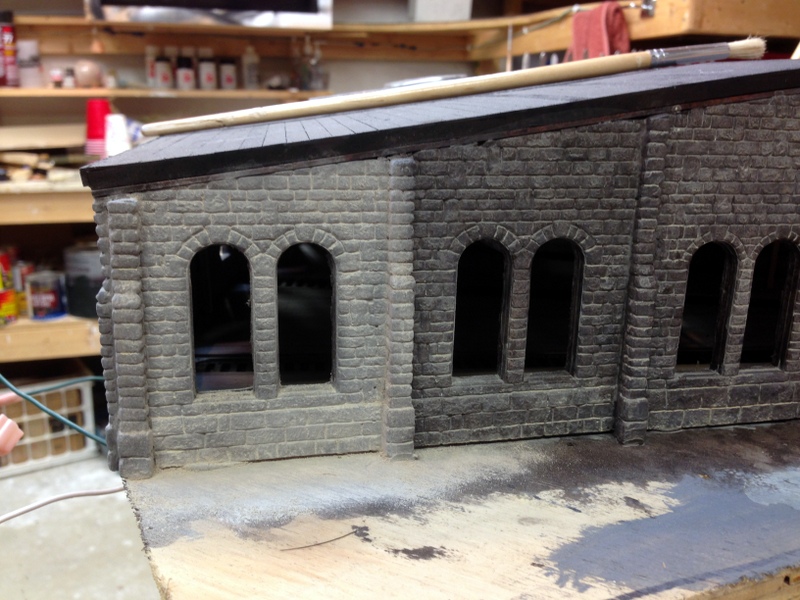

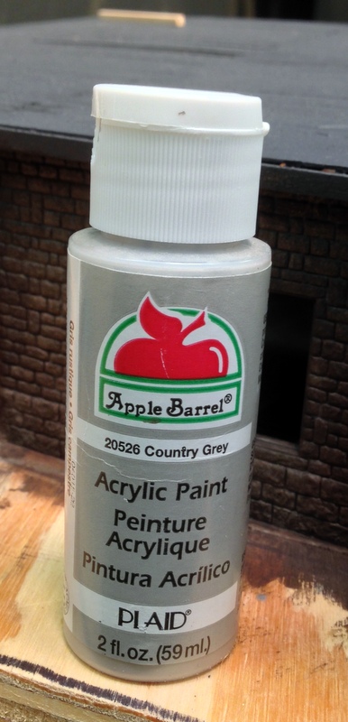

The third step is to add a wash of 2 part country grey, 5 parts sand, and 5 parts water. Again I have added pictures of the two paints and the wall after this step. The picture shows the wall after three steps on the right and after the final step on the left.

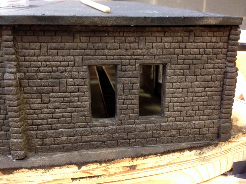

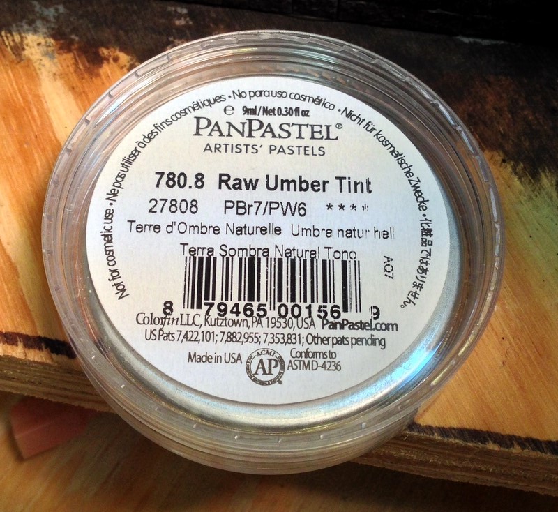

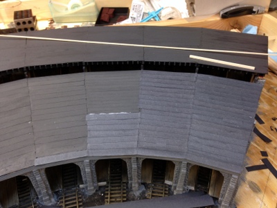

The final step is to make use of the pan pastels that I bought at the EXPO. I was pretty happy with the look after the first three steps but I wanted to make the mortar joints more real. Stone work of this kind required lots of mortar to makeup for the irregular shaped stones that were used. The procedure I used for the pan pastel was to apply it with a number 6 brush working it into the mortar joints. This looks really bad until you wash the pan pastel off the stone face with a damp sponge. The sponge I used can be seen on the roof of the roundhouse in the pictures below. At this point I plan to finish all of the roundhouse stonework in this way. I will then add some details like rust, soot, etc. using chalks as a final step.
This is a picture of the what have I done step - the pan pastels have been added. Then I cleaned the faces of the stone with a wet sponge.
Here is a picture of the pan pastel container and the color used.

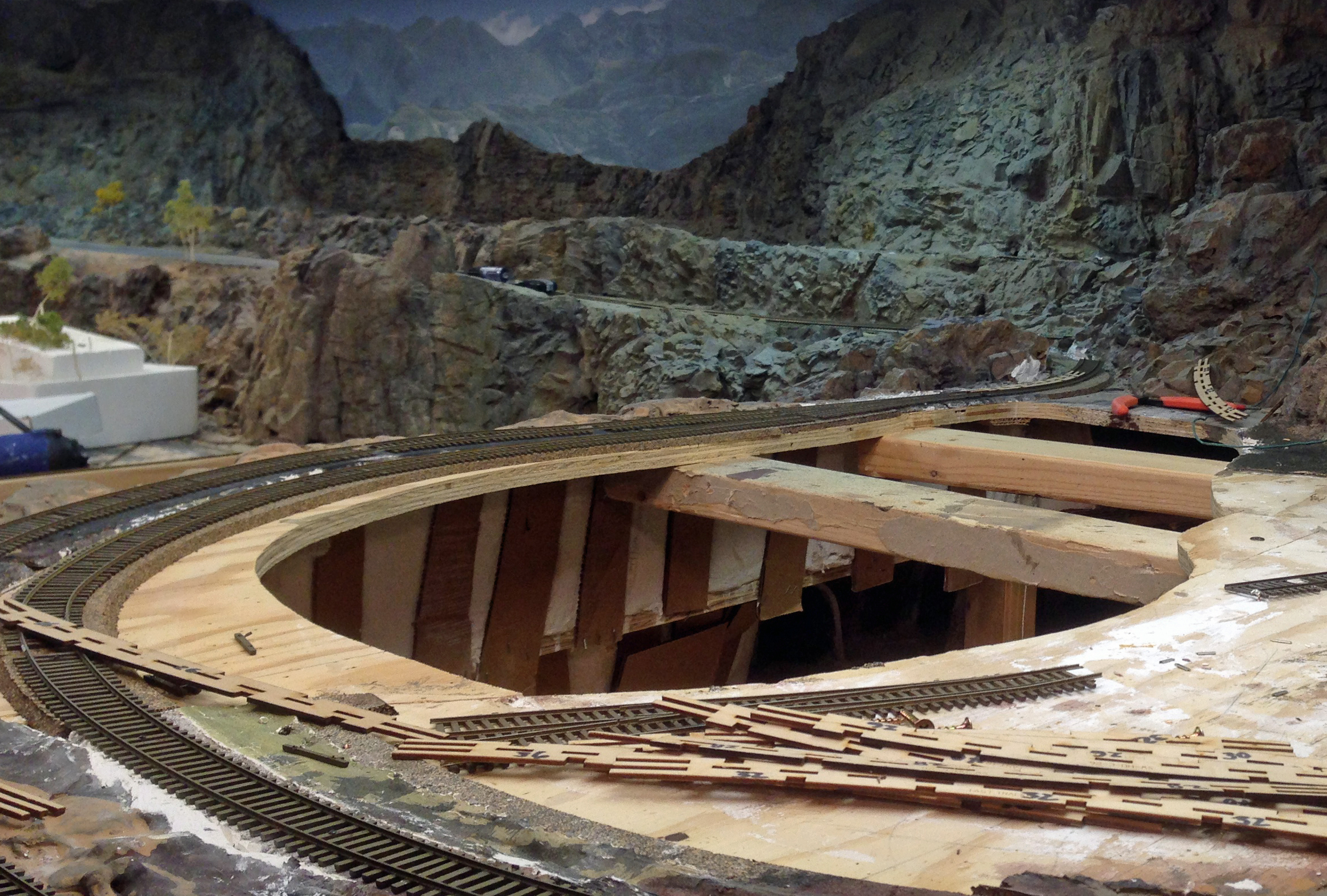

I made some progress on the track laying today. We have reached the point were it will get challenging because all of the lower level main line has been completed - now it's the upper levels that need to be completed.
#143
Here are a few pictures from the track laying on the layout.

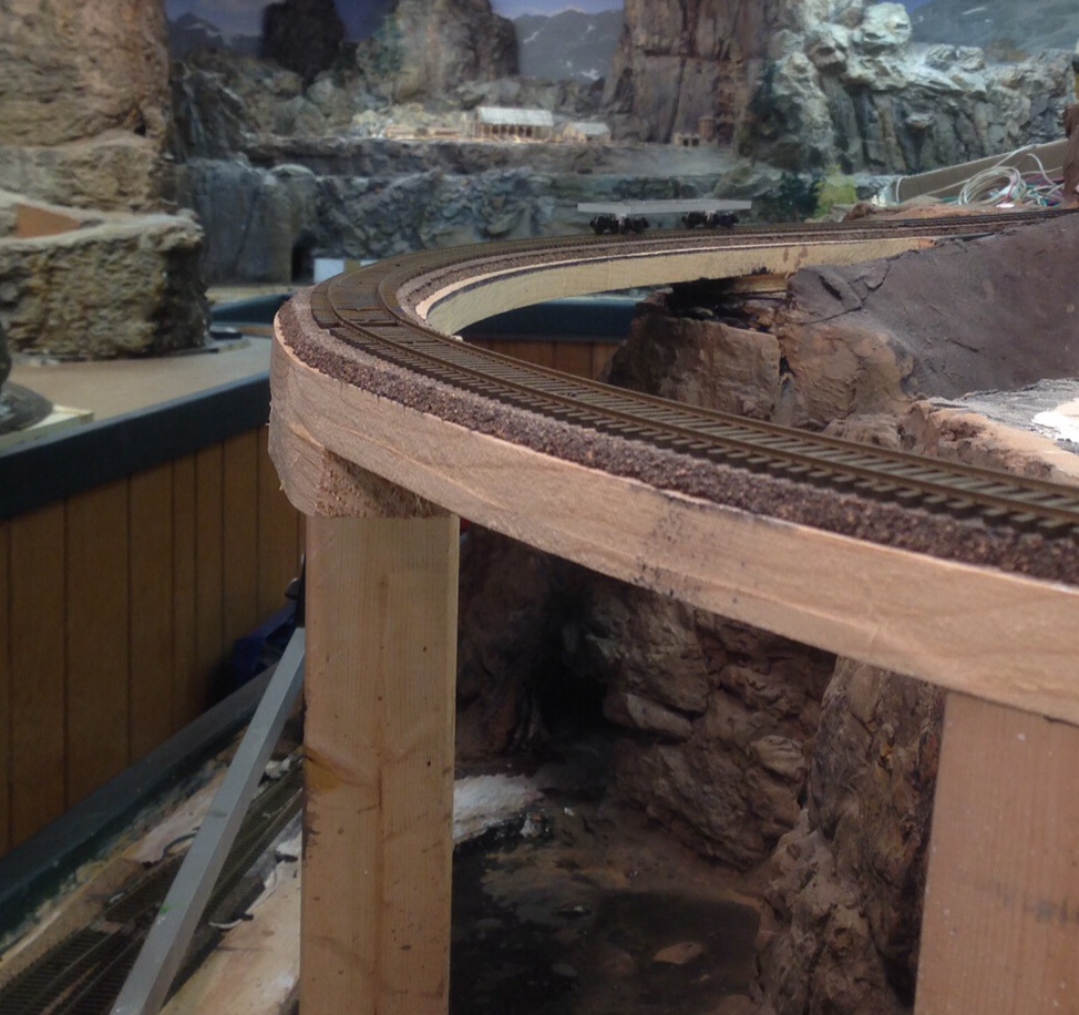

This first picture is the view from the top of Fox Run Trestle looking a West.  The test car has just been over the track for the first time.
A bridge has just been positioned for installation ahead of the track laying crew.

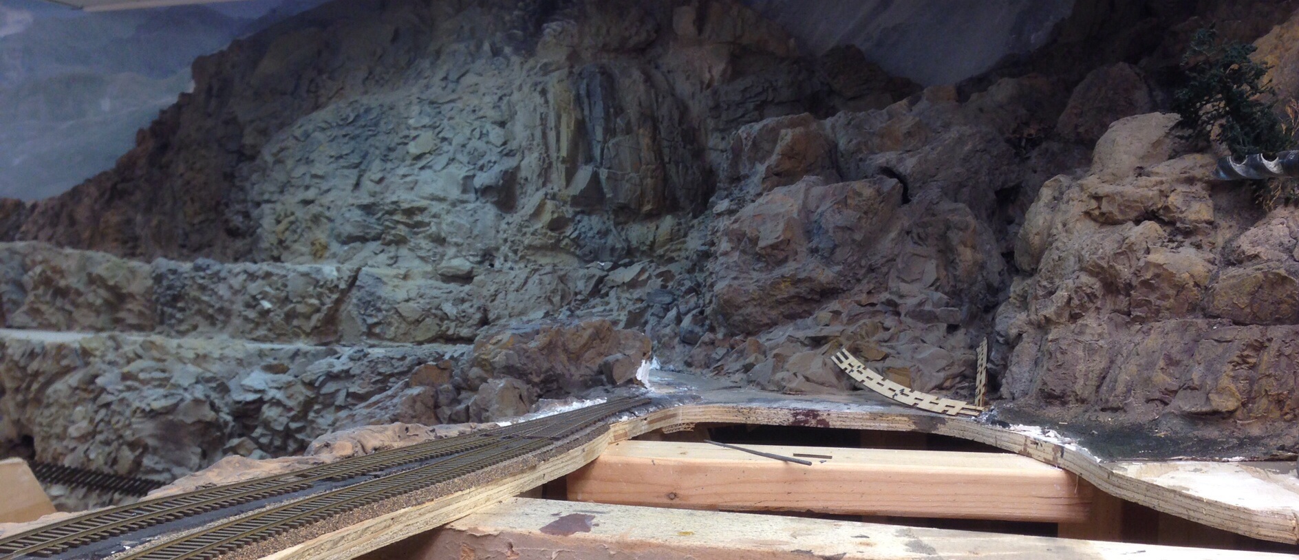

The tracks have been laid to the base of the mountains.  As you can see from the picture we are still doing some blasting work to get the tracks in just the right place.
