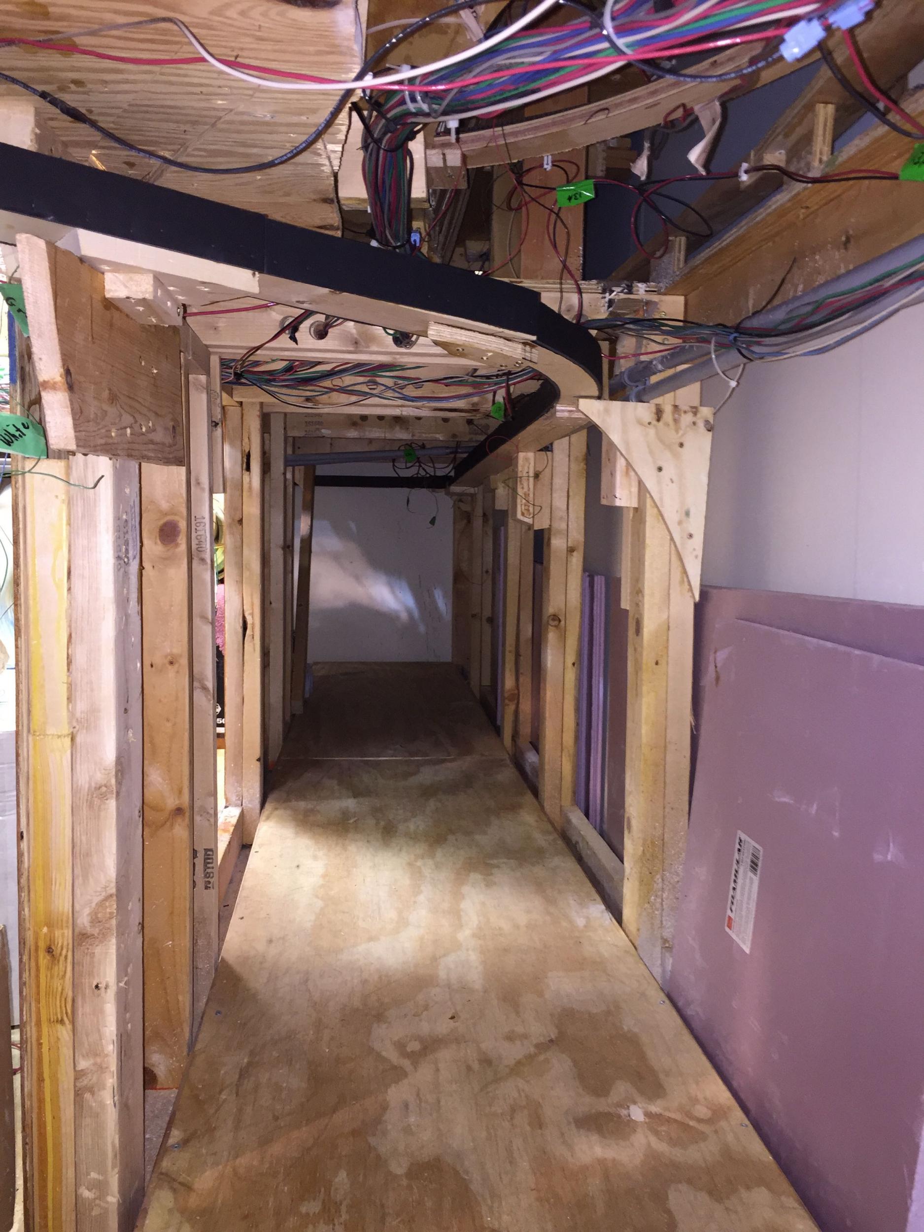

Here is a picture of the last two sections going under the layout to complete the helix and start the long journey to the other side of the layout.
The straighter section will start the journey through this tunnel.  You can see the start of the supports along the right hand side.  It will attach along side the power conduit.  I actually got this section completed today but a picture will wait until I crawl under the layout tomorrow.
The wall you see at the end of this tunnel is 20 feet away. At that point the track will take a 90 degree turn and run another 20 feet. Then another 90 degree turn and 30 feet of straight. Finally, it will turn another 90 degrees run 10 more feet and start up the helix on the other side of the layout. I will be making up 6 foot long sections to complete this track work.  The first one took about  an hour to build and another  2 hours to install.  So I have some work ahead of me to get to the second helix. I also have to connect all of the drop wires that you see hanging in the pictures to the main buss wires.

Great progress your making John.  You just gave me an idea of how I am going to keep trains from falling to the floor from derailments in the hidden track area.
Steve
Thanks for stopping by the thread.  I think you will be glad you used the guard rails,  most of the problems occur where you can't see the trains.  I know they have saved me some money.  The biggest issue when you are working on a layout is having stuff get pushed into an area where you can't see it and causing a derailment.
John, is that blue pipe electrical conduit, or water lines?  If the latter, you should make sure it's not that nasty polybutelyne stuff that we had in our house (and ultimately had to rip out - replacing -every water line- was NO FUN.)
Hi Dave
Those are electrical conduits.  Actually, they are the wires for the power switches for the main control panel. The only time they are hot is when the train room power is on. All of the water lines in our house are copper.  The white plastic pipe is a drain line for the kitchen and laundry room floor drains.
Glad to hear that.  No one should have to go through what we endured.  :P

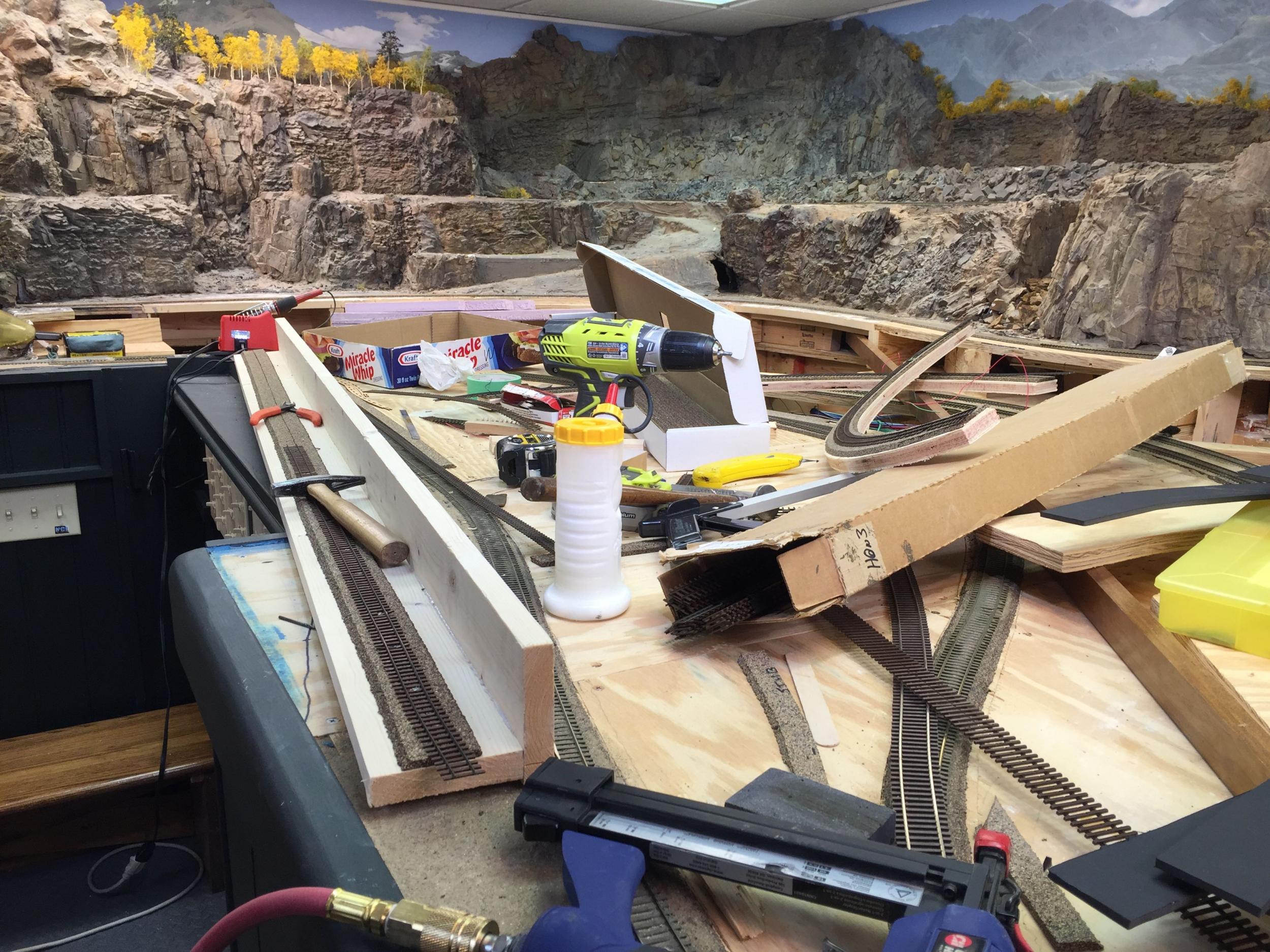

Here is a picture from topside - construction of one of the straight sections.
The corner we are working in is the same corner that is in this top side photograph.
I'm using a wood side rail on one side to mount with and to keep the wood from warping.  I still have to add the artist board guard rail to the other side of this section when the track and wiring are complete.
