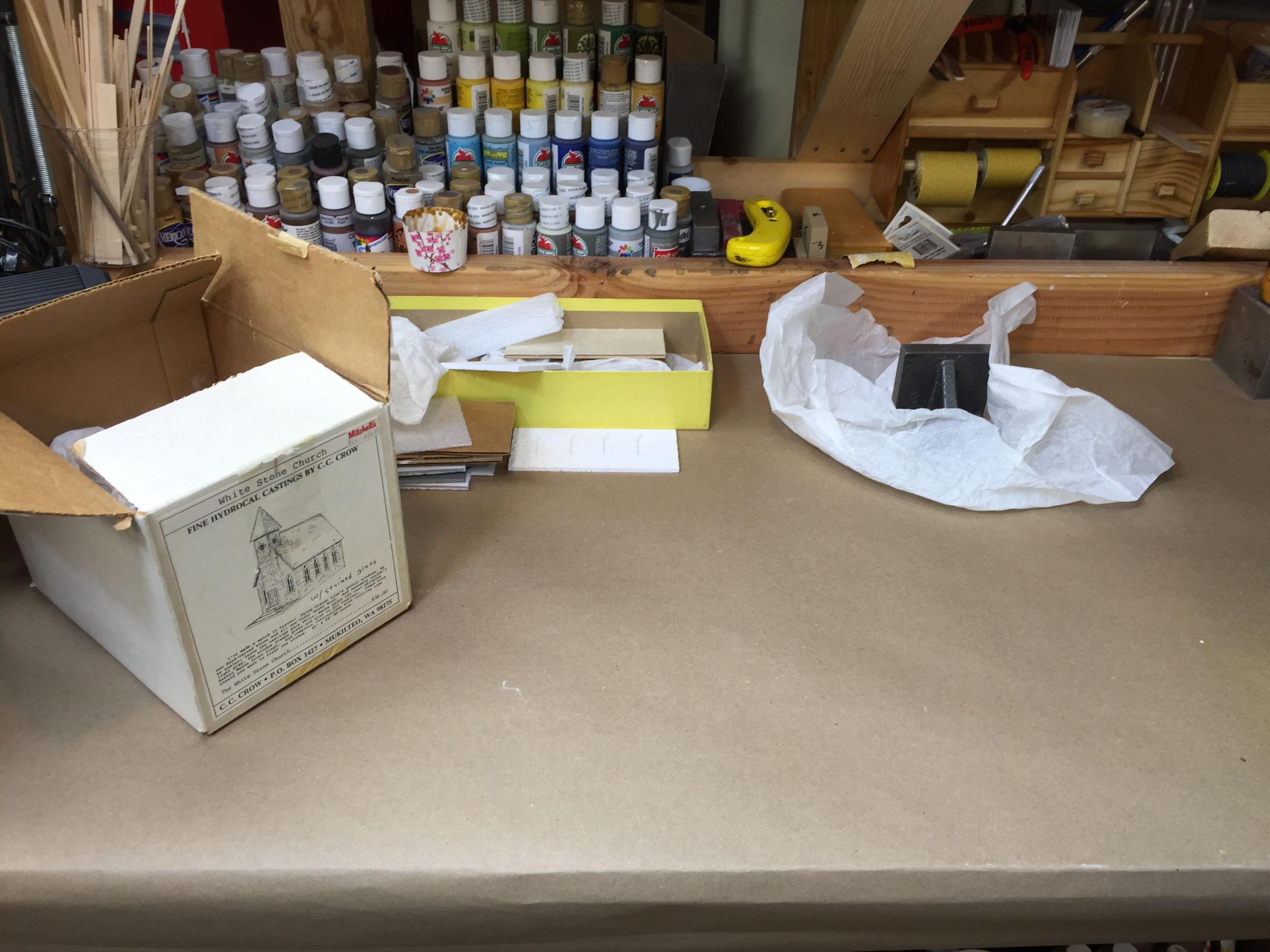

So today was get the shop back in order and organized day.  I had everything spread all over the place from four different projects.  My main workbench is now dedicated to the Jacob's Coal FSM kit build.  I'm currently in the process of assembling the coal bins.
My roll away work bench is now dedicated to the C. C. Crow Stone Church build - which is my Challenge build.  I'm just getting started on this one.  Currently have a number of test castings in the paint booth with the primer drying.

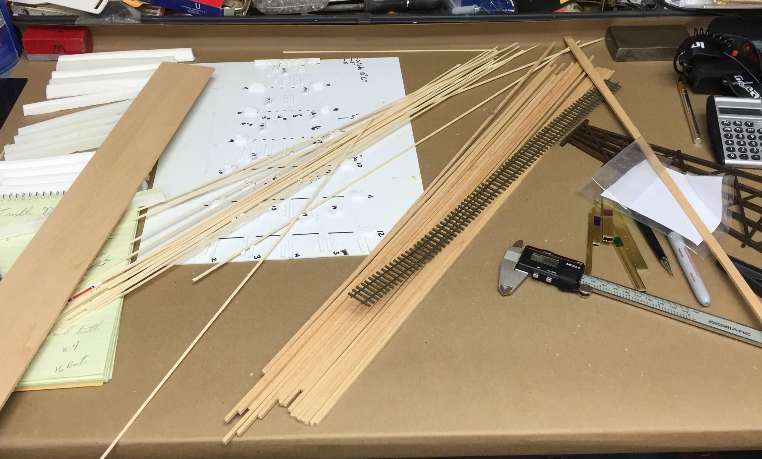

On my third workbench I'm starting the two remaining trestle builds to complete the Narrow Gauge Line on the layout. Today, I got a good start on cutting the strip wood and found the gluing template for the trestle bents. I plan to build these two trestles right on my workbench on a base which will fit in place on the layout. If everything goes according to plan this should make these trestles much easier to build than my last trestle build project.

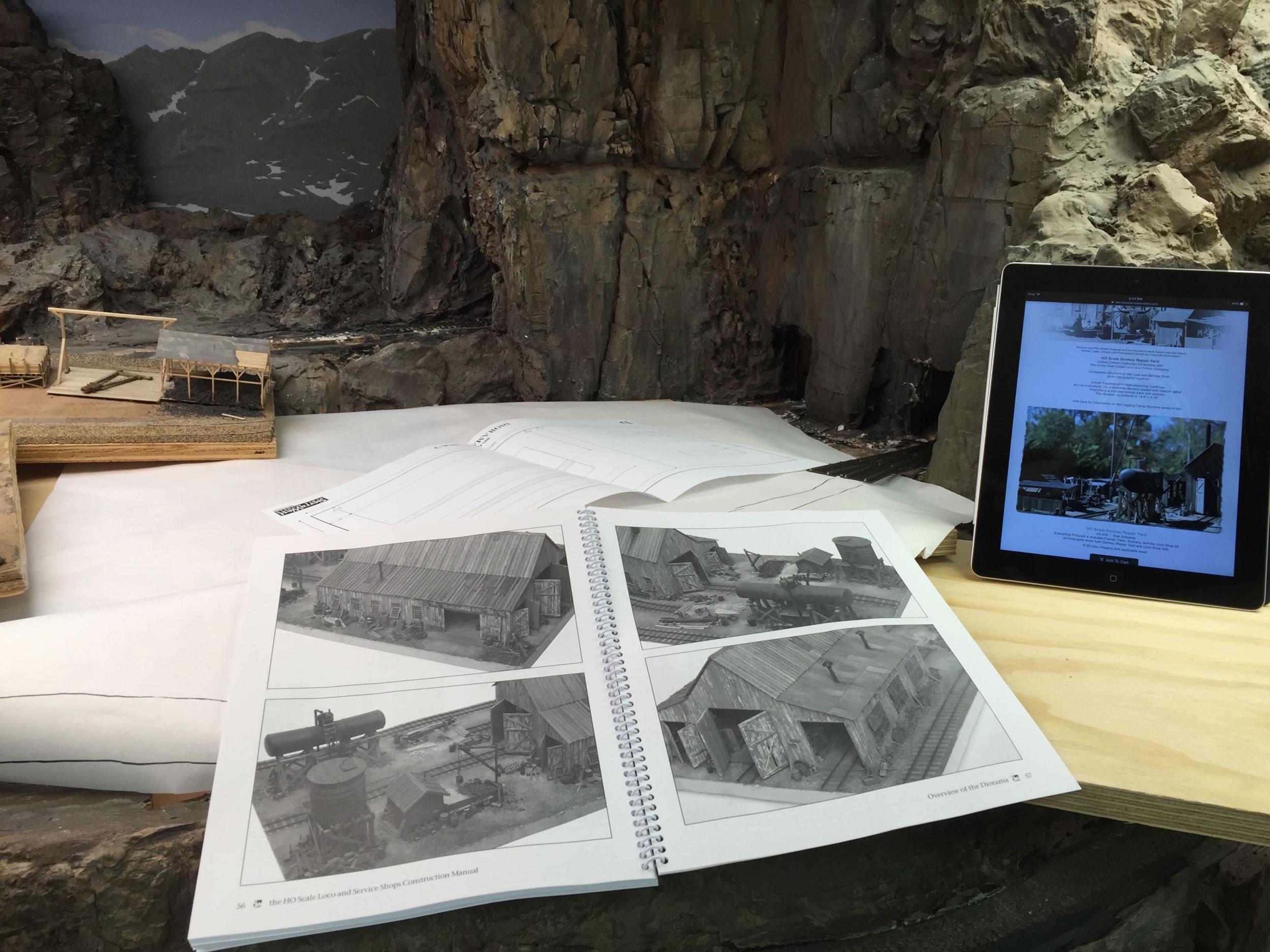

I spent the day working on the track work today.  Which included some time making final decisions on some future structure placements.  On the left side of this scene I will be placing 4 FSM kits which are left over from my previous layout. I actually never finished the Sand House kit.  I was working on it when I made the decision to completely remove my old layout and start fresh.
On the right side of the scene I have plans for 2 or possibly 3 Sierra West kits.
I needed to make these final decisions before I placed the main line and sidings.  By studying the pictures I think you can see the process I go through to visualize the scene and make the placement decisions. I find the templates and instructions along with build pictures very helpful in making these placement decisions.  In many cases I will also be looking at some kit bashing to make a particular kit work on my layout.  Don't let the orientation of the FSM kits bother you.  I have some rock casting removal work, along with some benchwork modifications, to do tomorrow before I lay the main line. The rock castings in this area need to be detailed, trees and bushes need to be added, and rock talus needs to be added to make this scene complete.
