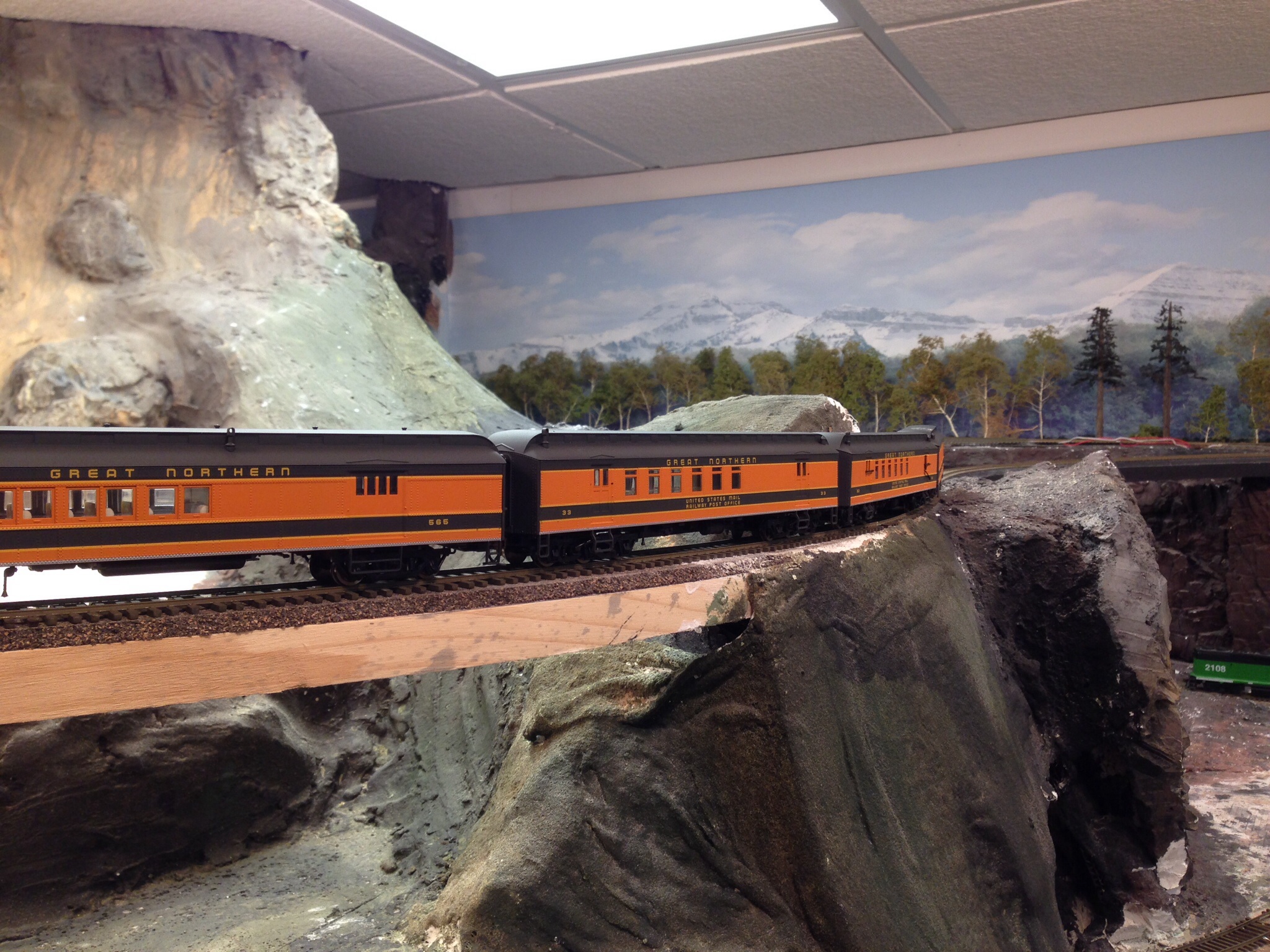

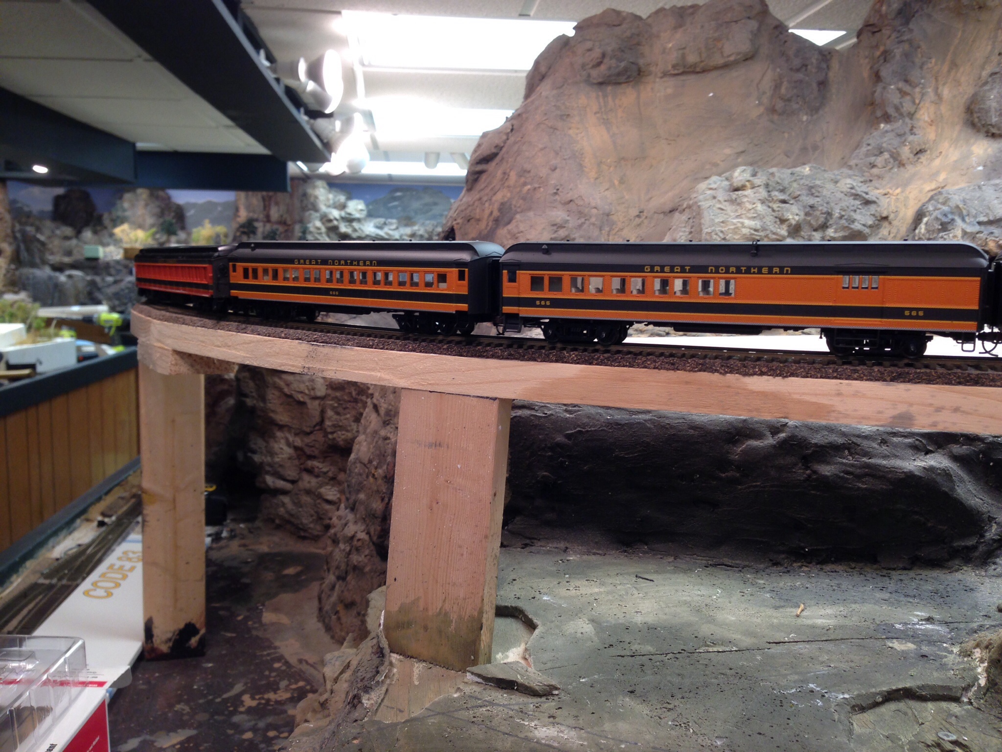

I was reading Tom's build thread for his The Atlantic and Southern Build  last night and realized I hadn't tested the new track with my long Pullman cars.  So today we ran the test with 6 - 40' passenger cars and 3 - 85' Pullman cars.  I found three areas that need some work in the backup test. The Pullman car test has now been added to the Superior & Seattle track testing procedures.  It will be called "Tom's AS Pullman Car Test (TAPCT)". Thanks to ACL1504 for the help in getting this track work right.

Thank you for the award! I'll wear the TAPCT pin with much pride! I found that, for me, proper planning pervents piss poor performance - The theory of the 6 P's!
I'm happy to be of help even though by accident.
What about the "Tom's Back AS-ward test?"  It's a bit more descriptive, I think :-)

You are correct - but I was doing my best to be nice. Actually, it is a great way to test your track work. Those 3 axel trucks find every little problem in your track. Thanks for following along.

I and a few others here in Boise have a pretty proven way to testing track work.........
Push 'em.
It's not prototype but testing is not operations....  We push strings of cars at various speeds for testing .......
Including all ahead flanktastic.
It shows stuff right now ! ! !

Actually, I forgot to mention that I'm the mode of power during this testing phase. And you are correct it shows stuff right now. It allows me to test the track before wiring - but it doesn't substitute for running the locomotives through everything, especially the modern steam engines. I'm fixing and area right now that failed the locomotive test.

If you find the 6-wheel trucks are too sensitive, you can adjust that a bit by using an Exxact Socket (from Reboxx, MicroMark has a knock-off) to open up the center set of bearings a bit.  This is easier done when building the trucks from a kit, though (all my Branchline Pullmans were bought before they started doing RTR).

Thanks for the tip - I will give it a try if I have problems after the track is where I want it to be.  Thanks for watching.
