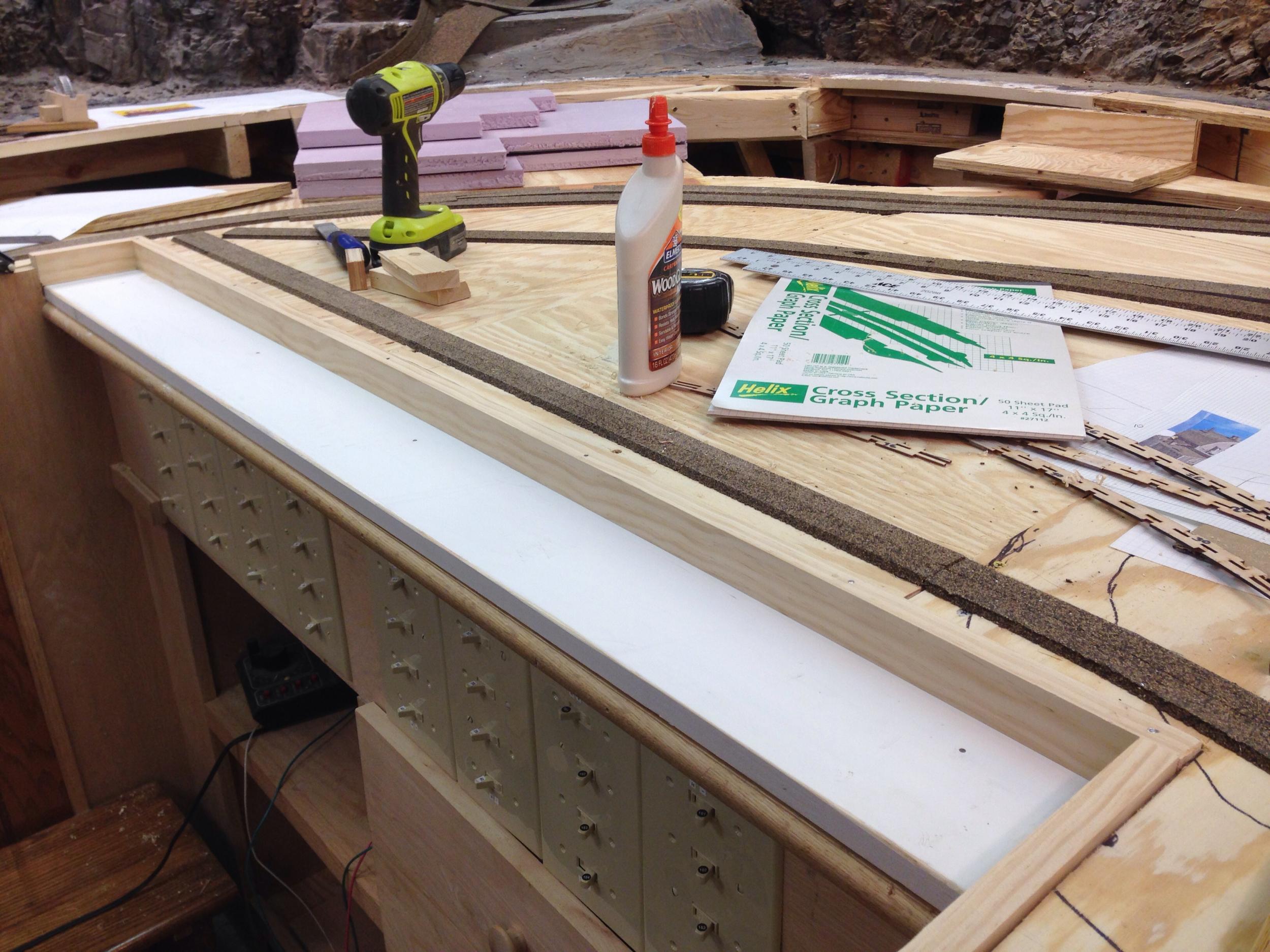

Spent the day laying track and finished the trim on the main control panel.  One of the features I'm adding into the fascia is places where people can lean against the bench work without hurting the scenery or structures.  This shelf on top of the main control panel works great for that purpose. I hope someday to have lots of structures to look at from this viewing position.
All of the wood below the edge of the layout will be painted dark green.

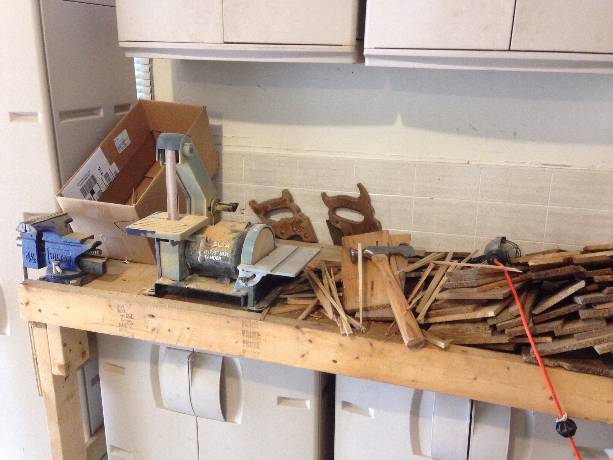

I spent a few more hours making pine tree armatures today and took some pictures of the operation. The weather is finally great here in Michigan and it's time to move my modeling to the gazebo.  This year I plan on making lots of pine trees out in the fresh air. I'm actually posting to the forum, using my iPad, and enjoying the nice weather and a nice cold beverage.
I make my pine trees out of cedar shingles that were left over from the gazebo build.

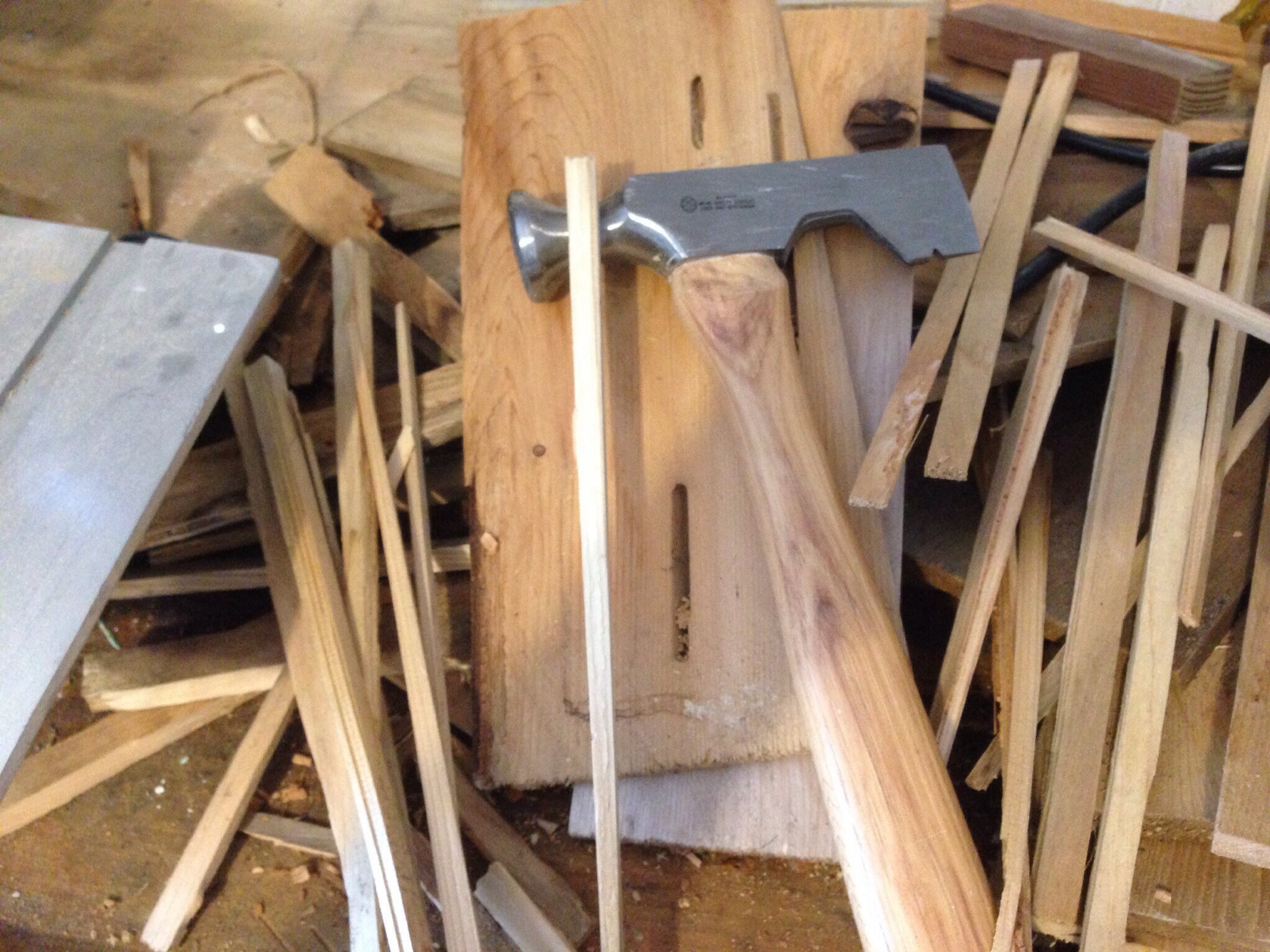

The next step is to split the shingles into strips approximately 3/8 of an inch wide using a shingling hammer.  Watch your fingers on the last couple strips.

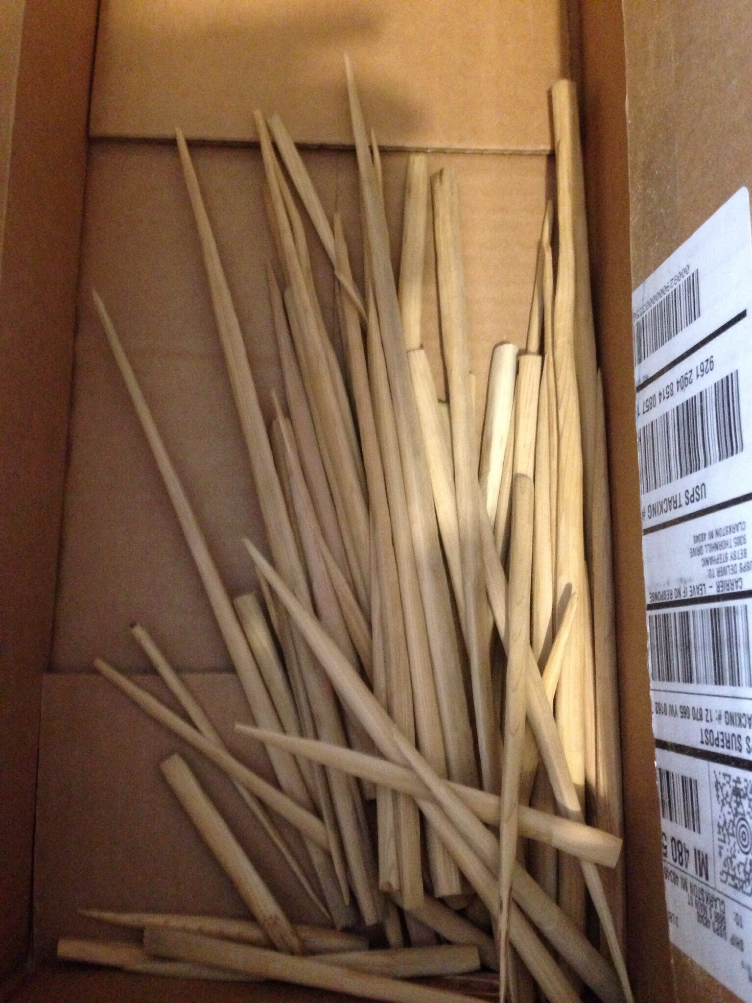

I then round and taper the strips into tree trunks using a belt sander.
I store the armatures at this point so I can do the next few operation in the batch mode.
