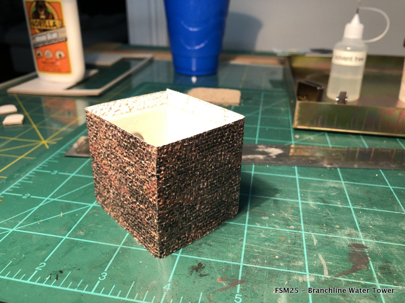

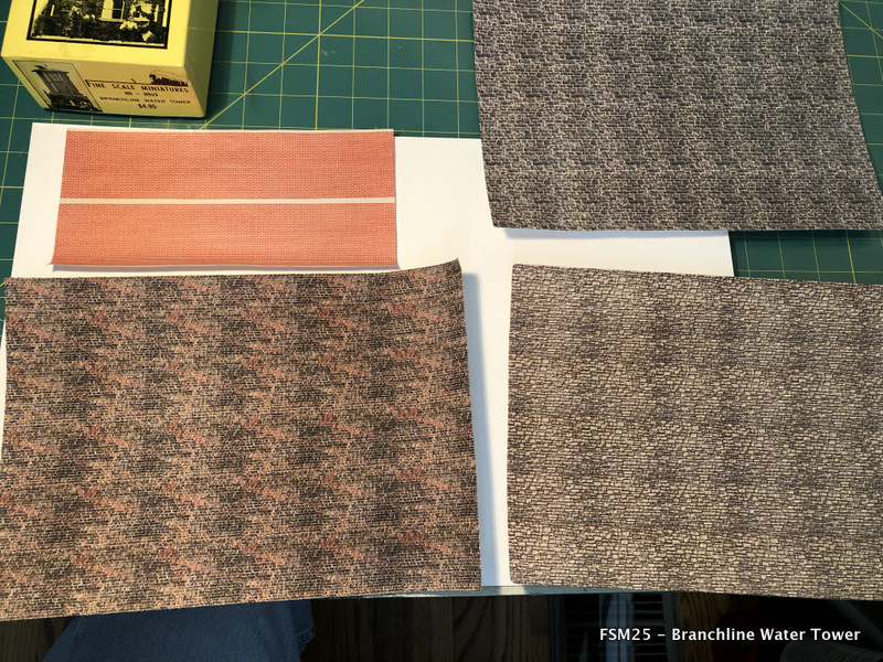

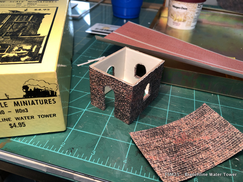

I am going to change something about it. See that red brick paper supplied in the kit. I am replacing it with some way cool brick embossed sheet from Foggy Mountain Models.
I'm using the sheet on the lower left. The other two sheets are probably more suitable for O Scale.
Here is a comparison of the brick paper supplied with the kit and the one I am going to use from Foggy Mountain.

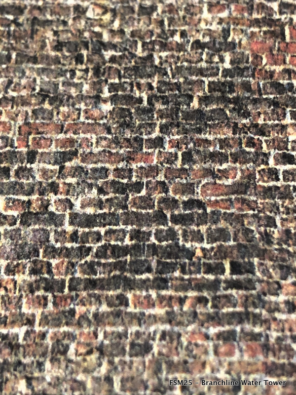

And here is a closeup of the Foggy brick.

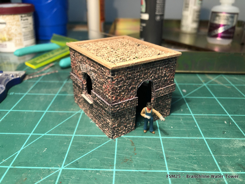

This is a small kit but it packs a lot detail into a small space.

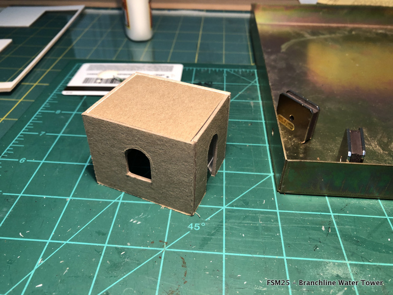

The walls are die cut from thick cardstock. The cut lines are sharp and accurate.
I used some laminated cardstock gussets to give the walls some rigidity.
What is odd is that one builds the little structure with the glossy white surface of the cardstock facing inward.

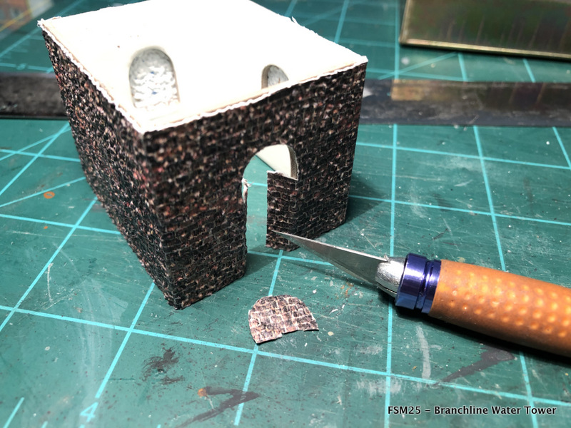

Once the structure is glued one laminates the brick sheet onto it.
And then one cuts out the window and door openings.
The instructions suggest gluing "gravel" to the roof of the structure and to laminate some rows of decorative brick work to the outside surface. A "cap" for the walls is fashioned from strip wood.

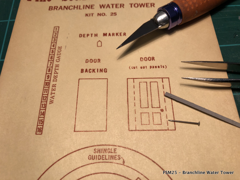

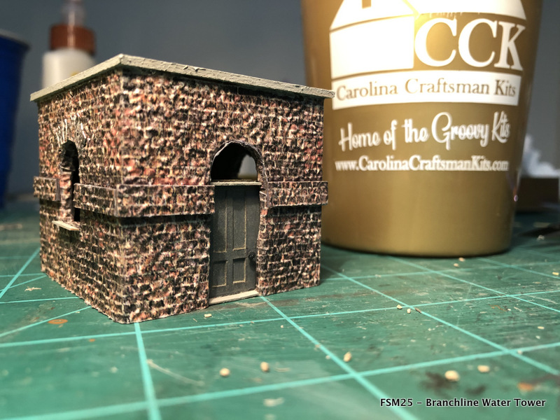

Here is an example of how the detail on this kit is made by the modeler. Let's take a look at the only door in the kit.

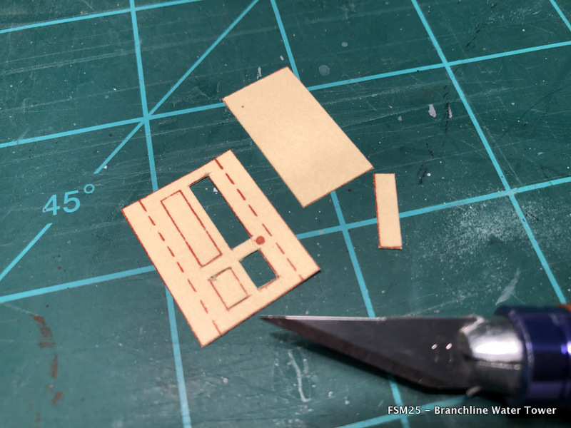

You see how the door is printed in two parts on the pale yellow card with the water tower's roof template. The modeler is to cut out the panels on the main piece of the door and glue that to the door's backing. Then a pin's head is used as the door knob.

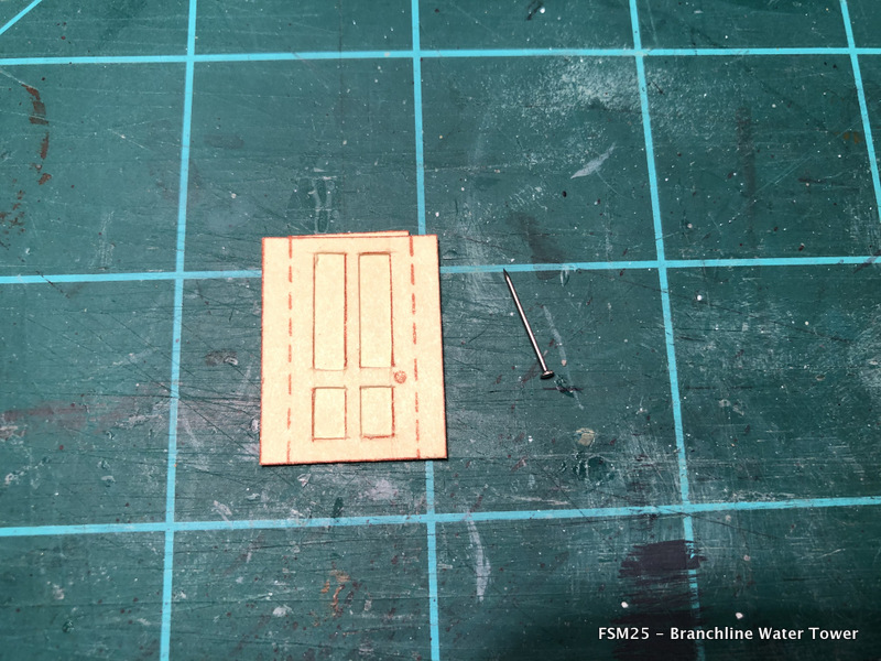

Here is how that goes together.
It's actually quite satisfying and there was no need to prime and paint a metal/plastic casting. Is the detail as sharp as a casting? No. But with practice I am sure a dedicated modeler could come real close. Plus, if you screw it up all you need to do it is cut another one. With a casting if you screw it up you need to go buy another one lol.

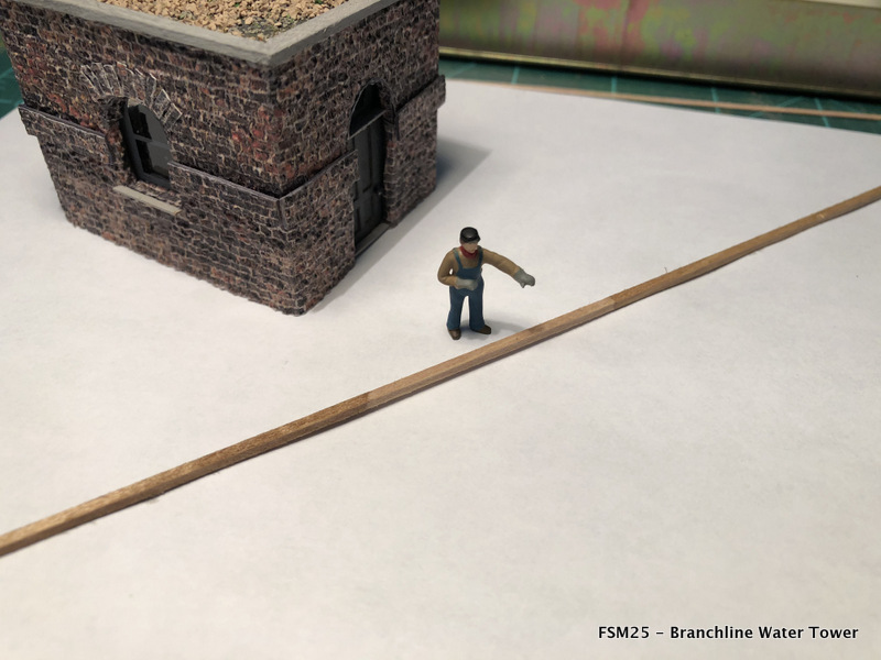

Here is a look at the ornamental brickwork. I need to redo the curved detail above the windows. The band of brick around the building looks ok. This little guy is ready for the tank to go on top.

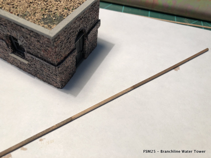

To get started on the tank one needs to stain the strip wood provided in the kit. The instructions suggest a stain made of turpentine and lamp black oil color. I've tried that method in the past. It yields great results. However, it smells up your modeling area some kind of awful. So, I decided to try something different. I've seen on the YouTubes where cool wood workers use a stain made of white vinegar and steel wool to age wood. So I gave it a try. Basically you take a wad of 0000 steel wool and you dissolve it in about a pint of white vinegar. It took 5-6 days for my concoction to finish brewing. You then take the resulting "brine" and you can either use it full strength or you can dilute it. I made a batch of 1/2 diluted "brine". Basically I took a cup of the "brine" and to that I added a cup of fresh white vinegar.
Here is what I got.
That length of strip wood was stained with the vinegar/steel wool brine on either end. The middle is left "virgin" from the kit. Here are my observations:
- it leaves the wood with a warm brown tone
- it smells up your work area but not as much as the turpentine suggested by the kit
- it takes much longer to dry than rubbing alcohol and India ink stain
- it makes the grain on the wood pop better than alcohol and India ink
- it does not penetrate as deep as alcohol and India ink so you basically have to soak the wood with the vinegar/steel wool brine
- I like it as an alternative to traditional model railroading stains
Here is a comparison with the middle of the length of strip wood stained with alcohol and India ink.
And here is a batch of more strip wood stained with the vinegar brine.
You can see where I missed a couple of spots when applying the brine.
