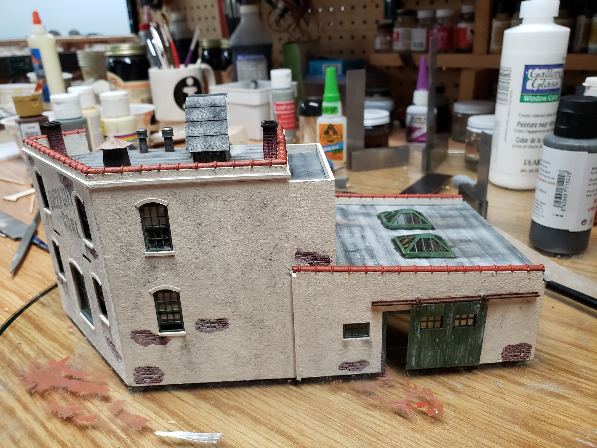

Looks great Vince. I can't tell from the pictures- Is the weathered roof flat or at a angle?
vinceg
It's at an angle. Interesting point now that you bring it up. For the main building, the roof is pitched but the tops of the walls are parallel to the ground so the angle is more apparent. For the big addition, the roof is pitched but the tops of the walls are parallel to the roof. Just interesting....two different styles.
Here's an older picture of one of those side walls that shows the angle more clearly.
Cheers.
Vince

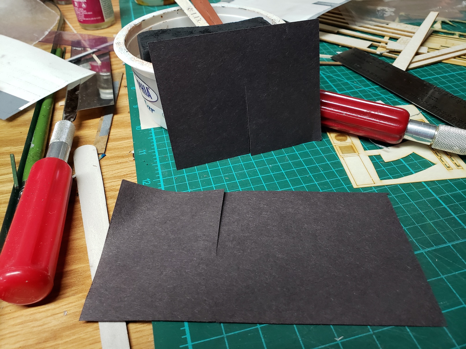

First up, I decided to do my first view block. This building will be at about eye level and there are a lot of windows. At least they're at my eye level -- actual adults may will see more of the roof. I didn't want to see through the building. So, I tried the usual approach of making an "X" out of black construction paper. Here are the sheets with slits that are cut halfway through to allow their intersection:

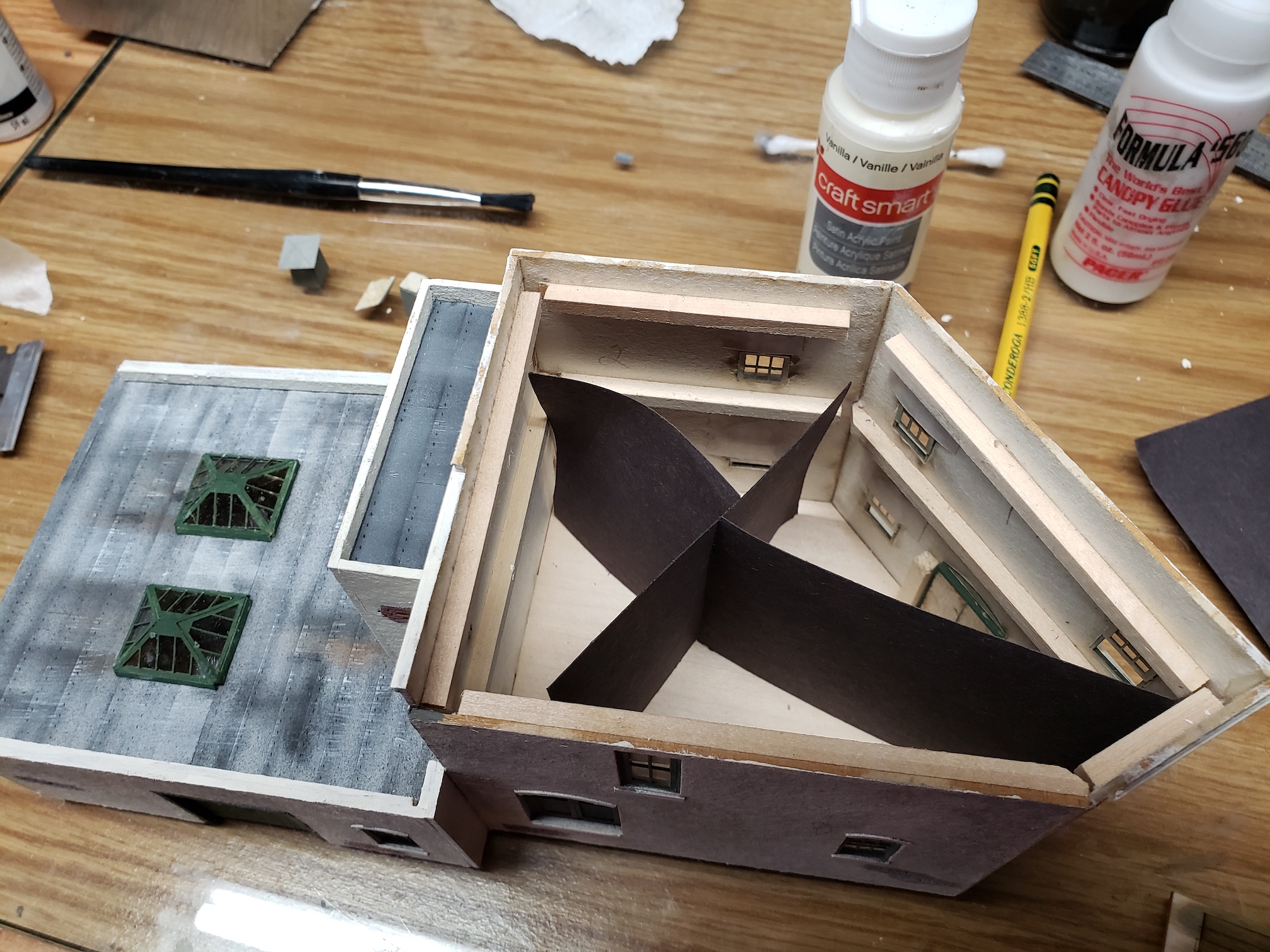

And here it is installed in the building before I seal it up forever by gluing on the roof:

#84

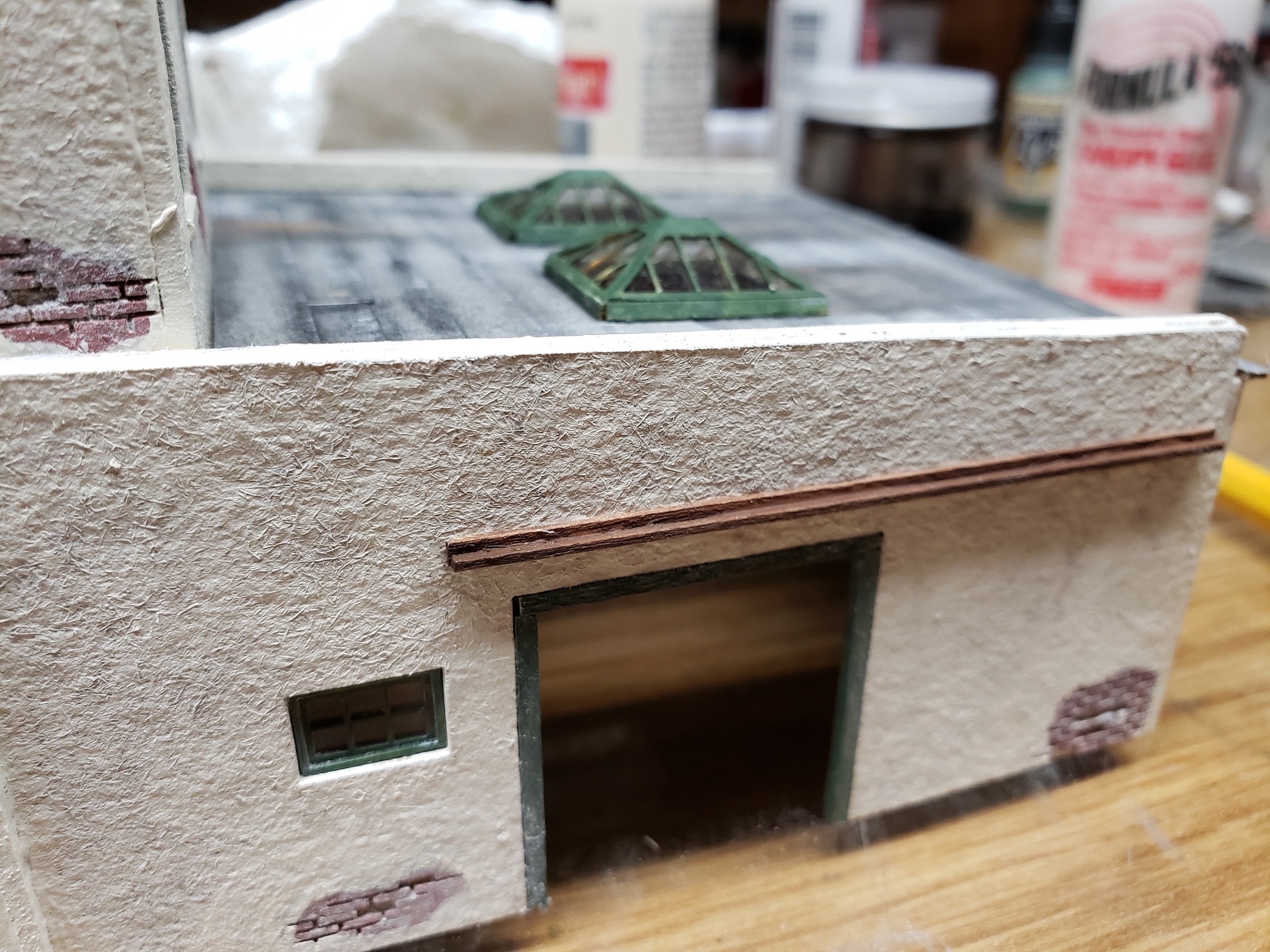

The building addition has a sliding door. The instructions for the kit call for using a 1/16" square piece of wood for the rail on which the door hangs. That didn't look very good to me. Instead, I used a piece of 1/32" square wood glued to a scale 2x6 to make more of an L-shaped piece. Then, painted it with burnt umber craft paint. Here's a pic:
The resolution of the photo is way too good. You can see the fibers of the task board rather that just the overall texture of the paint. Looks fine to me in person (having old eyes helps!). This already has two thick coats of paint. I suppose a couple more might do the trick but again, I think it looks fine in person so I'm not going to worry about it.
More shortly.
Vince
vinceg

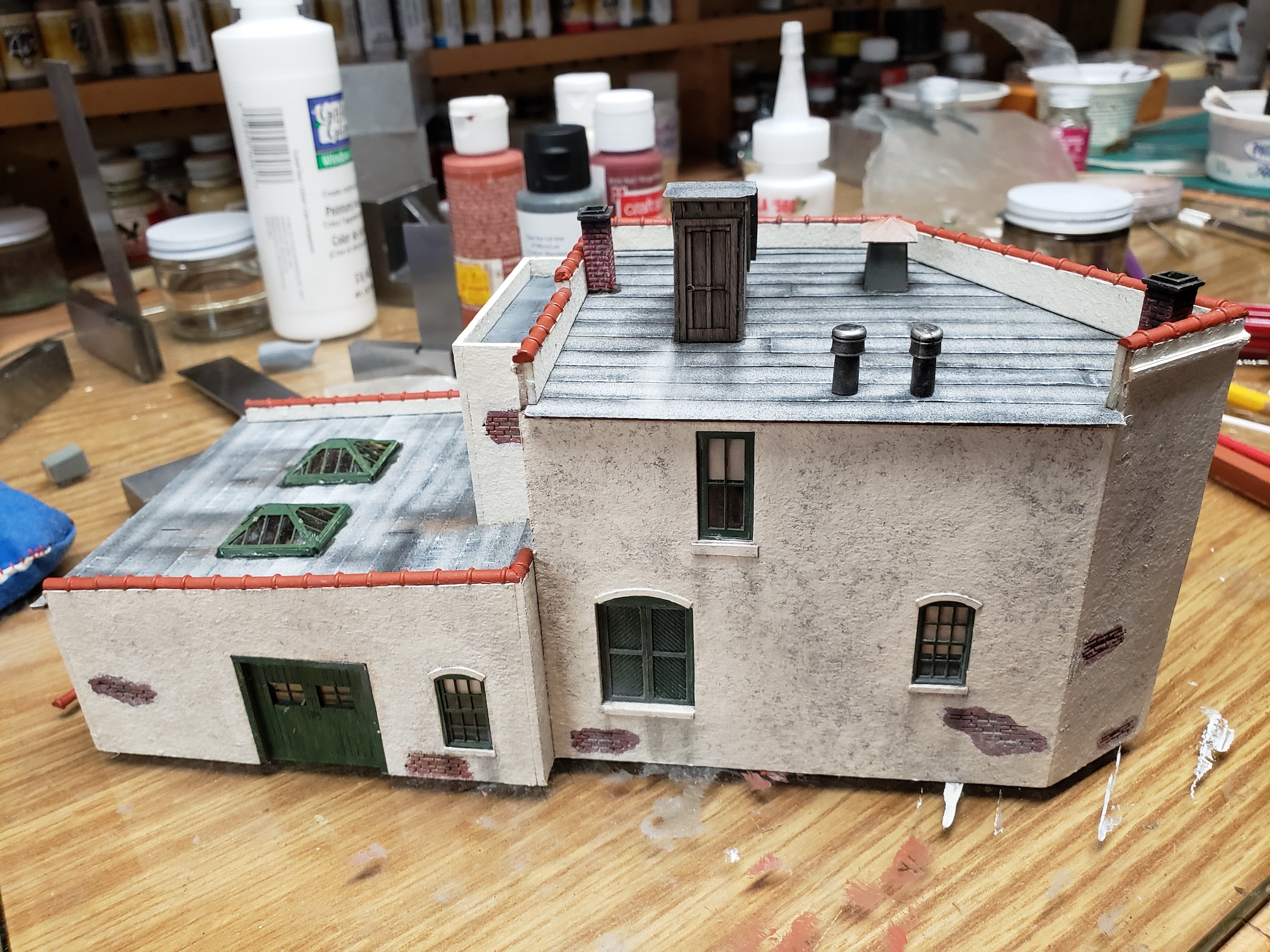

Here's the ceramic (resin) caps in place. Took a bit of time to get things mitered properly. I also wanted to try to line up the little bulges in the capping with the end of walls, where possible. Despite taking care, there are still gaps where two pieces join. I tried to fill those gaps with a little extra paint. The paint used here is an acrylic called "Pennsylvania Clay." Here are a couple of pics:
You can see I worked ahead a little here -- there's stuff on the roof of the main building. We'll zoom in on that shortly.
Vince

Here's a shot of the roof of the main building with all of the Roof Stuff. I do love roof stuff.
A few things to note here:
1. The instructions call for notching the chimneys and have them partially hanging over the wall. I didn't see the point of that. Seems like a lot of error-prone work for little visual interest. Not even sure I like the look of the notched chimneys.
2. The roof access piece is an interesting structure. Those walls are laser-etched, not board-by-board. Notice the knot hole near the bottom back of the structure. I thought about having that structure face the front so that I can see the door - more detail. But, the piece actually has the walls cut to match the pitch of the roof. So, to reverse it 180 degrees, I would have work to do. Again, not worth it to me.
3. That vent that looks like a pagoda is a little mini laser-cut wood structure. Very clever. It also has a base that matches the pitch of the roof. Need to be careful when you glue it down.
4. Here you see the result of the etched metal I mentioned earlier. Believe it or not, I did try to file off the mold parting lines. But, you can still see them. I think I found something I hate more than bracing walls.
5. I'm starting to rethink the whole "put tar around the base of everything you put on the roof" thing. As you can see, I did it around the chimneys. As you can also see, I did a not-so-great job. No matter how hard I try, I can't get what looks like a realistic application of the tar. The variations in the width always look out of scale to me. In some cases where it's a major interface between two surfaces (like a wall resting on an angled roof) I have successfully used a thin, paper folded strip. But short of that, I have a difficult time with getting a good result with apply the glue/black paint mix. I have thought about using a mask but that doesn't work with round vents as you see here. There's probably an opportunity here for a new tool or technique. Or maybe it's just a bunch more practice.....
6. You can see a pretty noticeable gap where the roof meets the raised wall. I don't know if I will at least address this or not. If so, I will use the thin strip of paper (painted with glossy black paint) technique to handle it.
7. The roof is not a light as it appears here. My overhead shop light is pretty harsh and makes it look whiter.

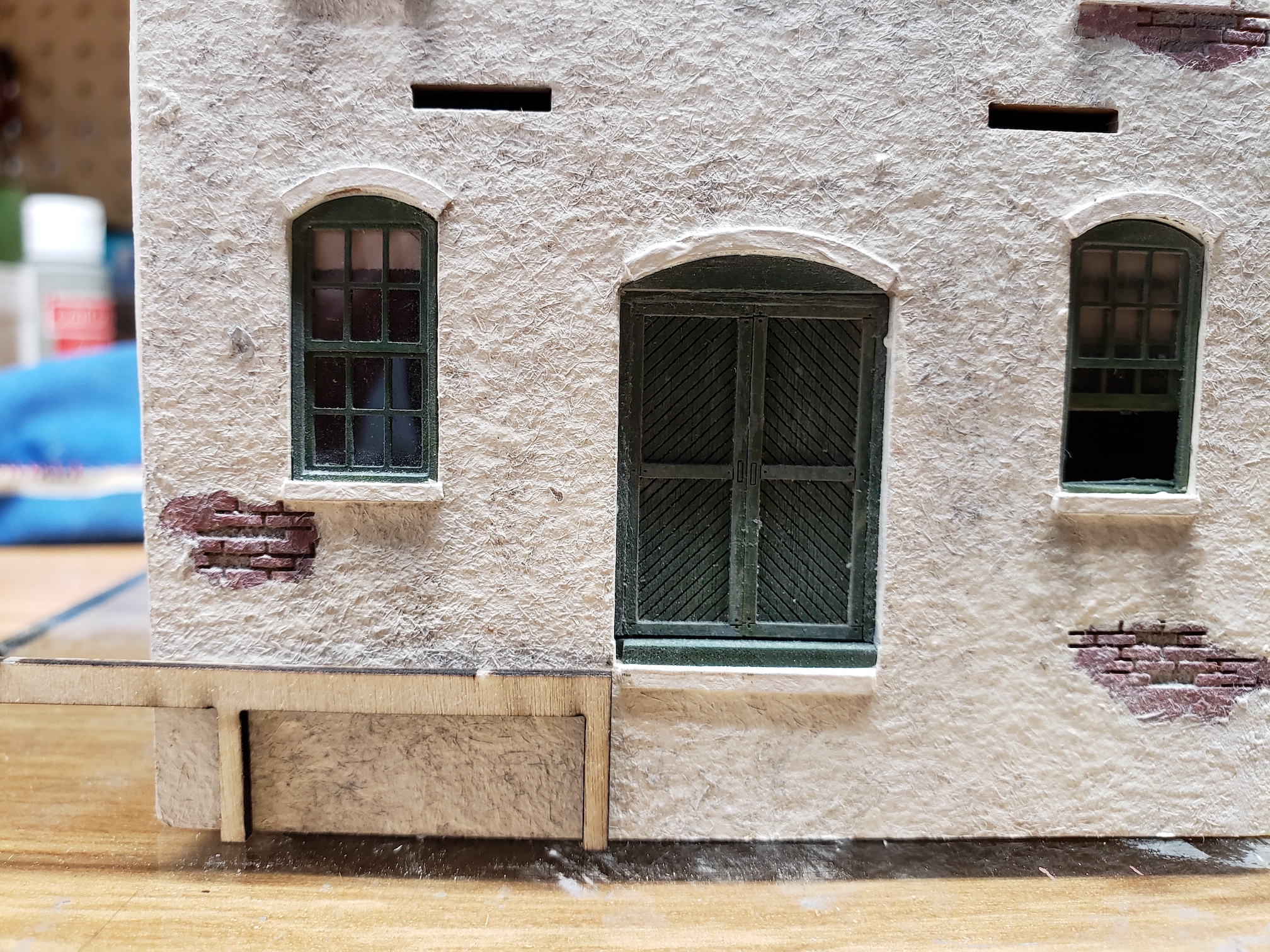

Time to do the loading dock on the front wall. The first thing I noticed that the door sill trim seemed like it would be a problem in that it would interfere with the loading dock. Turns out it is. This pic shows one of the support pieces held up against the wall. You can see that it's too high:
Two choices: (1) cut the legs to lower the dock, (2) remove the strip below the door to eliminate the interference. No brainer - a lower loading dock would look illogical is that you would have to step up to get things into the building. Also, A lower dock would then make the stairs on the side look funny as they would now be a little high.
