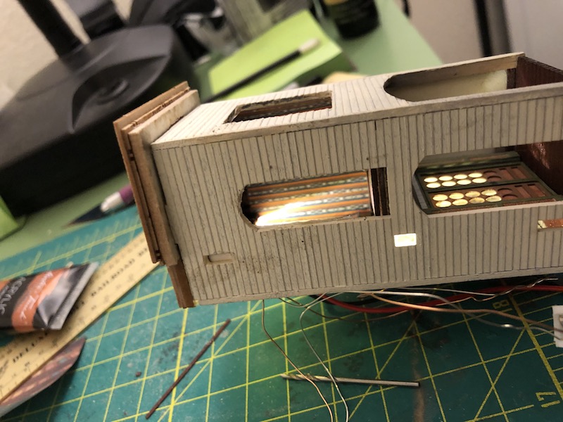

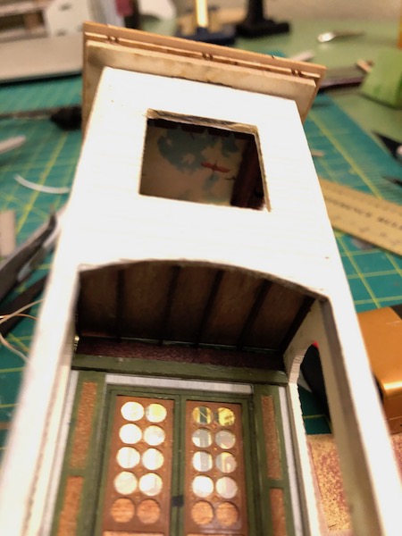

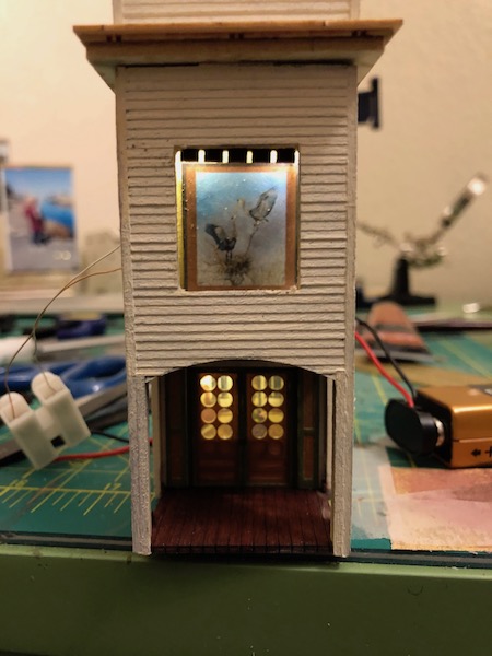

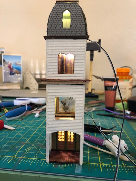

So the general method of how I completed the interiors has been covered. For the second floor foyer I put the Heron Tapestry (bottom edges not glued to produce a slight hanging effect) on the back wall. The other walls are a stripe wallpaper and I again put two LED lights hidden behind the stained cornice on the back wall. However, this time the wires were put through the wall and soldered to copper tape. Two more lights were put in same spots on back wall of the first floor. No cornice is needed for the lobby due to the doors and photo already in place. Here are the results:
I previously modified a post to show I replaced the hotel name and added ceiling bracing.

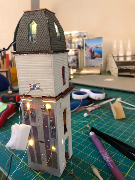

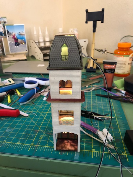

The directions say not to glue the various floors together yet. However here is how the four floors look at this point when assembled and lighted. The one picture shows how I have connected in series the lights for each floor. We will figure out how they all work together when I get the main building put together. I will be sealing the various holes on the back so there is no light 'bleeding'.
We are caught up now and back to following the directions. Hope to get more done soon.

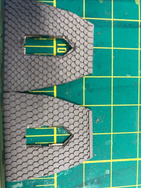

I have hit the meat of the build on the tower and encountered some issues so I thought I would add to the thread even though not a lot of actual progress has been made.
First he shingles provided with the kit are not the same design as shown in the instructions. Moreover, they are only mentioned in passing in the instructions. The four panels that are the frame the shingles are applied have laser etched lines marking where the top of each row of shingles need to be placed. Placement needs to be exact. Each row is placed so the bottom of each single is located to the middle of two shingles below. See below:
The issue I ran into is the shingles are made of some type of felt material. In order to make a clean cut you need to use a new straight blade, not an xacto-knife, the straight blade has a finer taper and is needed to cut as clean as possible. Even so making a truly clean cut, especially around the window openings is very difficult and requires patience, lots of patience. The felt wants to fuzz and even when you remove the felt the self sticking back is often left behind and needs to be carefully removed without cutting through the thin wood. If I was to do this again I would most likely use a different make of shingle. The need to make precise cuts for the windows is truly slowed down needlessly due to the material of the shingles. Here is what I am talking about:
The top roof panel shows the difficulty of accurately trimming around the window opening. You will note I also did not place the shingles correctly. So I did it all again. The bottom panel shows correct pattern and better trimming. However, even the bottom panel needed additional trimming when I went to place the dormer frame in place.
