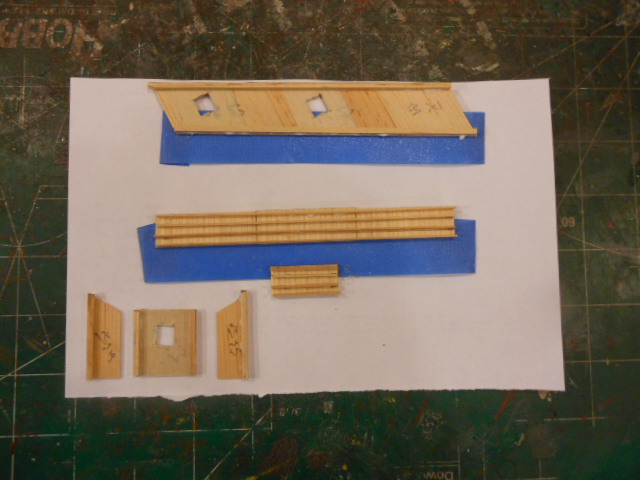

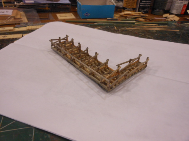

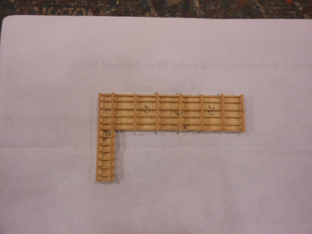

It's a little hard to see here, but I have the front loading dock sections taped to a piece of paper to hold them down while I glue on the floor joists. As with the walls, the loading dock comes in four separate pieces. Again I didn't edge glue the pieces.
After the floor joists, beams are glued on in the opposite direction The plans give detailed templates for this work. I don't have any wax paper or tracing paper, so I transferred the template dimensions to  a separate piece of paper.

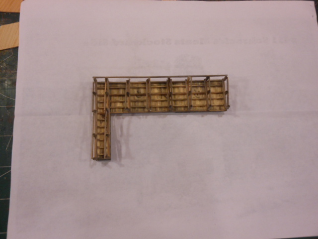

The 28 posts have been added and the cross bracing between them as well
A better view of the bottom of the front loading dock.
I've used my AI solution stain to add some color to the dock
A view of the top after staining. I counted up 66 separate pieces of strip-wood used on this dock. That is a new record for me. I know that some board by board kits use many more than this, but for me this is something different. I will use some weathering chalks and maybe some more AI later. More in a minute

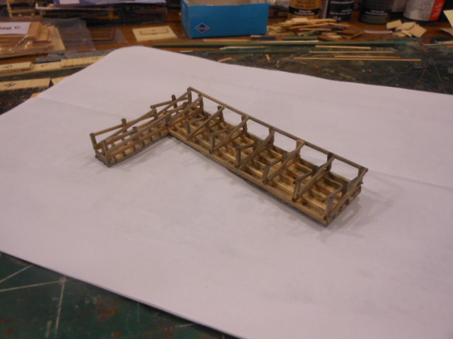

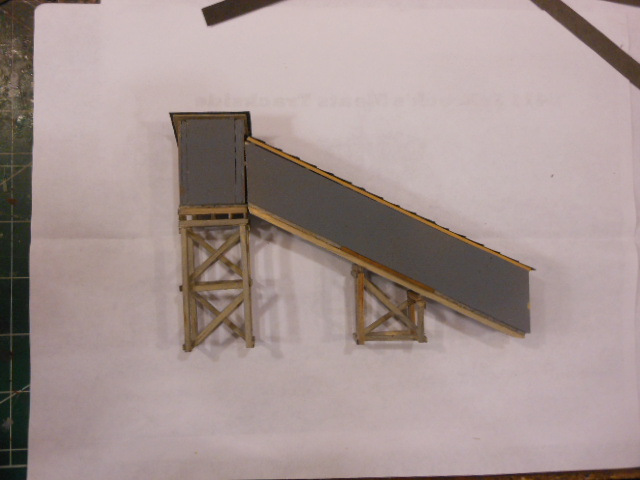

Next up is the cattle ramp sub-assembly. Here are the pieces the kit provides.  After reading the instructions, I decided to deviate from them to make the ramp more stable. I will explain as we go
First I added the bracing, cut out the window openings and also installed the floor joists. When assembled, these pieces glue onto the left side of the structure. I thought that I would strengthen them up by adding back walls to the ramp and the little ramp landing structure.
I've started to build the support structure below the ramp landing structure, you can also see the base for that structure.
Here I'm working on the support legs below the ramp. It is very easy to measure the size of strip-wood needed by just taking it off the blueprints. As I said before, they are very well done and show both front and side views as well as exploded isometric views. It makes it easy to do complicated small pieces like these.
Here is a view of the almost completed cattle ramp sub-assembly. You can see my transferred drawing on the paper below the structure. I painted the wall sections the same as the other walls in the kit, but I only stained the wood support structures with AI solution. I think it gives a nice contrast to the painted areas.
The roofs have been added. I used black construction paper, painted grey and then sanded the edges per Jason Jenson's video. A great tutorial if you haven't seen it. I'm really pleased with how this sub-assembly came out. It is a testament more to the instructions and drawings than to my modeling skills. You can't see the back of the structure in this picture, As mentioned before I added back walls for more strength. I will try to take a picture and include it next time. More in a minute

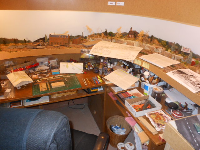

When my wife walked into the train room she said it looked like my work table had exploded. I wasn't even aware of the mess. Here is a picture, I don't think it's that bad, but I certainly can't run trains on my lower level
Two of the large drawing pages have been folded to smaller size for convenience. Maybe she has a point, but I'm too busy right now and I think I know where everything is...

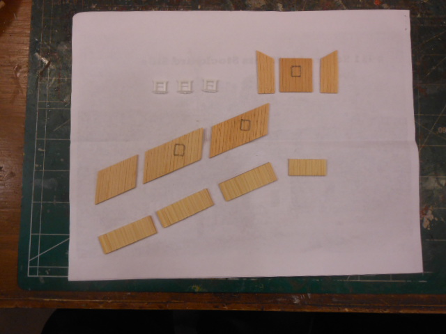

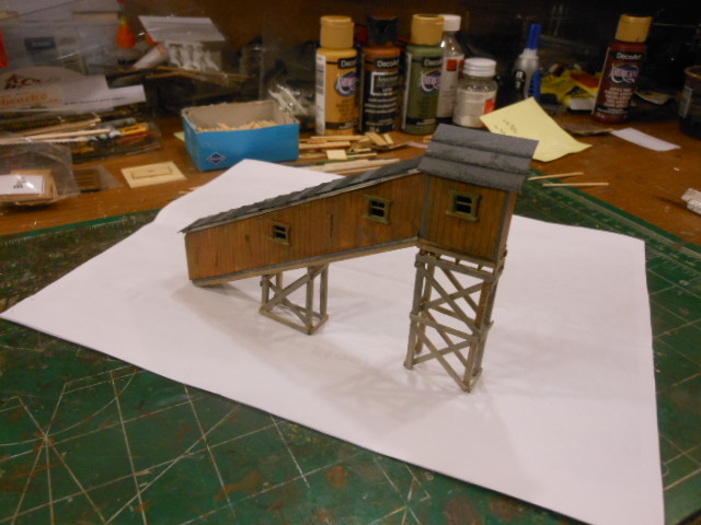

Here is the view of the back side of the cattle ramp. I deviated from the instructions by adding a rear wall to the ramp and the small ramp landing structure. I felt that they would make the assemblies more solid and easier to glue onto the main building. I used pieces of siding from my stash.

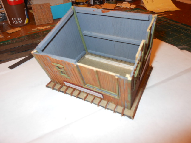

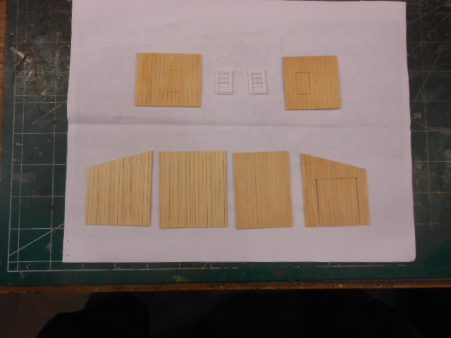

The next sub-assembly is the wagon shed- here are the wall pieces
The door and window openings have been cut out and the bracing has been added. This small structure was assembled like the others. First sprayed with dark grey primer and then dry brushing with the antique gold and cocoa bean colors.

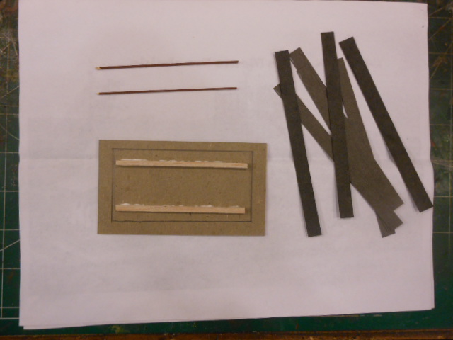

The roofs for the warehouse and the wagon shed were next. Both are shed roofs with vertically run rolled roofing material. I did not use the material provided in the kit, I used some paper from my roof stash box which is a black on one side and grey on the other. Because the rolled-roofing is being run vertically I wanted to seal the seams with wood battens. I used scale 4x4 strip-wood painted brown. You can see it in the picture. You can also see that I braced the roof card with two pieces of 1/8 square wood- I love to brace !
Here is the roof after adding the battens. I applied some weathering chalks to start the aging process.
