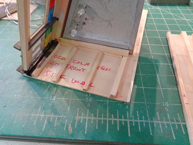

By adding the tile floor it dictated that I have some interior on the cafe floor.

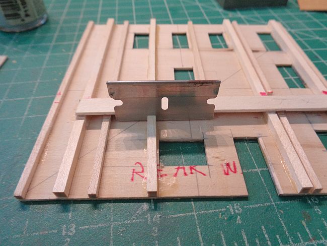

I had to think about this for a bit as the left and rear walls are braced. The rear wall has a door and two different size windows but the left side wall is all wall.
I can add an interior wall to the left and just glue it to the braces. However, the rear wall has to be handled differently.

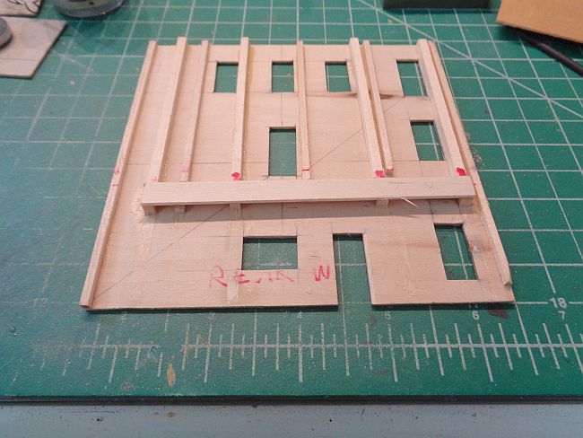

The rear wall required some special reworking and here is what I did.

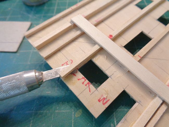

I measured up the rear the height of the left side wall. I then glued a piece of strip wood across the braces at that height.
I used a new single edged razor blade and rocked it back and forth and cut down through the bracing.
I wanted to make sure I also didn't cut into the rear of the wall.

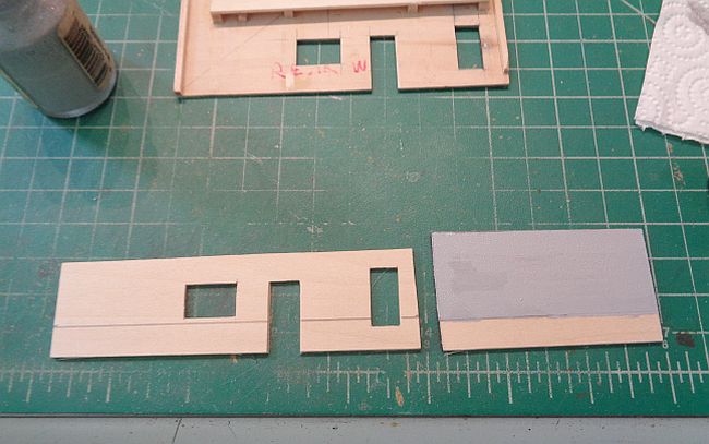

I used a new #17 Xacto blade and carefully pried up the bracing.

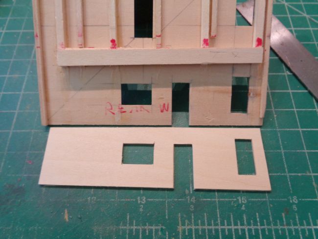

Once the bracing was removed, I sanded the interior side of the rear wall smooth using a large sanding stick.
I'll fast forward here a little. I cut a piece of plain strip wood, placed it up against the rear wall, traced the door and window openings and then cut them out of the strip wood.

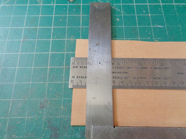

I measured up three HO scale feet for the height of the wainscoting. I'm using Floquil Primer for the wall color.

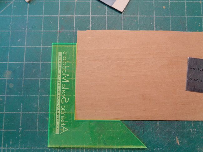

I have a very old, I mean about 50 years, piece of HO beadboard. This will work well for the wainscoting. It is very thin and fragile. I guess due to the age?
Anyway, I used a square to make sure the end was a true 90 degree angle.
I measured 3 HO scale feet and used the metal square to cut the wainscoting after removing the scale ruler.
