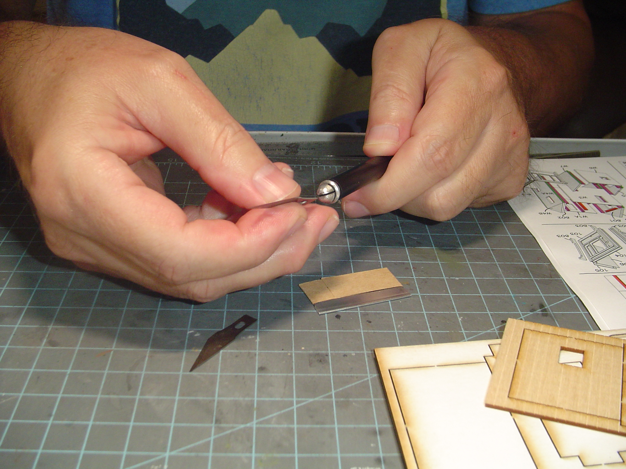

Since I just finished two background flats my razor blade and X-Acto blades needed to be replaced. I usually do this at the start of a new build unless I had to replace them near the end of the previous build.

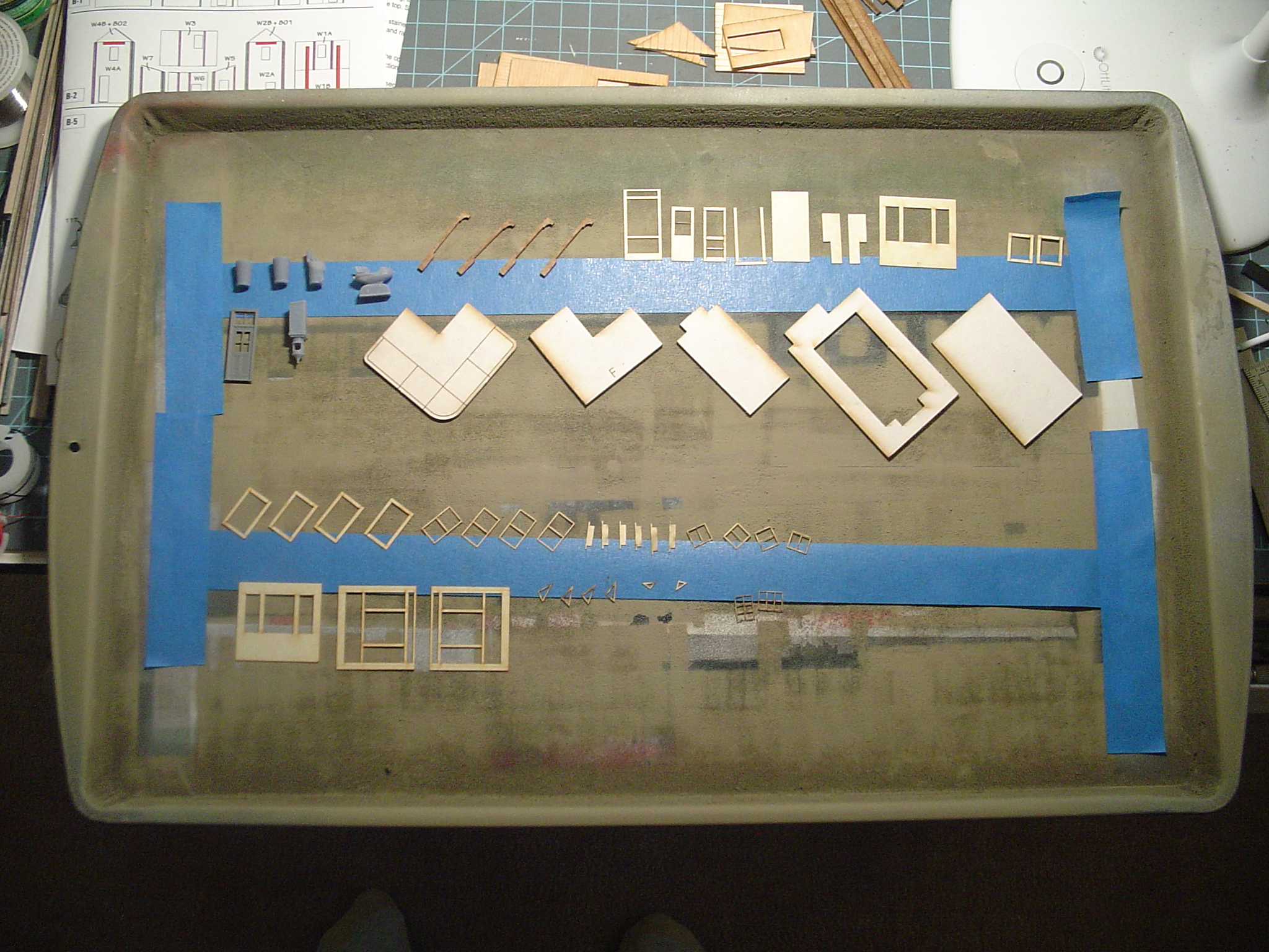

Once I had removed everything from the carrier sheets and cleaned up the other stuff (the 3D printed details didn't require any clean up) I stuck the stuff that I felt needed to be primed on an old baking sheet using painters' tape that was taped upside down on the sheet, so the sticky side was up. I took this out to the paint shop (my drive way) and hit with a rattle can tan color primer. After the paint dried to the touch I flipped everything over and hit the other side as well.

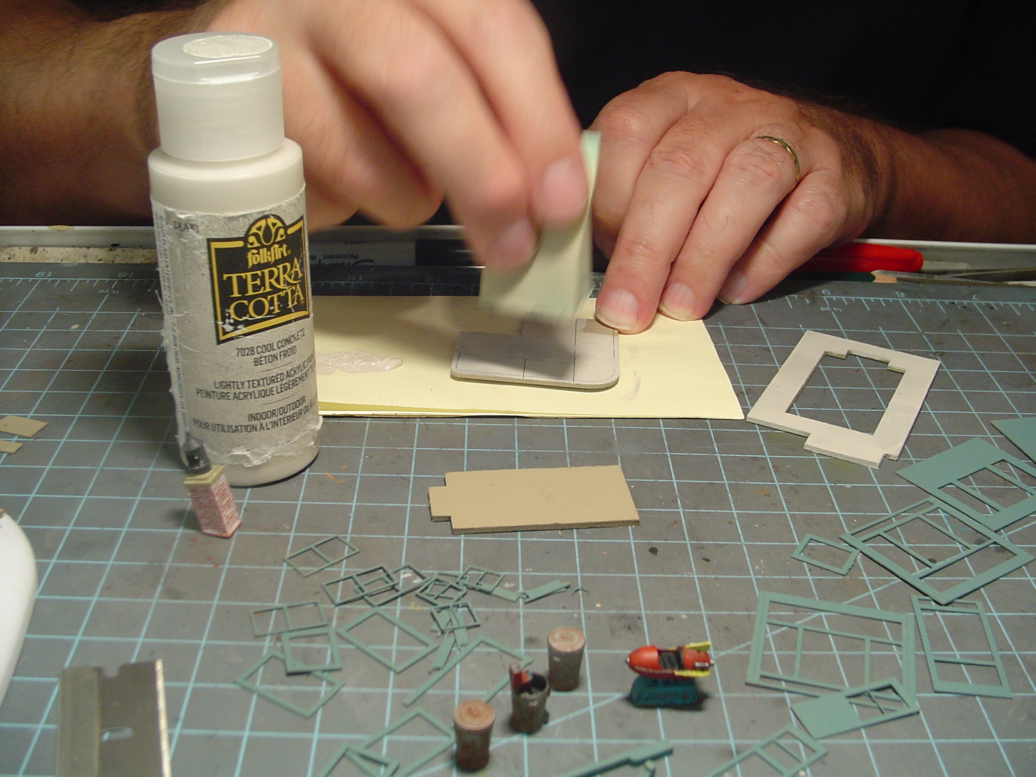

Then I painted the trim, doors, windows, store front components, columns, etc. with a craft acrylic (Americana Thicket) using a makeup sponge.  Gee...make up sponges and emery boards.  Who knew we'd be buying our tools in the makeup section at Target?

The concrete foundation pieces and sidewalk were painted with a "Cool Concrete" craft paint and then a wash of Polly Scale Aged Concrete was applied over top of that followed by some weathering powders.  I don't have a set formula for this.  I just play around until it looks acceptable to my eye.  In the past, when I would around the old town I live in up in PA, I noticed the sidewalks were a variety of colors. Not one uniform color throughout the town.  Older sections, newer sections, etc.
