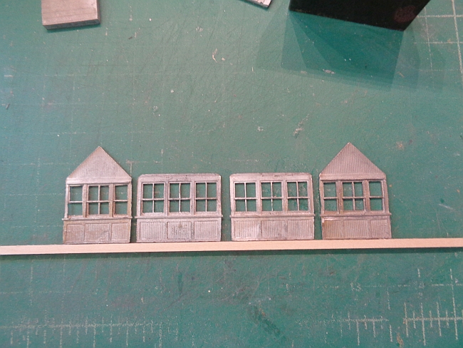

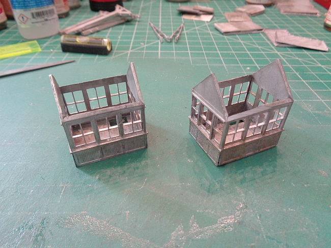

Next thing I knew, two hours had passed and the four walls and floor were super glued together. The next photo shows how bad a fit the first kit went together. I realized this was do to the bad castings in the one kit and my not paying attention more to the  build. Hint - I got carried away and didn't take many photos of this build.
However, I did get the walls level in the first kit in spite of myself and the bad castings.
I did pay attention to the second kit and realized one of the problems I had with the first one was due also to the wall being different heights when aligned at the bottom.
You can see the window trim between the windows and walls don't line up.

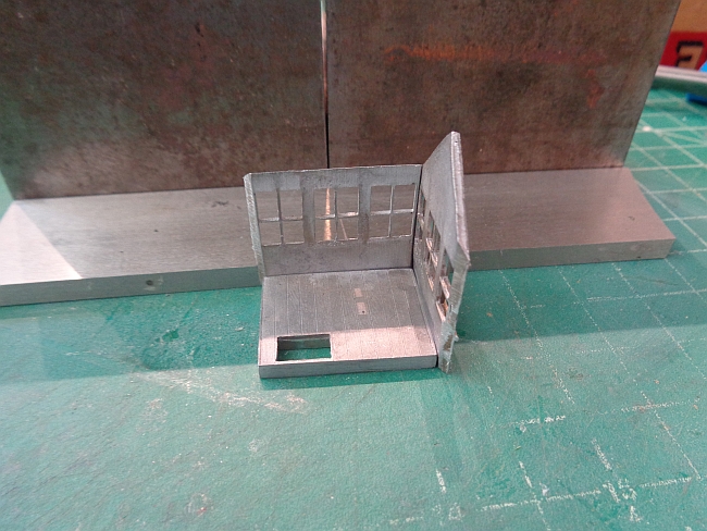

I aligned the floor and one end wall and then super glued them together.
Next I test fit and then glued one side wall to the floor and the end wall.
The the other end wall. I'll fill the small gap at the bottom corner with putty.
The remaining side wall was a nice tight fit and it was glued in place.

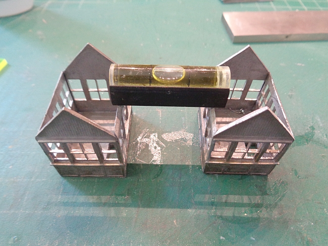

Both towers were square and true and that was a blessing.
I used my sanding disc with medium grit and leveled the bottom of the first kit to sit a little lower. The first one was slightly higher than the second.
Not that it mattered but I wanted them both the same height.
