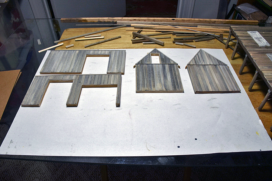

The inside framing is done. Framing is 4x8 with 1/32" scribed siding.  Stained with Minwax Golden Oak.
My lightning screws up the stain.
More to follow later.
The outside is made of 2x12 planking coated with 1 to 3 coats of SilverWood Stain.
The doors are stained SilverWood then white over that and peeled with mineral spirits and scotch tape the Chuck Doan way.
Jerry Fantastic job on the framing and inside/outside siding. Luv the doors; I may have to borrow that technique sometime. You are the "Master of framing."

Thanks Larry.  it an easy way to do peeling and it works every time!
Pennman
You know Jerry, that I now have silverwood stain. I might just have to use some to see if I can achieve what you have shown us. Those wood planks are superb! I know lighting is also a small problem, but the dock pictures (shown earlier) look a little darker than the outside wall pictures, or it may be my eyesight. I was thinking that silverwood stain would be more darker though.
And Larry is correct when saying that you are the master of framing. How did you make the door rollers/pulleys?
