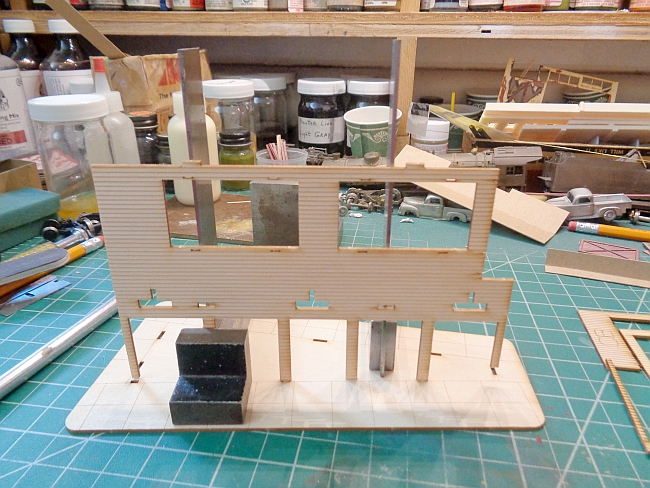

I was a crime scene photographer while on the PD. The wall is definitely warped. It you go back and look at the photo again, you'll notice the corner trim is straight. The bottom and top portion of the wall is bowed in.

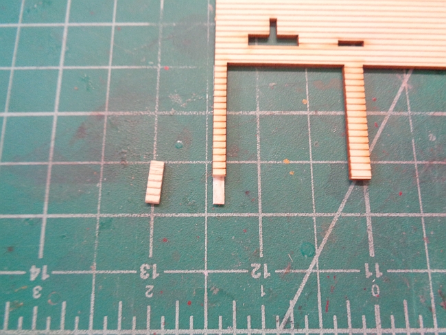

I decided to look closely over the kit parts and familiarize myself with subassemblies. I also counted the parts, 235+ of parts and pieces.
There are no instructions, but Jeff did a great job of showing all the subassemblies in exploded views. Eight pages of front and back drawings.

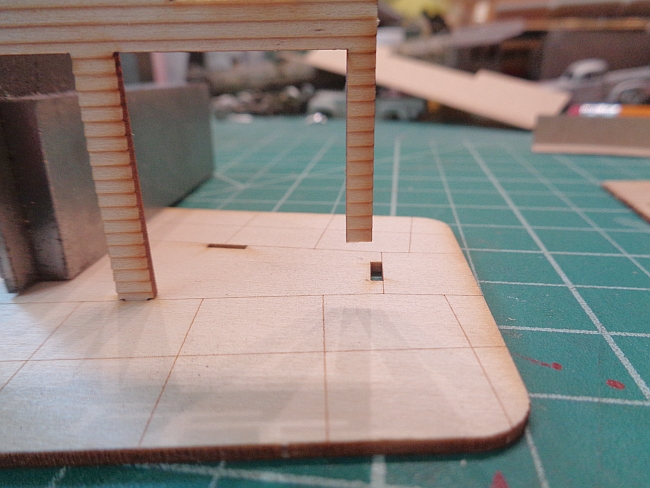

I did find two broken pieces. These may have broken when I first open the box many, many years ago. This was the first start of the build as these two pieces were missing from the front wall.
The right end lower wall section was broken off. I didn't find it in the box.
The left end bottom wall tab was also broken off.
These needed to be fixed first.

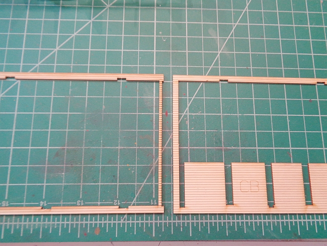

Note the two carrier sheets in the below photo. I was hoping to find a wall section from these two.
The one on the left is to thin and the right one is to wide.

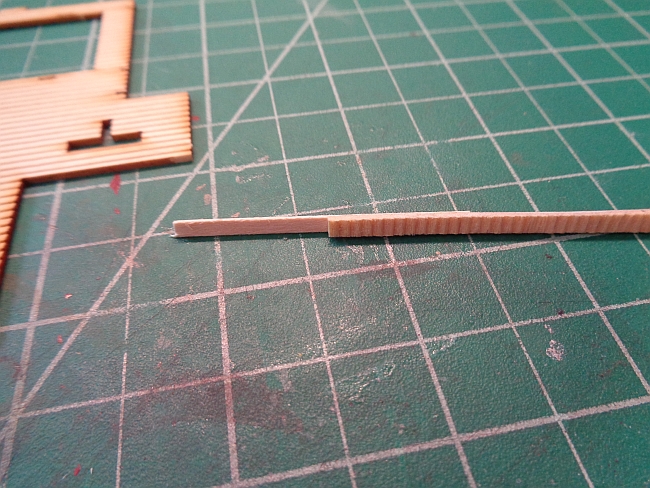

I measured and cut one from one of the blanks on the right carrier in the photo.

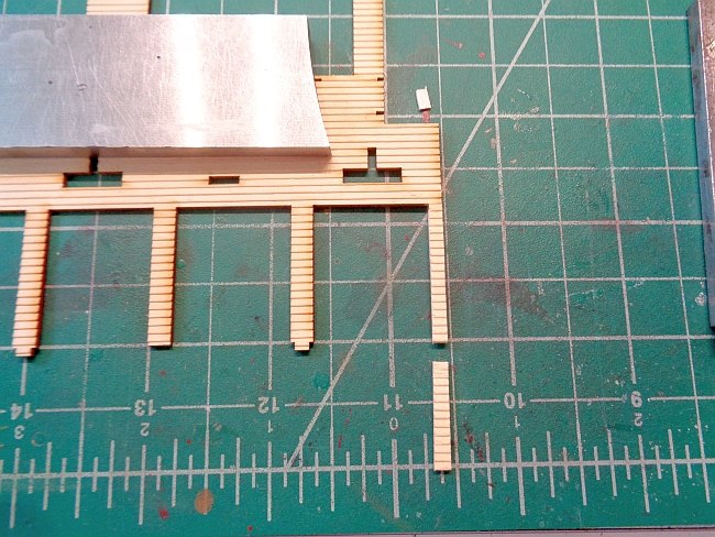

The right wall section is very fragile. I didn't feel that just by end gluing,
the two parts would hold.
I then cut the broken wall part off flush with the bottom of the upper wall.
I used a small length of an HO scale 2X8 and glued it to the back of the new piece.
I then glued the 2X8 to the back of the upper wall section. When dry, I trimmed the 2X8 off the top and cut the new wall section even with the other wall pillars.
I used the same technique for the left wall tab.

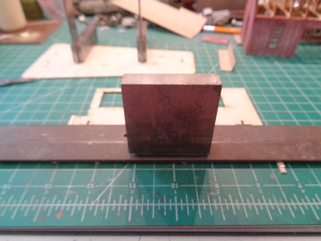

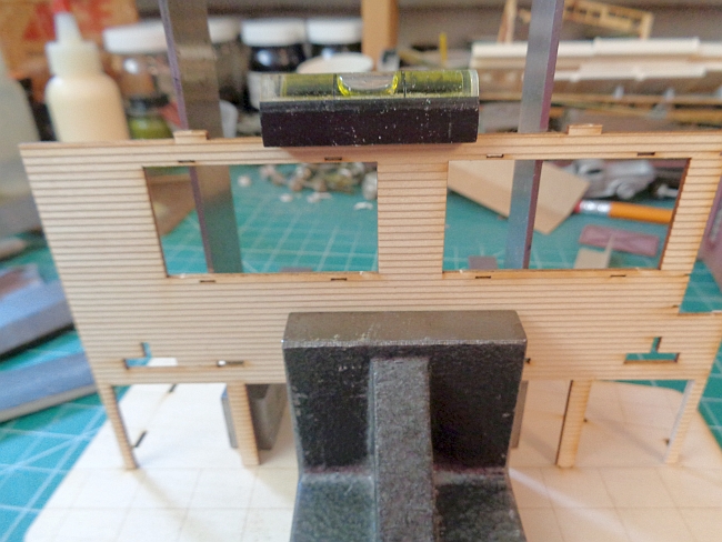

I placed a heavy metal ruler on the front wall and let the glue dry on the repaired left wall tab.
When the glue dried, I trimmed the tab to the length of the other two. I made a test fit of the repaired front wall into the base. Everything fit as it should and the front wall section in now repaired and level on the base.
