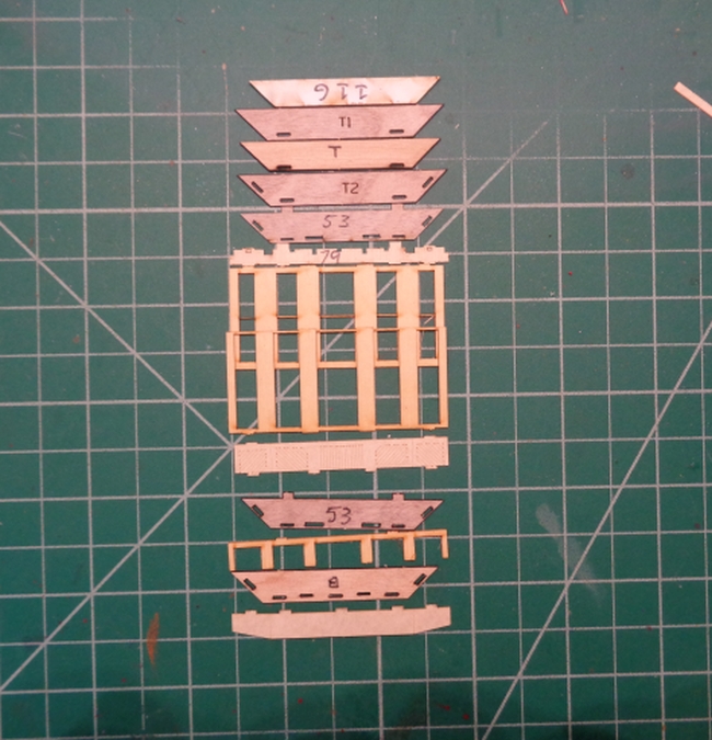

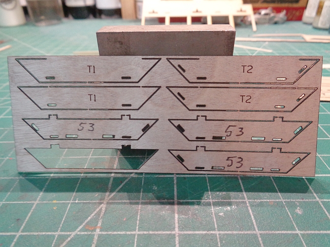

This next photo shows the parts that go on both upper bay windows.
I figured out the unmarked parts were parts #53. I marked the number on the part.
Notice anything else wrong with the carrier sheet?
The upper part of T1 and T2 are not laser cut all the way across like the parts below them. I'll need to cut them myself. No problem.
For such a high quality manufacturer there seems to be a lot of issues.

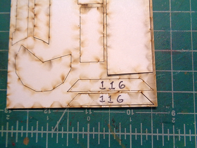

Each bay window is made up of 13 parts. However, I could only find 12 parts. Then I found them on the thicker sheet of parts.
The two parts are on the lower right side of this sheet.
These are both part #116.
Here are the 13 parts that make up one bay window. Of course, the doesn't include the corbels.

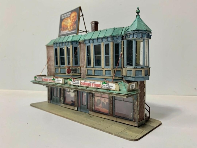

I searched again today the pictures I sent earlier thinking the second one sold on Ebay, No. It was actually found on Facebook, here's the original caption, and date:
The Craftsman Courtyard
Jeff Grove
September 25, 2021
.....by popular request....our old Doc Koontz store now in brick....thanks to Stephen Milley at Rail-Scale Models, we've converted this structure to prototypical brick.....a nice, tough to build craftsman kit....with exceptional results....great window details and effects.....
I'm still unknowing who the builder was, unless it was Jeff Grove.

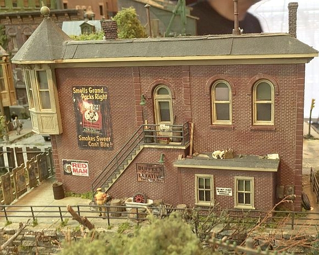

I'll call Jeff later this afternoon and get the history, if any on this kit. I know this kit was on the F&SM layout in 2016 when I last visited George. Also, the kit on the F&SM is definitely not like the brick one shown below. The front is very similar but the rear is totally different.
The two huge bay windows don't really look like they would be on a wood walled structure.
