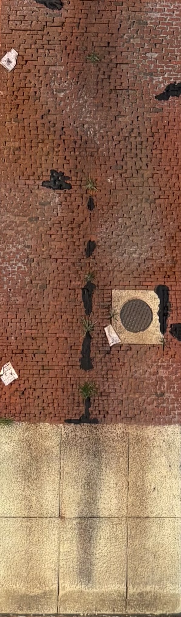

Awesome modeling.  The fire escapes are beautiful.  Wondered how you did the cobblestone road. Appears to be foam insulation that you carved?  One-of-a-kind models are so cool.  Mark

Mark, the brick alley is indeed carved insulation foam, as are all of the sidewalks. I covered unsightly gaps with tar patches and weeds.

What did you use for the concrete space next to the carved brick street? Was it Durham's
water putty?

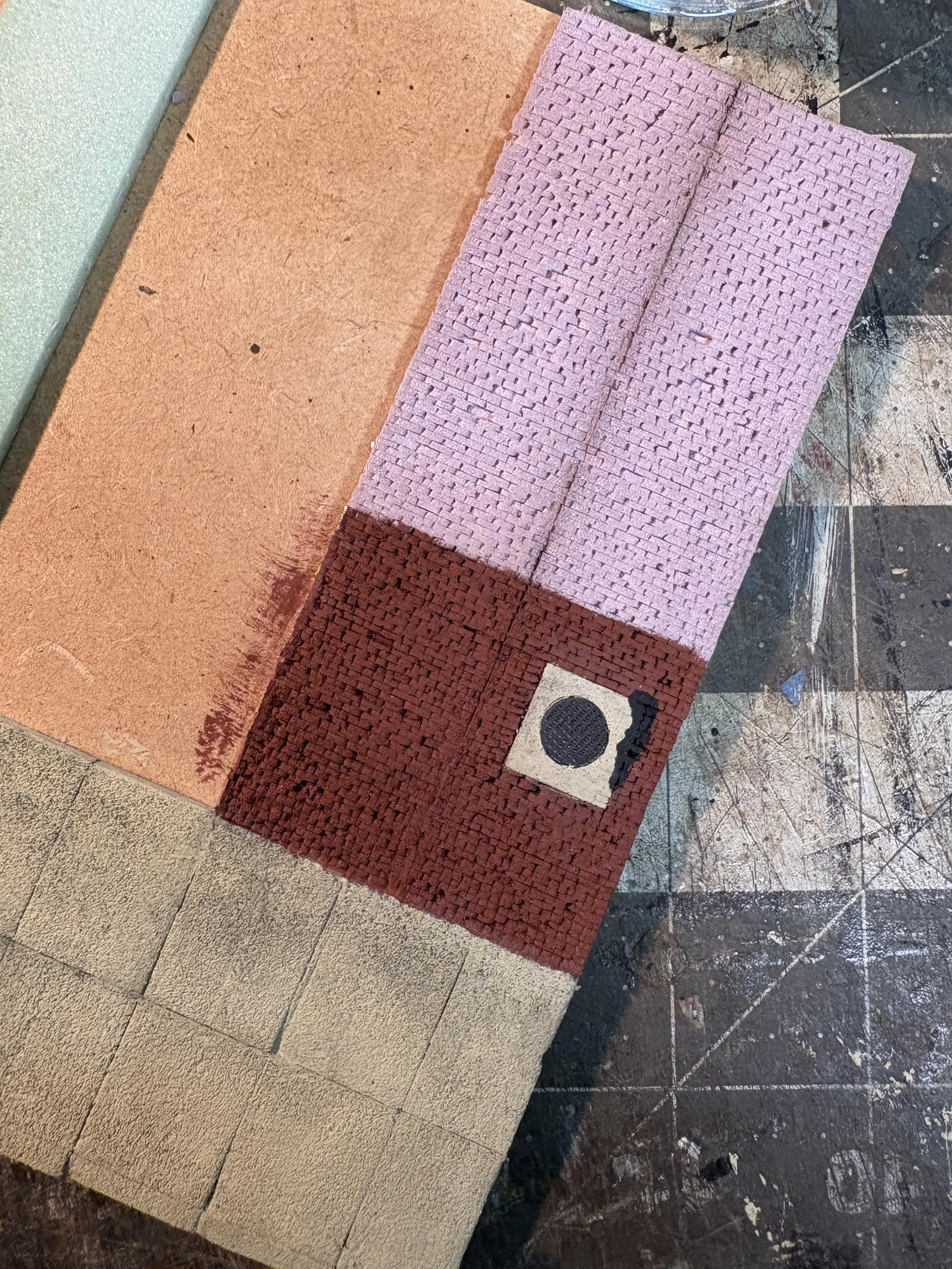

Rich,
I am not sure which concrete space you are referring to, but I can confidently say that it is foam. The carved brick street, the concrete around the manhole and the sidewalk are all insulation foam. I rip 1" foam into 1/8" strips with a bandsaw. For the sidewalks I add curbs, joints and cracks with a hobby knife. I use a ruler to press some of the sidewalk sections down to create unevenness for variety. The texture that you see is from the bandsaw. I paint it with Cocoon chalk paint(no longer available) and then give it a dark gray or black wash. All that is followed by a pass of Bragdon powders.
For the bricks I cut the rows and brick joints and then push in individual bricks with a piece of strip wood. They are painted with a brick red and individual bricks are picked out in other shades. The tar is black acrylic. The manhole cover is an FSM casting from Railroad Kits, painted with that same Vallejo Camo Black Brown. Again everything is weathered with Bragdon powders. The lighter colored powders add some hints of mortar. The darker add dirt and grime, especially near the edges. Black goes down the center of the travel lanes for oil and such.
The stone pavers in the backyard and all the stone foundations are also insulation foam. They are the same 1/8" strips, textured with a ball of aluminum foil and cut into individual stones.

Thanks for the info Matt.  At some point, I'll be giving foam insulation a try for cobblestone streets.  I've seen this done before using old paint brushes, with the bristles removed, and squaring the metal tips to make individual bricks, but I was looking for a faster method.  Anything worth doing takes time and patience.  Mark
