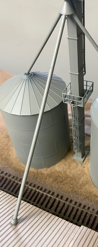

With the structure nearly complete, I moved to the elevator and Bins.
The bins were gifts from Dave Emery.  They are meant for water or fuel tanks but scrolling through photos I noticed that old feed grains looked similar, so I decided they would work.  No details here on construction; nothing special.  Just join sections to make rings, pile the rings, and add the top.
The elevator is a PikeStuff kit.  I simply followed instructions.
A couple of construction details . . .
Seeing no clear way to guarantee the platform would be straight, I glued pieces of stripwood against the ridge around the elevator, glued the platform on, and then, because I'd used a water-based glue. I removed the wood.
I was worried the small base would be insufficient to hold the elevator in place over time, so I glued a square of styrene to the base, and attached the assembly down to the homasote base with four track nails.  Here it is with the scenery partially in place to cover it.
The bins are glued down with tacky glue.
I've started adding the chutes.  Sort of delicate.  The chute to the building will need some thought.

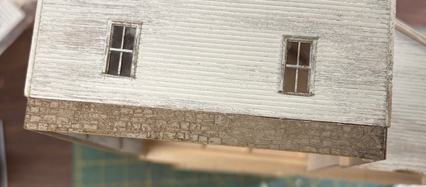

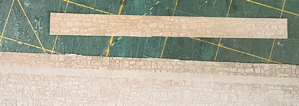

Foundation
The foundation is made from a paper product that I bought some years ago from Rusty Stumps, now available from Rail Scale Models.
I simply brushed several gray and brown shades of powders, and cut strips to laminate on the foundation area:
I supplemented the sticky backing with canopy glue.

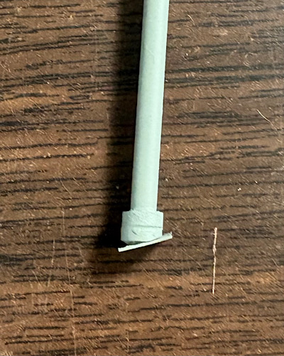

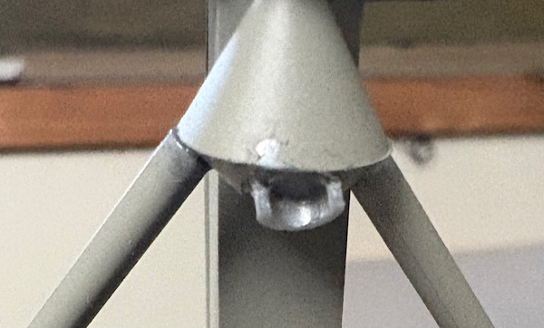

Chutes
I wanted a chute from the elevator to the building, but I also wanted to be able to remove the building.  I added a semicircular plastic piece to the elevator, and glued an angled fitting to the bottom of the chute:
The chute simply sits in place:

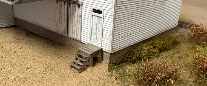

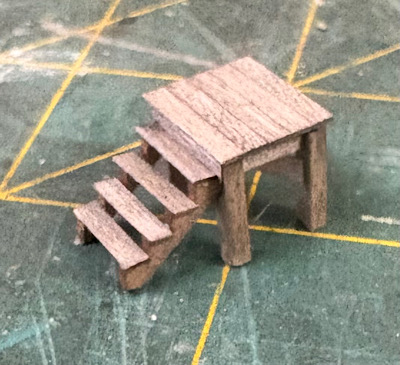

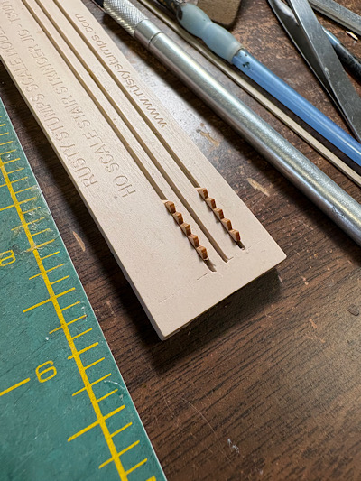

Steps
For making steps I used a jig and stringers I also bought from Rusty Stumps:
The result in place:
I have a few more details to complete on this model.
