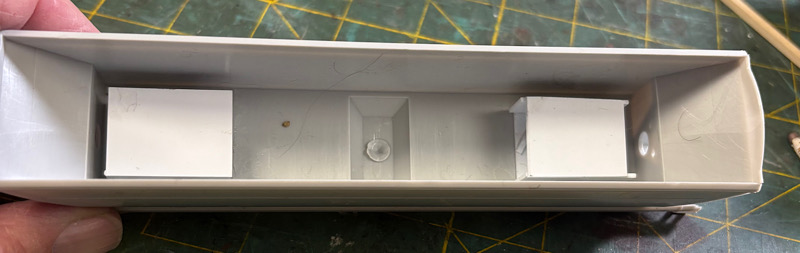

First of all, despite the fact that the instructions mention a weight, none came with the kit.  I usually use a couple of steel nuts as weights.  I secure them in a car my packaging them in a little box:
and gluing them onto the floor of the car.
They will never come loose.

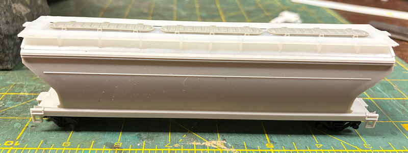

This morning while it snowed heavily outside, I added the roof:

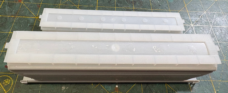

The roof hatches are Atlas parts that I ordered a year ago because despite the box saying this is a grain car, the kit only included round hatches, rather than the trough hatches typical of grain cars.  I had to carefully remove some short pins on the roof of the McKean car, as well as remove pins on the Atlas parts.
Here's the modified roof with the stock roof of one of the other kits in the background.
I guess those are pegs more than they are pins.
The roof is a tight fit, but in the end it sets down very nicely on the sides and ends.
