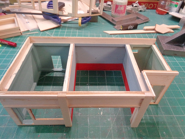

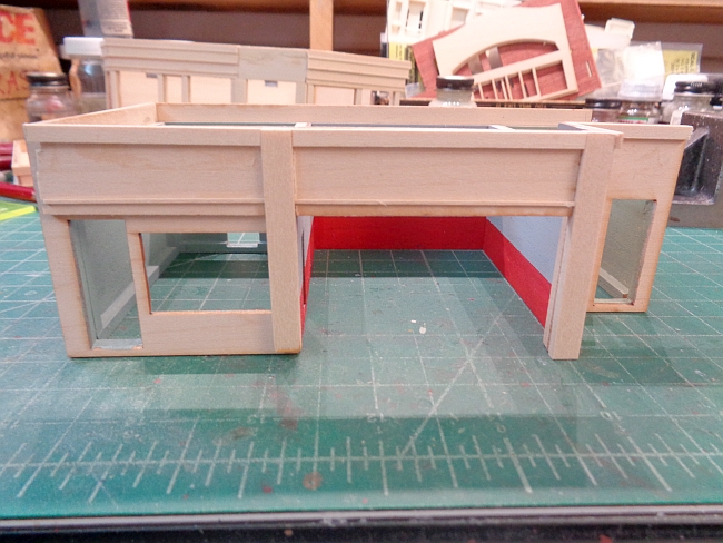

I got a lot done on this build today. I painted the walls on the three areas of the service bay. I also assembled, glued the walls together and added the fascia trim.
I haven't decided just how much interior detail I want to add but the interior walls were easier to paint when laying flat. So, no matter what or how much I add, the walls are covered.

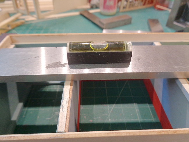

Add, I'm always pleased when all walls are level.

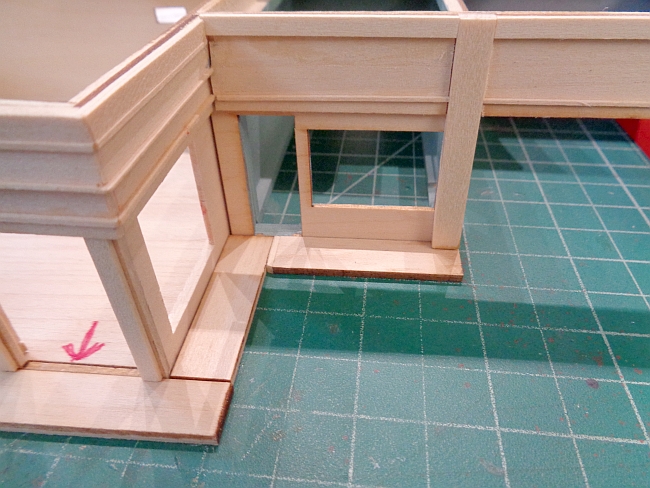

I showed this photo in a previous post and said it front sidewalk needed to be trimmed.
I trimmed it this afternoon and sanded down the short piece of sidewalk that was too thick.

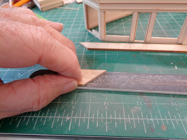

I didn't want to use the powered sanding disc. I wasn't going to chance having my finger skin removed from a sander rotating at 1200 RPMs.
Here is what I did to sand down the thick sidewalk.
I noticed the piece was as wide as my sanding stick.
I used my thumb and middle finger to hold the sides of the sidewalk. And, I used them as a guide on the sides of the sanding stick. I used my pointing finger to hold the piece on the sanding stick.
I moved the piece back and forth until I had the desired thickness.

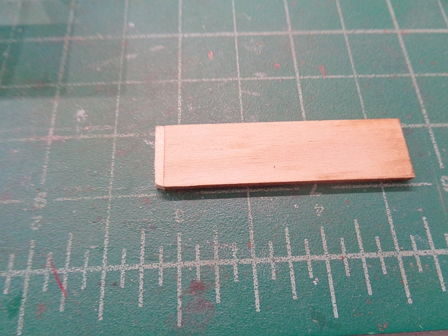

I noticed one sidewalk section was short and didn't fit the space.
Here is how I fixed this one.
I glued a piece of scrap wood in the opening and against the section on the right. When the glue dried, I cut the top off and sanded it flat to match the height of the sidewalk.
More problems and more fixes.  ;D
The gray and red interior looks prototypical.
